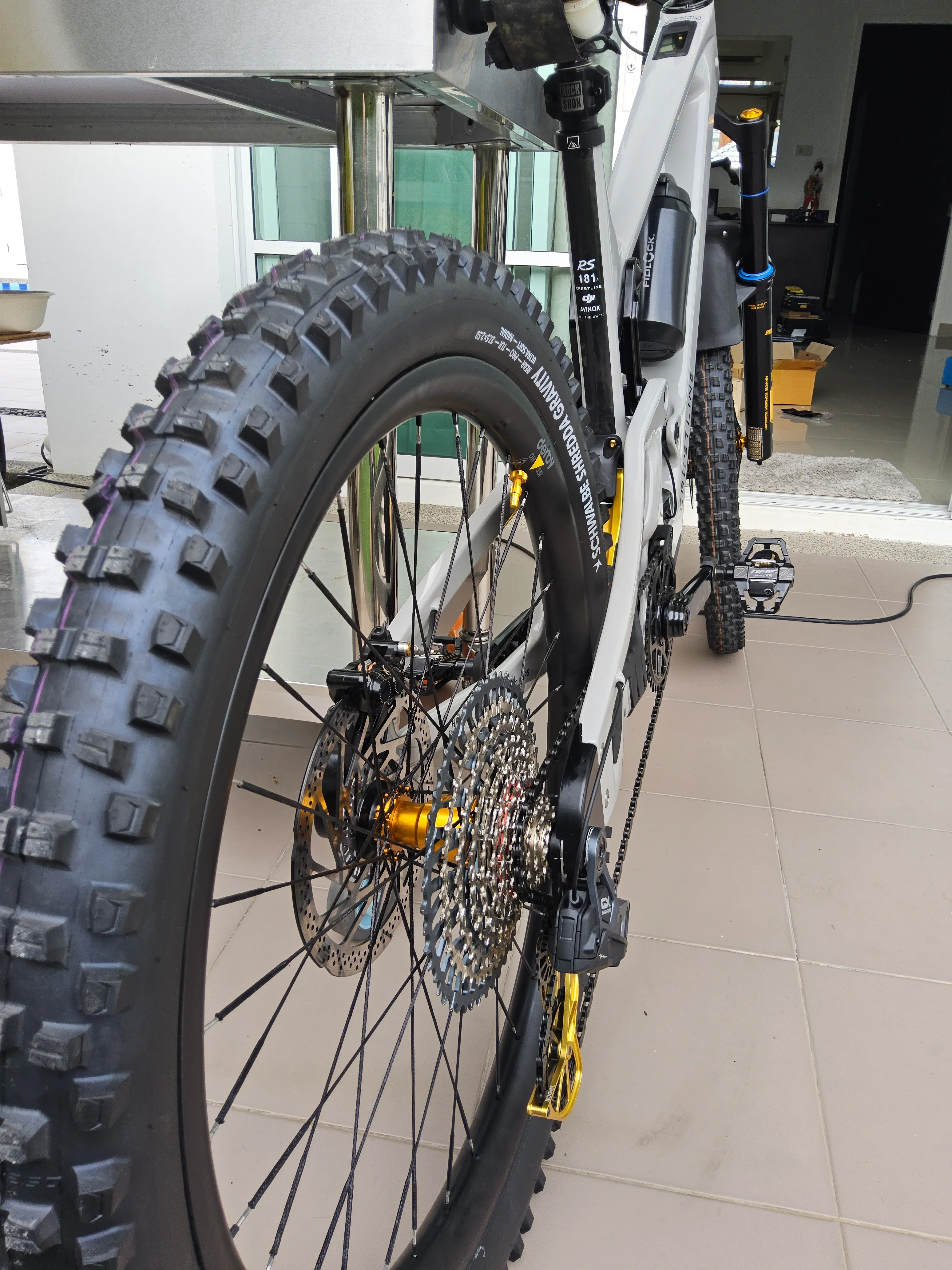

Can you share your wheel build specs please. I have I9 system currently but been really looking into these. Thanks
Onyx Classic hubs with the hooks for the BERDs, and derby rims. 35i rear, 30i front.
Are those the heavier duty spokes? Just wondering if above can comment on the feel.
Ill have to double check as the order just says Berd spokes.
Its hard for me to give a real opinion on them because I am also running the magic mary radials and this new bike. This is a first for me on the radials. I’m sure all the things I am feeling are due to several factors. That said, my first impression is that they feel crazy comfortable over rough stuff. I hate to use the words, but compliant was my first thought.
At some point, I am going to swap between my two sets and try to get a better idea of the feel, and if its worth it. My other set is Vespers/tr37’s with Sapim D-light spokes. So only difference is the spokes. 😁

Bike looks so good, and with the Onyx hubs I know it sounds good too!
I also run the Time pedals for decades now, they just work forever regardless of mud and lack of maintenance. (y)

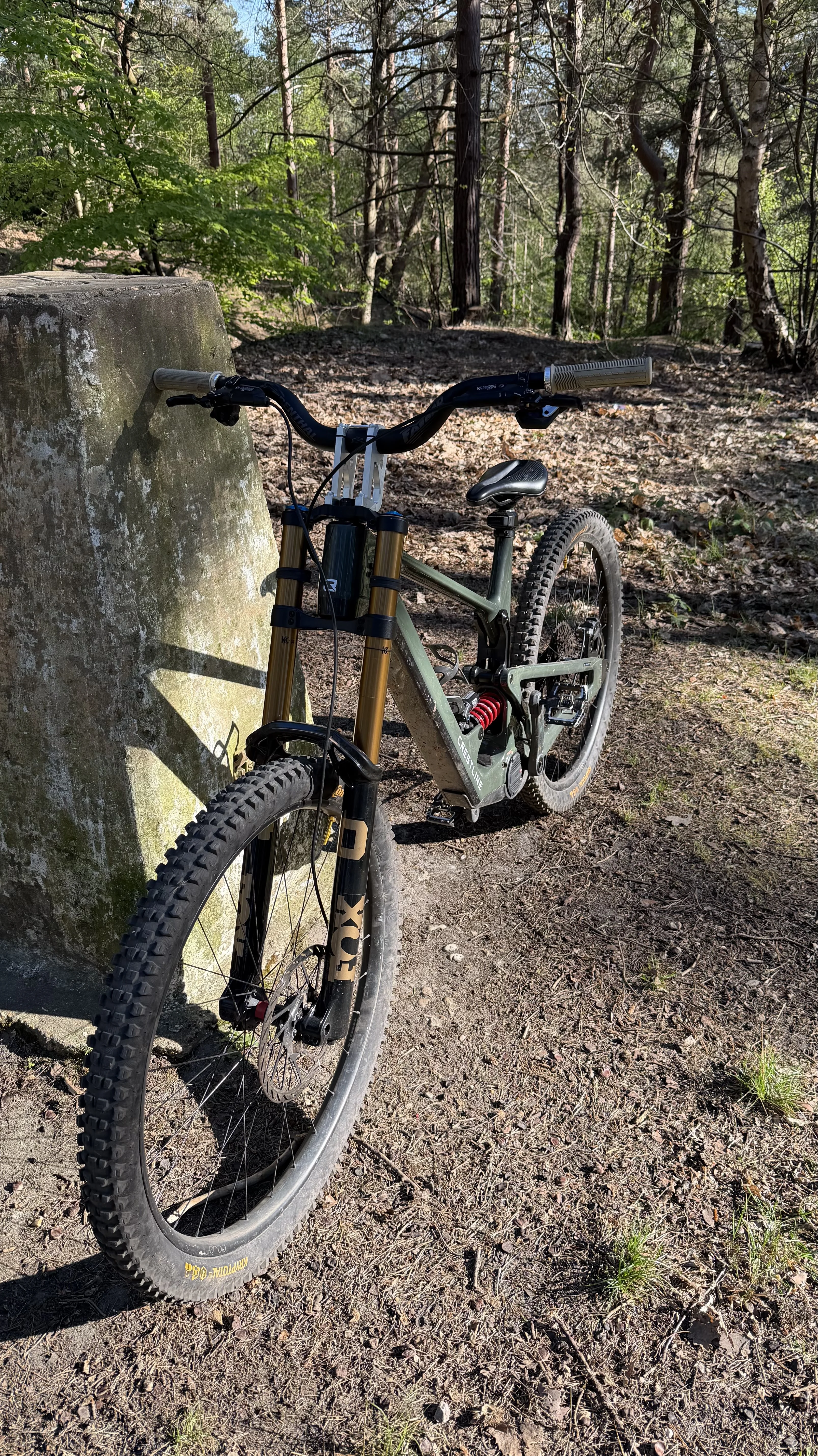

Nice chopper Rob (y) I'm leaning that direction for park days. Maybe go with Ohlin's...
Cascade sells a 200 link I assume?
Yes. Need to go up a compression tune at least. (I haven’t yet) but will do when I fit the link.
I'm curious for the lazy ones or those not wanting to swap the shock how it would ride without changing compression... I'd imagine that additional 20mm wouldn't be all that helpful without a change. I don't see the suggestion of a retune for 161 vs 181, but I'm not sure if the increase to 200mm surpasses some threshold?
Good to see it still works with a 29", i figured mullet might be necessary, is there a CS length minimum for the wagon wheel?
