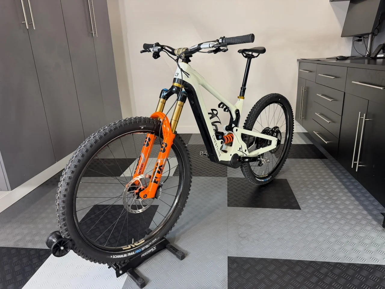

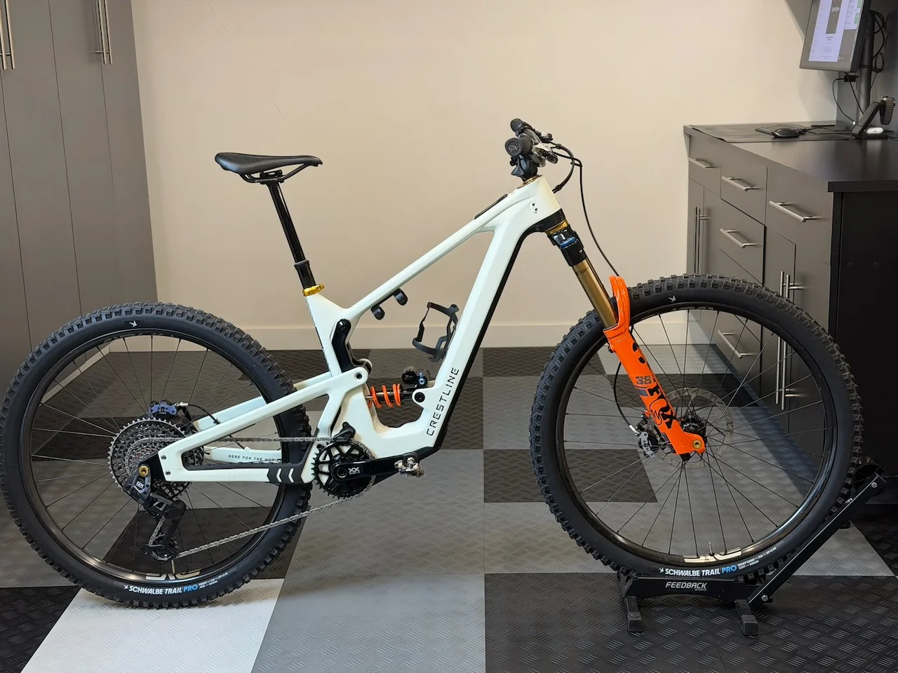

Got a RH-3 team bike last week and it rides really well. I’ve never had a Zeb before and I guess this new one is a bit different from previous versions. I set it to the recommended settings for my weight (200 lb, 150 psi, neutral Lsc/hsc, -9 rebound, no tokens, mid abo) but seems a bit stiff, I assumed the new linear air spring would be more plush. Haven’t hit the hardest trails yet, but using nowhere near full travel. I’ll play around with air settings, but curious how you all are getting along with this fork and if you have any recommendations, I realize fork setup is a personal preference thing.
I had the same experience on my inaugural ride and will be dialing back the pressure. I’m also at 150 and plan to try 140.
What psi achieves the recommended sag for you? I’d start there.
yeah, similar experience also with the new Zeb. Found myself running a decent amount less PSI than recommended. Still tweaking it, not super close to bottoming it out.
this is all so interesting to hear. I had 17% sag with no token on the new zeb and found myself blowing through travel. I’m only 155lbs. Had to put a token in and it’s now feeling much much better. Have it around 19-20% sag now. Also have to have rebound close to full fast (I think I’m 1-2 click from full fast).

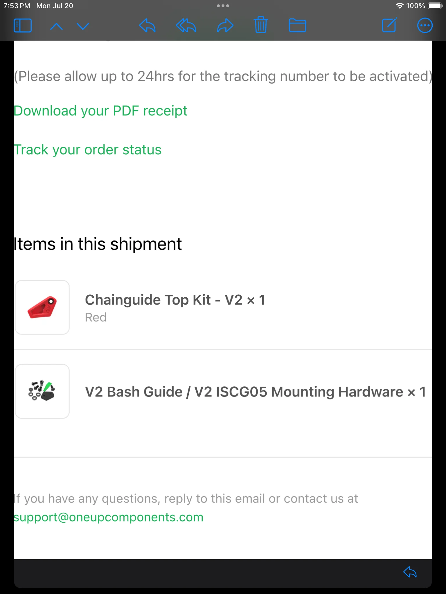

Yeah, I had an issue with mine, but it was most likely because I was running a Garbaruk chainring and it has a few mm less offset than stock. So it wasn’t rubbing, but it wasn’t centered in the chainguide. There was a larger gap on the outside of the guide and in rough high speed chunk the chain would bend the guide outwards enough to derail the chain onto my crank arm. This past Saturday the chain actually ripped the guide completely off. Destroyed the chain and guide. So I just ordered a new top guide and mounting kit from OneUp. The bummer is they were sold out of black, so I had to order a red one. The good thing is I believe the mounting kit comes with shims, so you’ll be able to adjust it in or out to center it on the chainring. This is what I ordered. 👇🏻
