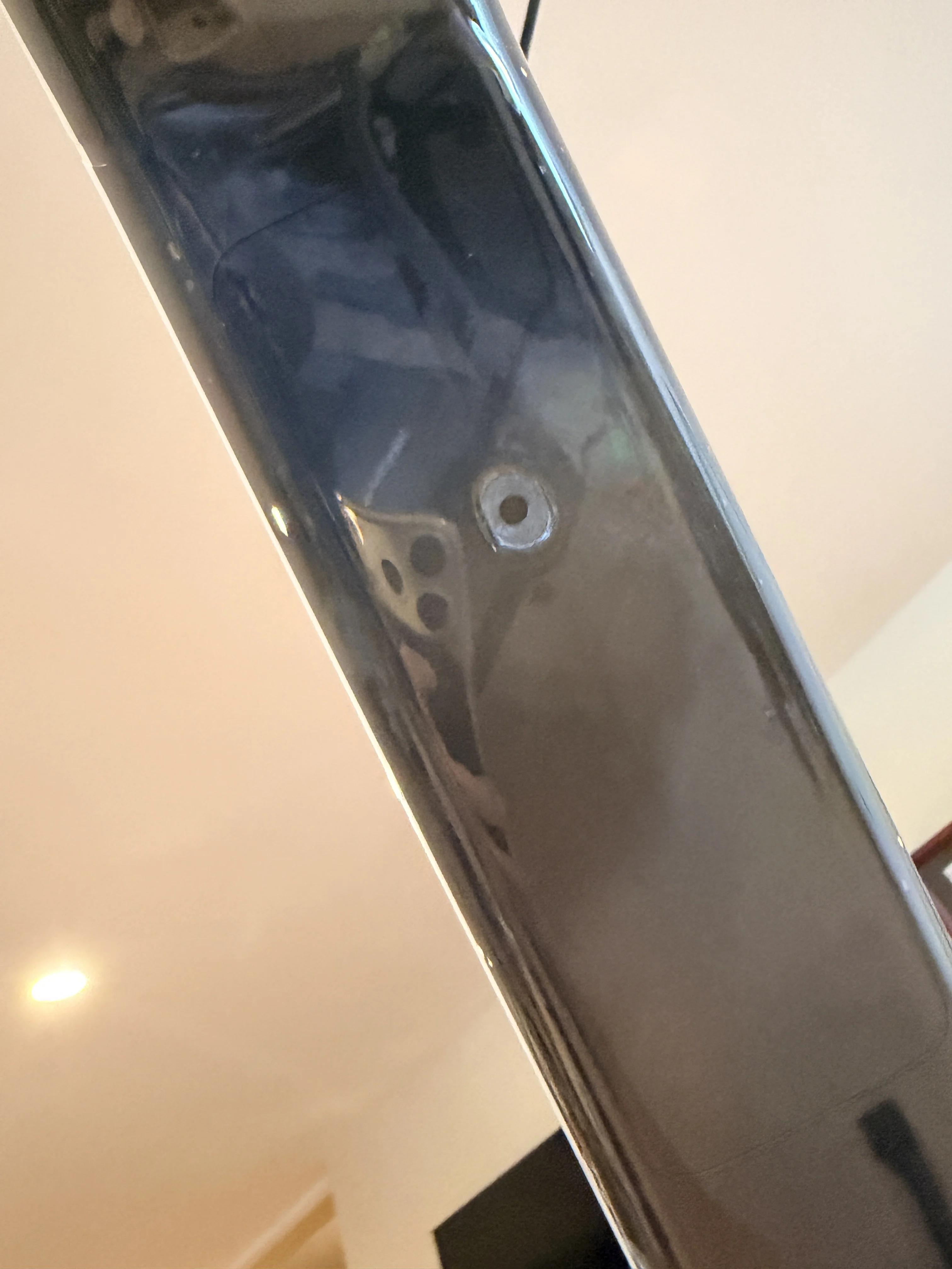

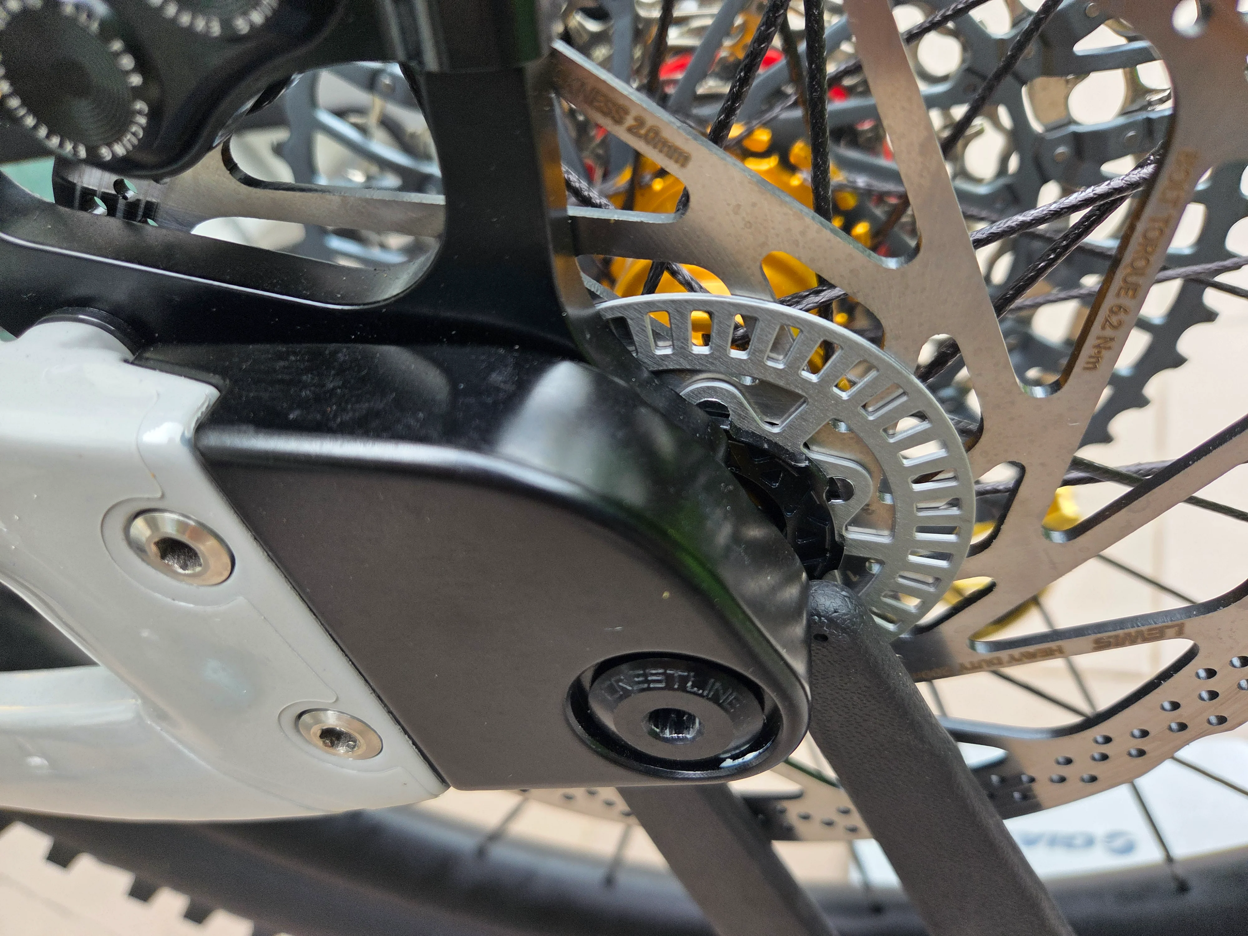

^^ I noticed my ridewrap has that gaping hole right around the battery mount too. What a terrible design if this is the case, I thought maybe the installer missed something. (n)
Guess they assume everyone received the super cool shuttle guard, which is out of stock on the Crestline site:
When ridewrap developed their wrap, they had a shuttle guard. If you reach out to them, they'll send you a replacement free of charge without the cut out.
Do you have a frame plug for that hole? I know the 181.1 came with plugs but it seems like the 181.2 did not receive plugs.

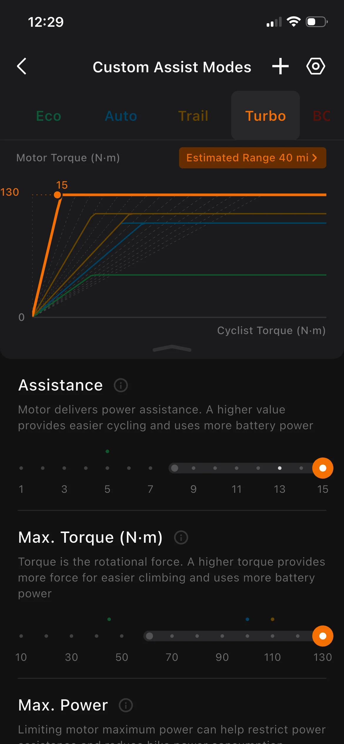

What about raising the torque/watts limits to the max per the mode you are in while attempting to boost?
..Thinking maybe something to do with local boost enhancement which I dont fully understand just yet to be honest.
Yep. Firmware updated. Tried it turning it on from every other mode
Makes sense, wonder if they will just send the center part to fill in the hole for the missing shuttle guard area. I will reach out, thanks for the tip!
The photo is not mine, but a screw goes into the hole for the 600wh battery on my RH2. :cool:

I went back though all the settings and everything checks out. Tried the button again just cruising around on the road, no bueno. I changed turbo mode settings to max everything 1300w/130nm max assist, there's tons of power and all seems normal. As soon as boost is activated the power cuts and it feels like the motor is fighting me on the pedals. This happens regardless of the mode I started in and lasts the duration the timer. I also tried the high rpm hypothesis, and mashing as hard as I could. Everything seems normal other than the boost mode. It's not a huge deal for me it's not something I'd be using often anyway. I'm sure it's just a software bug they need to patch up, I will look into opening a ticket with Avinox.

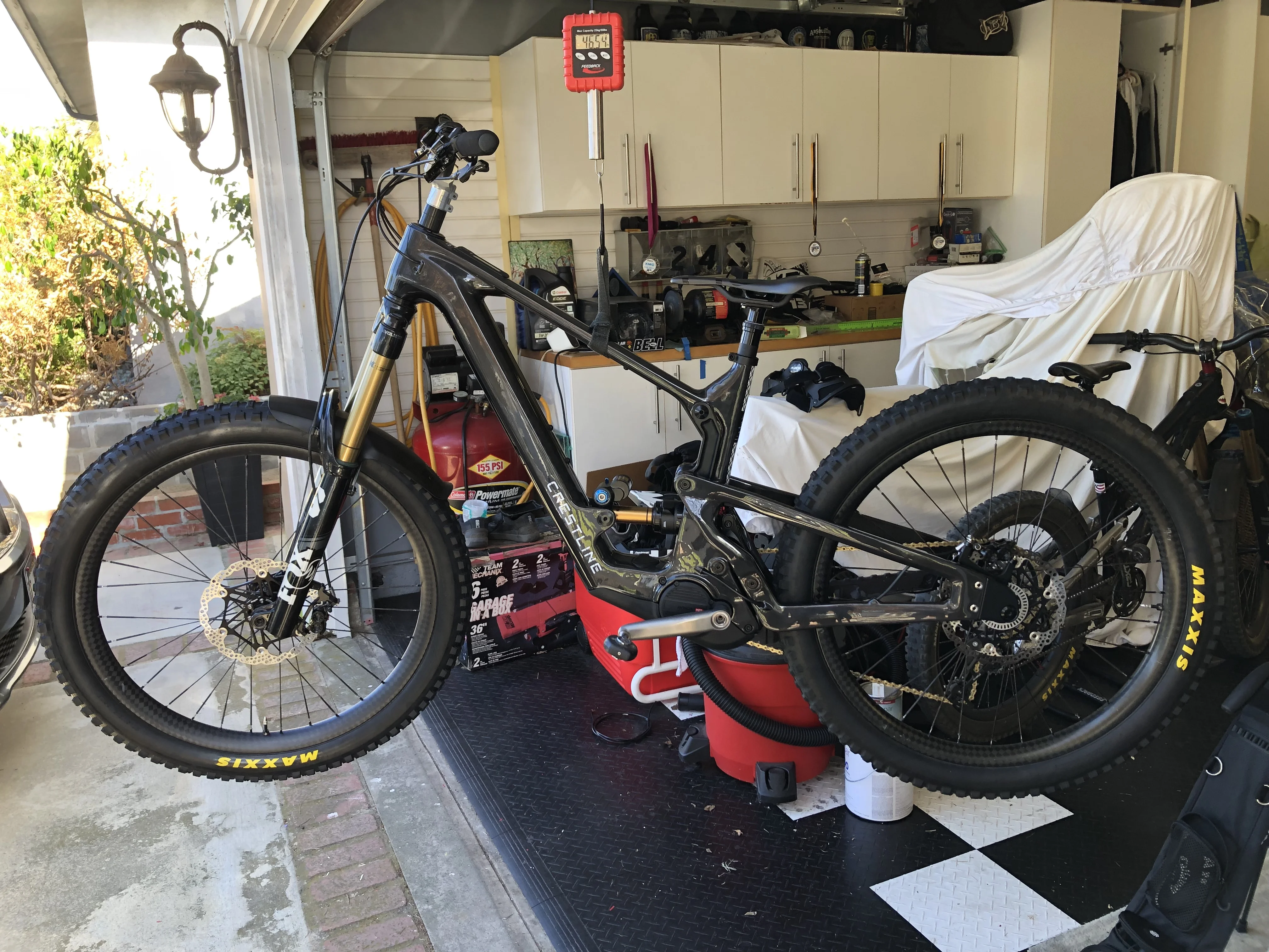

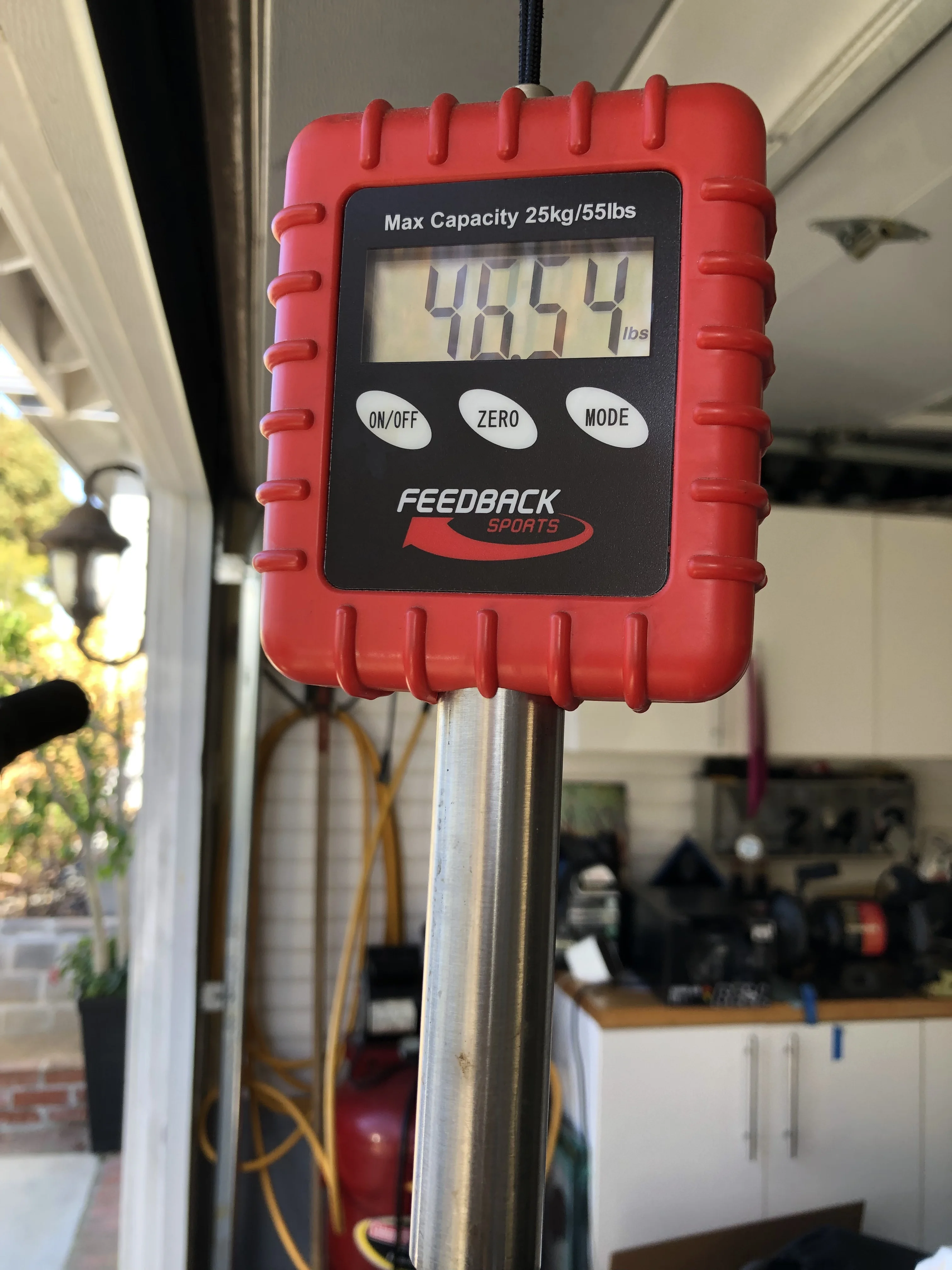

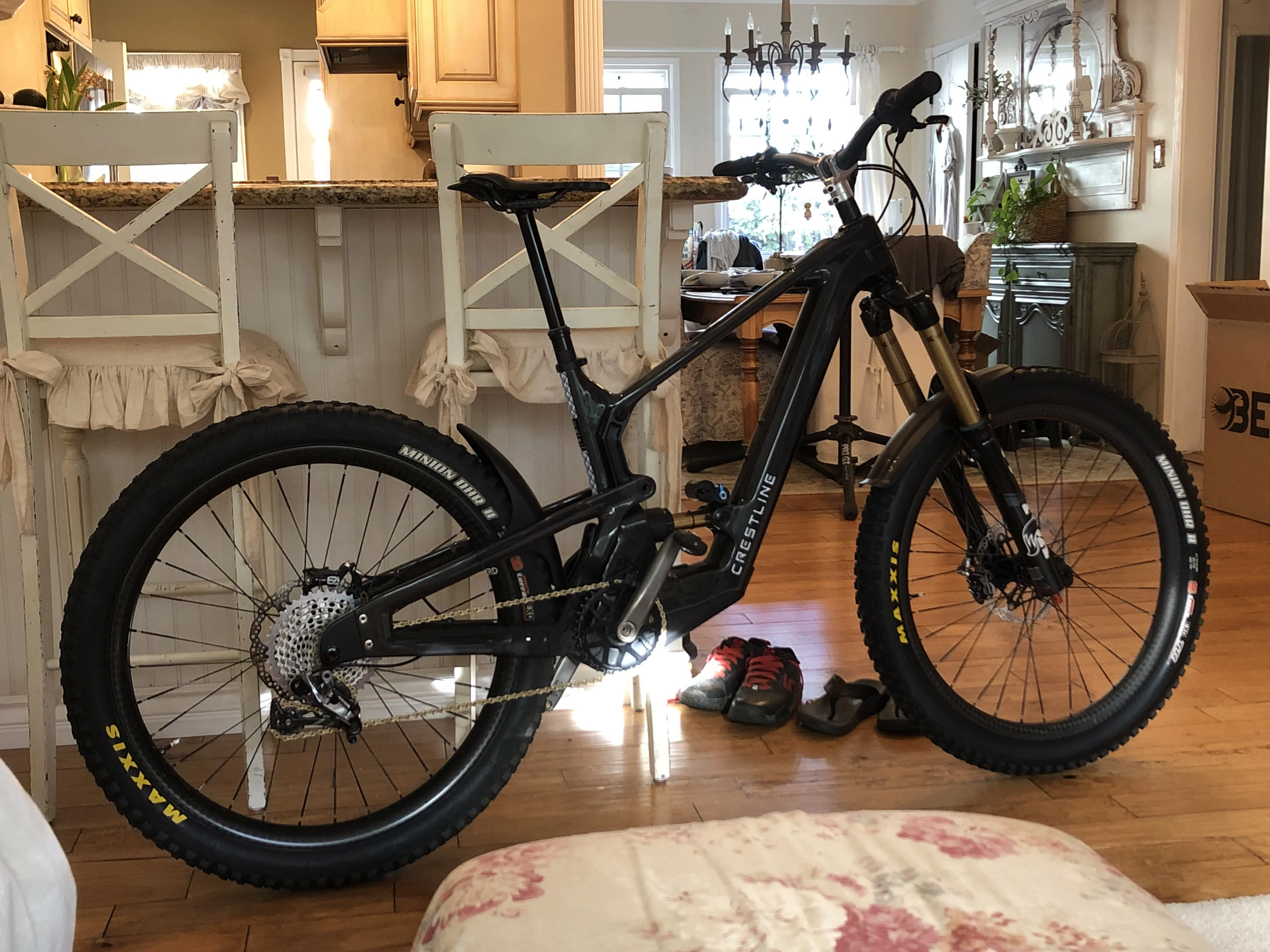

OMG! This bike is so fucking fast! My old bike was a gen 4 Bosch CX Race, which I thought was fast. But it pales in comparison to the Plaid! And mine is 46.5lbs with the 800w battery! I just did a quick rip up and down the street. I’ll take it on its maiden voyage tomorrow to get the shock dialed in.
View attachment 182878View attachment 182879View attachment 182880View attachment 182881
Wow the weight ! And the saddle and stem. Nice build. U mind sharing the build sheet?
Sure thing bro! It’s an RH2 with 450mm dropouts, 800w battery, SRAM 11SP XX1, 10-42 cassette, derailleur and shifter, 160mm Cane Creek e-ewings 3d printed Ti cranks with Ti Speed Play Frog pedals, 180 mm One Up dropper, SQ Labs 612R carbon saddle, Rulezman 15mm stem, Renthal FatBar Lite carbon bar, Hope brakes, Fox 38 fork with MRP Lift V2 damper and Noken air cap with MRP 10mm crown race, (to raise the front so geo remains the same as a mullet) and Float X2 shock. Wheels are LightBikes 40i carbon rims, Berd spokes on Tune hubs with 27.5 x 2.8 DHRII’s front and rear. Lastly Ti and alloy bolts throughout. P.S. I also have a 34t Garbaruk chainring on the way. I’ll hopefully have that by next week.

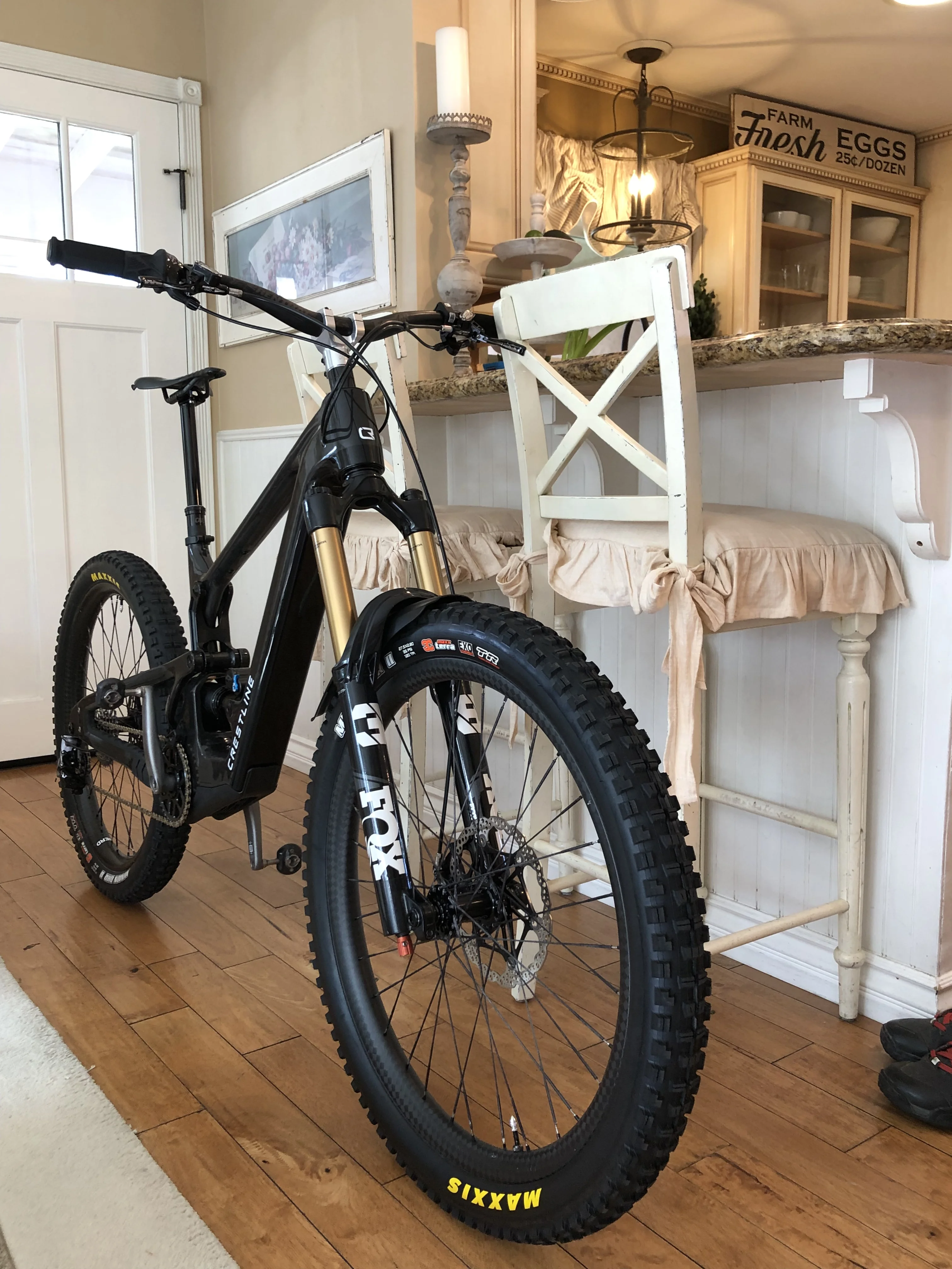

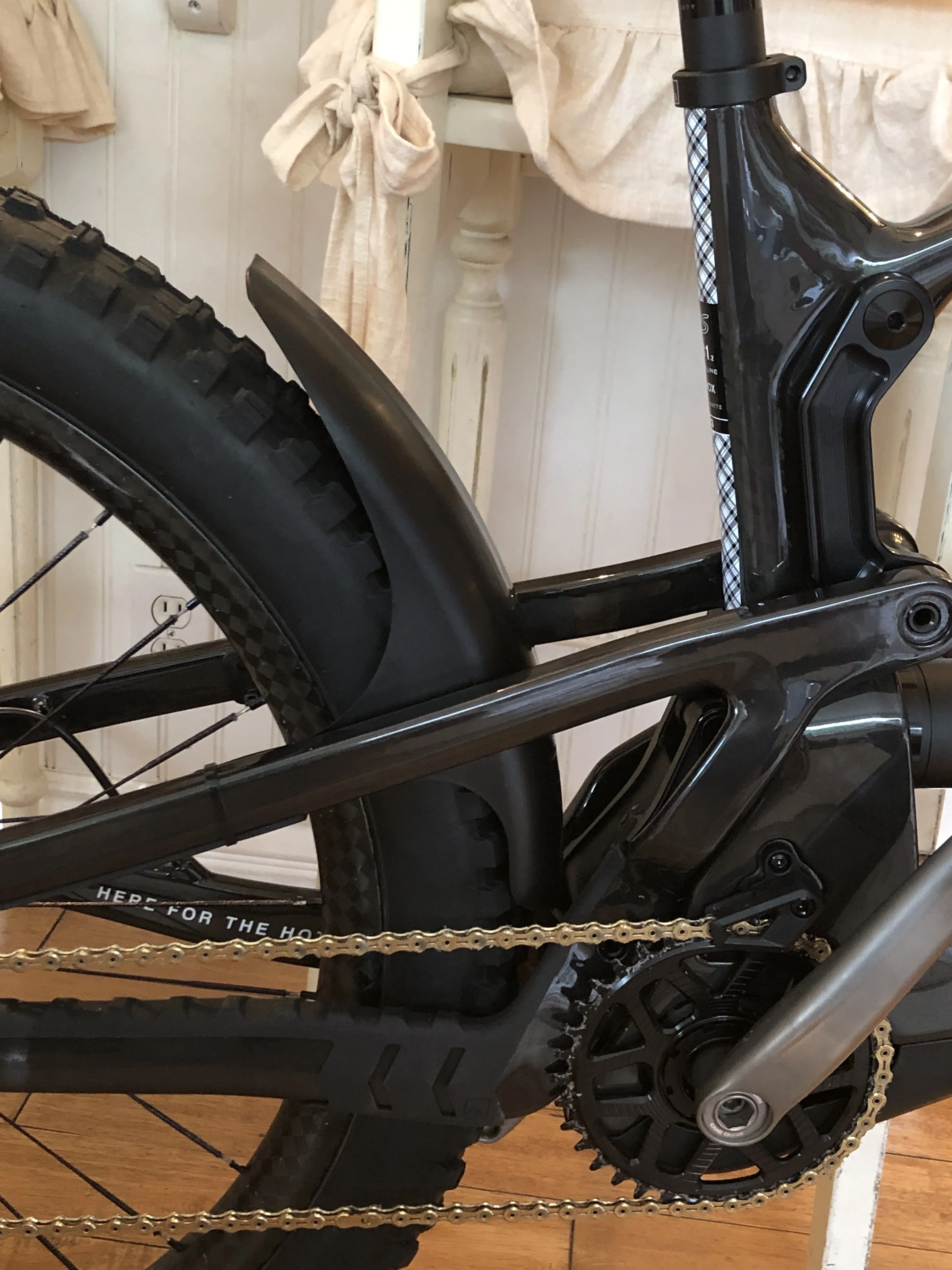

View attachment 182887View attachment 182888
Now that’s a stacked up cockpit
What fender is that? How close are the 2.8 tires to the fender? I wasn't sure if I could run 2.6 (have a few extra e-wilds), so good to see that the newer design has a bit more room than the older rear triangles.
It’s a Mud Hugger fender and there’s tons of clearance. I also have 450 dropouts which gives more clearance as the wheel goes farther back.

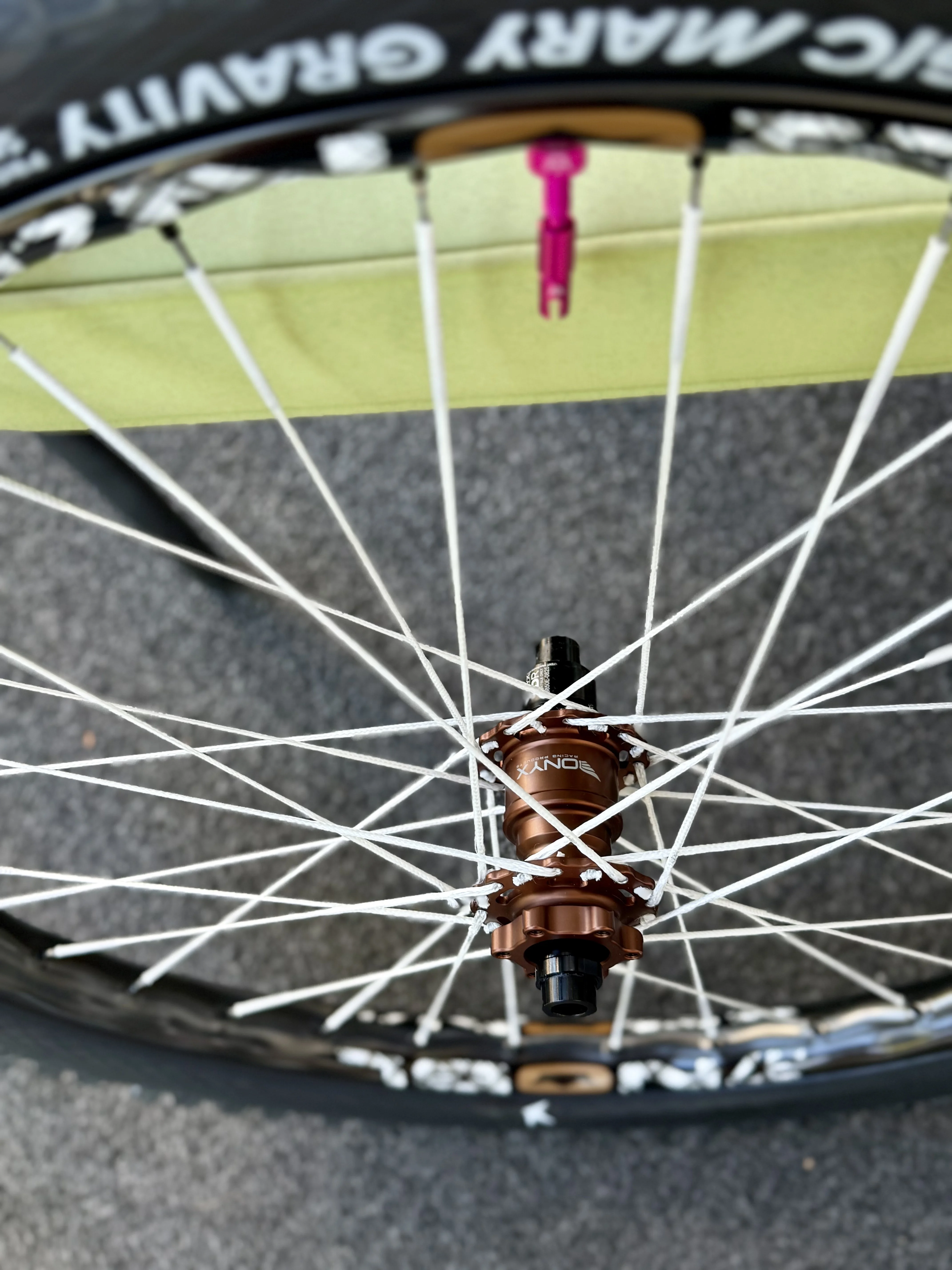

Looks easy peasy with the Avinox SS on centerlock. Have you run Vespers on an eeb before? Any issues? Nobl and Onyx push for classics, but I havent had any issues with my vespers.

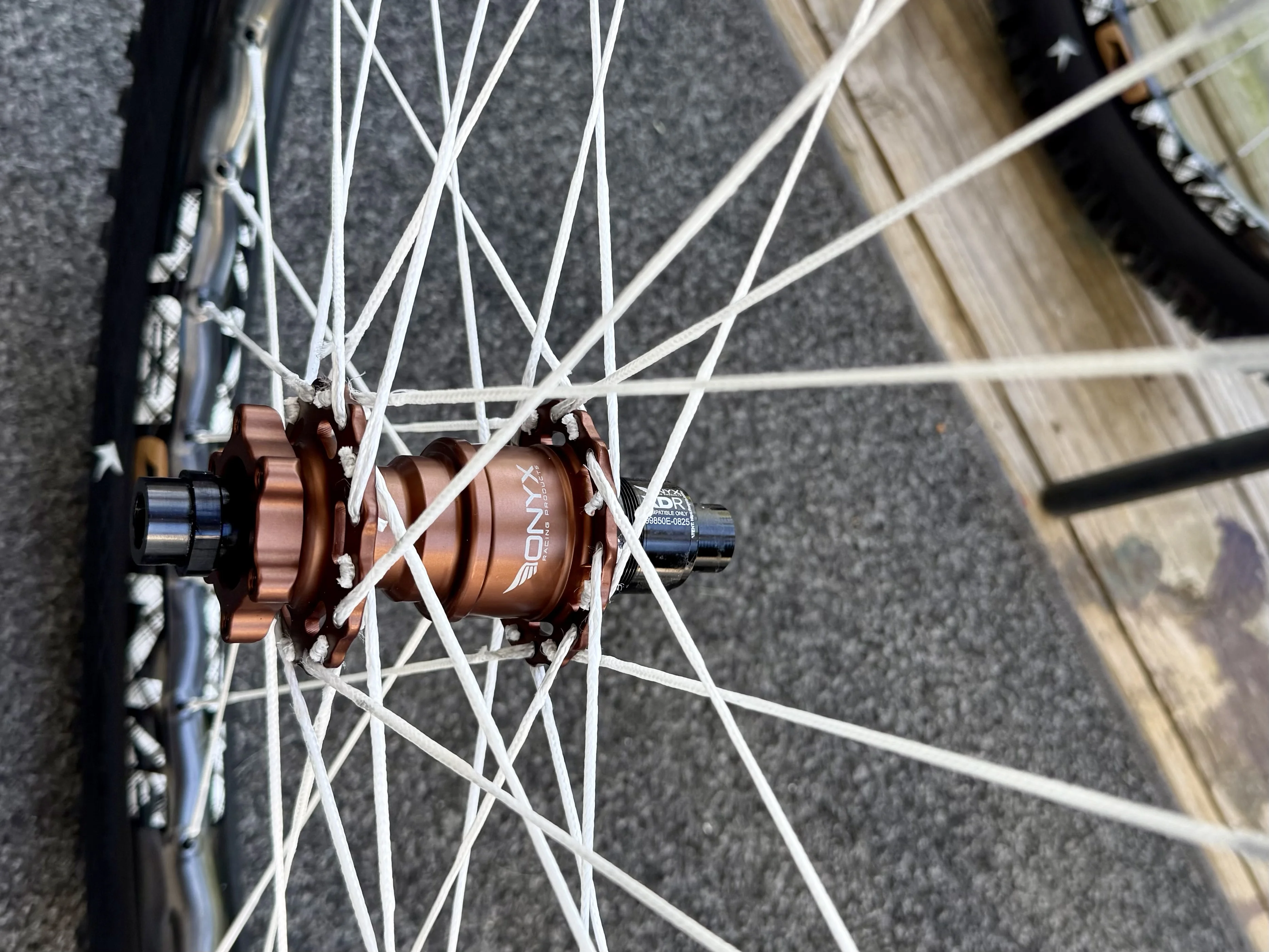

Here are my wheels impatiently waiting for a frame to strap up to lol. Wonder if they will be white for more than the NBD photos 🤣
View attachment 182027View attachment 182028
Are those the heavier duty spokes? Just wondering if above can comment on the feel.
