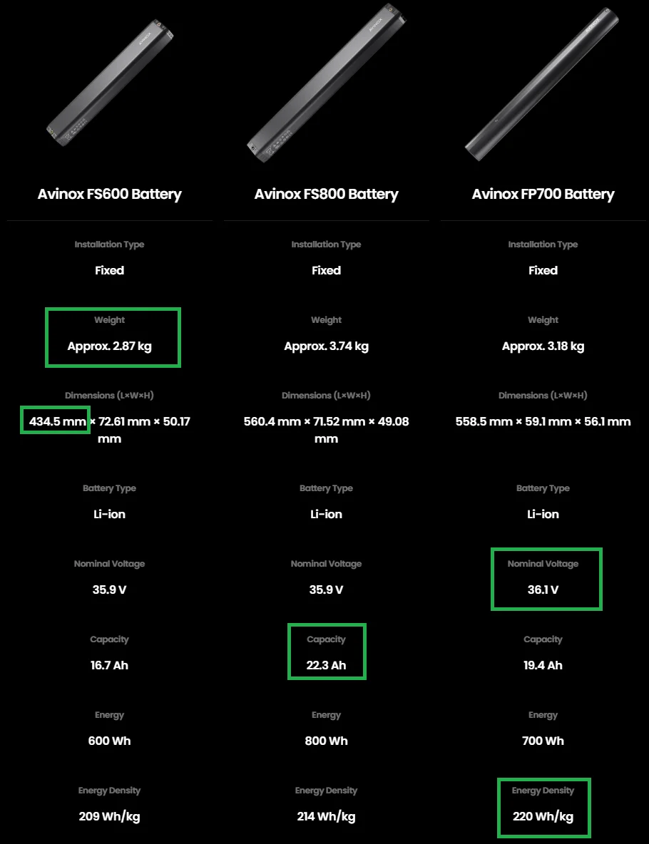

I looked it up on Avinox's site. The FP700 is slightly shorter at 558.5 mm vs 560.4 mm for the FS800. Weight-wise it's closer to the FS600 (2.87 kg) vs FS800 (3.74 kg) at 3.18 kg.
Here is the spec comparison from Avinox.
600wh "Ripper" is the lightest weight and more so the shortest case to keep the weight lowest in the center tube.
700wh "Roundie" is within mm's in length of the 800, and weighs in the mid range. Best energy ratings too for the juice.
800wh "Ranger" is has the best range but the most weight.
Choose the battery that suits your riding style, or fits your frame!
