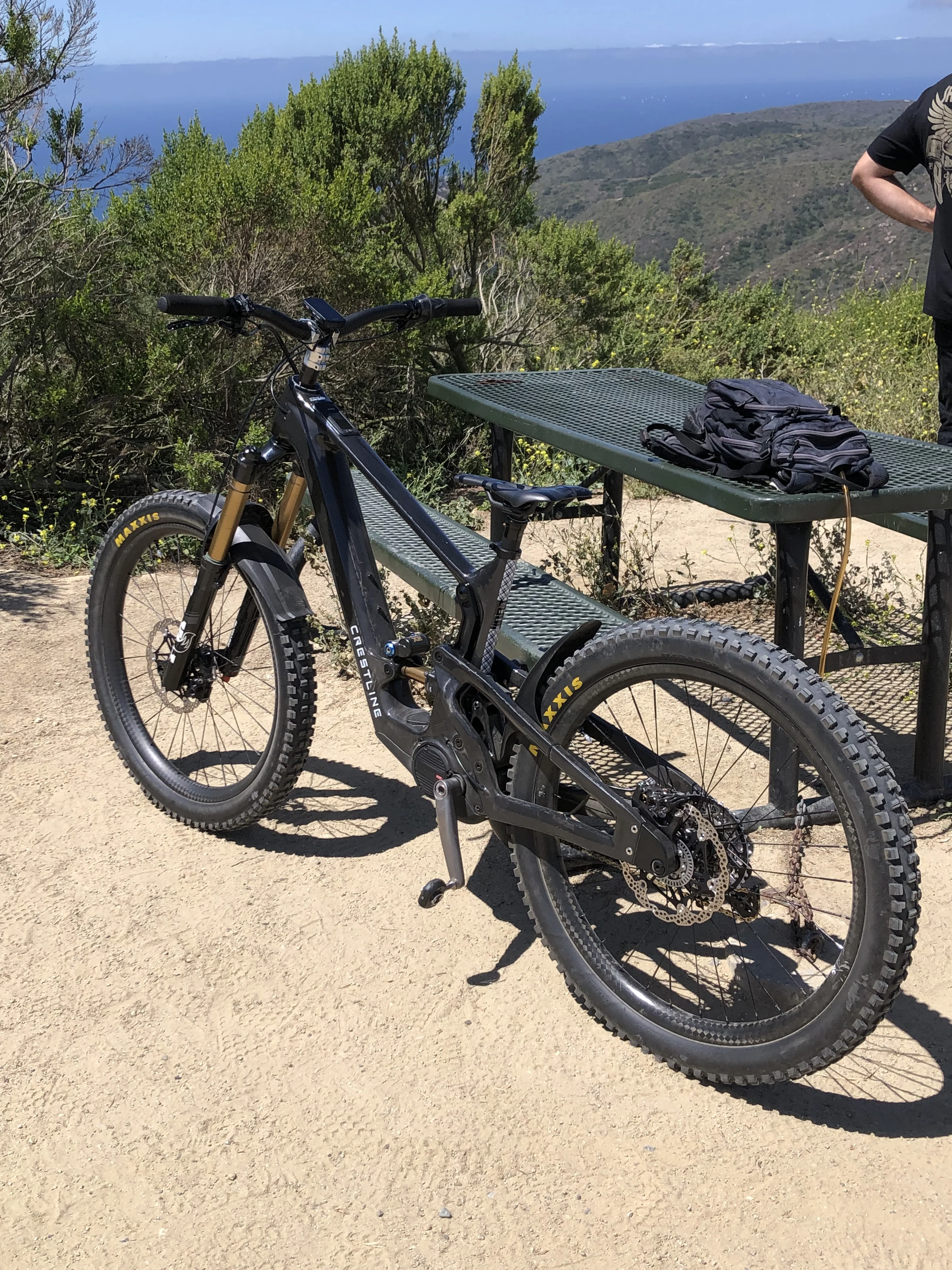

So after the first ride, which was at Aliso Woods in So Cal, (one of my usual spots) I got 28 achievements on Strava and 11 PR’s. Of the 11 pr’s, 6 were top 10 all time and 1 was KOM. All of the DH runs were good, but the trails are blown out, so not ideal for PR’s like good hero dirt after a rain. But I was within about 5 seconds of my pr’s on those trails. And that’s just the first ride, with only 1 click added to my HSC on the shock, so lots of room for improvement. One thing bugging me is the headset feels loose and has some slop in it even though it’s definitely tightened down with the star nut. I might swap it out for a CC Hellbender 70 which I already have brand new. The motor is definitely a hot rod and I love it!
Nice, aliso is local to me too. Was actually out there today on my 181.1. Still need to rap my 181.2. What Trail did you Kom?
Bike looks so good, and with the Onyx hubs I know it sounds good too!
I also run the Time pedals for decades now, they just work forever regardless of mud and lack of maintenance. (y)
How do you like the Shredda's do these get you up some hairy loose techy climbs that other tires would normally slip away on? I have a few super steep bits on my trails that seem to need something like the Shredda to make it up.
Oh yeah, I just ordered the new Tacky Chan radials for a bit more grip too!
The chan will for sure be the next replacement. I took the shreddas off for magic marys. Too many loose leaves on my local trails. Not sure when I'll get to run them. Might do the front shredda on the rear soon just to make use of them.
