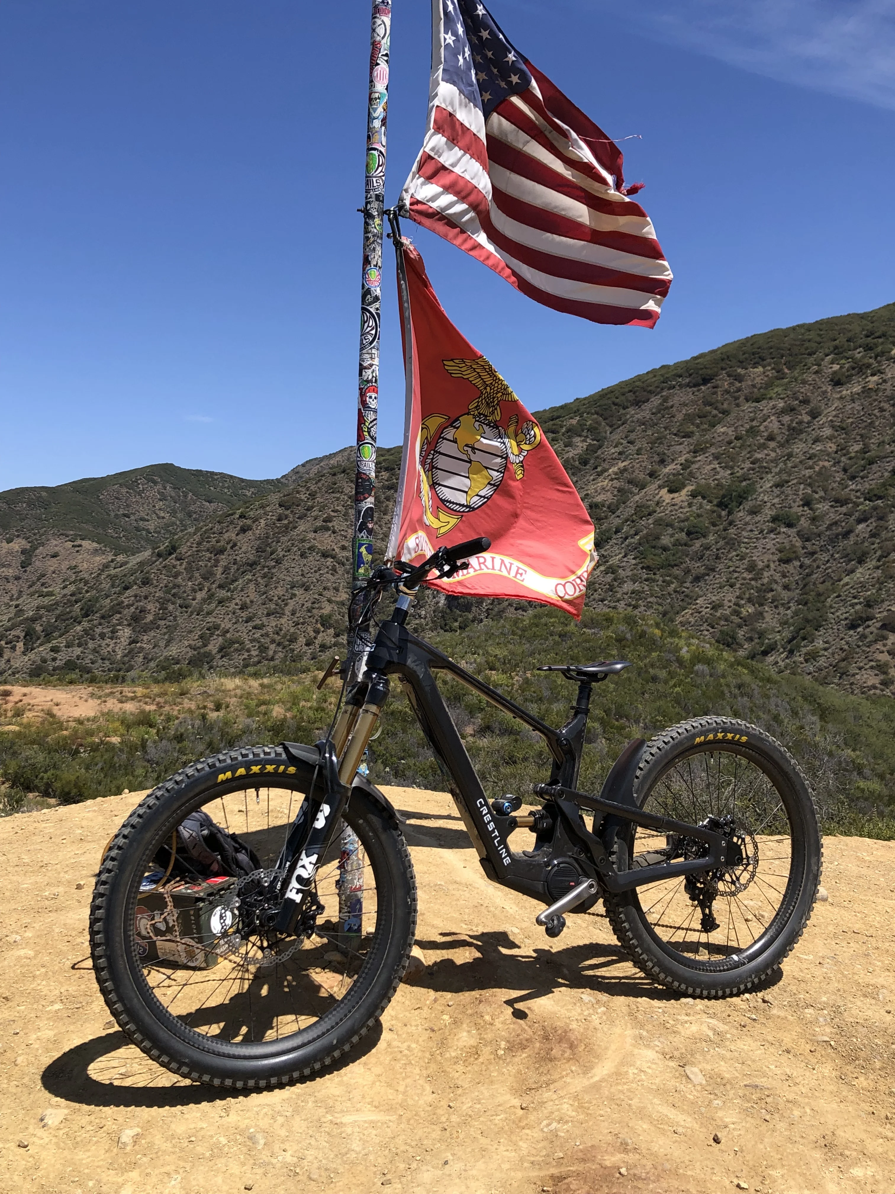

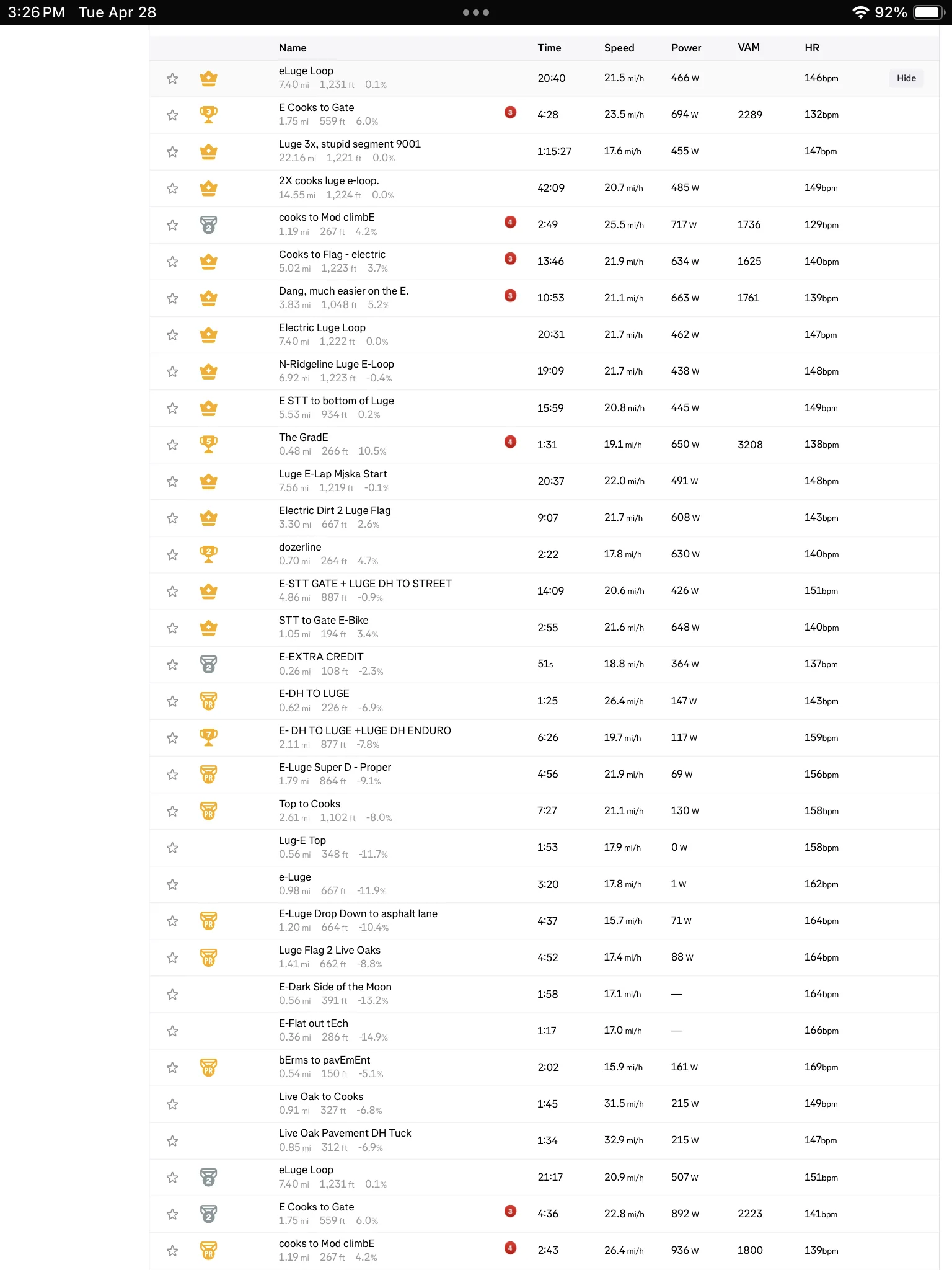

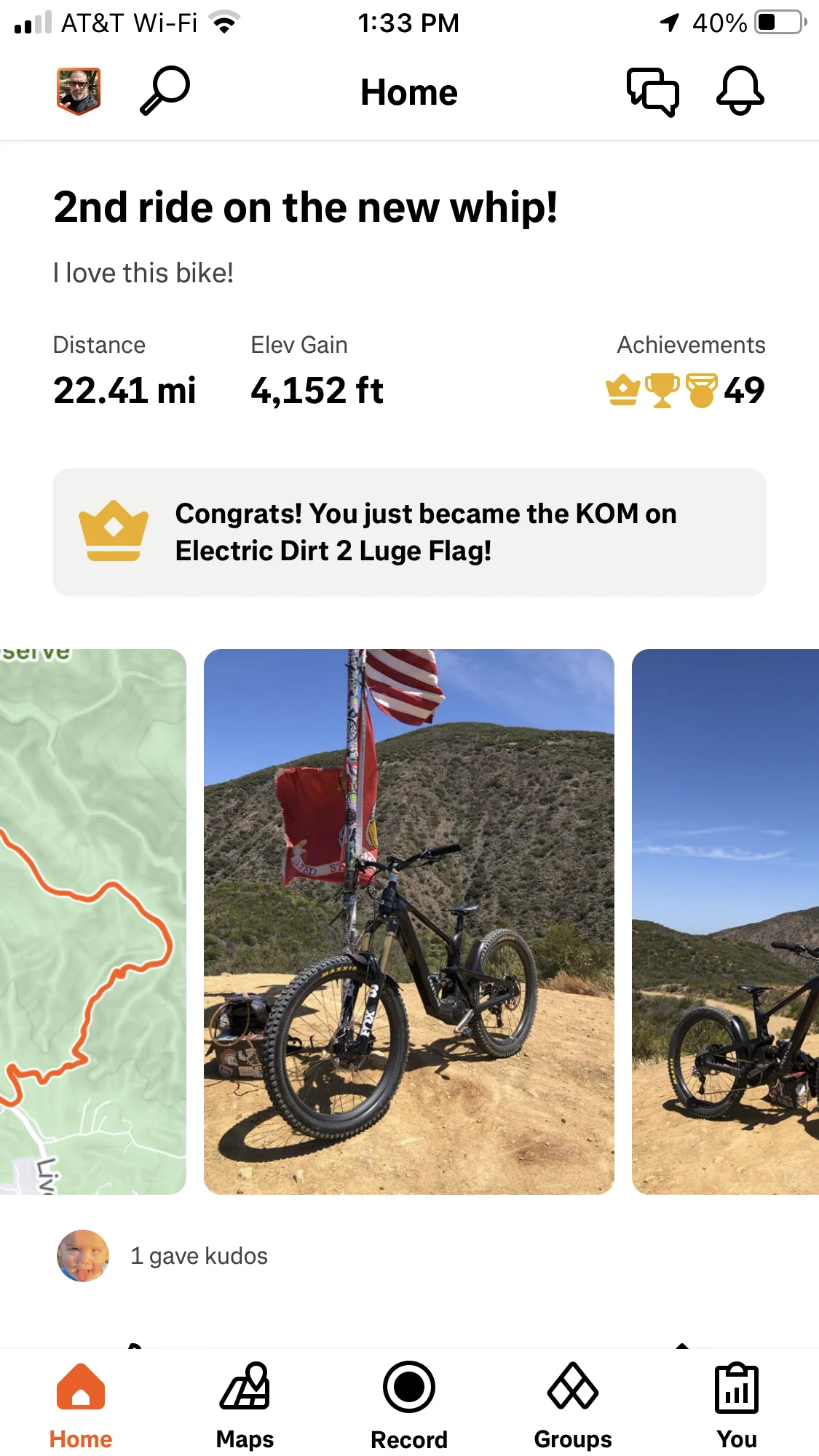

So did my second ride today. 3 laps of the Luge in OC. I decided to put the hammer down to see what it could do. It’s just crazy good. I ended up with 5% battery left and it slowed considerably on the 3rd lap. Probably thermal overload. So I put it in auto once that happened. Still awesome ride. The bike was really really good. 49 achievements and 12 KOM’s!
My Strava ride
So did my second ride today. 3 laps of the Luge in OC. I decided to put the hammer down to see what it could do. It’s just crazy good. I ended up with 5% battery left and it slowed considerably on the 3rd lap. Probably thermal overload. So I put it in auto once that happened. Still awesome ride. The bike was really really good. 49 achievements and 11 KOM’s!

Once below 10%ish the best assist you'll get is auto no matter what mode you set it in.
My Strava ride
Damn you're ripping! nice times!

It’s always rideable, but best conditions are like 2 days after a rain. Otherwise even on the hot days, just get an early start and you’ll be good. 👍🏼
Thanks brother! I figured I might have a couple good ones, but I had no idea it would be 12! The bike just rips though!
Three rides on the rig, and it rips. Top 5 Strava cups on classic DHs here in Marin... shaving off 40 seconds from my previous best times on 7 minute runs. Absolutely awesome bike! So happy!

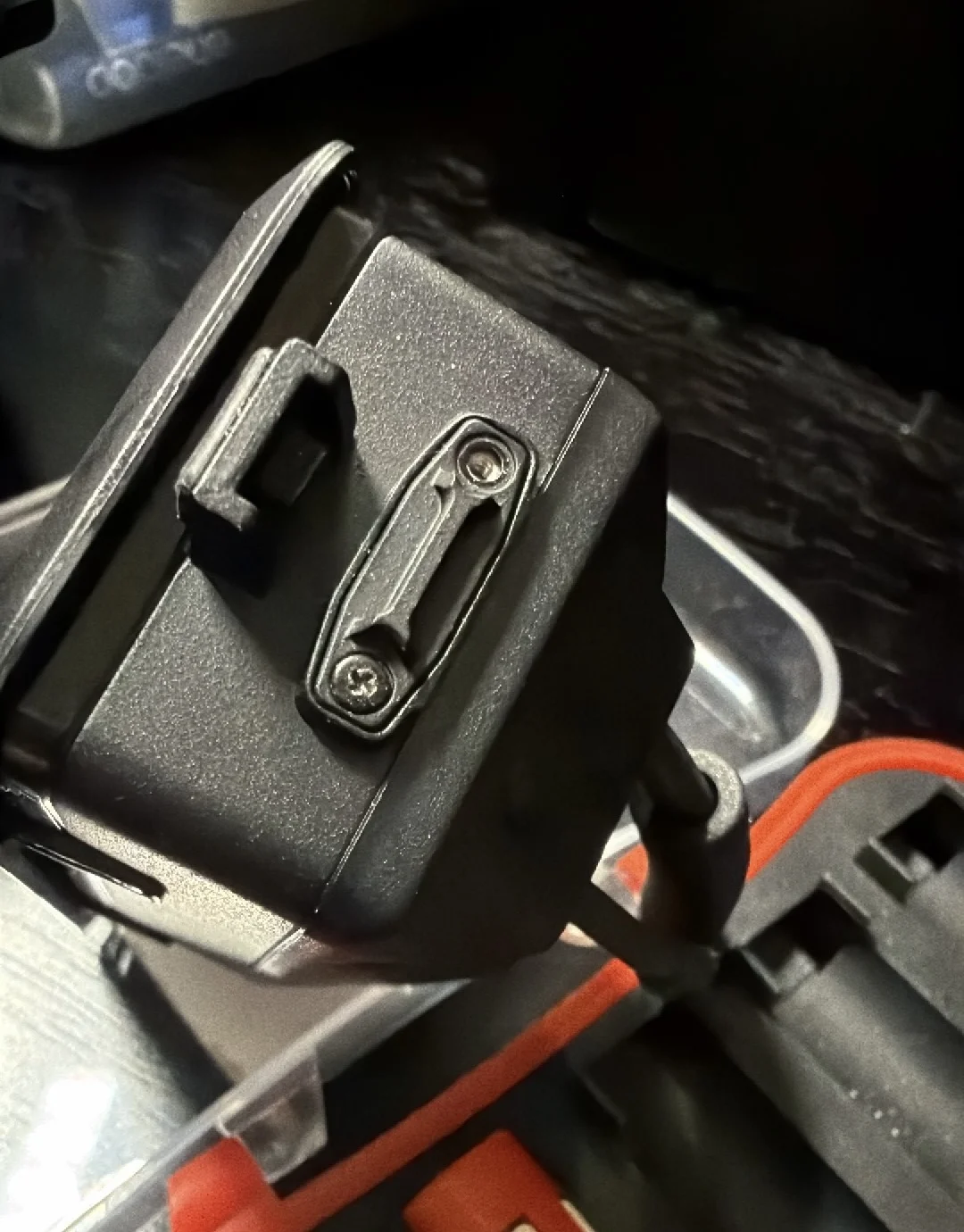

Be careful when trying to get the sim slot cover off the display. They use locktite and those screws are tiny. One of mine just won’t budge and I stripped the head. So pissed. Gonna take it to a mobile phone repair place and see if they can extract the screw.
