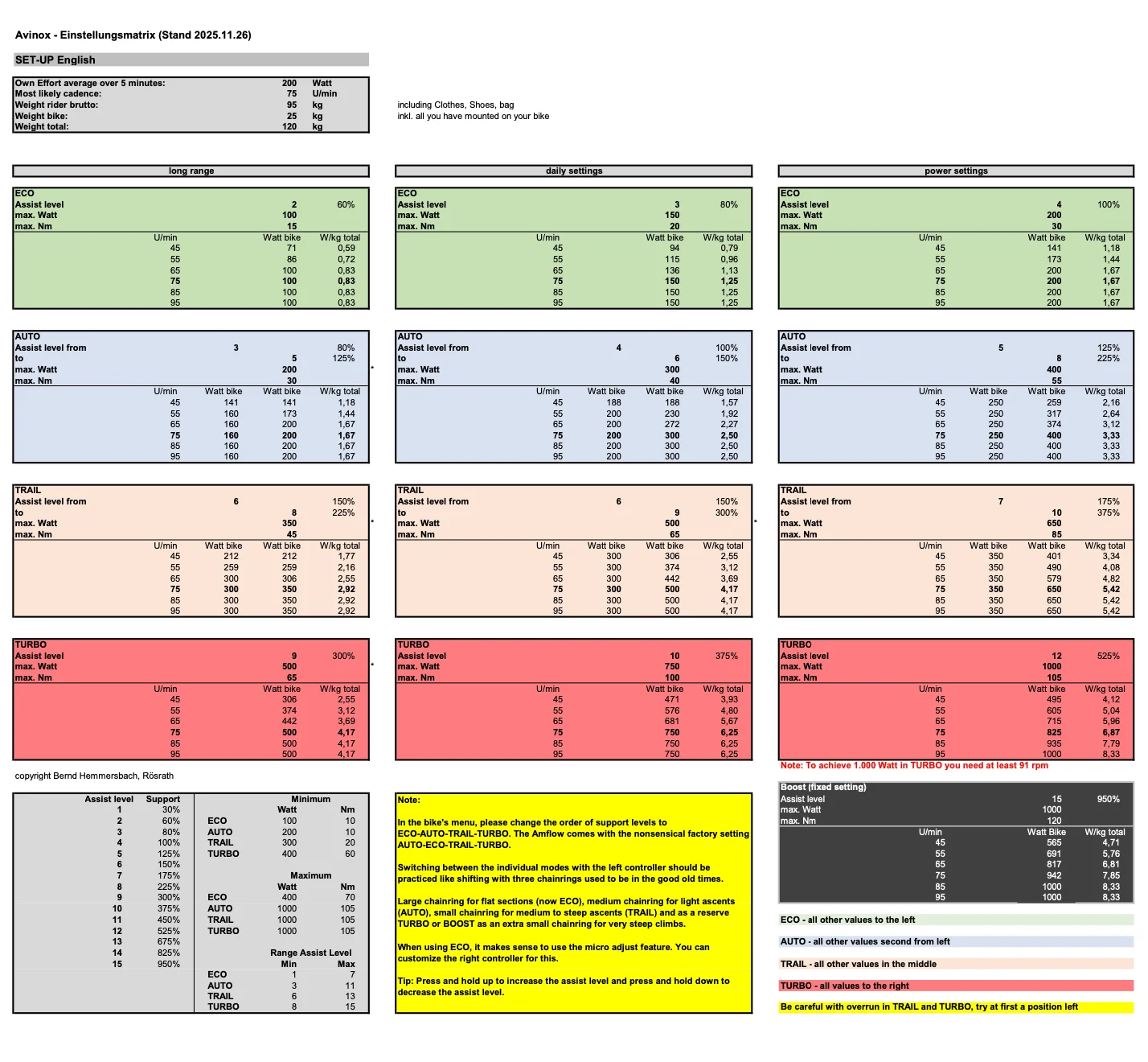

Do you have an actual link to the spread sheet or have the spread sheet you can email? I don't Facebook.
this is for a rider weighing 95kg with full kit. A little heavy for me but close enough. We're not building rocket ships here.

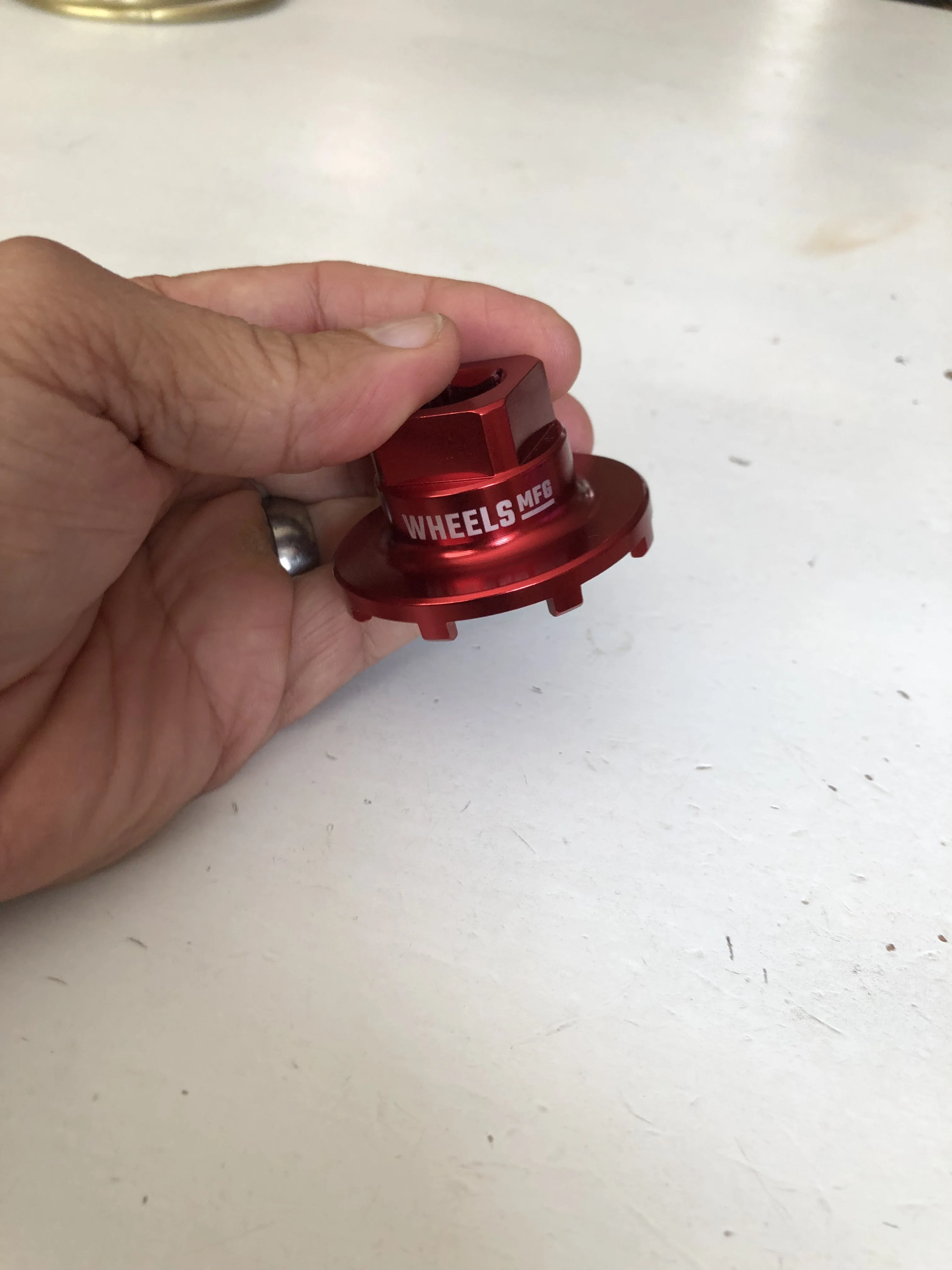

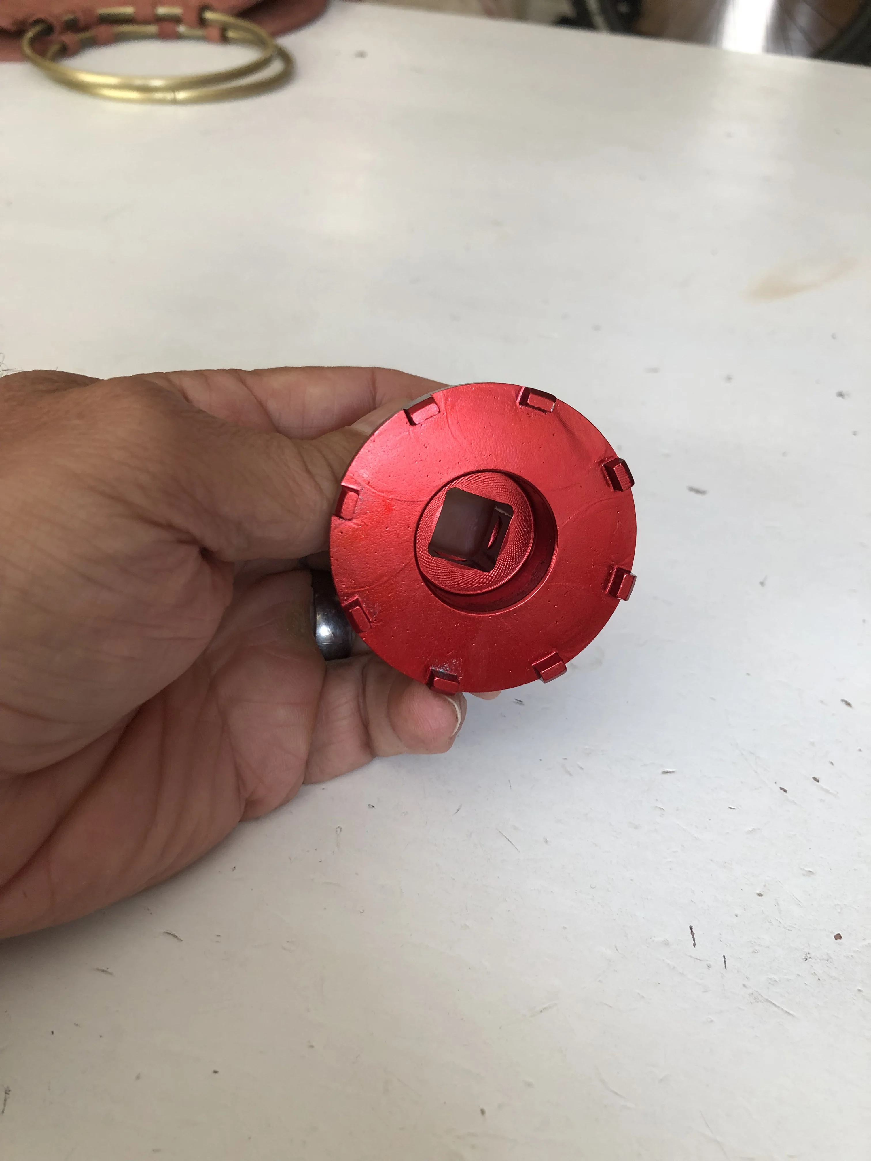

So who has taken off the chain ring and what kind of tool is needed? Where to get one?
Park LRT 1?
That looks like it but I can’t find dimensions to make sure. Says it’s for Bosch Gen2.
Only one advertised as specifically for Avinox is the Wheels version but they are out of stock.
Thanks for posting the sheet. I used the daily settings exactly as they are here and just got back from riding. It feels pretty good like this, I stuck to trail mode the whole ride. The assistance felt pretty natural, much more balanced than the defaults. I ended up doing 25mi and 4700ft climbing. The bike was at 3% when I got back to the car, I'm definitely cooked. I'm calling this a success. (y)

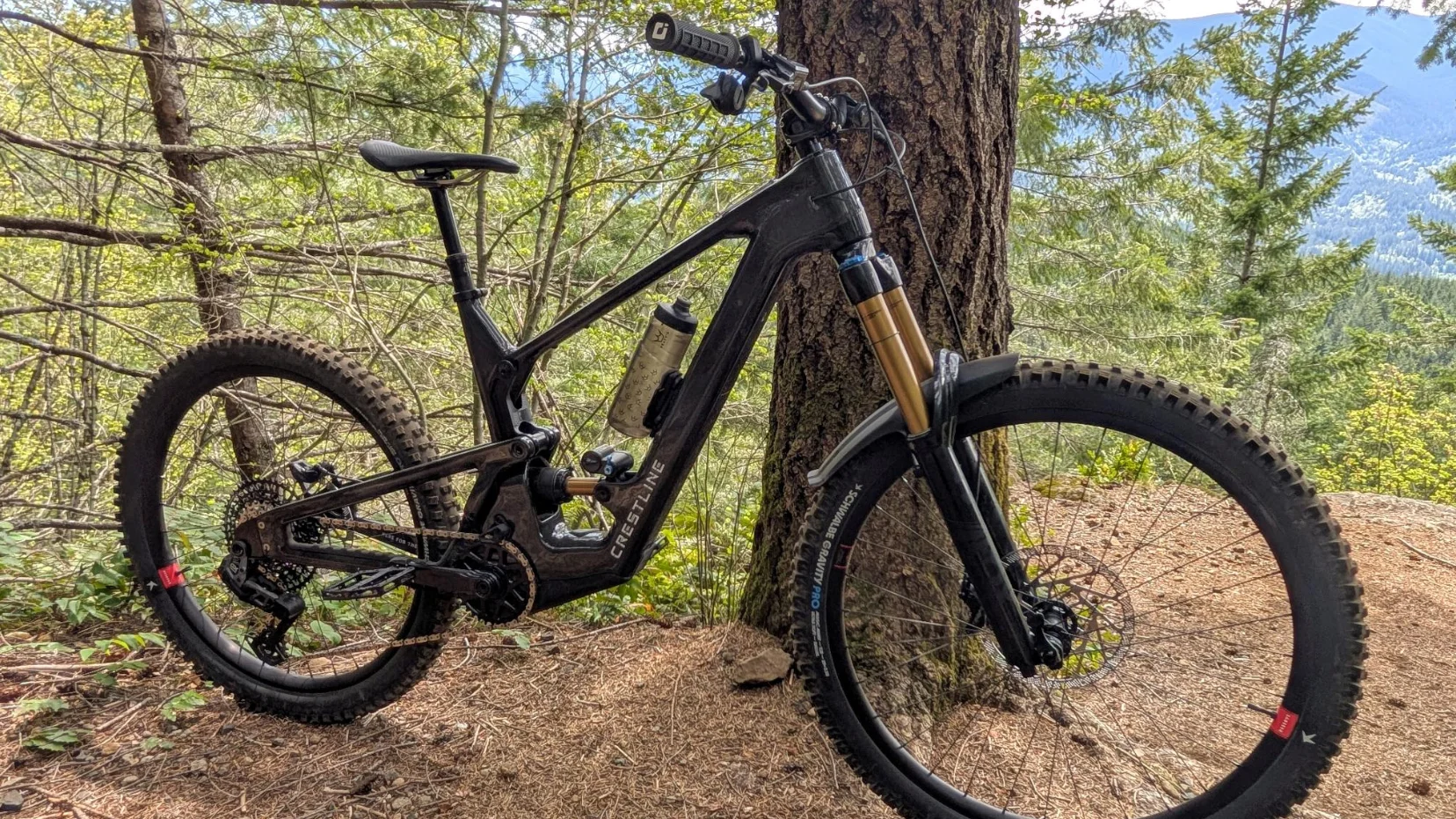

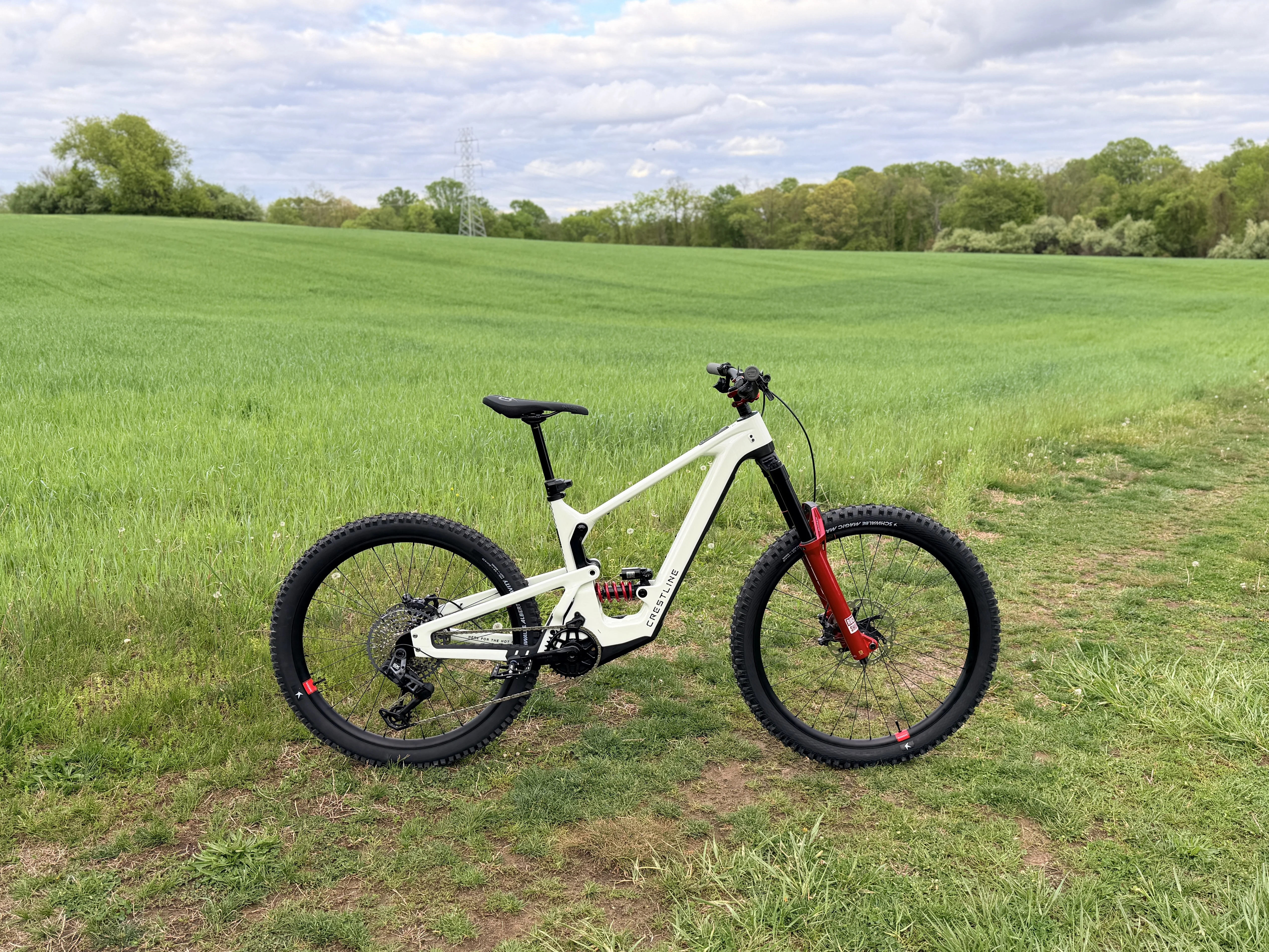

Had my bike pretty much done since last week but my reverb dropper was still not delivered and I was technically not cleared by my spine surgeon to ride singletrack….. until today! Been waiting patiently to say this… #21 checking in!

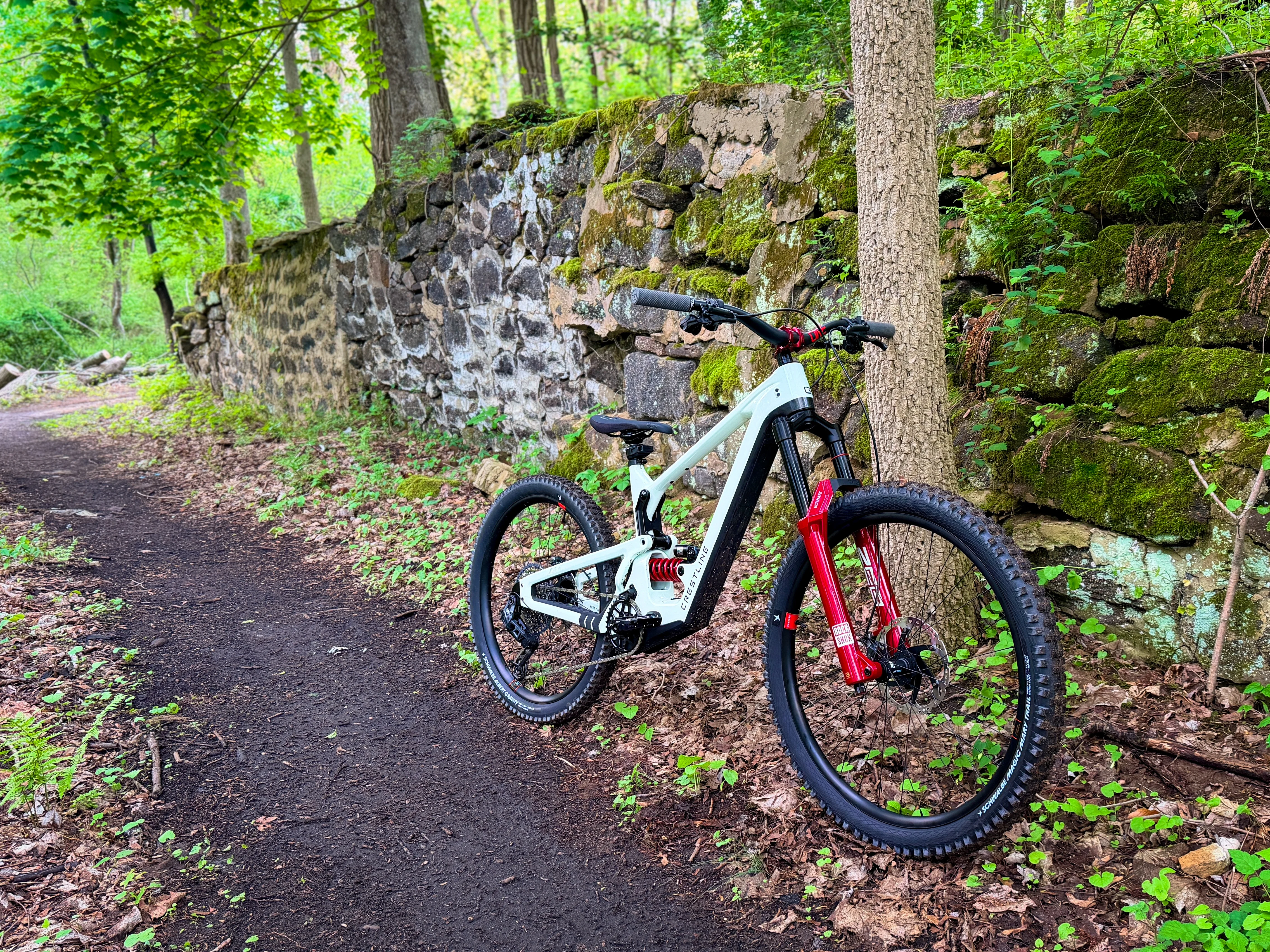

Dammit I should have went red coil. Just ordered a lighter rate in black. I hate the red zeb but it looks good here with red coil and reserves!
At least it’s not $120 like the fox sls. I think I paid like $23 for the coil.
Yeah they’re pretty cheap! I may go red soon after seeing your bike. I have the reserves too. That’s a good look. Right now my zeb just stands out so much.
I was at like 20% sag without gear on with the stock 500 it came with. Ordered 450 which still might be too much.
