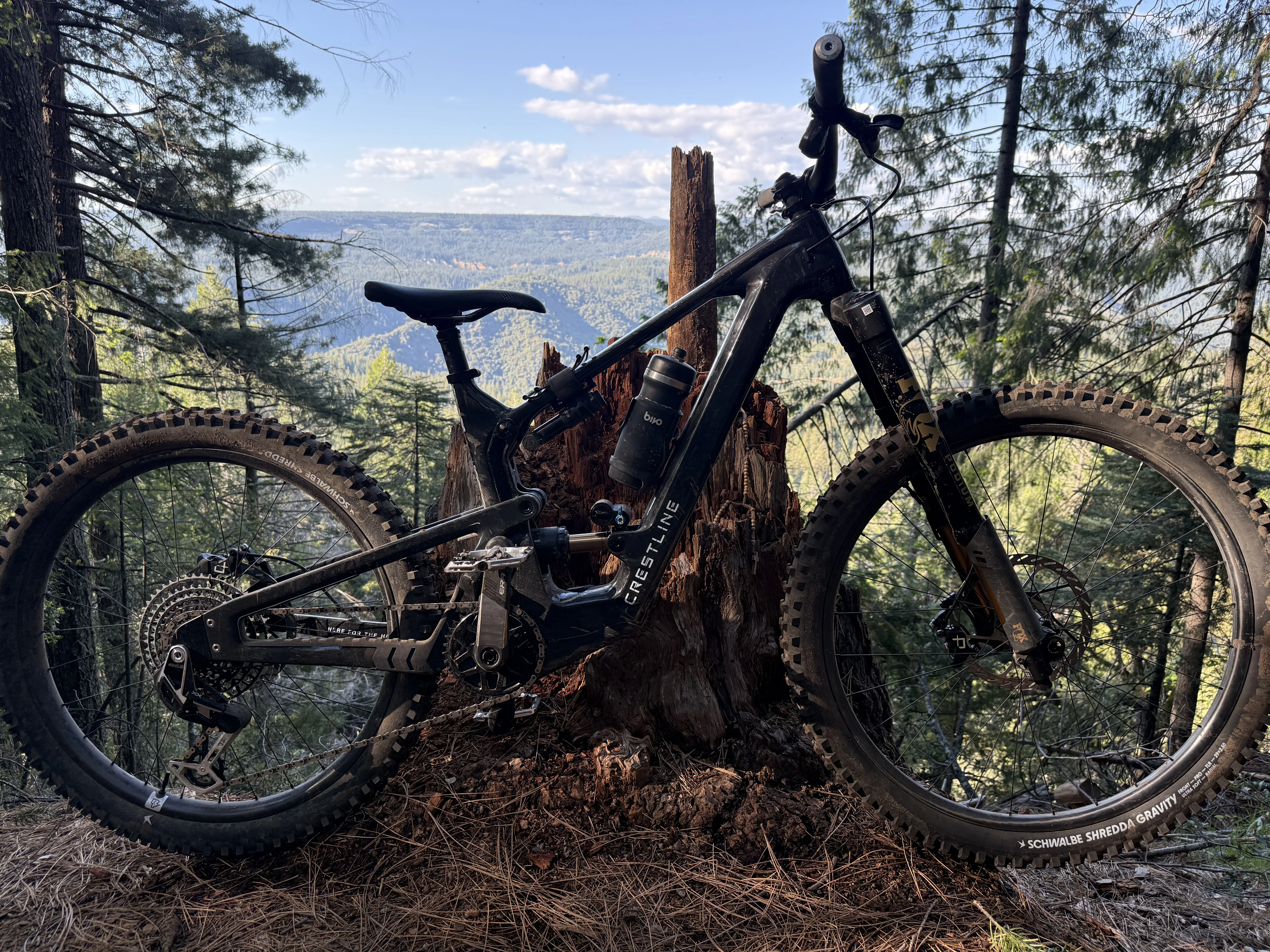

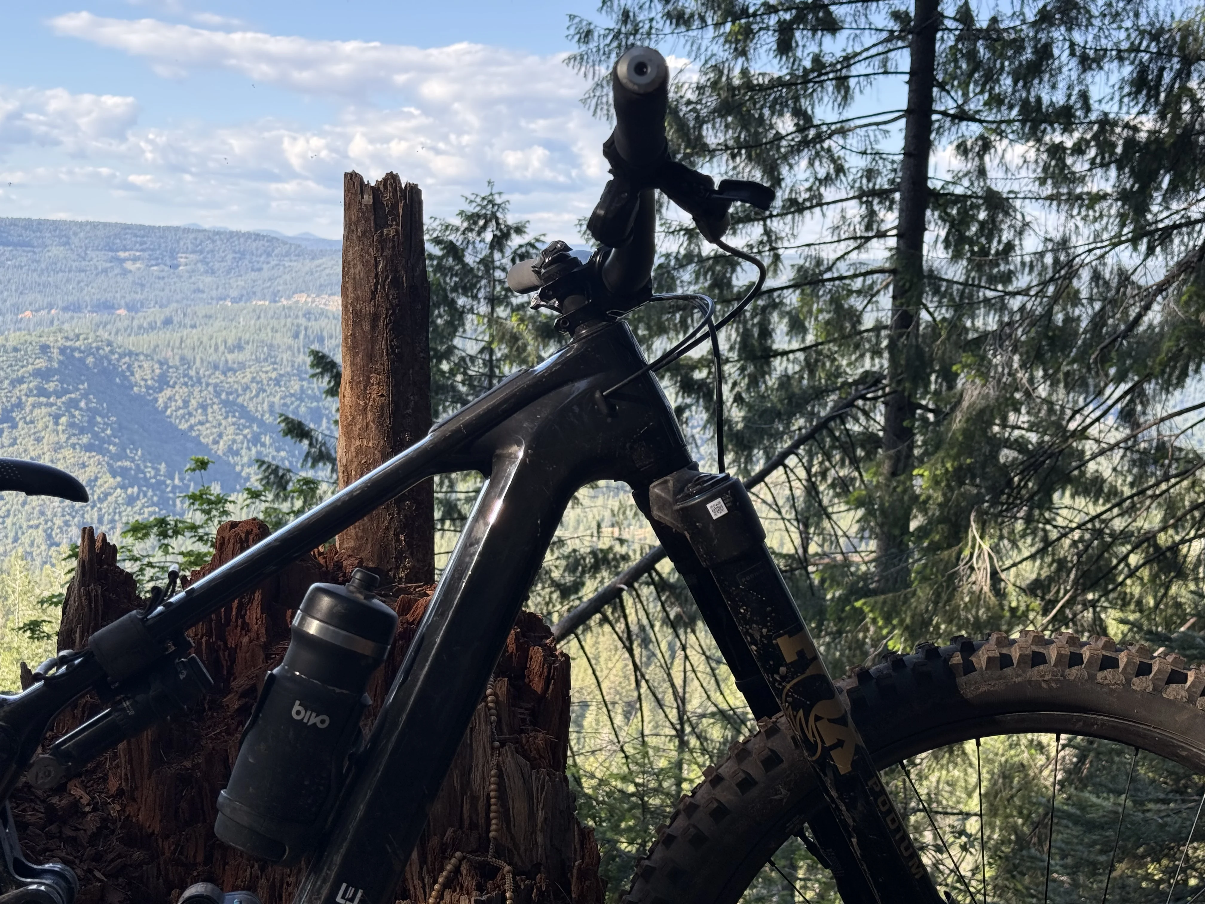

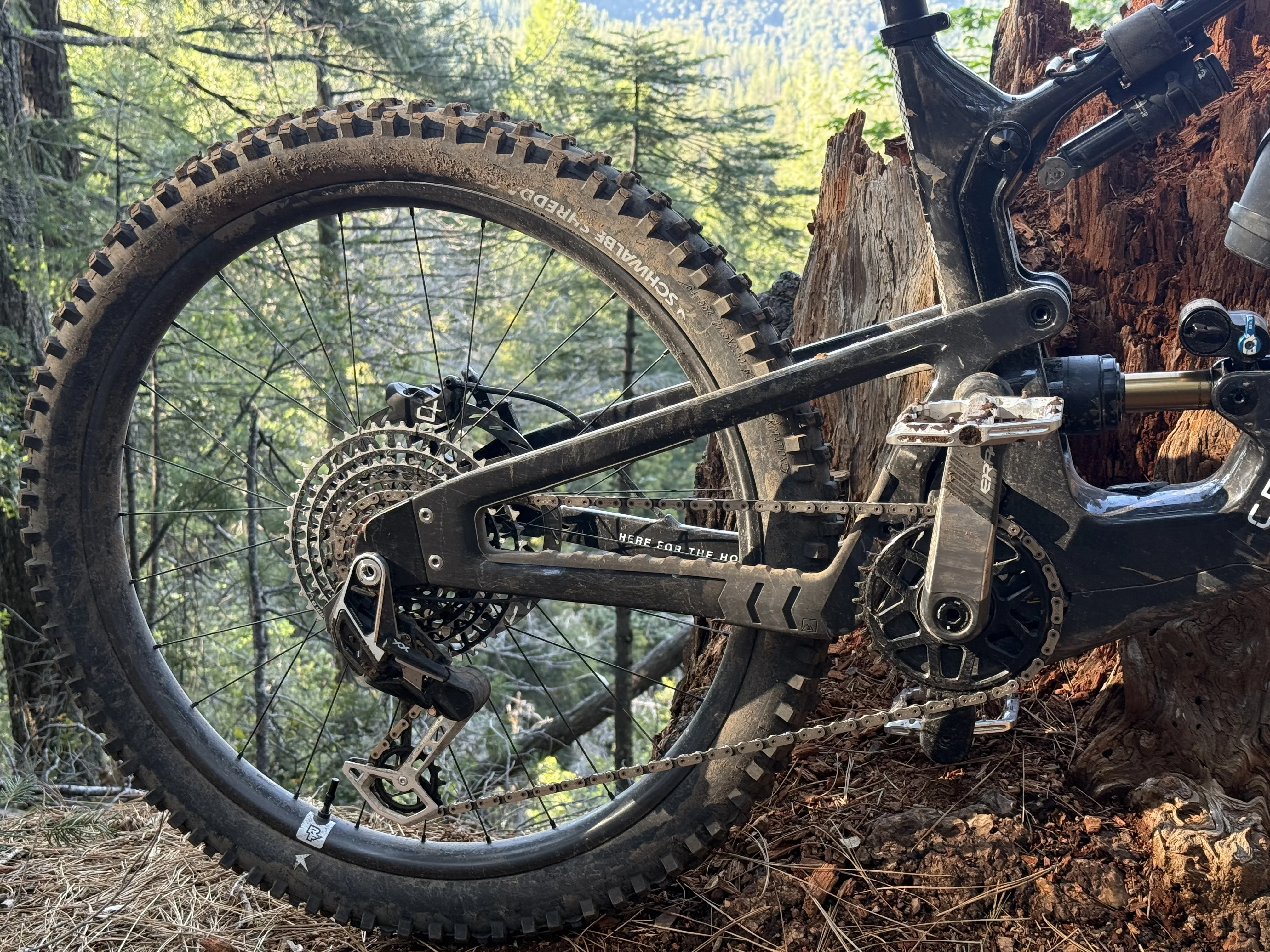

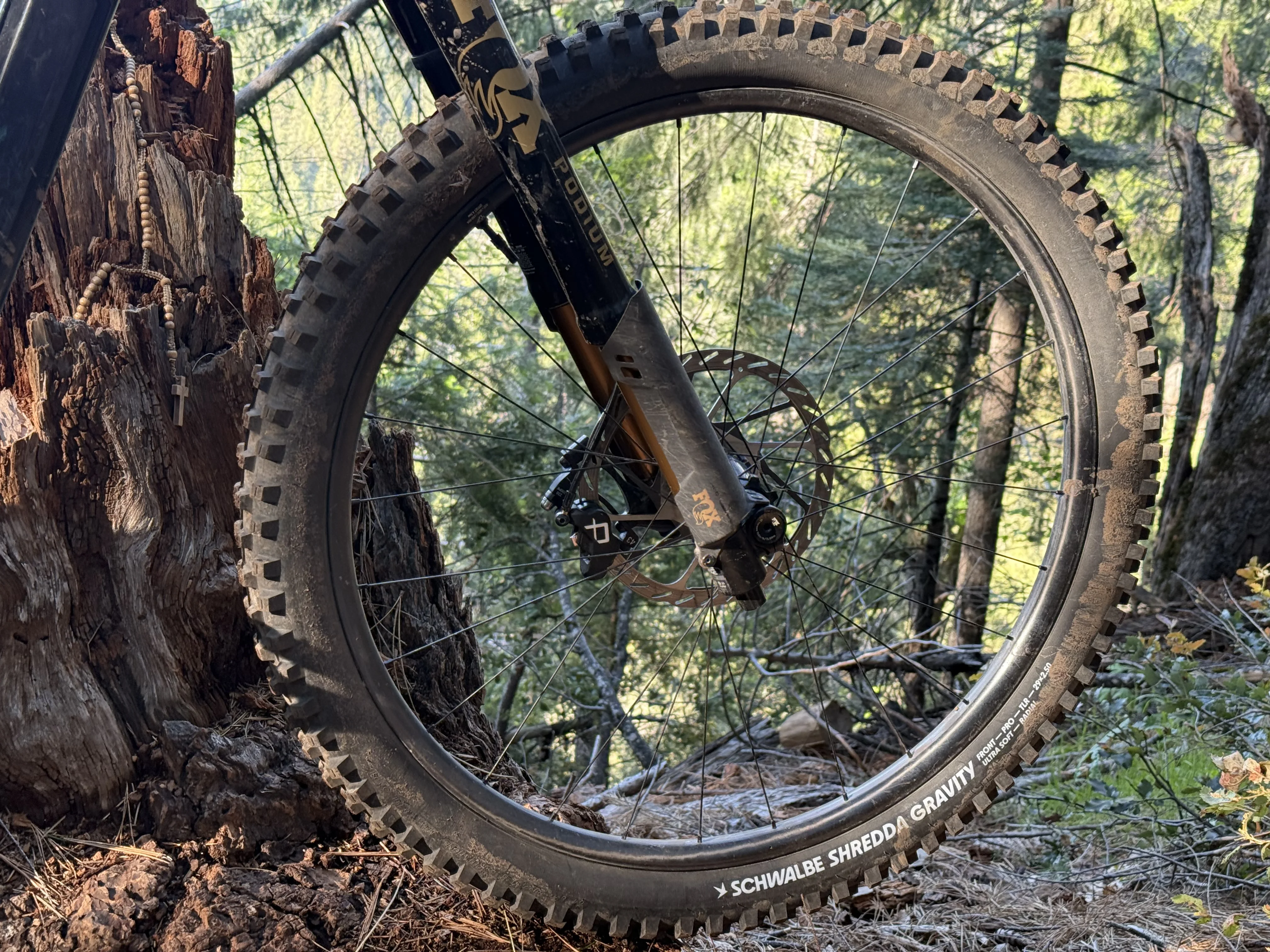

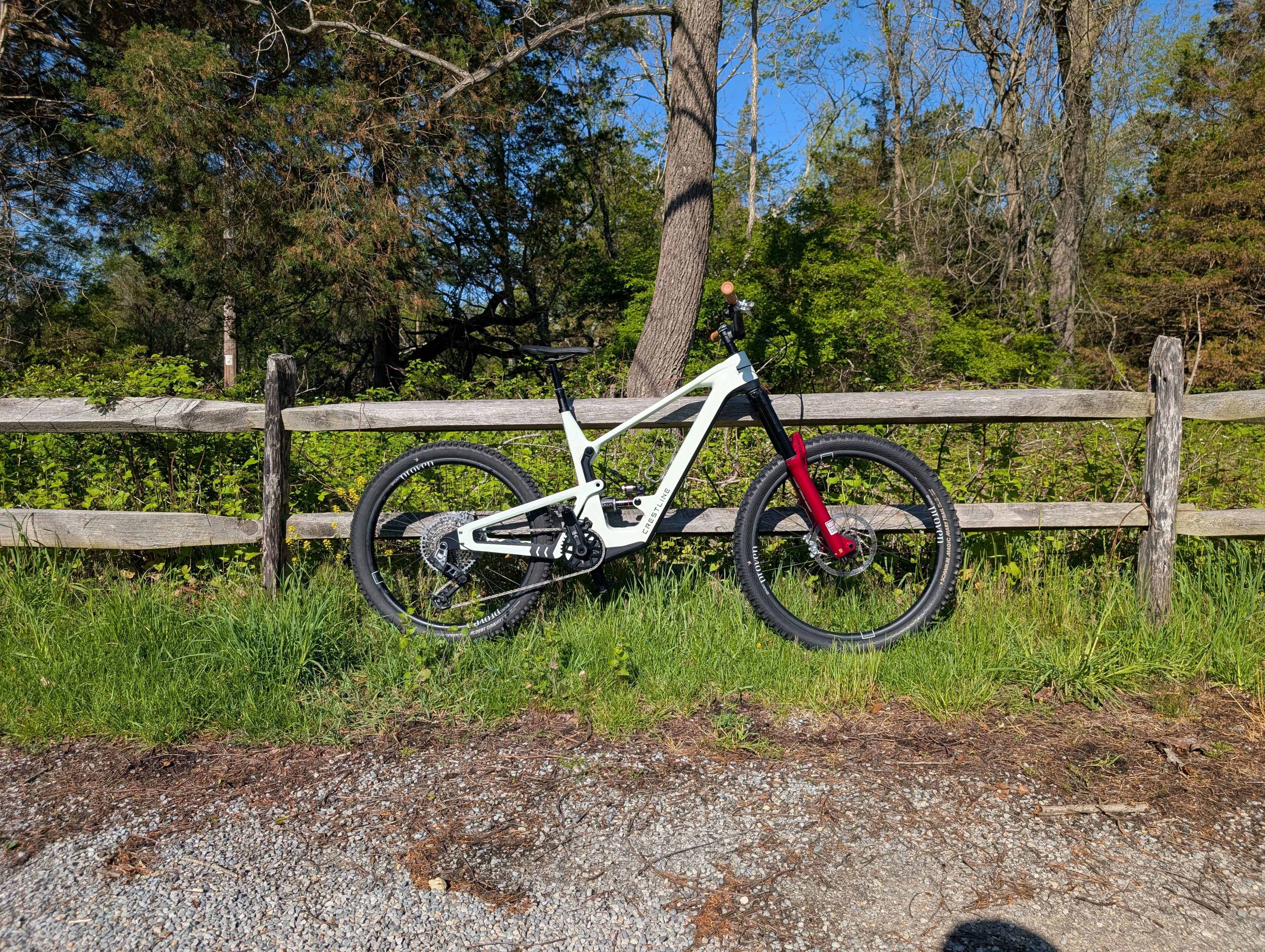

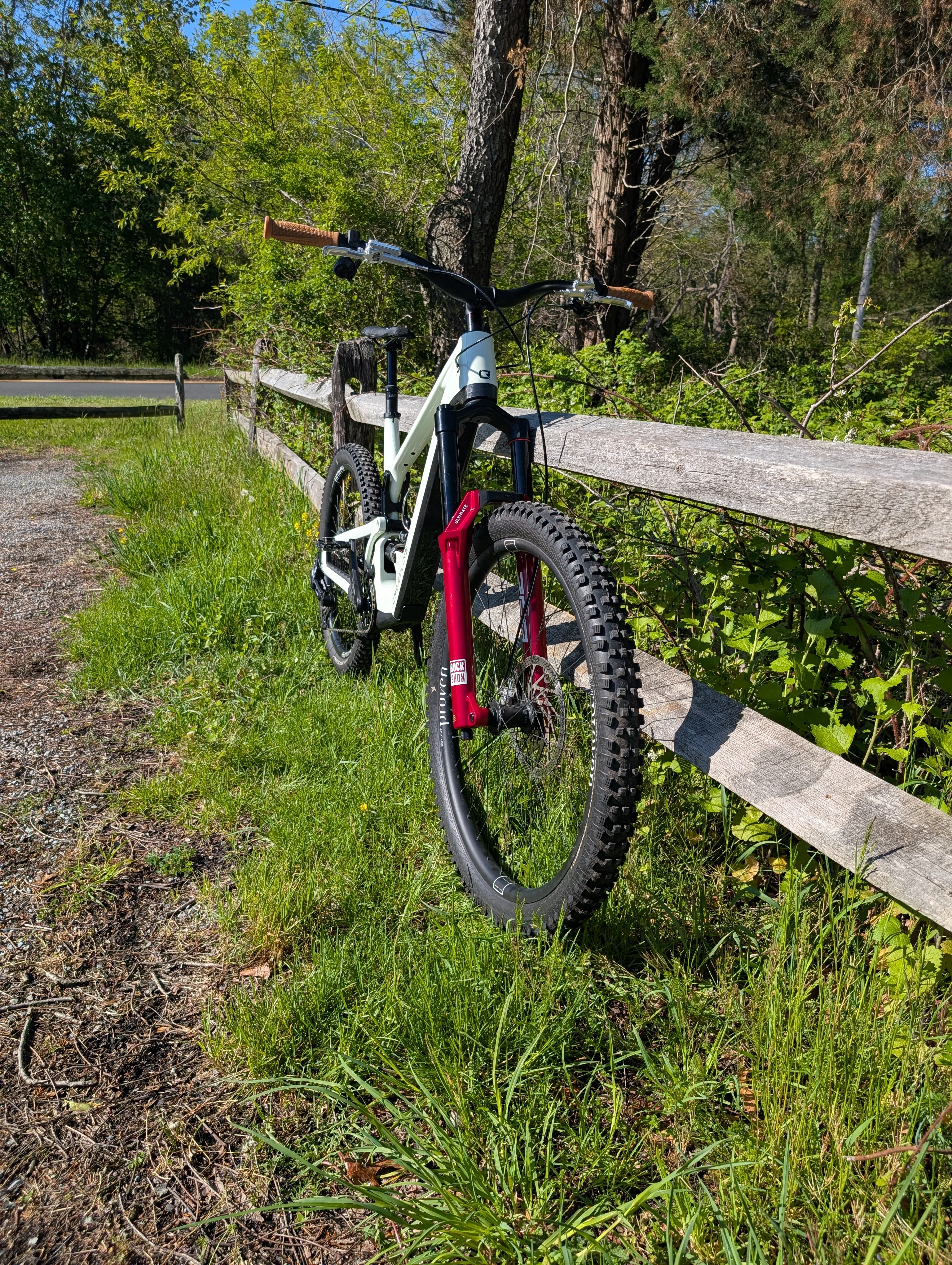

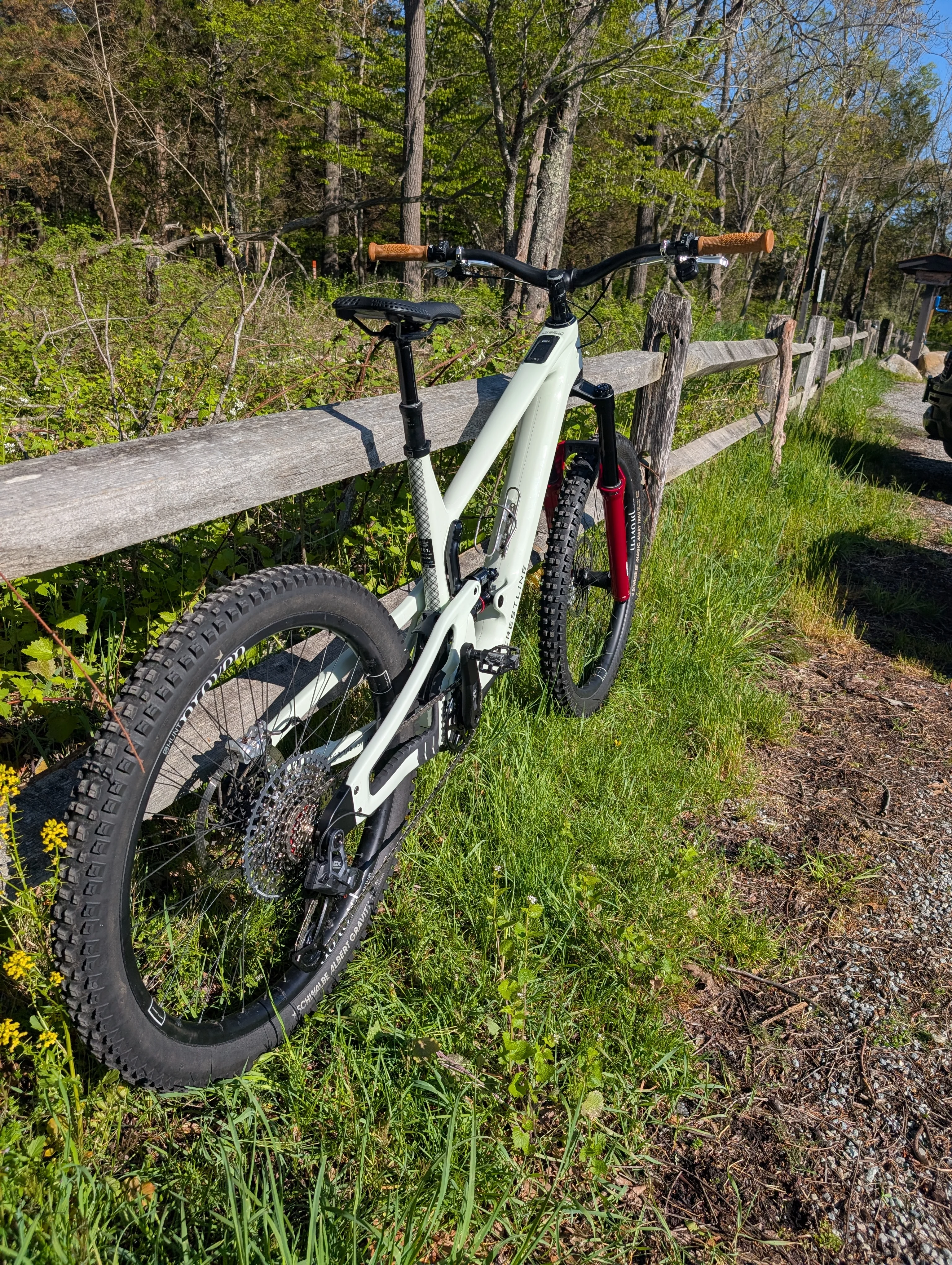

6th ride today. I’ve made almost no adjustments. I went with race face era wheels, bars, cranks, and turbine stem. Plus 5 headset and 170 podium. DominionT4 brakes with 220 rotors. 450 stays. RH2. 180 one up post. Shreddas! I may try longer stays and taller bars in the future. 51lb.

Nice set-up....Getting ready to start building mine...I also went with podium fork...How are you liking it? I was a little concerned with the 180mm rear and 170 front but. 10mm really a big deal? Thx

It’s really good. With the external headset cup (of the offset headset), the bike seems to have a great ride height. At first I thought about limiting the shock stroke to match the fork, but then I realized that with the same eye to eye it would make no difference and I could adjust the sag if needed. Long story it rides great with the stock shock in LT setting and 170 podium. …So good.

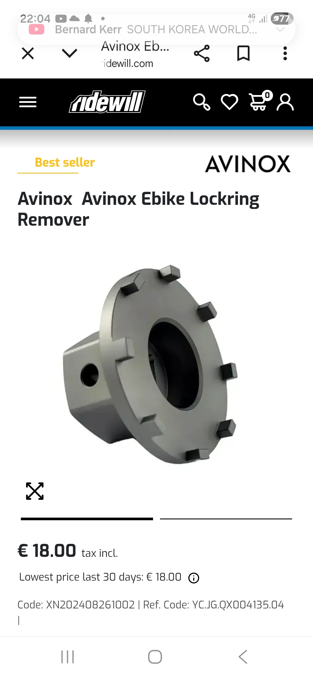

The wrap on my bike has started... but I need to remove the chainring so the front drive side of the front triangle can be done. Hopefully my local shop has one and will let me borrow it for the weekend.

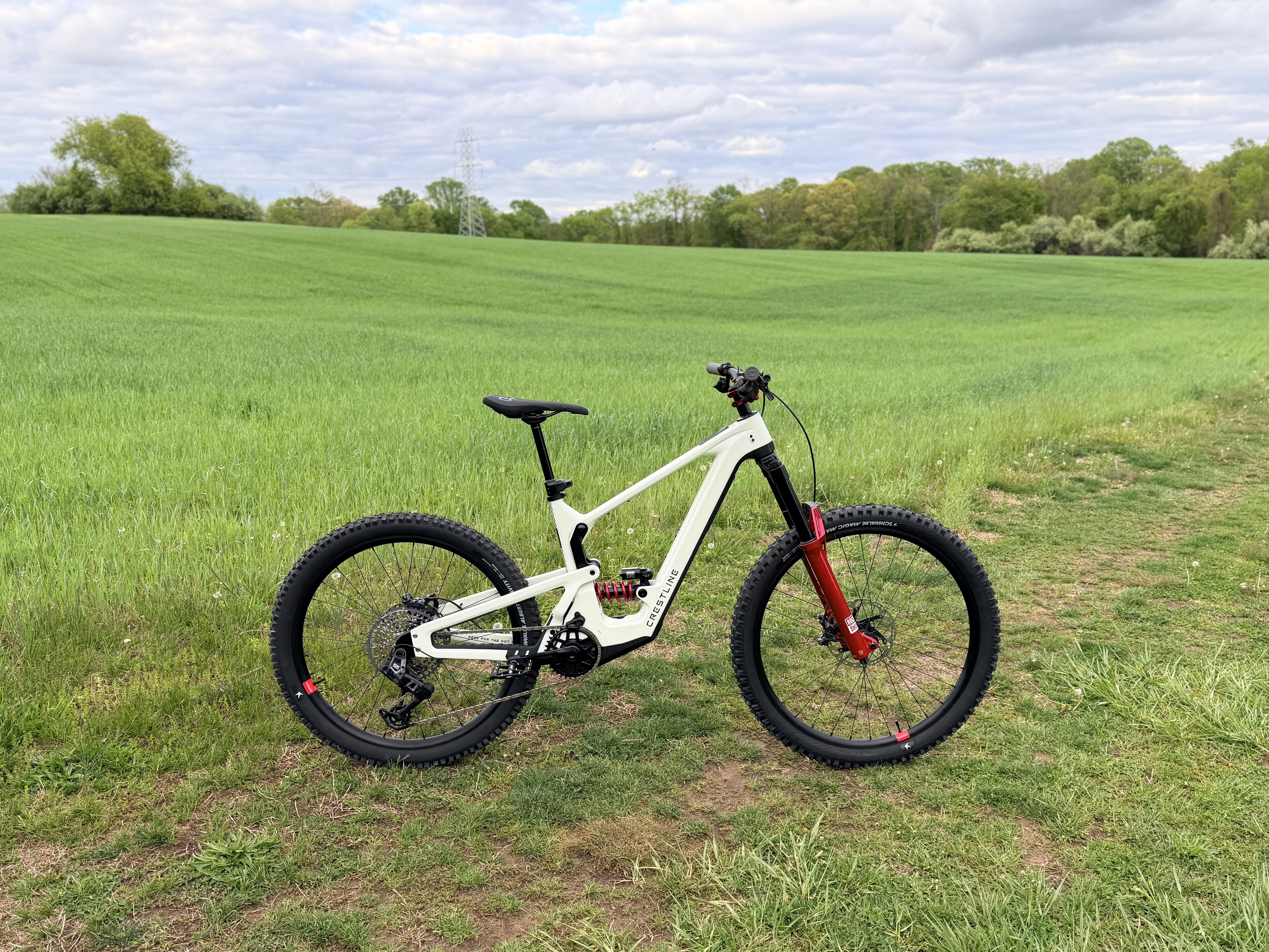

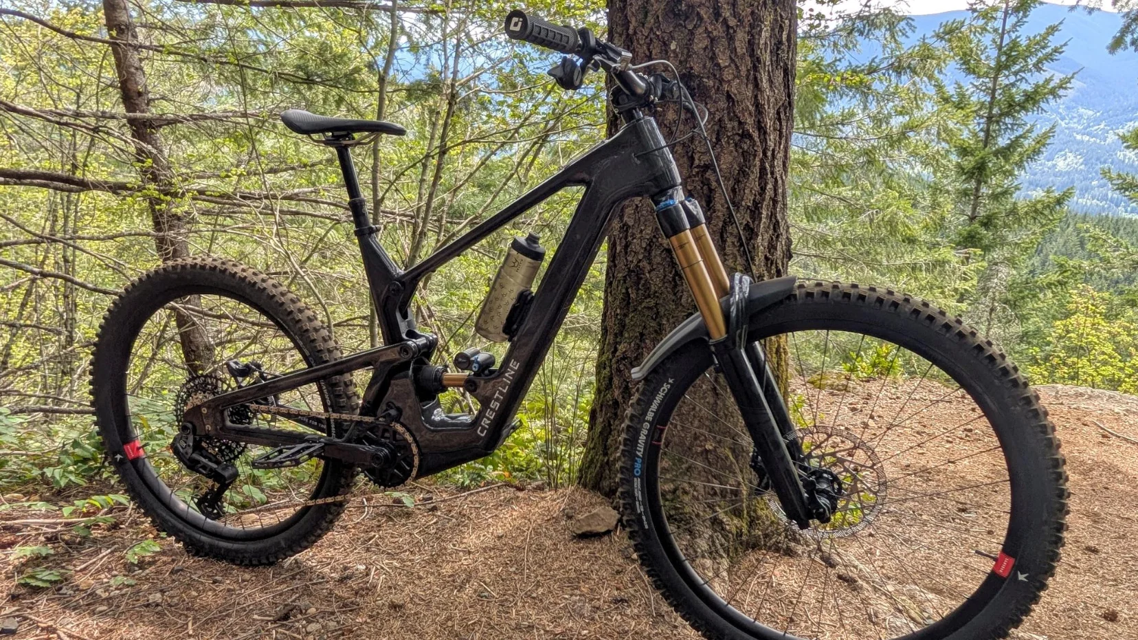

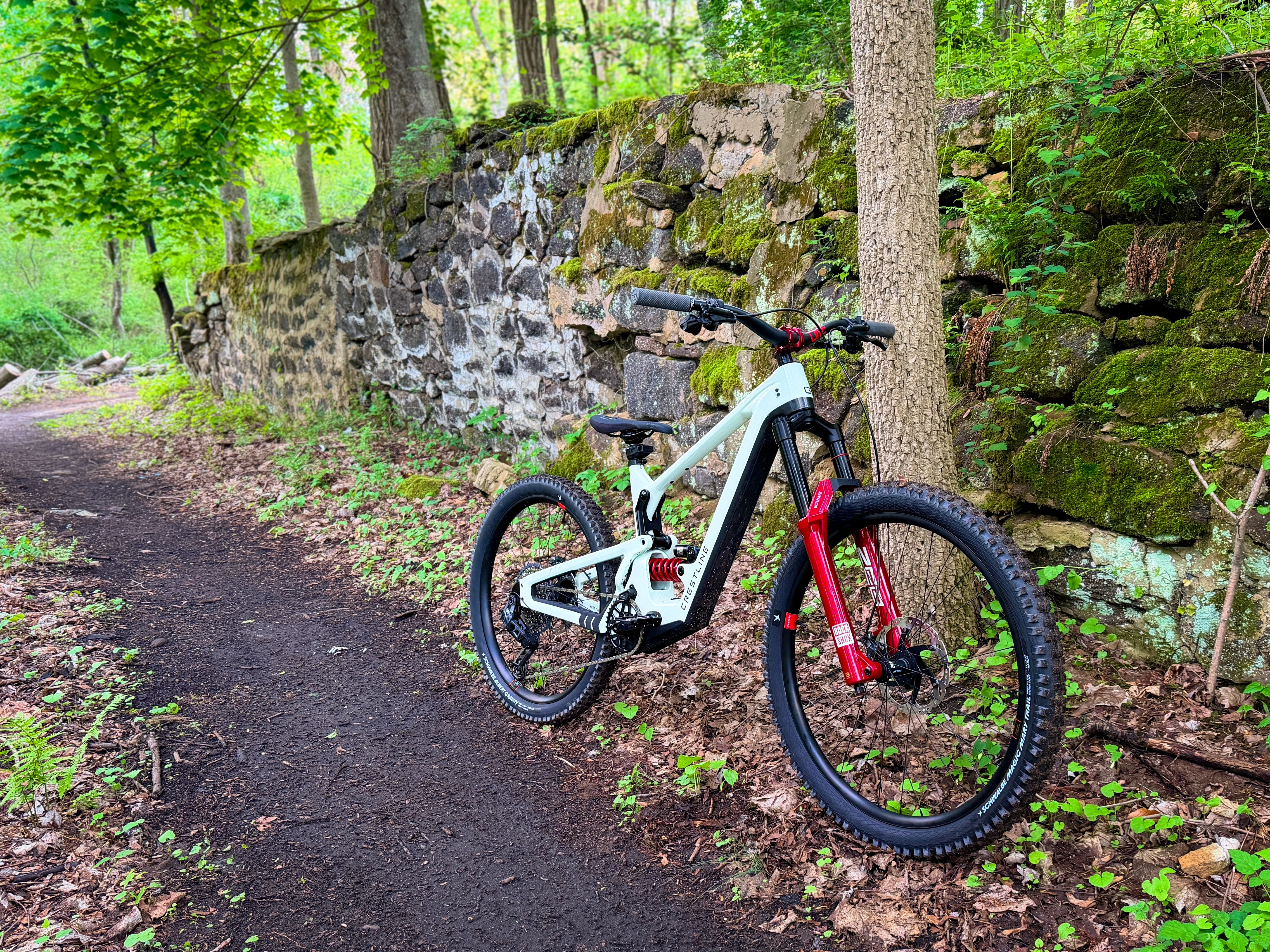

Got 002 all together. First ride today on some pretty mild trails. The M2s is amazing, makes my EP801 feel like farm equipment. Need to do some tweaking on the suspension, suggested pressure on the fork seemed to high, lowered it alittle bit. Suggested pressure on the shock was too low, but I may have ran it too high. I have to lower that as well. 460mm stays feel perfect, I don't have to ride over the front end to generate traction up front, even with the tall stack/bar height. Excited to get on some gnarlier terrain.
EDIT: Thought I'd add a little more color. Saddle feels too short, I think I may just need to slide it back in the rails. I have a fender and oneup edc carrier on order. I got the buggered Ridewrap, so waiting on the replacement ridewrap to cover more of the top tube. Those oneup goldstone grips are great. I thought they were going to be too skinny for my hands, they're not. The thick flared ends are a nice touch, almost feels like you can push your hands against the ends to give yourself some more stability.

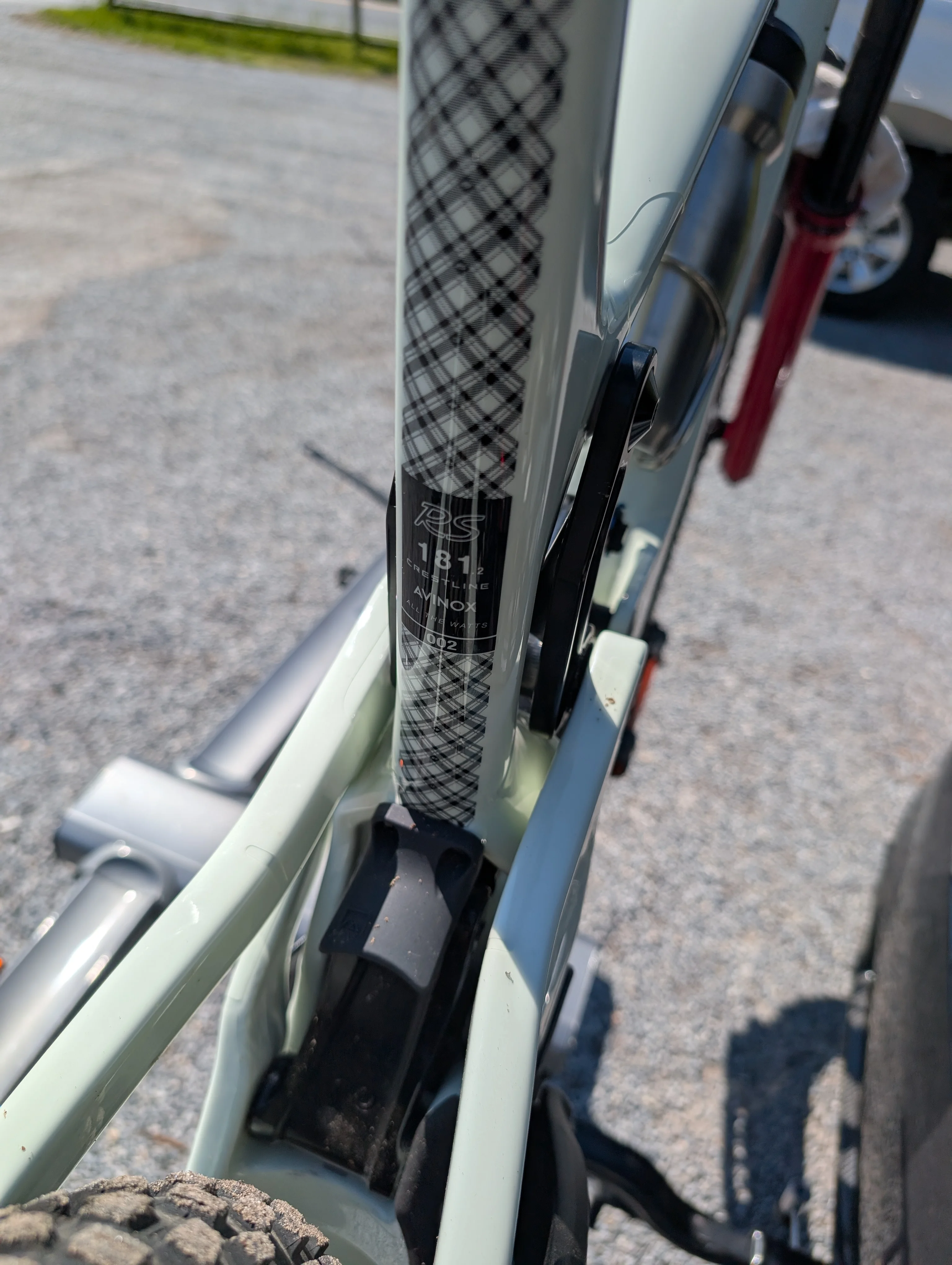

@digitale your power cord routing is not idea. It should to through the RD mounts. Check @bikedrd pics above your post.
Has anyone found a nice storage box (not bag or strap) that mounts to the top tube bottle cage bosses? Something narrow and sleek, large enough for a Tubolito small spare tube, a Dynaplug and a CycPlus Mini Ultra pump?
Appreciate the heads up, thnx
