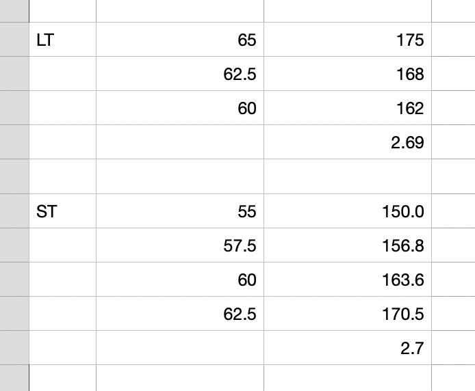

Guys I'm trying to do the math on travel vs shock stroke.
So if
230x55 is 150mm in ST , and 230x65 is 175mm in LT but 163mm in ST what would
57.5mm be
60mm be
62.5mm be ?? Any ideas
here:

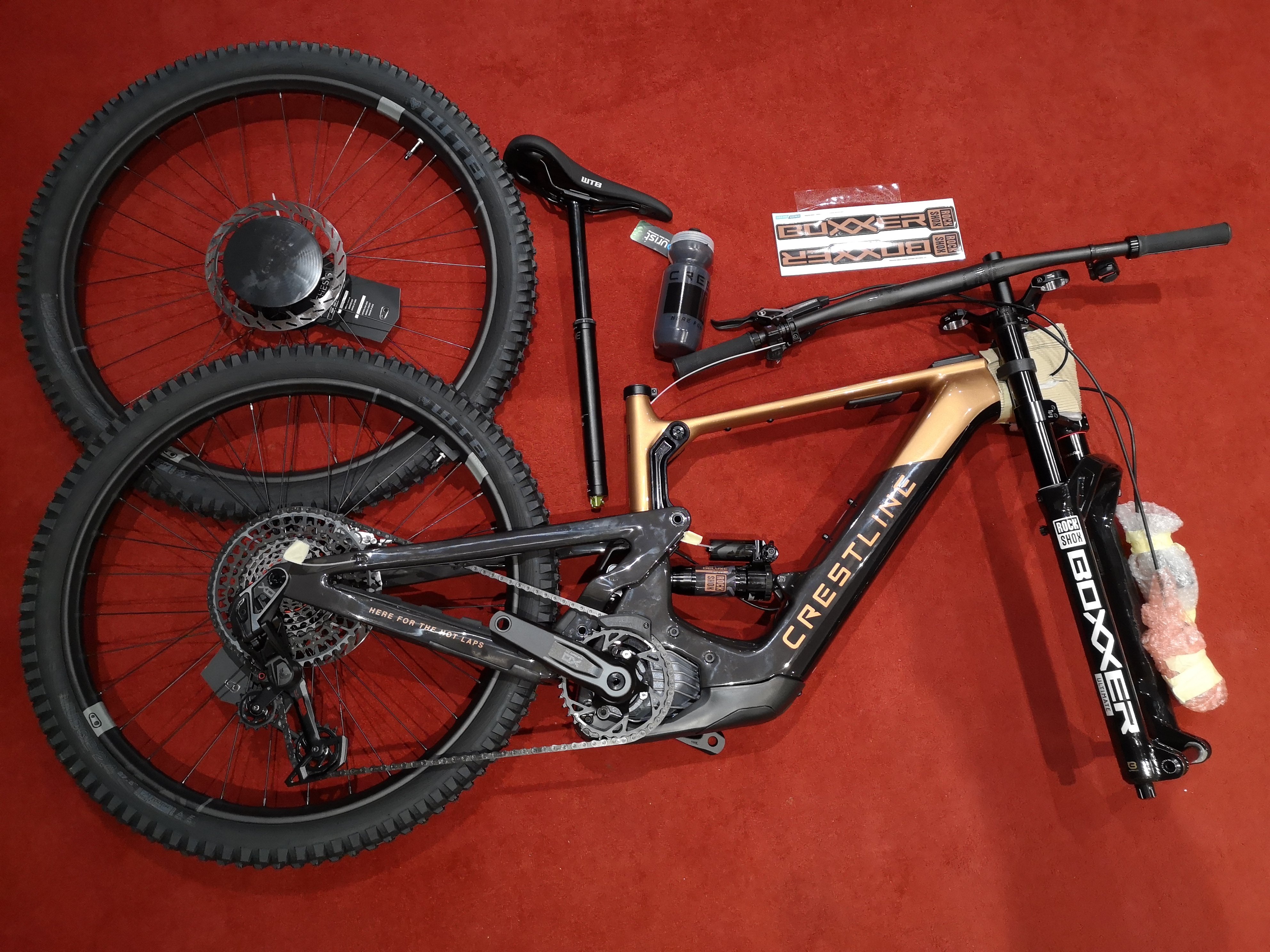

Wow. That looks great. Are they the new boxxers? Sick bike man. Let us know how she rides
Thanks dude. Troydon hooked me up with new Boxxers, 200mm front, what a legend. Got ride wrap to install and a few other mods like 220mm rotors, Zee mech. I reckon she will be a beast, can't wait and will report back (might be a while, weather is terrible here!). I've gone for the smallest size to keep things playful.
I spoke to Vorsprung and apparently a coil conversion is in the pipeline for Boxxer. Will see how it performs on air first, but my DH bike for sure will get coil fork if this happens.
Only one I have seen in real life had a bit of trouble with linkage bolts getting loose so maybe just keep a sharp eye on that. I am extremely envious. Your spec is exactly how I would want mine. I currently run 200 boxxers on my Cannondale and would never go back to single crown I wouldn't imagine
FYI the frame's not designed to run 220 on the rear dude.
Thanks. Probably better with 200mm rear anyway because of the mixed wheel size, otherwise the rear brake will be more powerful than the front.
just ordered mine.. Cant find the bike on the Ride wrap site though, or did you guys get the generic one ?
It's definitely on there. I've got the tailored protection kit. ridewrap.com
To throw another spanner in there it's a 203mm direct mount mate
i know im being stupid... But.. iv ordered the RS 75 sram, but can only see a rs205 vhp, a rs50/75 web and a rs 75/50 eeb on there site, Which if any do i need ?
75 and 50 are same bike bud just different travel set ups
The RS 75/50 eeb is the one you need. Frames are the same. Sram just the build kit it comes with. Just make sure you select the correct frame size, and wheel configuration.
