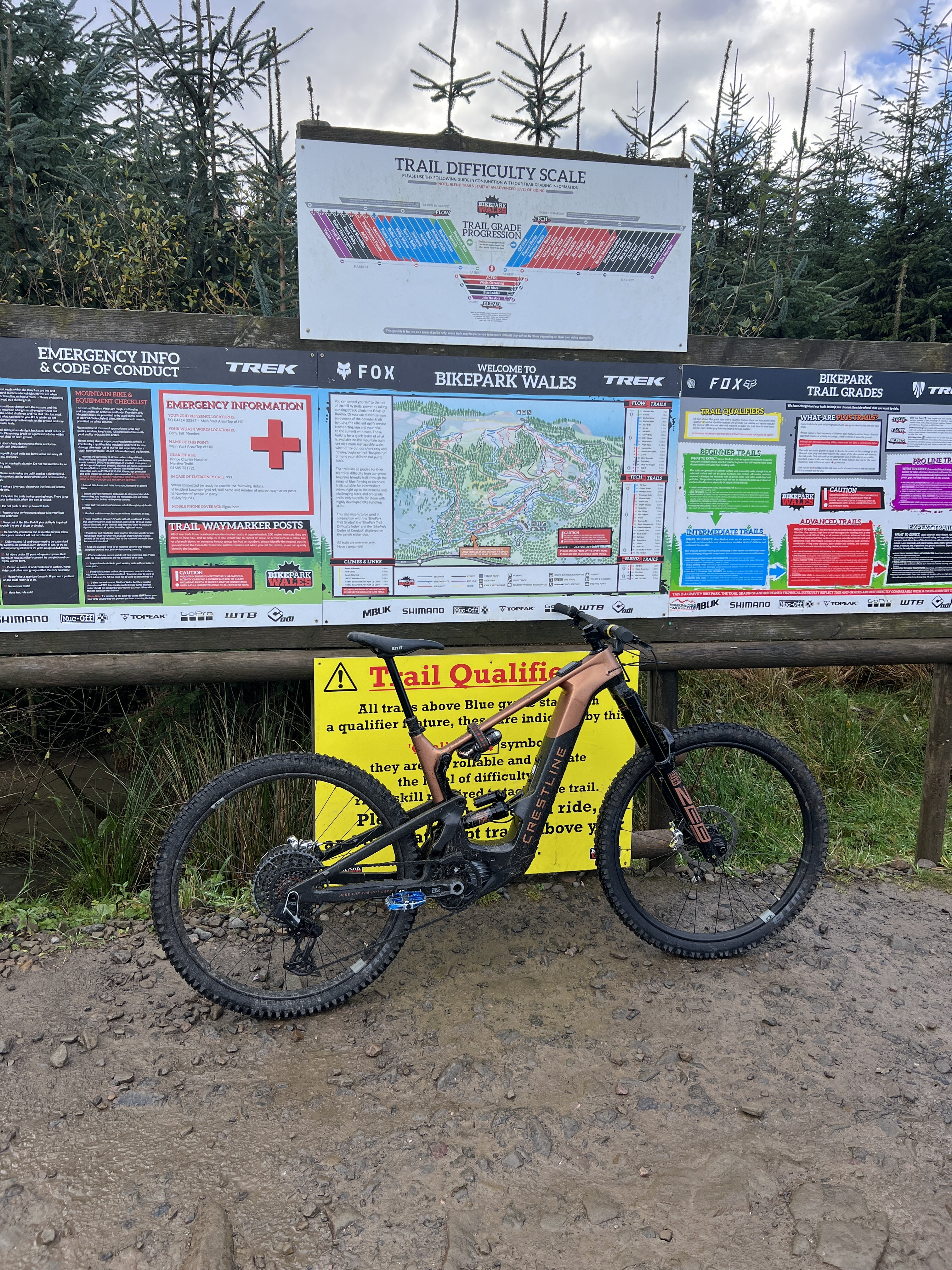

Very impressed With this bike, Havent been to BPW in a while, Felt confident letting off the brake straight away on this, Put it together, Seg the sag, Sent it... Cracking bike..
Cheers mate 🫡
Looking sick mate. Need some new pedals though 😉 What was your last bike, how does this compare?
She will be treated to a new set of pedals, Was going to go blue again But you Got me thinking now... Mrs always going on to me about matching clothes etc...
i'v had two gen 2levo, 9.8 trek rail, two gen 3 levo pro then s works, canyon strive on.
The rail was probably best suited to my needs out of that lot, and most similar to the crestline. The strive on was a good bike, best suited to a bike park, Mine was Faulty and i lost faith in the brand.
The crestline jumps too, Also eats all the rough, most of my riding is natural mountain, wood tracks.

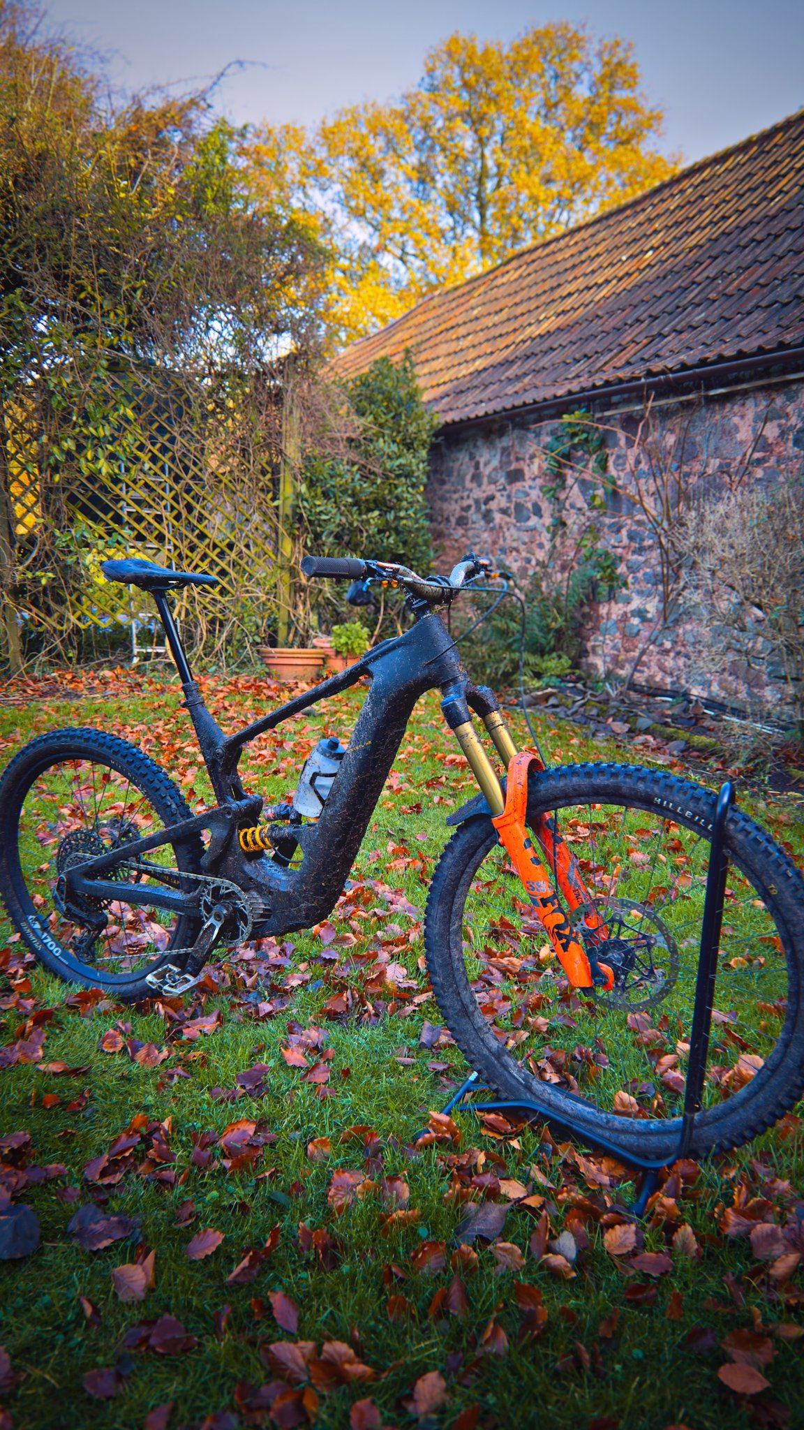

iv ordered Fox x2 and 38's, i have an ext storia i will get altered to suit, But i liked the fox x2 when it held air... there supposed to be more reliable these days so will sling one in and try.
Has anybody replaced the headset bearings yet, and if so are they tapered bearings ?? The frame is 56mm top and bottom but without stripping it down i can't figure out what one's i need to replace the FSAs in there
have you got the standard or works -5 in there ?
Luvvly jubbly, i'v got an ext e storia waiting up mojo's, trying get half a day to go out with jack any try it. Must say the X2 has been perfect in there though, Cant say the same about the 38's..
i'v just dialed back into full 29 and im happy...

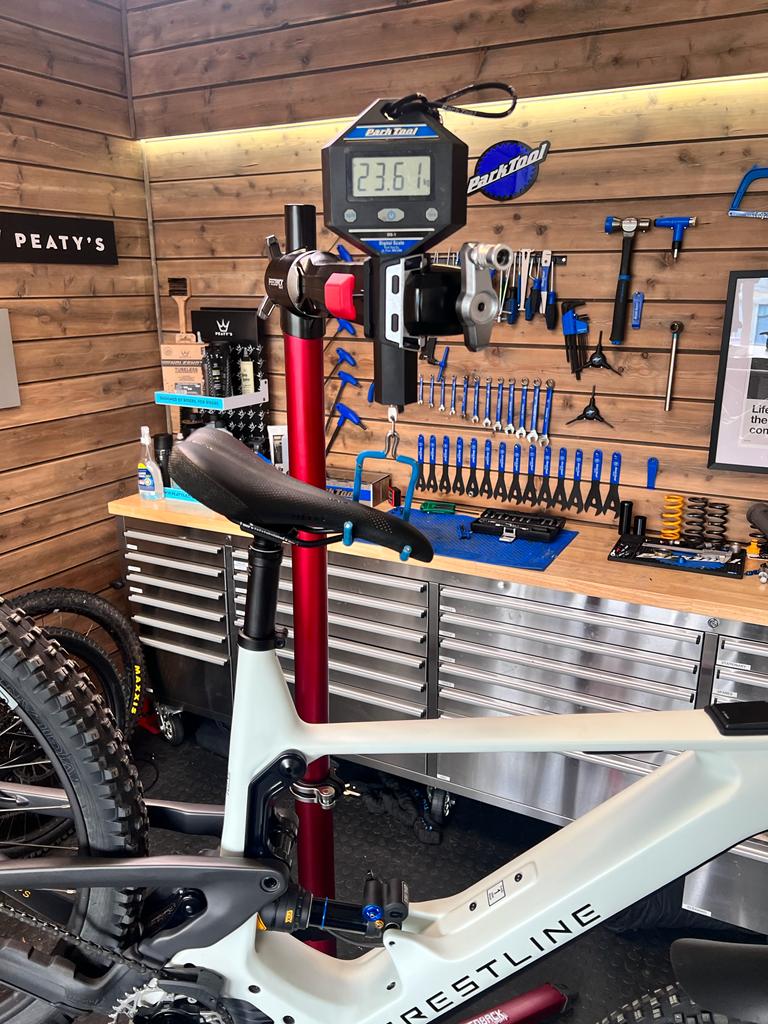

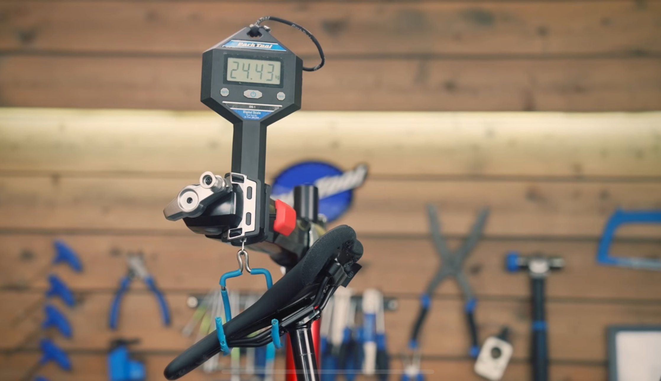

Thougt it would be around 23kg. That's only 600grm lighter than my Pole.
Interesting.

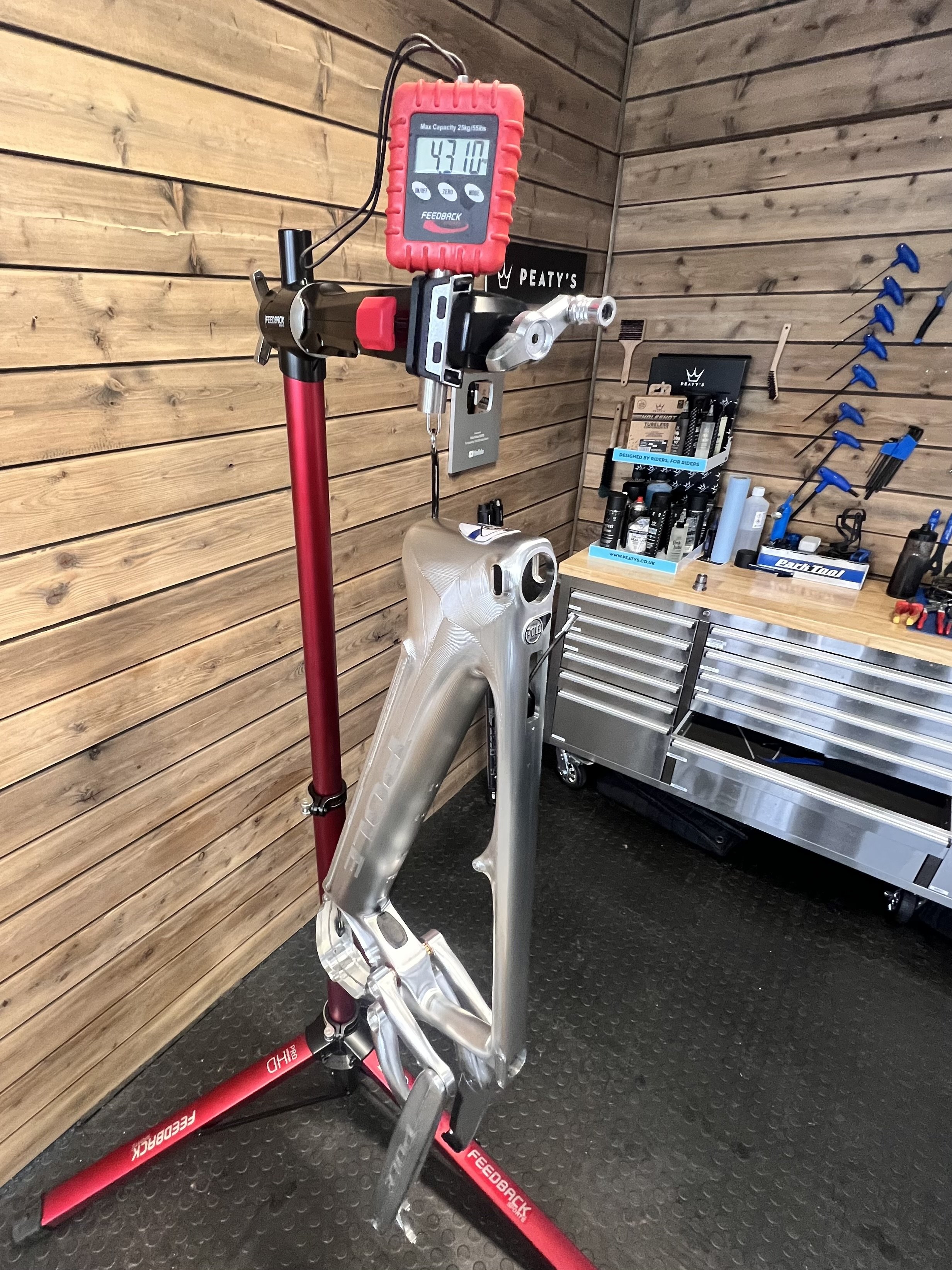

Over 80% of bike weight is not the frame, but the parts attached to it
The Voima frame weighs 4.3KG
Crestline won’t be a huge amount lower.
So most Bosch bikes with 750 battery in proper build are 24-26KG 👍
