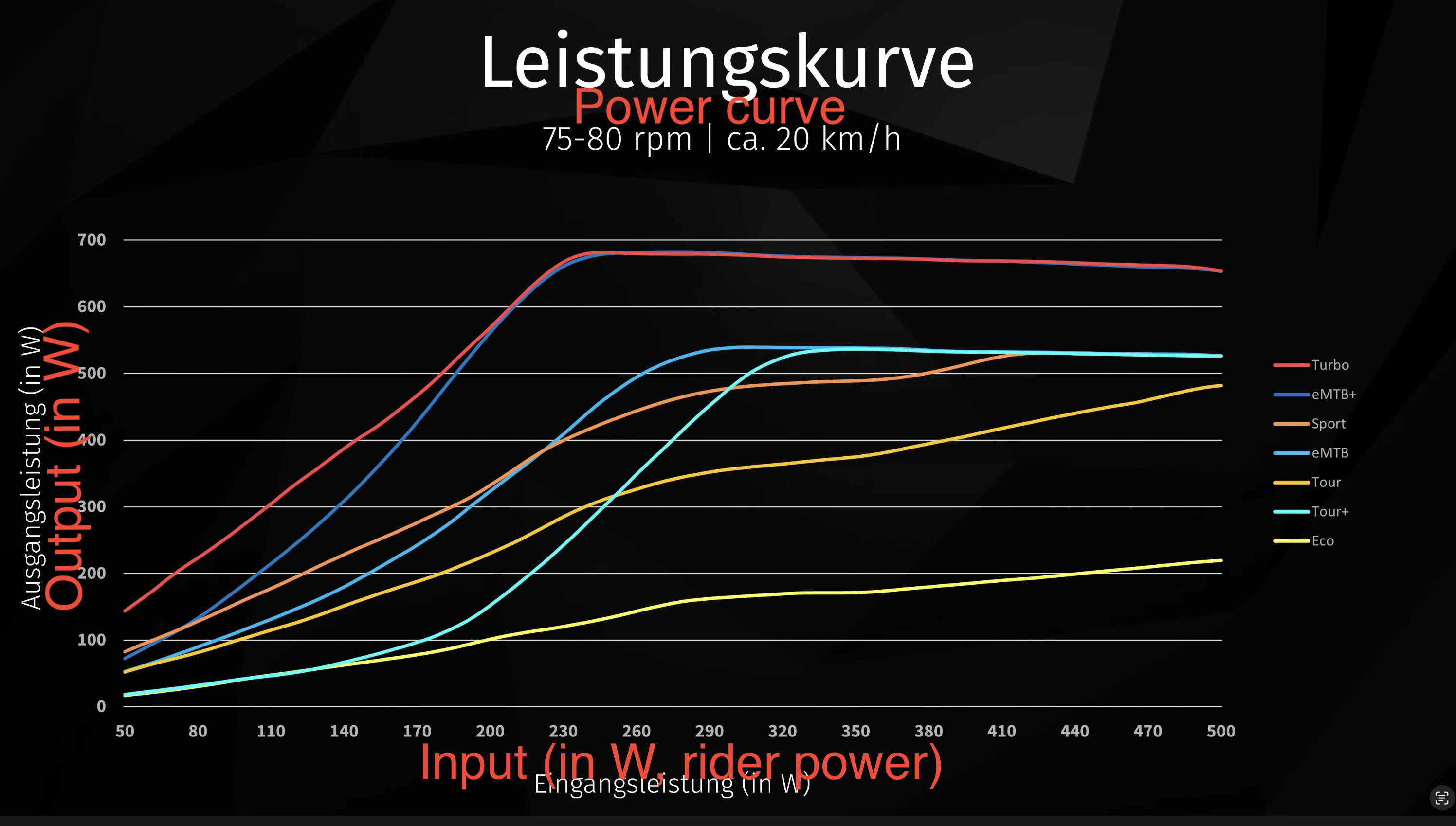

ffs, please, learn the difference in power output and what efficiency really means. thanks. i even annotated these two diagrams for your, and marked the difference in output for your, i even translated the bad german words in easy english:
the first diagram shows you the power output of the bosch, in the different modes (x axis shows rider input, y axis how much power the motor puts out, at the wheel, at the same rpm:

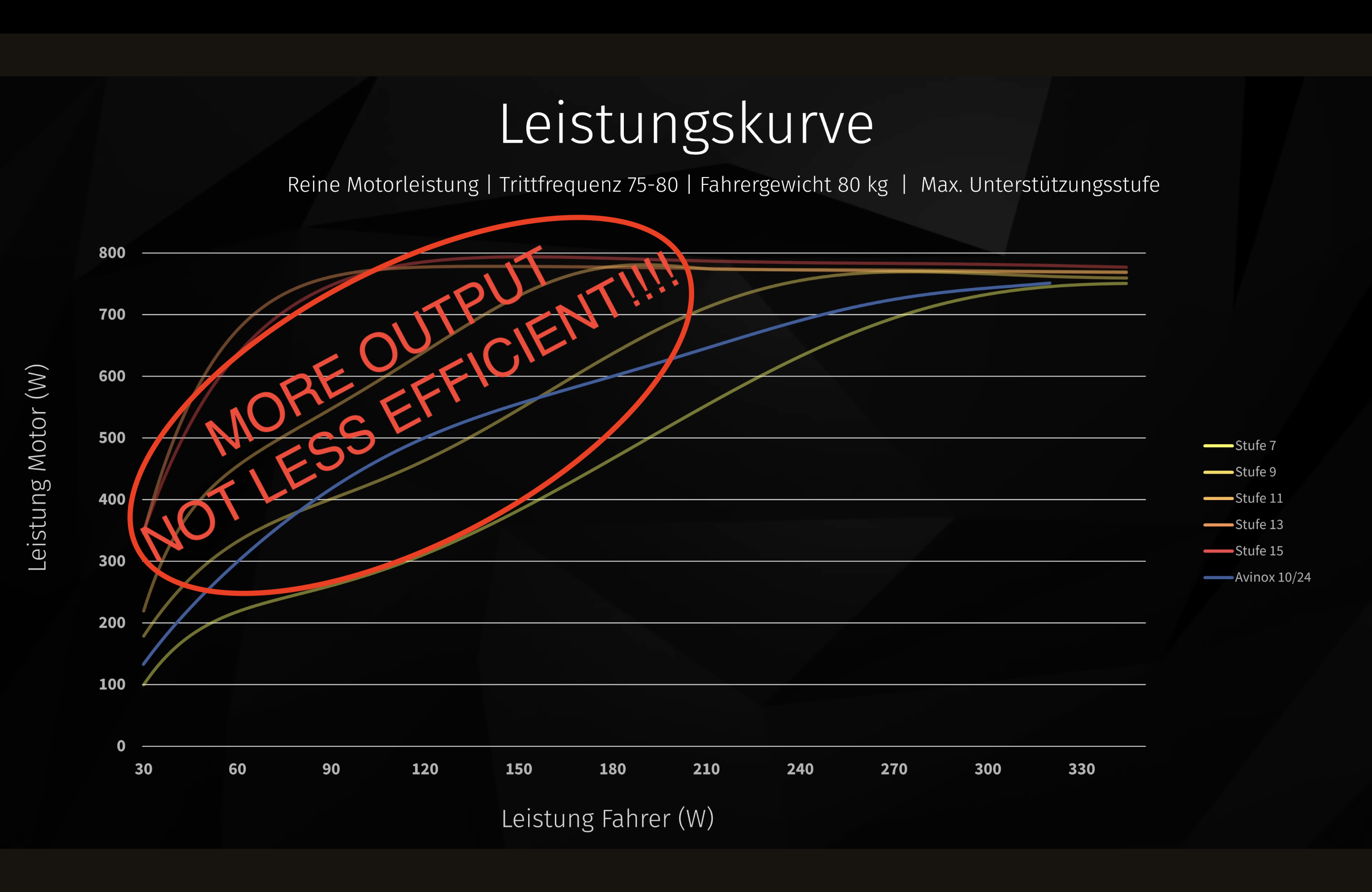

now the power curve of the avinox motor, after the software update where they also increased the power. you can clearly see, that for the same rider input, you get out a lot more power in the higher assistance modes, than on the bosch. BUT THAT DOESN'T MEAN IT'S LESS EFFICIENT. efficiency is IN the motor, how much loss there is in the different gears. that is probably there, but that's not much. how much? this we will know at the latest in february, when all parts of ebike-mtb's motor test are released, as they announced they have tested that with the help of DEKRA Stuttgart.
see that BIG FAT RED circle? that's the higher output. when you turn down assistance to lvl 7, than you have a similar power curve than Bosch's EMTB+ mode, everything above that, the motor uses more battery but gives you more power = less rider work. and that's most probably the area most testers are usually riding in, hence why they use more battery. they didn't test how much less input they needed to put in to get that amount of power.
hope that finally helps you understand the difference, @Suns_PSD. but please, for the love of everything, stop calling it less efficient, because it isn't.

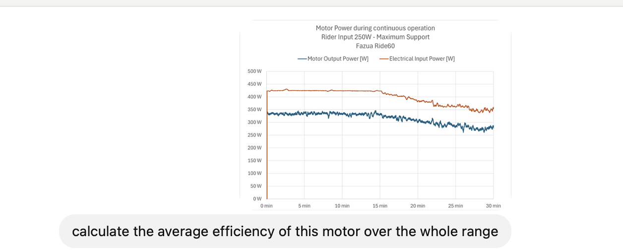

just ask chatgpt (fazua result):
Read approximate values from the graph
From visual inspection:
Motor output power
  • Starts ≈ 335 W
  • Ends ≈ 275 W
  • Rough average ≈ 305–310 W
Electrical input power
  • Starts ≈ 425 W
  • Ends ≈ 350 W
  • Rough average ≈ 385–390 W
Average efficiency
\eta_{\text{avg}} \approx \frac{\text{average output}}{\text{average input}}
Using mid-range values:
\eta_{\text{avg}} \approx \frac{308}{388} \approx 0.79
✅ Result
Average efficiency over the full range ≈ 79–80 %

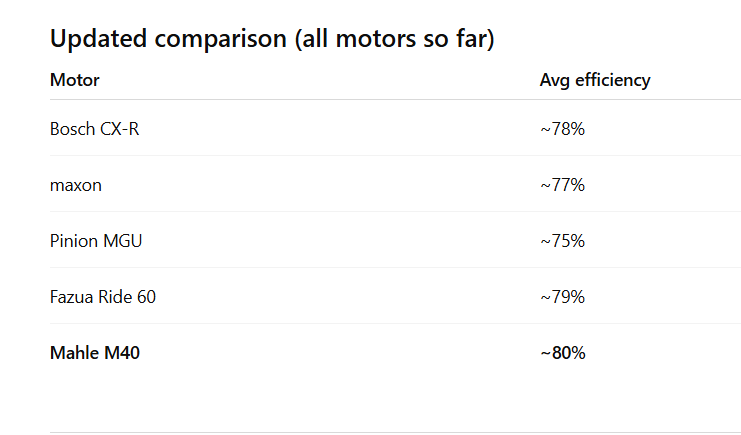

The Bosch SX was just added.​
Updated comparison (all motors analyzed)​
MotorAvg efficiency
Mahle M40~80%
Fazua Ride 60~79%
Bosch CX-R~78%
maxon~77%
Pinion MGU~75%
Bosch SX~73%
A few notes, the Fazua 60 is a better performing (not reliability!) mid power motor than the Bosch SX. It doesn't rattle, it's more efficient & it has a 480w battery.

3Bosch CX-Race≈ 78%High output with controlled losses
4Maxon≈ 77%Strong but higher copper & inverter losses
5Bosch CX 5≈ 75%Efficiency stays flat despite derating
6Pinion MGU≈ 75%Gearbox losses offset motor efficiency
7Bosch SX≈ 73%Compact/light design prioritizes mass over efficiency
Although I didn't know for certain, I suspected the CXR motor would be more efficient than the CX (YTBD on the Avinox) and since I wanted the lighter slimmer 600w battery, this mattered quite a bit to me.
This why I had to find a good all-around e-bike with a Bosch CXR and a 600w, that costs less than $15K for my new bike order.
I havent looked, but did they use the CX-R on the exact same bike, set setup conditions as the normal CX?
I think the issue with these is there's so many variables that can distort the results.
They attached measuring equipment to a fixed bike in a lab and used machines to apply the 250w pedaling input, then measured battery drain and watts output.
They also removed the motors from the bikes entirely. That's how they got such accurate weights, etc. as well. Notice the CXR is only 90 grams lighter than the CX, not the claimed 150 for example.
I think the Pinion had high efficiency because they somehow bypassed the built-in transmission or maybe chose an efficient gear. See the note that ChatGPT included. I didn't bother reading that particular review because I would not consider that motor anyways.
