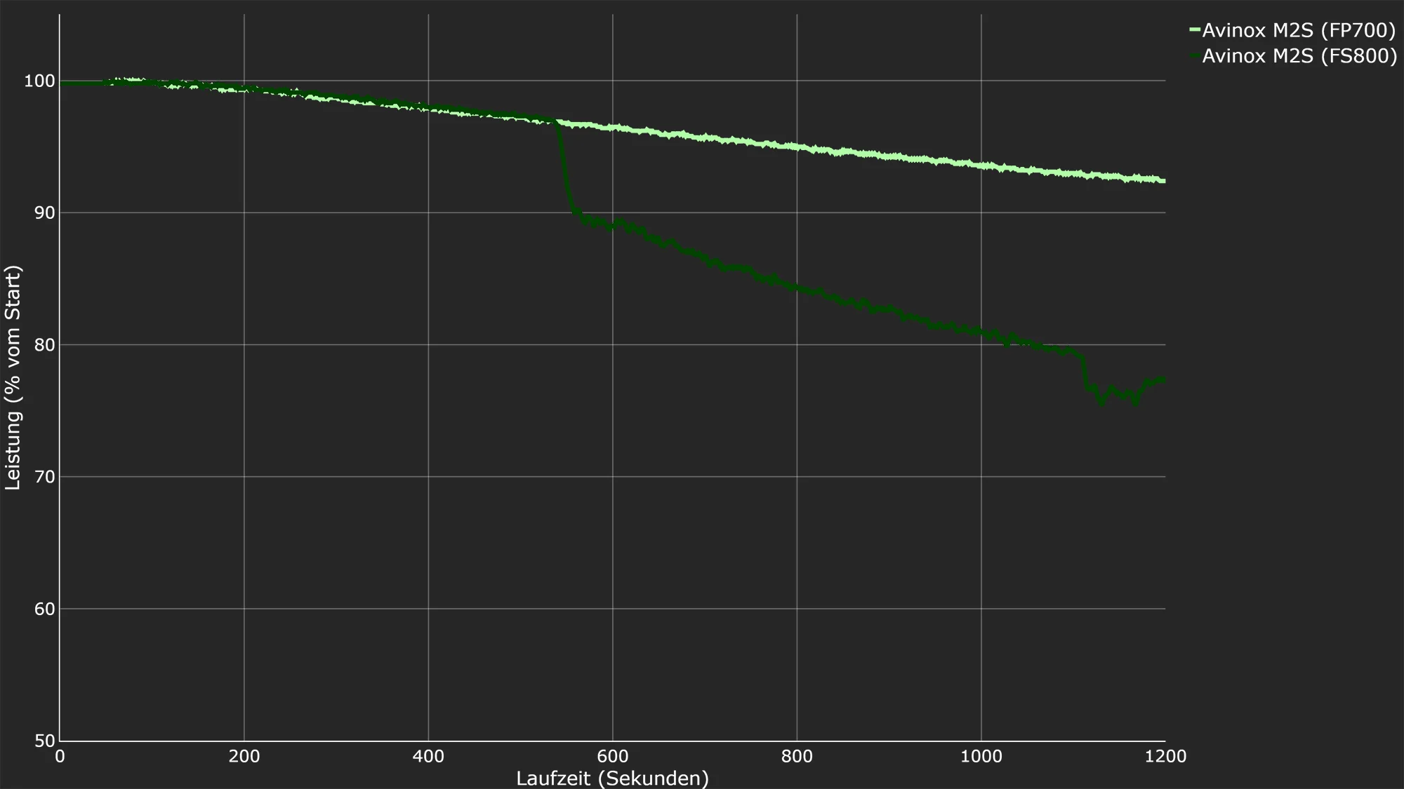

hey @Suns_PSD, there is a new efficiency king in town:
I really appreciate the lab testing that those guys do. Having said that, their review is a little odd, in comparision to the Pinkbike one (https://www.pinkbike.com/news/avino...drive-units-with-up-to-1500-w-peak-power.html).
The main thing is that Ebike-mtb.com is normally very technically precise, but in this review they seem to treat the M2 and M2S motors as mechanically the same, and list a single weight for both of them, as well as mentioning the “Dual Gear Engagement” and helical gears as common technologies shared between the 2 motors, as well as saying that they use flat copper wire winding on the motor coil to increase the efficiency.
The Pinkbike review, on the other hand, says that only the M2S has the "Dual Gear Engagement" which eliminates all the rattle, whereas the M2 is more of a modified M1 and lacks that tech and instead uses helical gears as a rattle reduction technique that is less effective. Pinkbike also lists different weights for each motor, which makes sense if they are mechanically different. Pinkbike also says that only the M2S uses the flat copper wire to increase power output while using the copper very efficiently, and the M2 instead uses traditional round copper that needs extra winds to achieve the higher power output.
translate that one then:
much more detailed
with the new 700 battery, there is practically no derating anymore:
motor casing gets as hot as 120°C though, so curious when the first american idiot sues them for burning his legs :D
