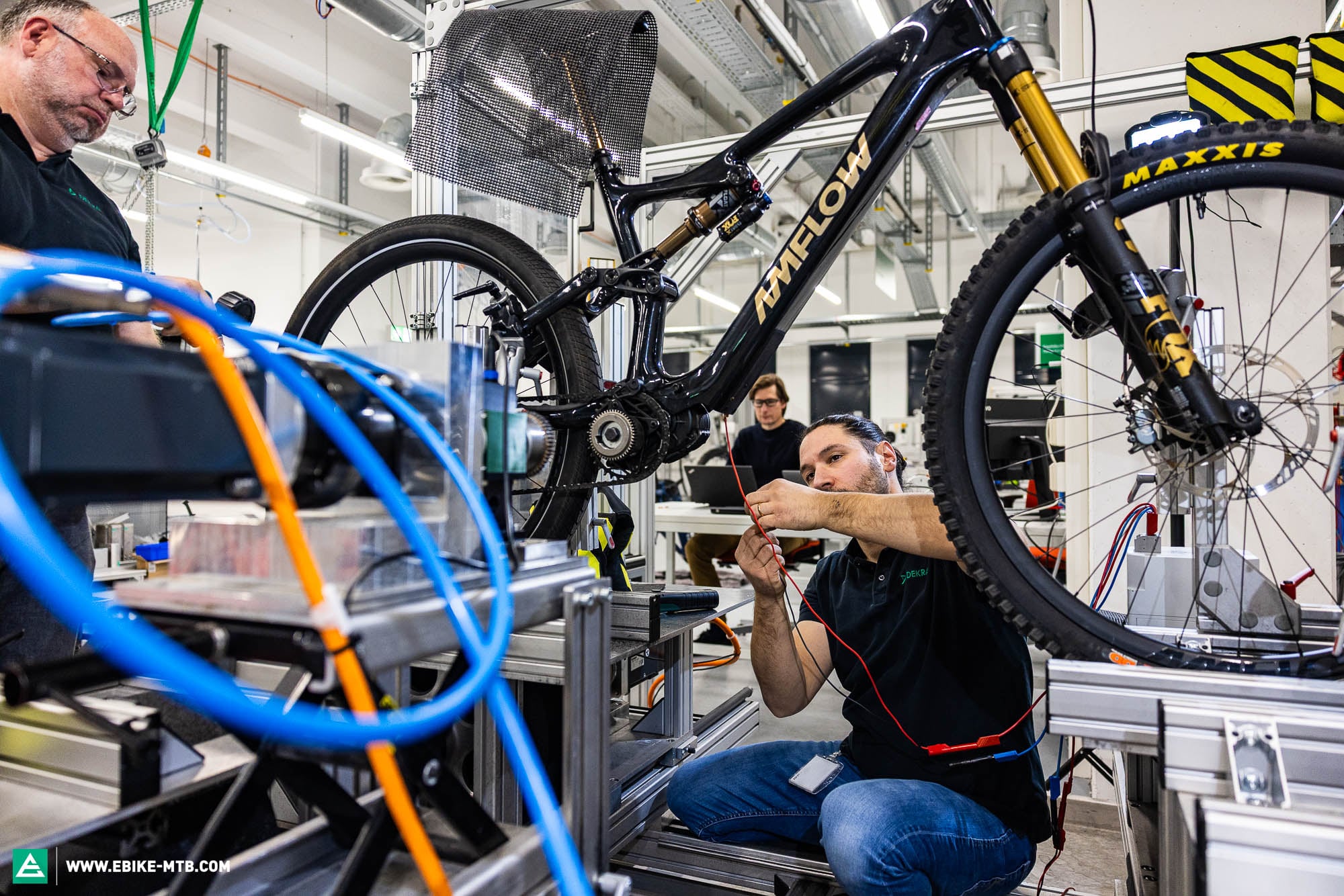

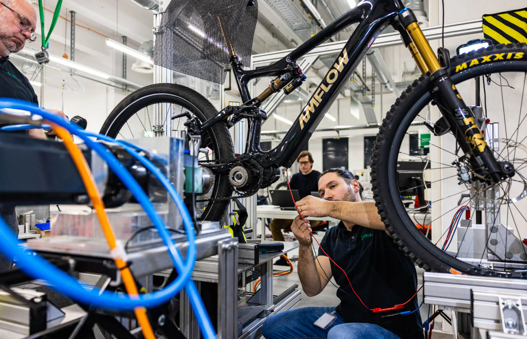

They attached measuring equipment to a fixed bike in a lab and used machines to apply the 250w pedaling input, then measured battery drain and watts output. They also removed the motors from the bikes entirely.
Yeah, just had a quick look. Unless they measure electrical power into the drive unit and mechanical power out of the motor at the crank with the same external load conditions across the different bikes, they are mostly measuring whole bike drivetrain efficiency intertwined into the result... not a pure motor efficiency number.
They also removed the motors from the bikes entirely. That's how they got such accurate weights, etc. as well. Notice the CXR is only 90 grams lighter than the CX, not the claimed 150 for example.
I think the Pinion had high efficiency because they somehow bypassed the built-in transmission or maybe chose an efficient gear. See the note that ChatGPT included. I didn't bother reading that particular review because I would not consider that motor anyways.
View attachment 175445View attachment 175446
I can see lots of cables and wires. Its hard to tell their exact methodology though. Its not disclosed as far as I can see.
Taking a motor out is pretty easy to weigh.
By the way, I'm not knocking them at all - the guys are great. But I'm saying that unless everything is equal in the testing then there will be inaccuracies in the data differences in the results that are introduced by drivetrain / hub / suspension design / chainline etc etc.
It looks to me like they are getting the output from the dyno at the rear wheel.
the guys testing are DEKRA, same level as TÜV Süd
DEKRA are legit for sure. But Dekra testing does still not turn a complete bike bench test into a motor only efficiency test. If the device under test is a whole bike, then the result is system efficiency, not purely motor efficiency. The moment mechanical output is measured downstream of the motor, everything after the motor contaminates the number.
On its own, probably not that interesting, but when we are literally comparing motors to the percentage levels like in @Suns_PSD table, then definitely we need to take these variables into account.
They measured output power right off the motor. Not at the rear wheel, which frankly wouldn't make any difference anyways if they used the same tire but did it on a bench as long as they didn't use a HP bike.
Do they show / explain how?
Well you can see it on the Amflow in your picture. They have a flywheel coming right off the crankshaft of the motor going back to a pulley on the measurement dynometer.
Edited now that I'm not on my phone. I see that they have a road tire so it looks like they are picking up the power reading from the rear wheel.
This doesn't matter, at all. There is no power loss that is specific to the bike chassis when there isn't even a rider on the bike.
My take on that was that is the input - the machine is putting in ~150w (or whatever) into the motor, and they are measuring the output at the rear wheel?
If not, how are they putting an input into the motor? It needs an input and output.
It looks to me as if it's driven on that gear.
In that photo they don't have the gears touching as they are still setting up the rig. But the drive gear is on like a lathe slider so they can engage it. They have the drive gear off to the left and you can see the driven gear to the right of the photo coming off the motor crankshaft/ crank spindle. There are no cranks installed so obviously they're not peddling it. Then they have a belt that's going back to turn a generator or something to read the output power. They're using the electrical connections to capture how much battery juice is being utilized to compare it to the output watts.
Agree with Rob, hence the road tire and you can make out a drum with mechanism (with round lightening holes) within that 80/20 extrusion below the rear tire. There inputing power via that splined coupling (where the crank arm would be) and measuring the output at the wheel. There also tapping the battery to measure consumption.
