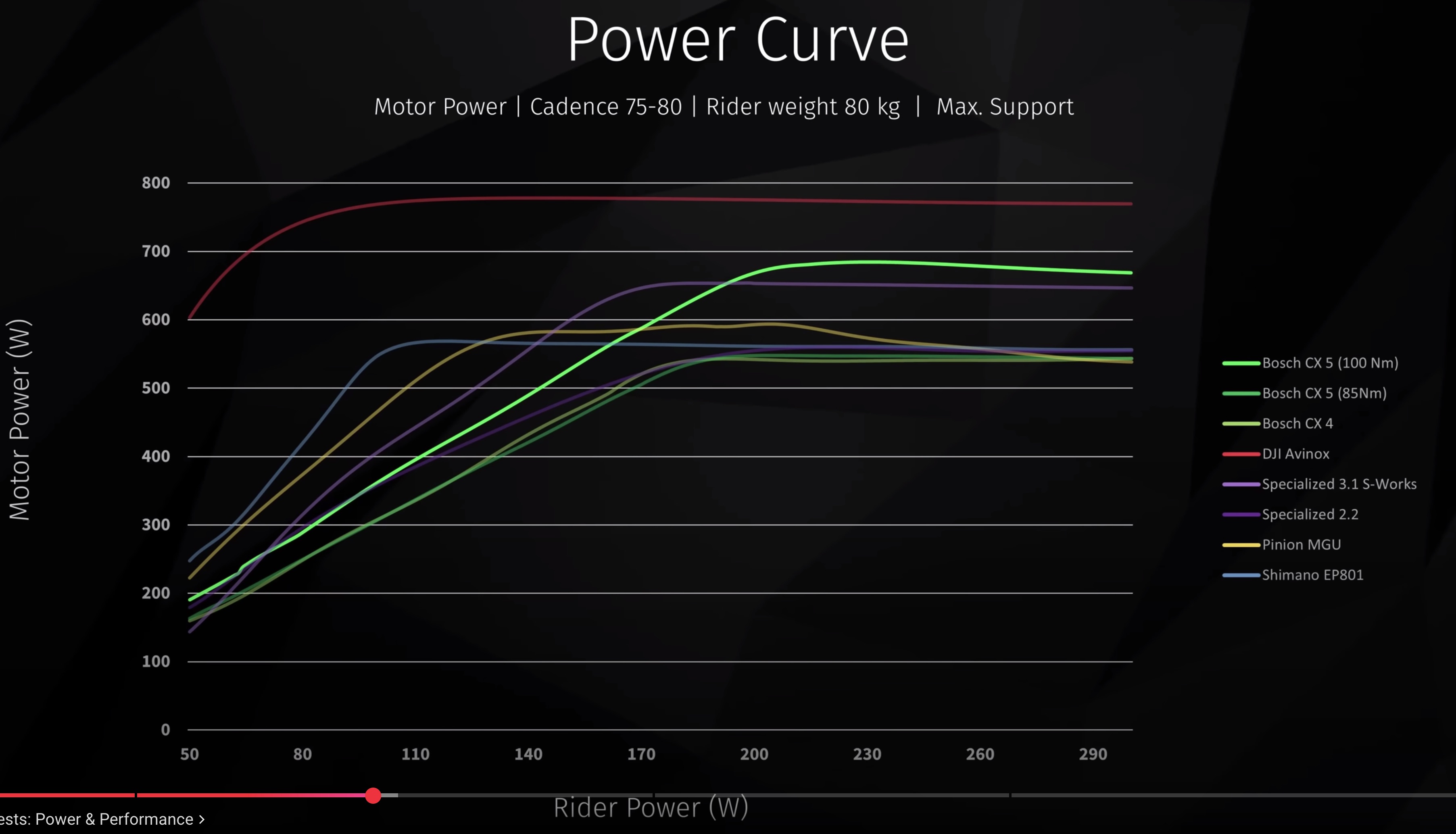

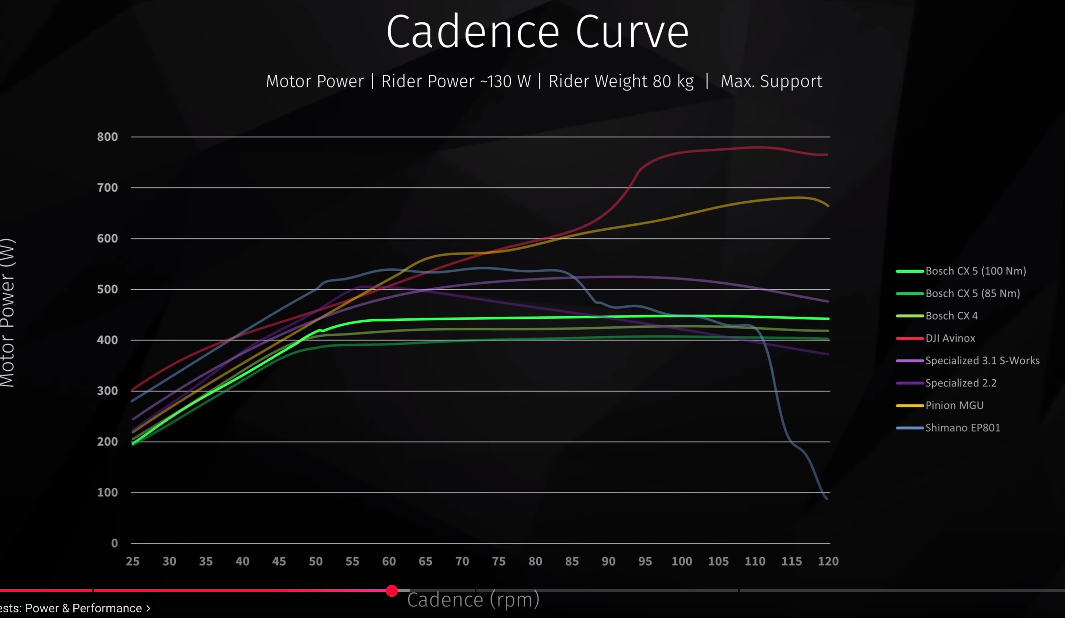

Agreed. The guys at Velomotion do some serious and comprehensive dyno bench test comparisons, but I believe even they have stopped trying to address output power vs battery consumption (aka "efficiency") because in practice it's just not possible to give any figure that - albeit objective and repeatable - has any genuine meaningfulness in real life.
The reason is simply that there are a several parameters that affect output power - and hence battery consumption - and together they give multiple combinations of possible test scenarios. Any figure they might choose to quote would either be overly specific (ie valid only for a very specific rider cadence and effort) or not repeatable in real life.
These two graphics taken from their Bosch CX gen 5 bench test review demonstrate this well.

Based on some of the data shared, I was thinking the Bosch CX system was more "efficient" than the Shimano EP801 w/ Darfon battery.
In the LoamWolf test, the rider was definitely more than 195 lbs and he rode a winch/plummet enduro loop and got 4500'. So that made me hopeful of using a 600wH with Bosch CX. Plus the Bosch CX is potentially more powerful than the Shimano EP801. I don't know if eMTB (Bosch) equals Trail (Shimano) mode, but it made me hopeful.

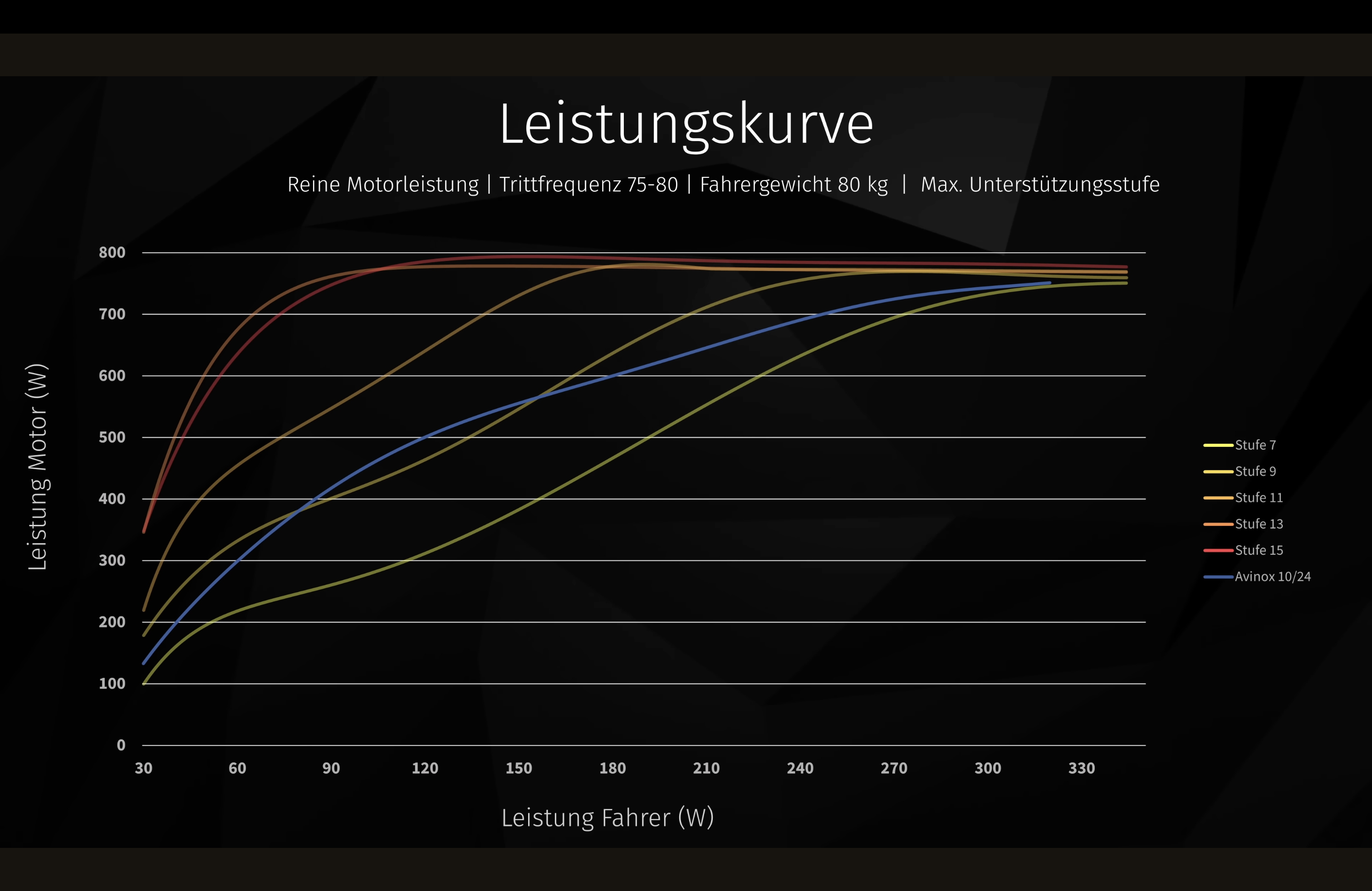

yeah, that's simply what @Suns_PSD doesn't understand. they even did a second avinox test video after avinox updated the firmware, and published the power curve for assistance level 7, 9, 11, 13 and 15 in AUTO and TRAIL mode (compaired to the orginal turbo one from the original firmware):
so that just shows, the avinox gives its users a blank slate, where they can tune it to their individual liking OR USE A SHIT TON OF POWER with nearly NO OWN INPUT, and then deplete the battery in no time. but that has nothing to do with how efficient the motor is, but on how much INPUT they want to put in themselves.
time to learn german, @Suns_PSD:

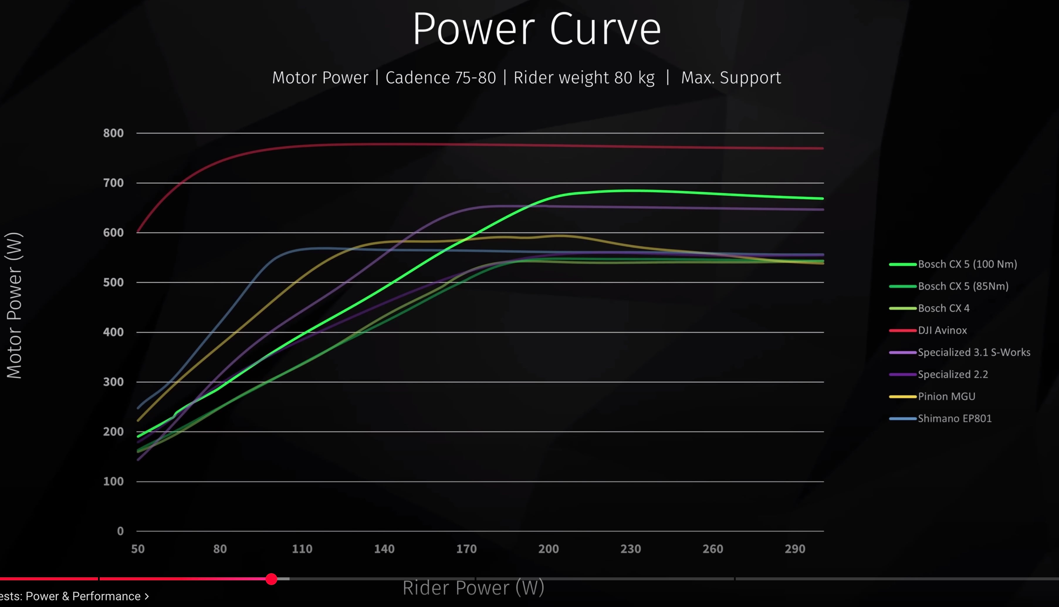

Obviously a motor, like the DJI, which is proving a LOT more assistance than the competitiors is going to consume more power when used in such a way. Another challenge is their measuring power at the wheel, which isn't the way, I suspect, manufacturers are reporting (output pinion or chainring drive). At the wheel, your dealing with drivetrain losses and gearing, which affect results. Add to that, the different drivetrains, bikes needed to test all these motors since they are not universally compatible in fitment.
Any "meaningful" test would need to normalize assistance or power in vs. out when comparing battery usage.
you just repeated all the points mentioned in the video i posted?
I didn't watch the video... but I was looking at some of those graphs last night and the data does seem weird. I recall seeing the EP801 indicidating its more powerful than a CX4/5. Power levels, well below manufactored posted, but it wasn't consistent.
When Shimano/Bosch/DJI say 600W or 750W or 1000W is that electrical power to provide max output or is that the actual motor output?
that’s also mentioned in the video, they never clear that up, but velomotion test all the motors with the same parameter and measure output at the wheel
I'll be the first to admit that it's not possible to control for every variable in a bike efficiency test.
That said, I've read enough rider reviews and online comparisons, some with normalized power but nearly all with normalized speeds, to conclude that the Bosch is indeed between 10-20% more efficient more than the Avinox. No one denies that the Avinox is like pedaling through quicksand when turned off so there is 30-70 watts per hour lost to drag right there, that anyone can verify and feel. The motor power still has to overcome that drag to turn the motor over.
Think how many Bosch 600w reviews you read where the tester says the battery size is ideal but then no one ever says that regarding the Avinox 600w. But also there are several instances of people saying that the Avinox bikes handle considerably better after switching to the 600w.
So efficiency, chain ring protection, power delivery, ability to pedal with motor off, noise, dealer support & a better handing bike are all advantages of the Bosch. I just think that people are too impressed by the power and the looks of the Avinox and they are ignoring too many other important attributes.
I only dove into the topic for my own info as it was between those 2 motor systems for me and I feel no need to convince anyone else.
For me, the Bosch is a considerably better overall package based on the reviews I've read and my priorities.
The motor drag of the Avinox is ALOT more than any other motor out there so that means one thing for certain :
1. to overcome the drag power has to come from somewhere, with a 800% ratio, for sure it's the motor putting most of it .
2. going motor off or eco is a no go after a long day .
As for the Shimano EP801, I've rode with two of my firends for quite a while , more than 10 times in different places and EVERY time, the Bosch was more efficient. The CX4 on the other hand was almost equal.
Well I ride with dudes with all motor options and my conclusion laterally after hundtreds of rides is the motors are of very similar efficiency. If one guy has a 600wh and the other has a 750wh regardless of brand the 600wh guy has less range. The only time that is not true is if 600wh guy uses more legs and lungs and or 750wh guy is a lot heavier.
There is no free lunch or a magic more efficient and more powerful motor.
When sizing a bike/battery size it on the run time you want to achieve.
