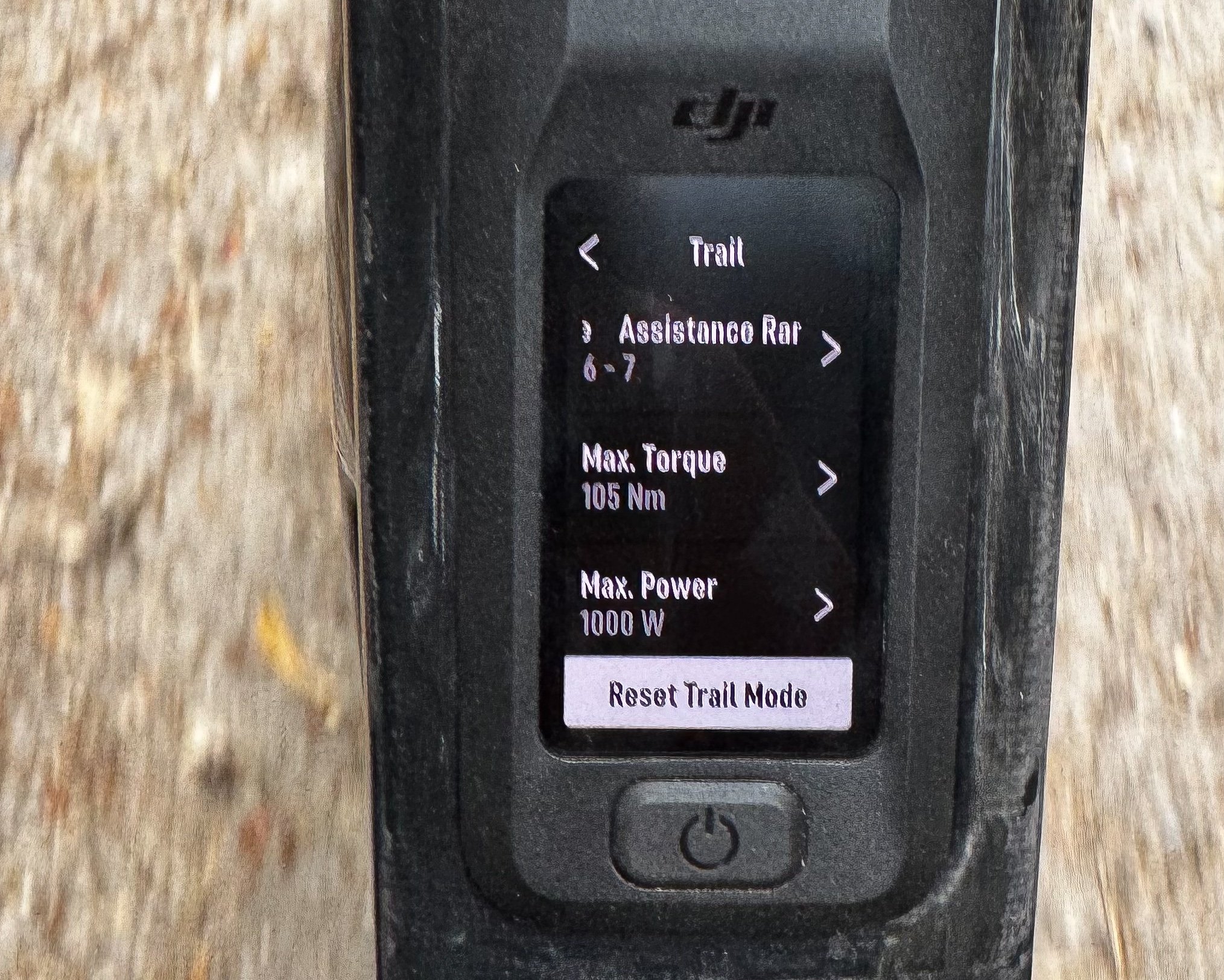

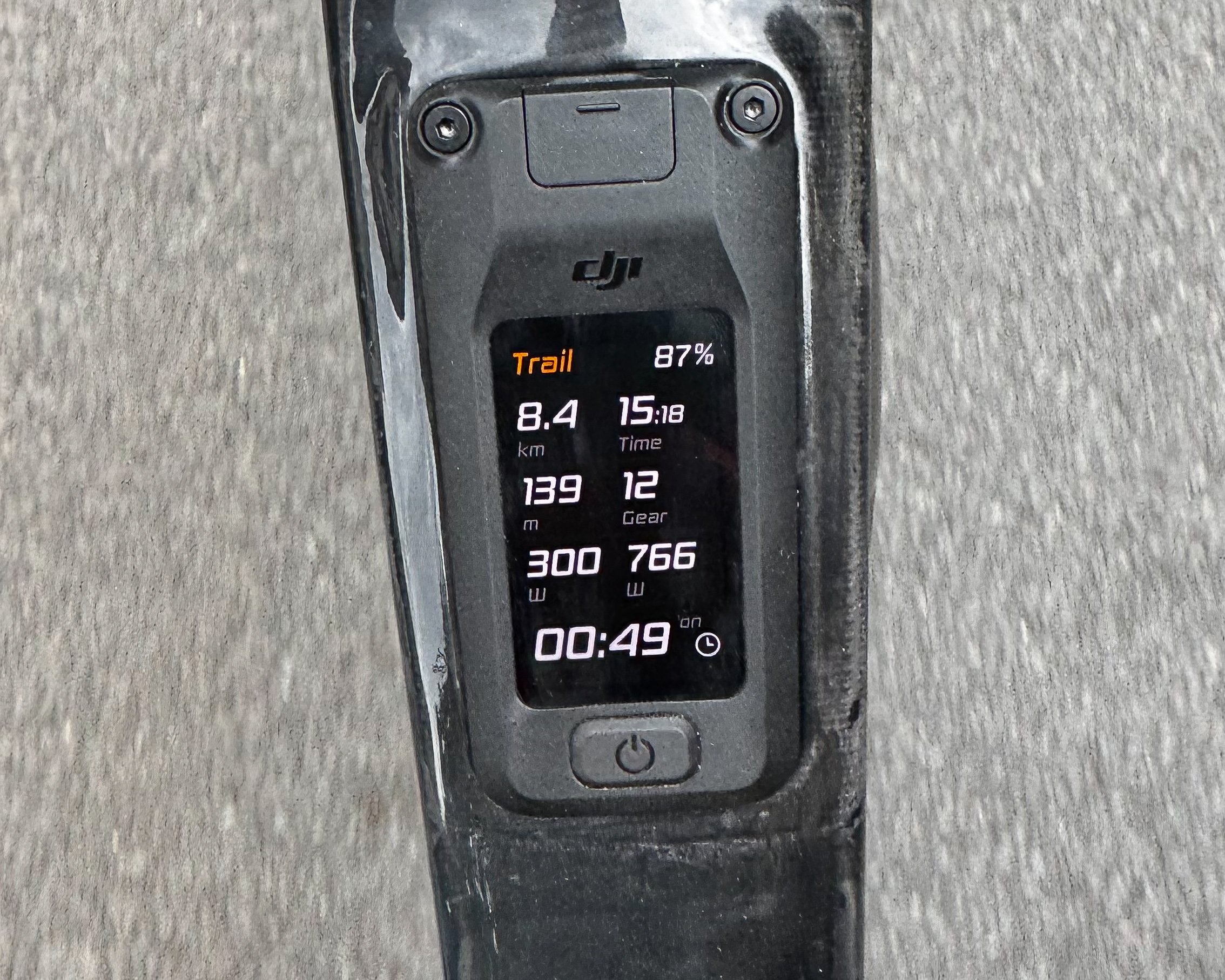

Tell him to try setting power assistance to 6 low 7 high.
Then it will double his leg power (slightly more) right up to 1000w. But reduces battery consumption significantly.
Mine shows rider power w on the left, motor power on the right.

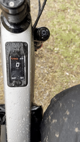

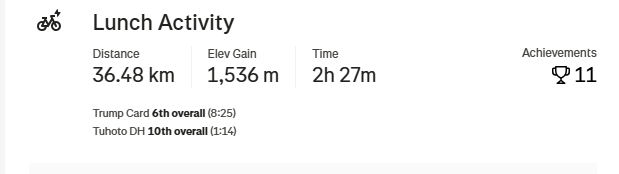

Another interesting ride last night.
Crestline Gen5 bosch 100nm 600wh Used 450wh 80kg kitted
Trek Rail Gen3 bosch 85nm 750hw Used 412wh 75kg kitted
Teewing DJI 105nm? 800wh used 552wh 85kg kitted.
This was a really interesting test because a good 630 mtr vert is super steep tech. It basically is super rooty and keeps getting steeper until you loop the bike out in front of you or you loose traction. Then for short period it becomes hike a bike for you then to jump back on and have another go at the steep tech until you loop out gain or ping off into the undergrowth. Just for shits and giggles half the climb was also slippery too... so slippery moss covered steep climbing
The question is which bike is the best for tech climbing? Can the 85nm bosch keep up? Will the power of dji be worse or better in the tech? will it just wheel spin? will the smoothness of the bosch with 100nm climb further?
Well first up 85nm bosch is out the back door. It cant climb the same level of tech simply because you can quickly get up to speed and carry momentum up and over the what ever the tech bit is. My moving time was 1:32 trek Rail guy 1:41. Now he did have a worn tire so couldn't clean as much in the slippery section, but it was obvious in the dry section that the lack of speed momentum limited the top end of what was possible.
Enter the battle off between DJI and Bosch 100nm. Well I have to say it was freaken similar. There were some sections i managed to clear and dji guy didn't and vice versa. Those sections it was who took the better line or didn't get pinged off a root and into the undergrowth. I don't think any one of us had a clear advantage over the other. It was pretty much level pegging.
My conclusion out of that is either motor system work well for tech climbing.
I do like the dji option to set the top speed to 45kph. That would be nice for higher speed bike park stuff.
Side note. I did the same loop about a month ago with the 400wh battery in the bike and conserved more and managed 380hw burn in 1:39 moving time. So this time I traded 70wh for 7 minutes faster.

As an example when i did the same loop on with my 400wh and conserved more i did a 1:39 moving time 380w used. Gen 3 guy used 412 in 1:41.

Avinox vs. Bosch. Both set at 100NM 750W. Same weight riders and trails.
Avinox derated at 5% and the Bosch was still showing 15%. For some dumb reason they didn't continue to run the Bosch untill it derated. I thought I read that the Bosch provides full power until <1%. Does anyone know?
Like I've said though for some time, the Bosch is almost certainly 10-20% more efficient than the Avinox. I have a CX-R with ceramic bearings on order and I'm curious if those bearings will impart additional efficiency as that's what they do in hubs, BB's and the like? I guess we'll never know.
