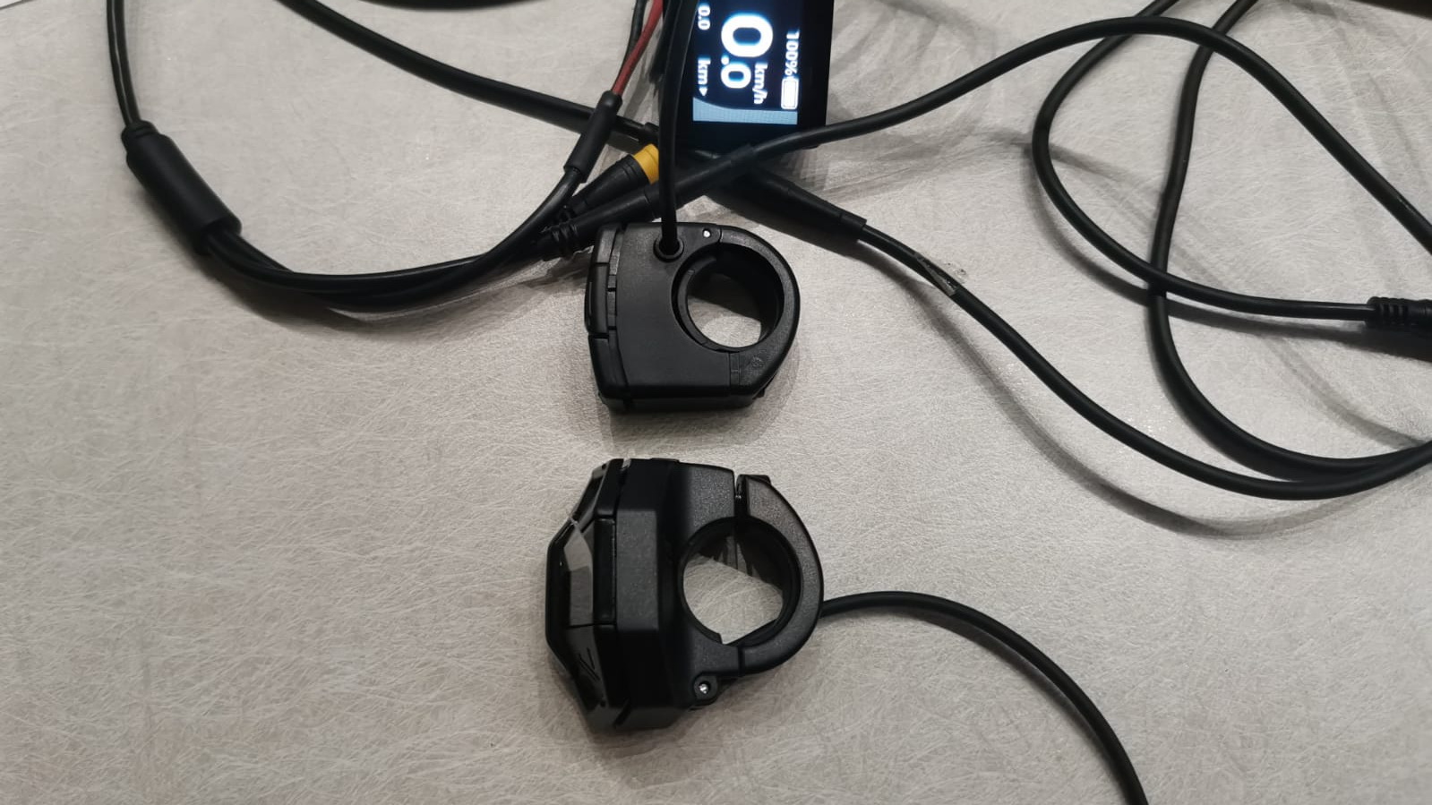

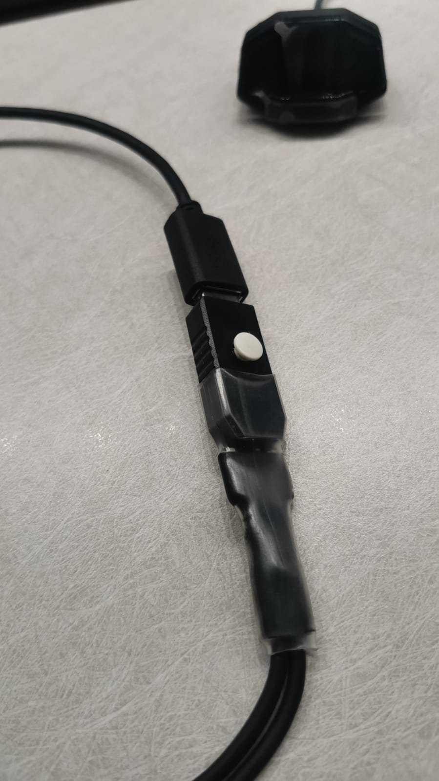

can u take photo the remote from side, so it show how thick it is?

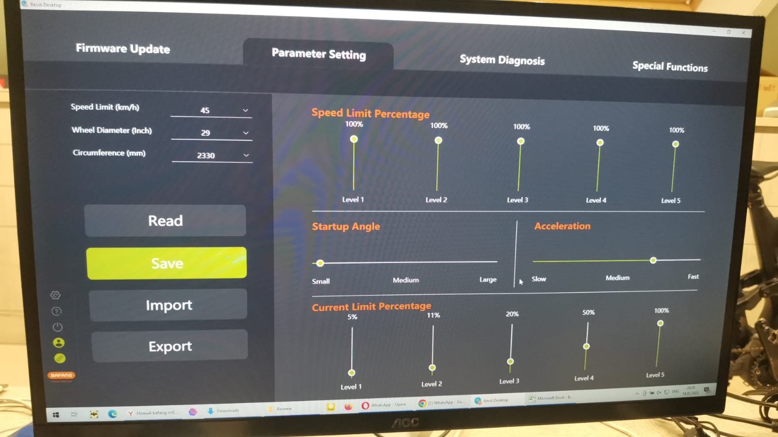

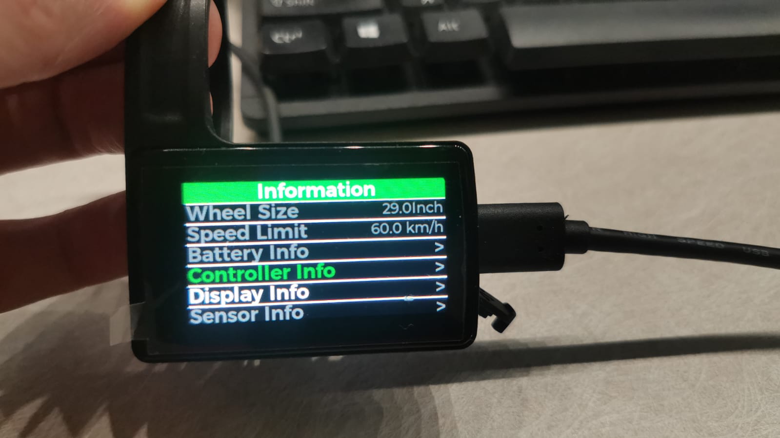

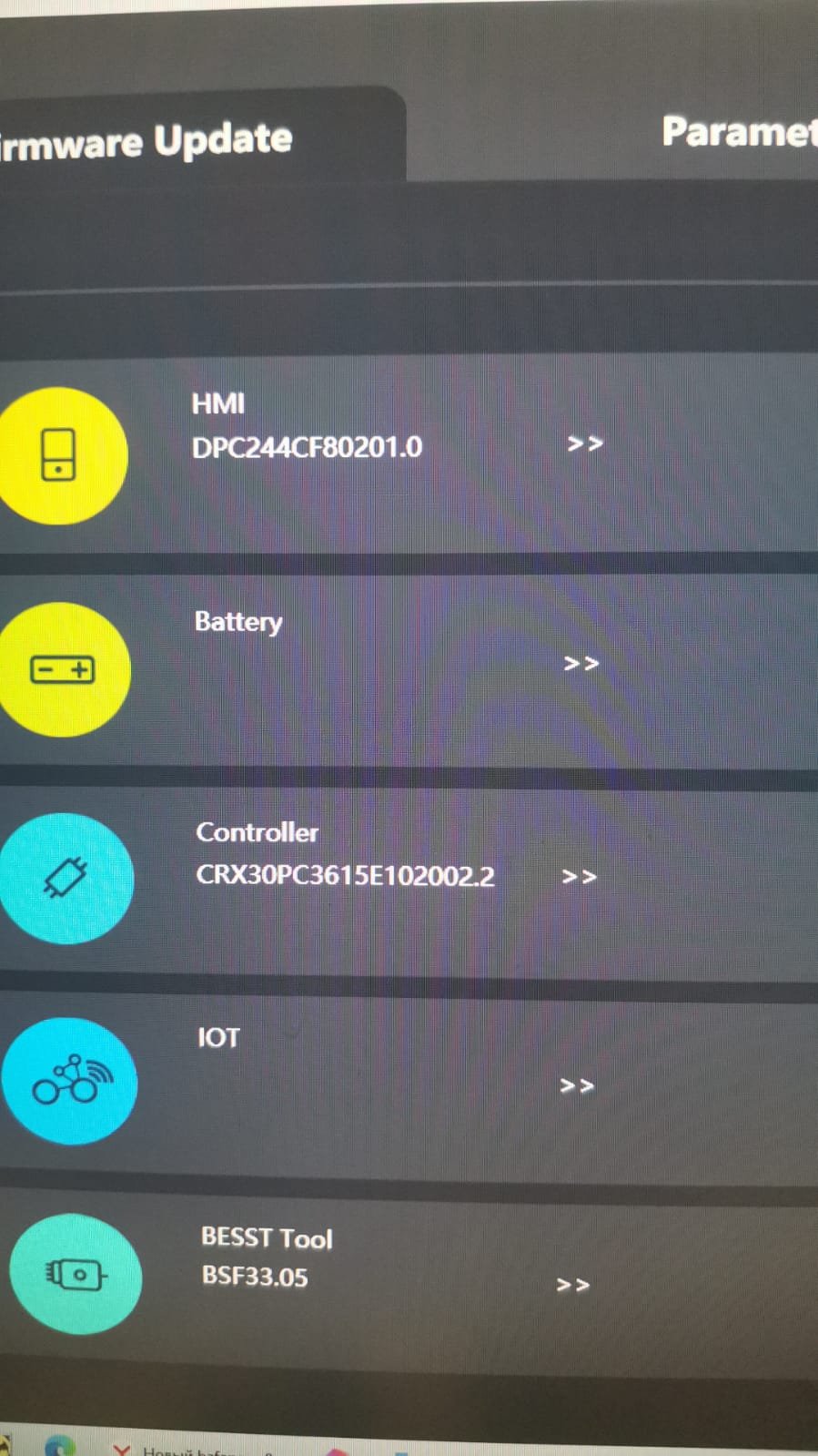

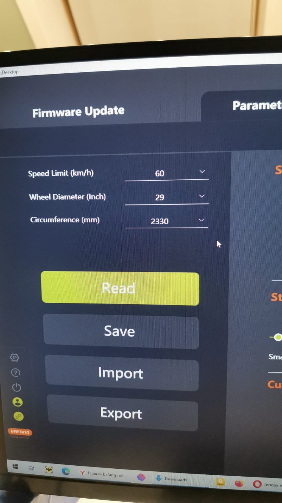

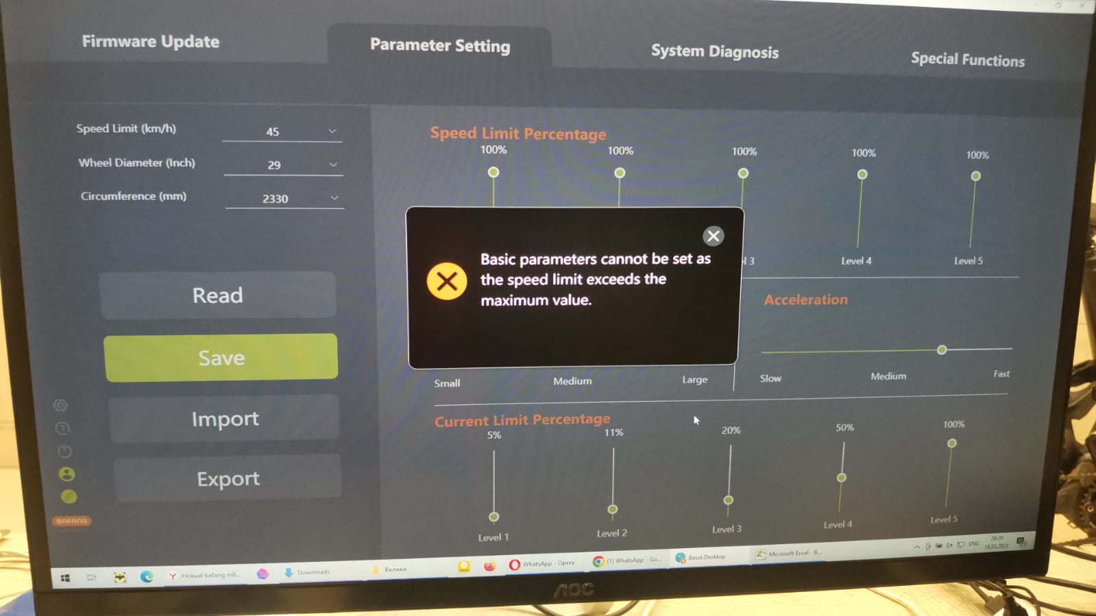

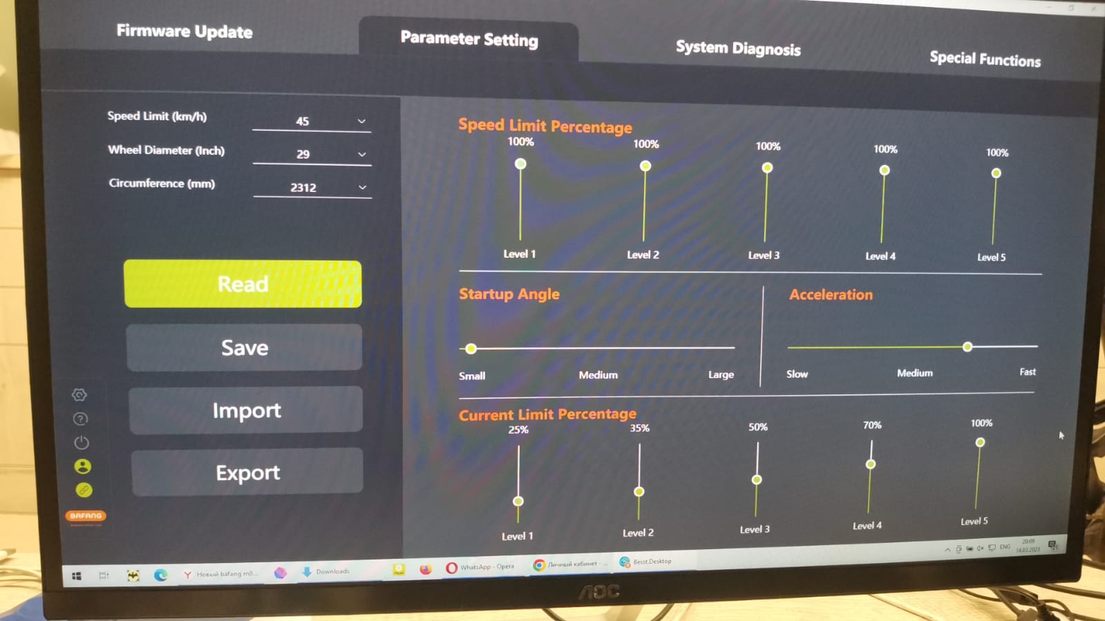

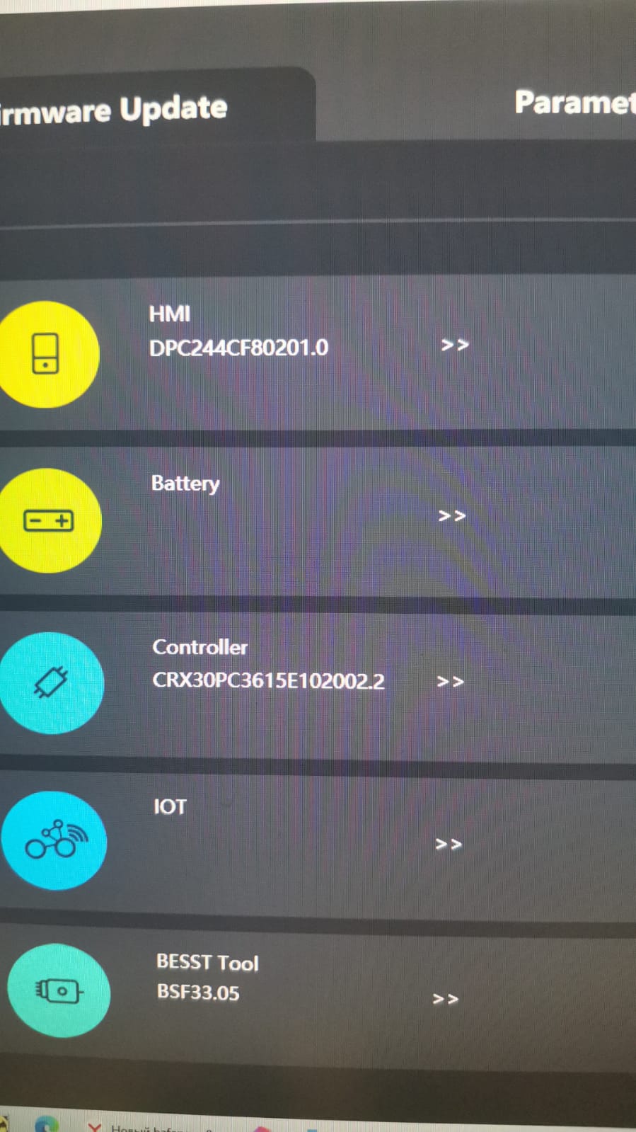

With Best, you can change the diameter of the wheel and the speed is limited to 45 km/h. With the help of the wiring, you can change the limit to 60 km/h
WhatsApp Image 2023-03-14 at 20.51.54.jpeg WhatsApp Image 2023-03-14 at 20.52.03.jpeg

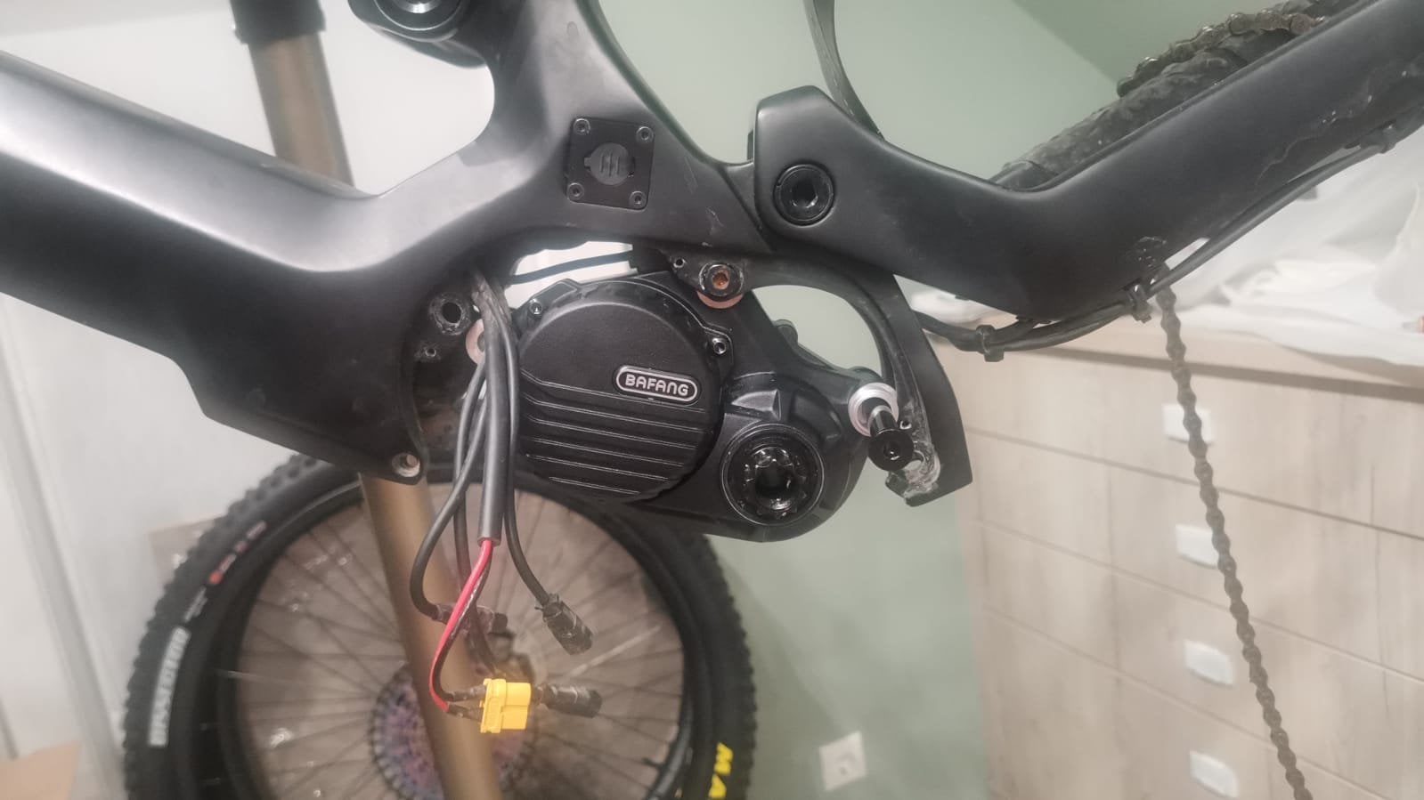

Has anybody tried riding the new motor already? If so, what are your thoughts? How does it compare to m500/m510?

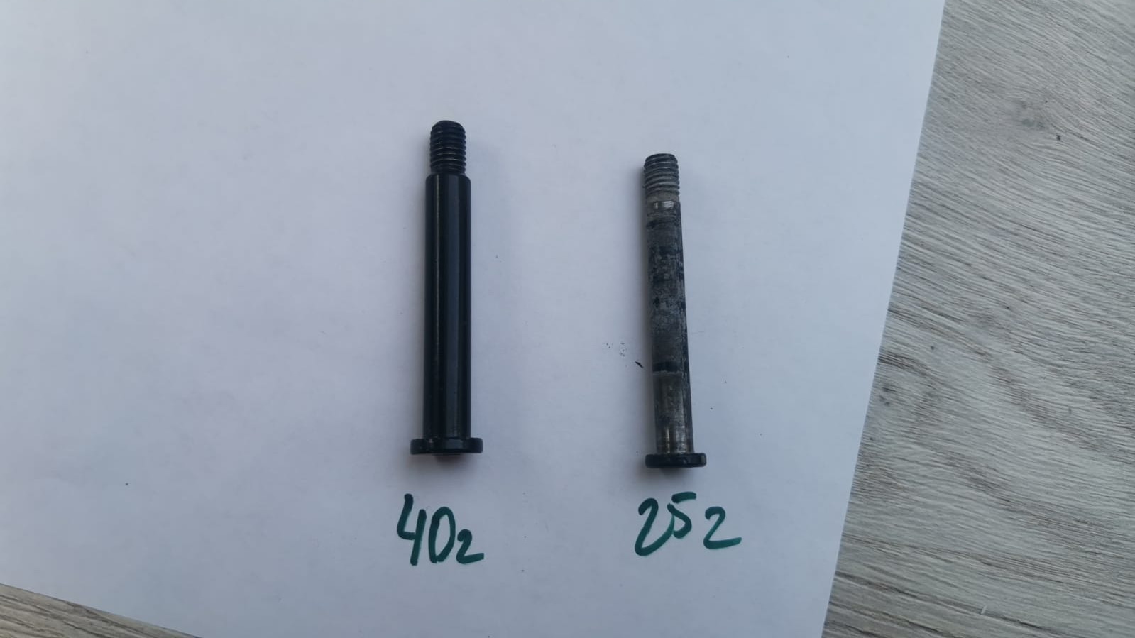

Why make a heavy steel bolt for the M820? An old bolt from the M600.
