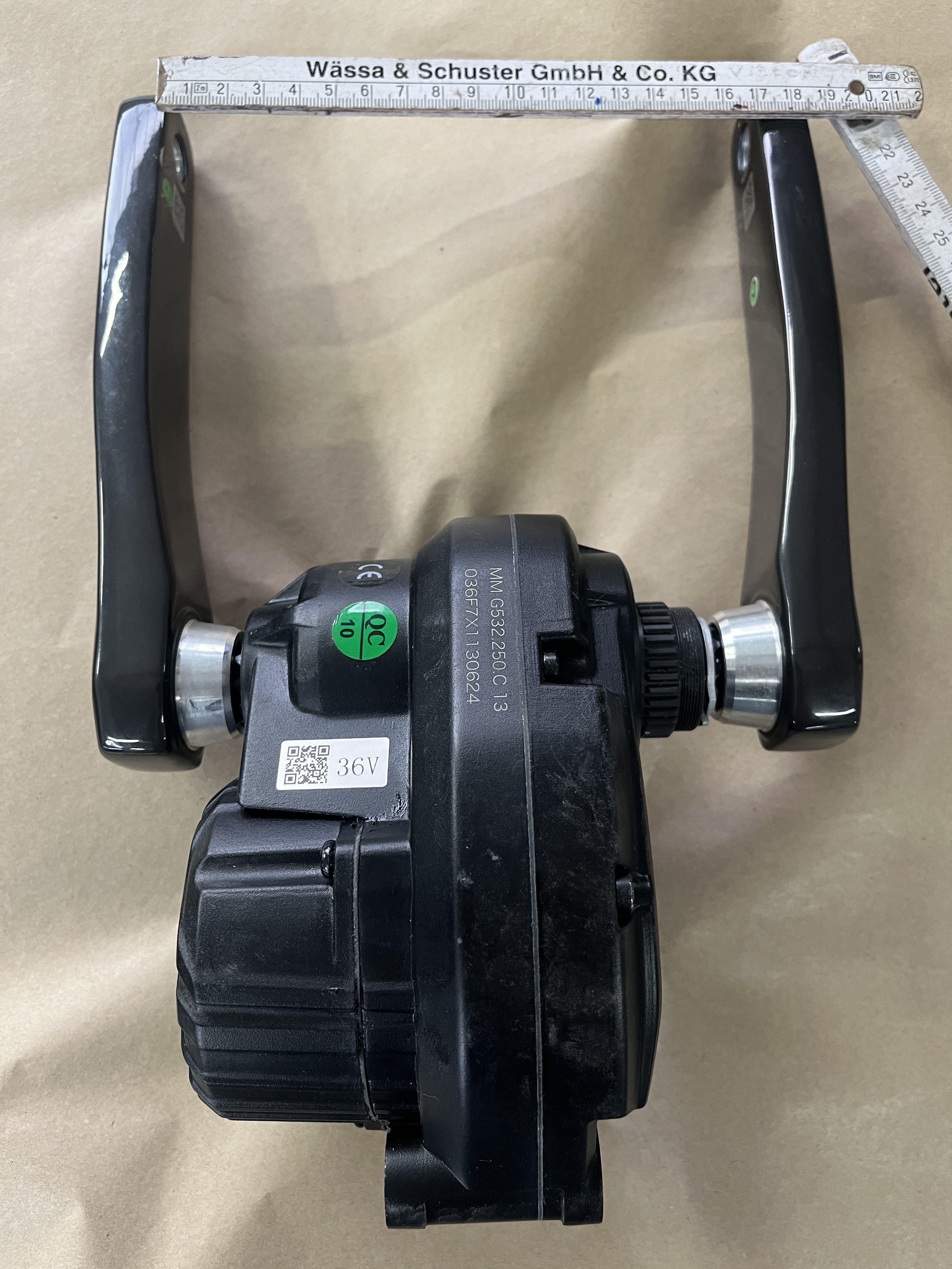

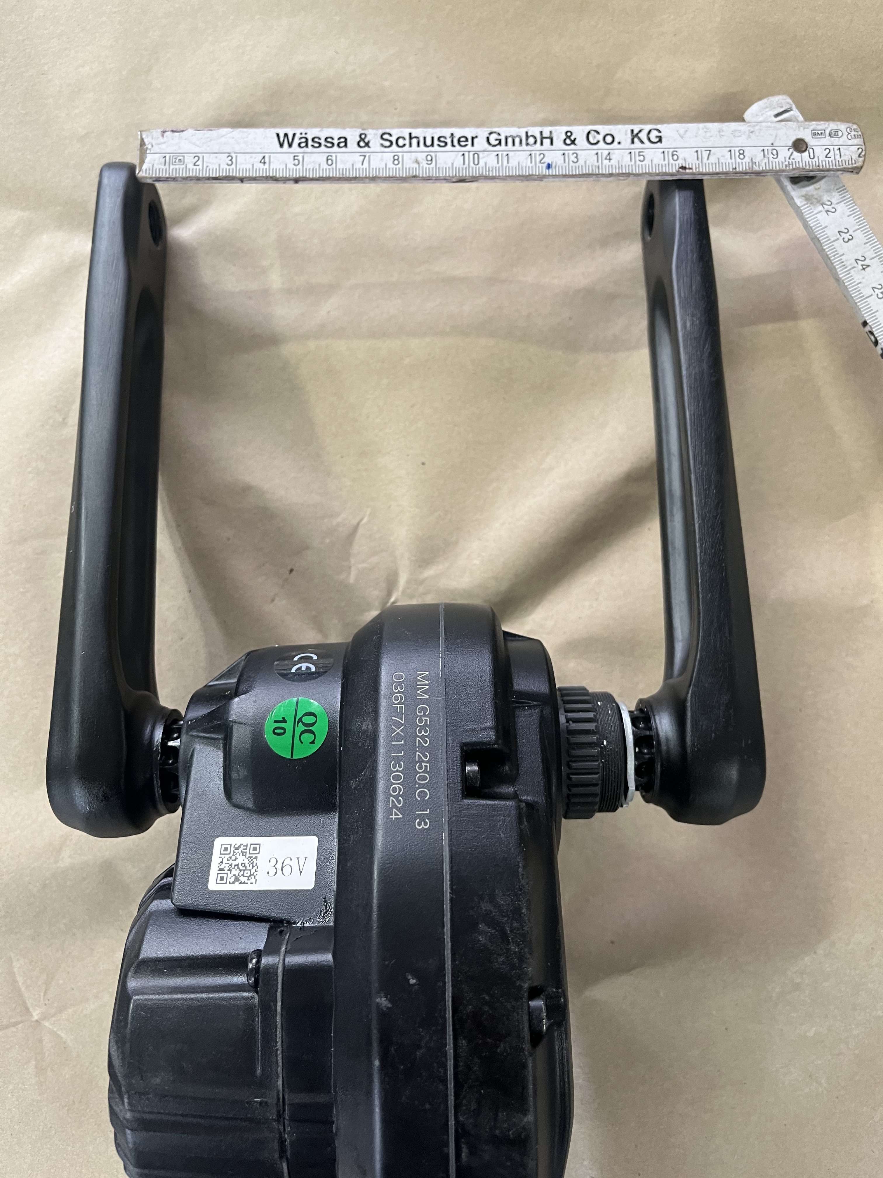

That's a good point. I have the 36V motor on tap. Shoot, I'd be disappointed not to have it, but not a deal breaker. 😇
Currently on my full-powered M600, I stay in trail-mode mostly, and then just do a quick turbo burst-mode through most of my terrain just to maintain flow! Just no HAB whenever possible!🤛
Plus, this mid-powered M820-75 Nm is more of a "fitness" e-rig for me...bonus dropping 8-10 lbs from full-powered...so I'm expecting a little less PAS assistance overall, I will just adjust to reduced peak Nm....I'll survive with it!😉

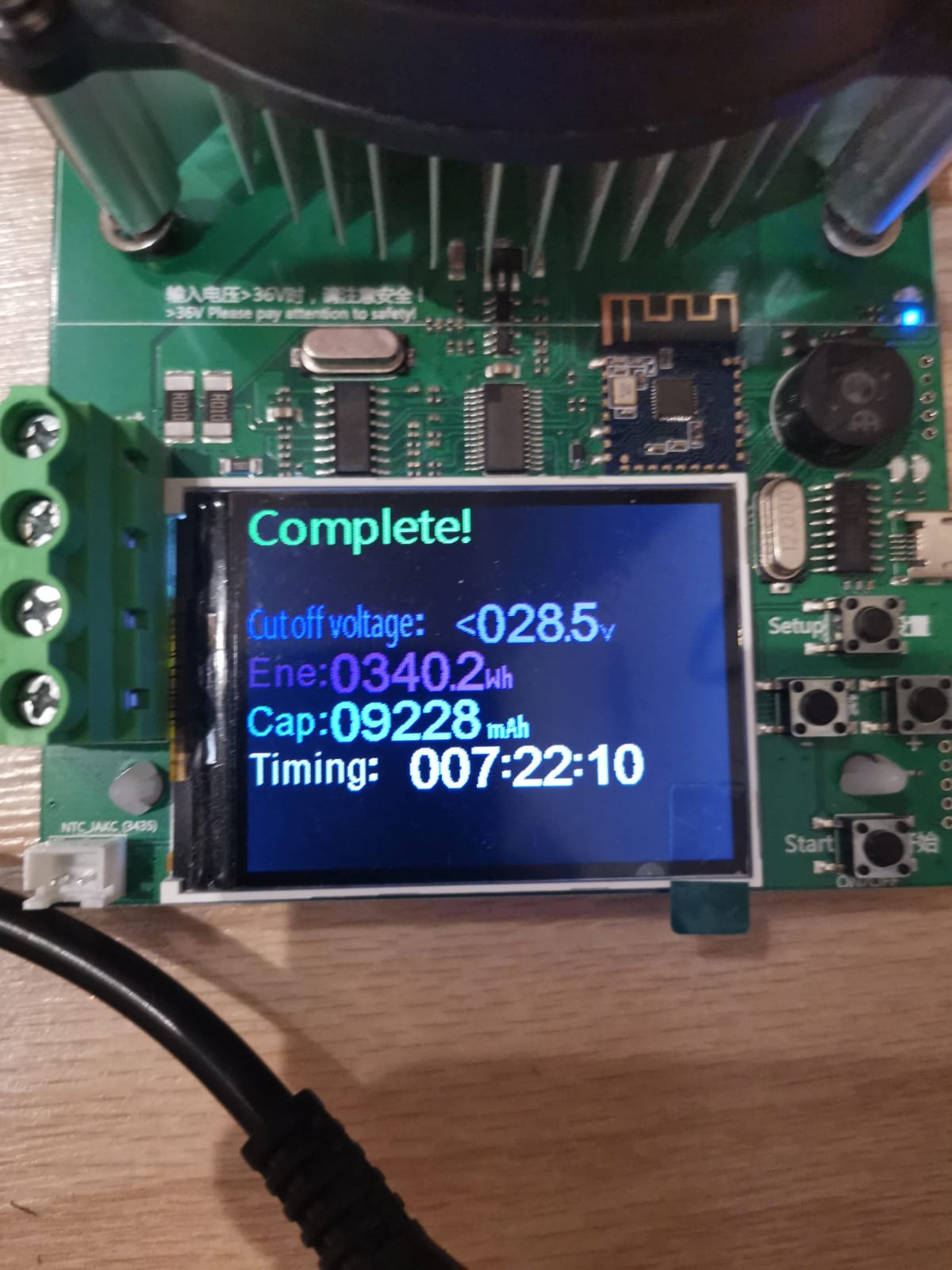

I mean is there a match between the decrease in torque and battery life??
If I understood the question correctly. On the M820 motor, I drove 31 km on one 340W ((9.2Ah) 36V battery. The motor power is 100%. After 20% of the charge, the motor power drops. On the M510 motor with a power of 70%, I drove 44 km, the battery is 12.6Ah 48V. I haven't driven the M510 engine at 100% for a long time, I specially tuned it to get used to the new M820.
Basically, you feel that 70% max of M510 motor = 100% max of M820?
And the M820/340 Wh battery yields 31 km/19.3 mi vs. bigger battery M510/ 700+Wh(?) yields 44 km/27.34 mi?
Flatter terrain?
If so, that's not bad!🤙

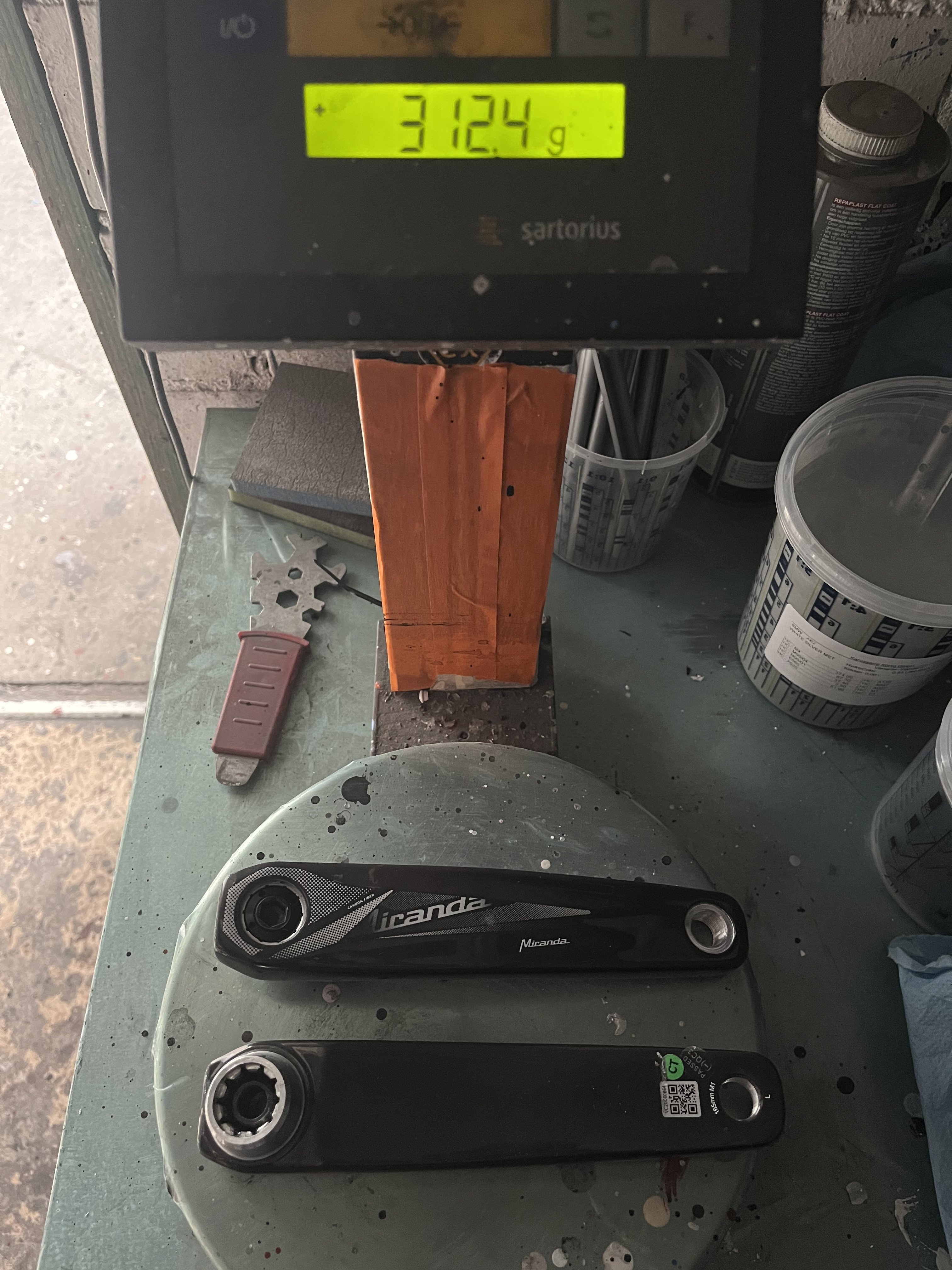

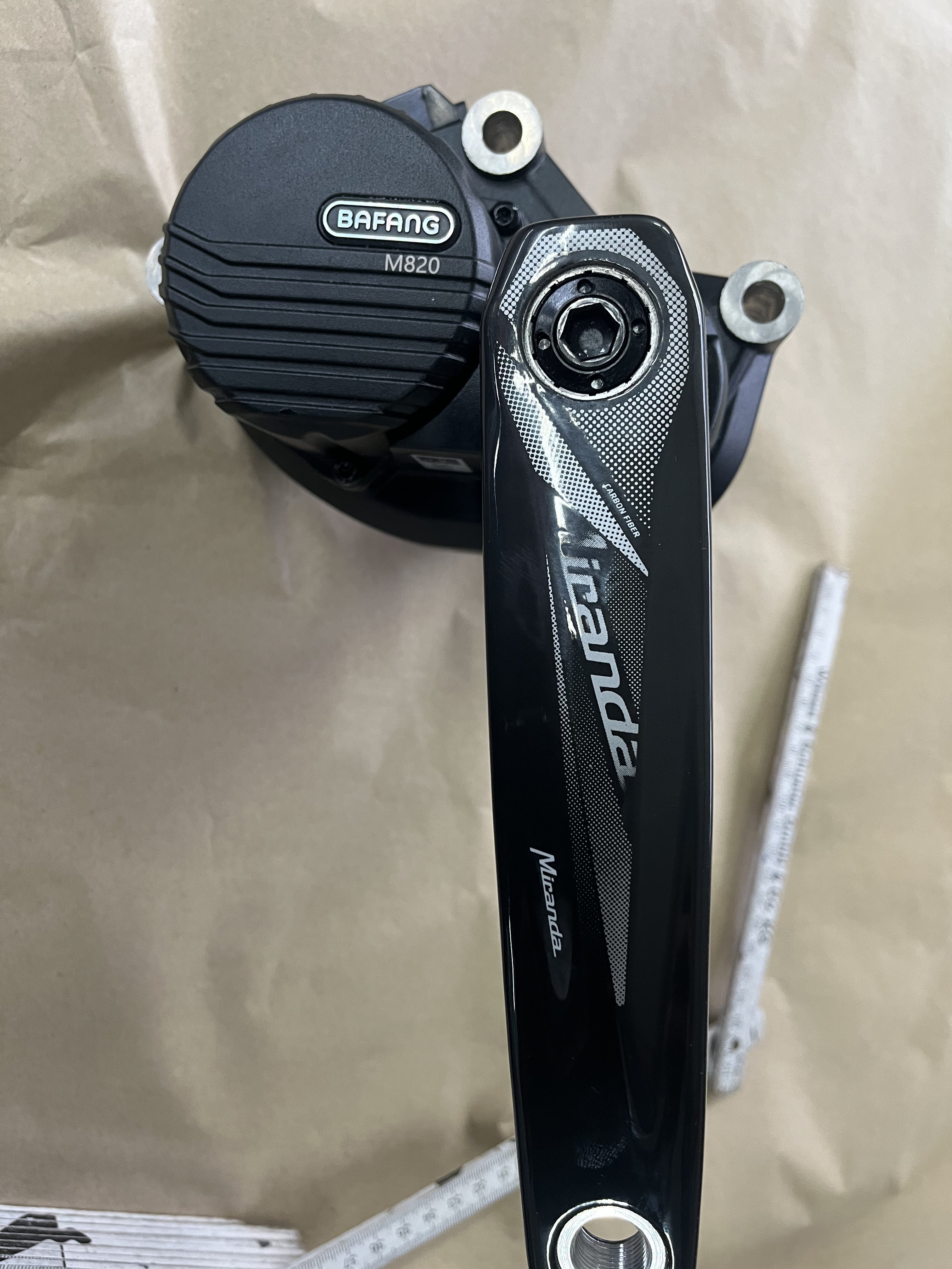

I also want to buy such handles. Tell me please. Have you been using these handles for a long time? What is your weight? I didn't see on the site what user weight they are designed for. If they break, you can lose the most expensive place :)
The cranks make a solid impression, I think they will hold up. I weigh 85 kg and don't worry about it. And at my age it wouldn't be so bad with the best piece either 😆

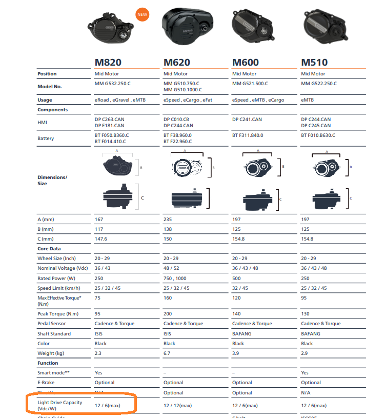

Just for curiosity, how to wire up LED light output to the M820 motor. Could not find any diagram. There is no separate LED light output plug in the motor.
THX
