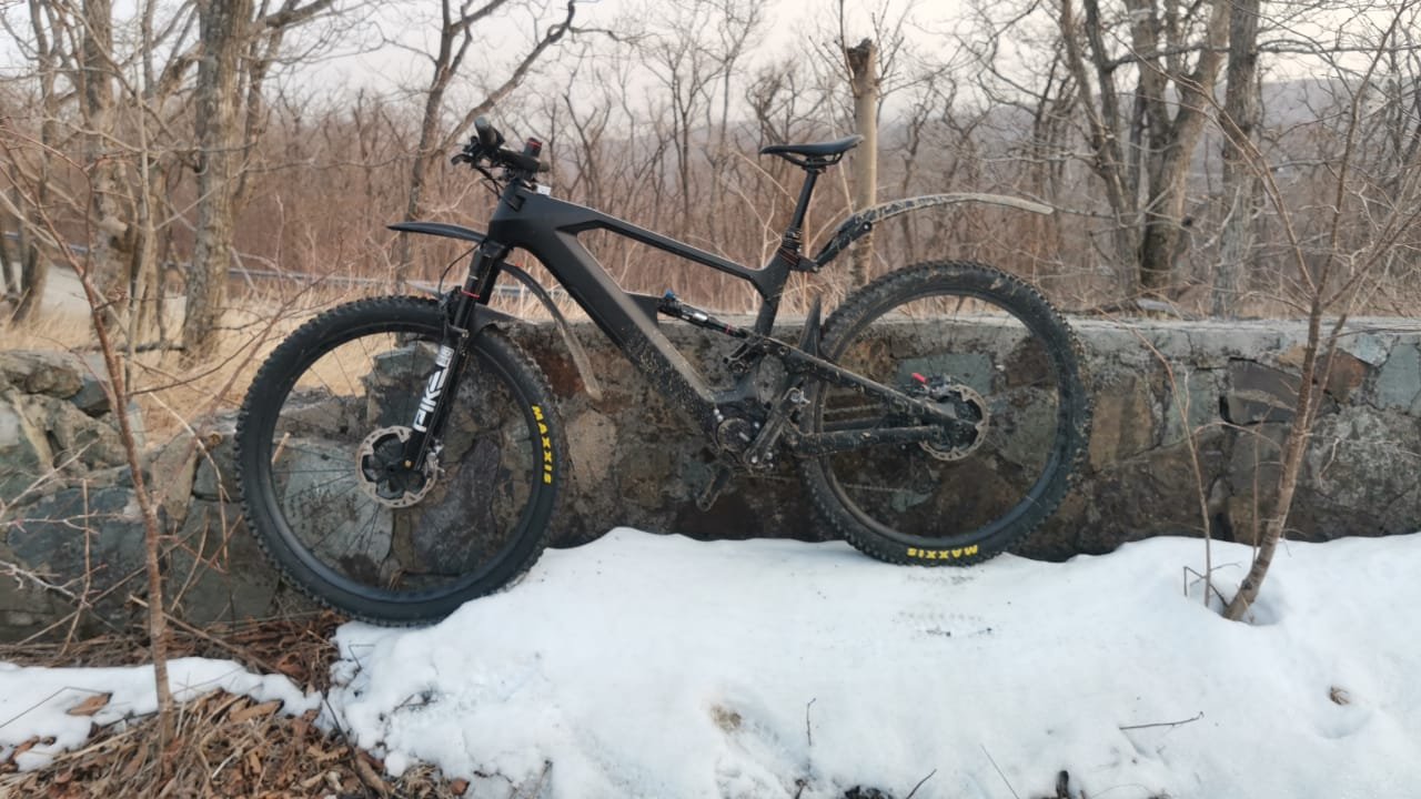

The M820 engine is noisier than the M510 engine. The noise of the motor is very clearly audible. The M820 motor is about 30% weaker than the M510. I didn't understand how to turn on boost 95N mode. I drove 29 km on a 360W battery at 100% power.

that's good. How about power delivery, is it smooth?
I didn't notice the difference between the M820 and the M510. I liked the way the M820 rides. For the last six months I have been driving the M510 with reduced power up to 70%. I had to get used to the new motor :-)
I didn't notice the difference between the M820 and the M510. I liked the way the M820 rides. For the last six months I have been driving the M510 with reduced power up to 70%. I had to get used to the new motor :)
Wow 70% is much. Do you think it's appropriate between the decrease in power and battery usage?
