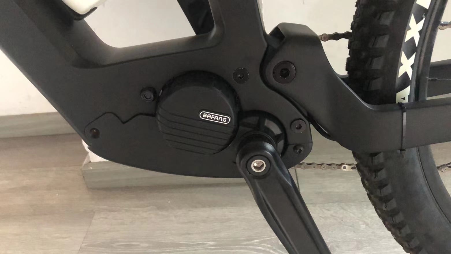

Bafang m820
This won't work because of the "Bafang" gearing

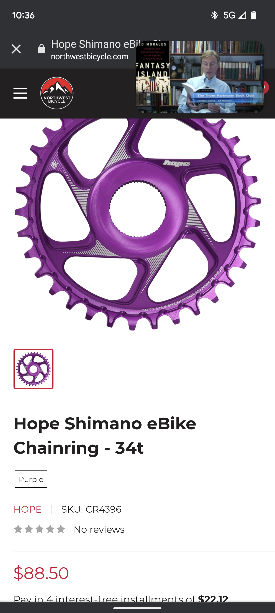

TCFlow told me about this Aurnoet chainring on Amazon for $12. He says he has used it for a year.

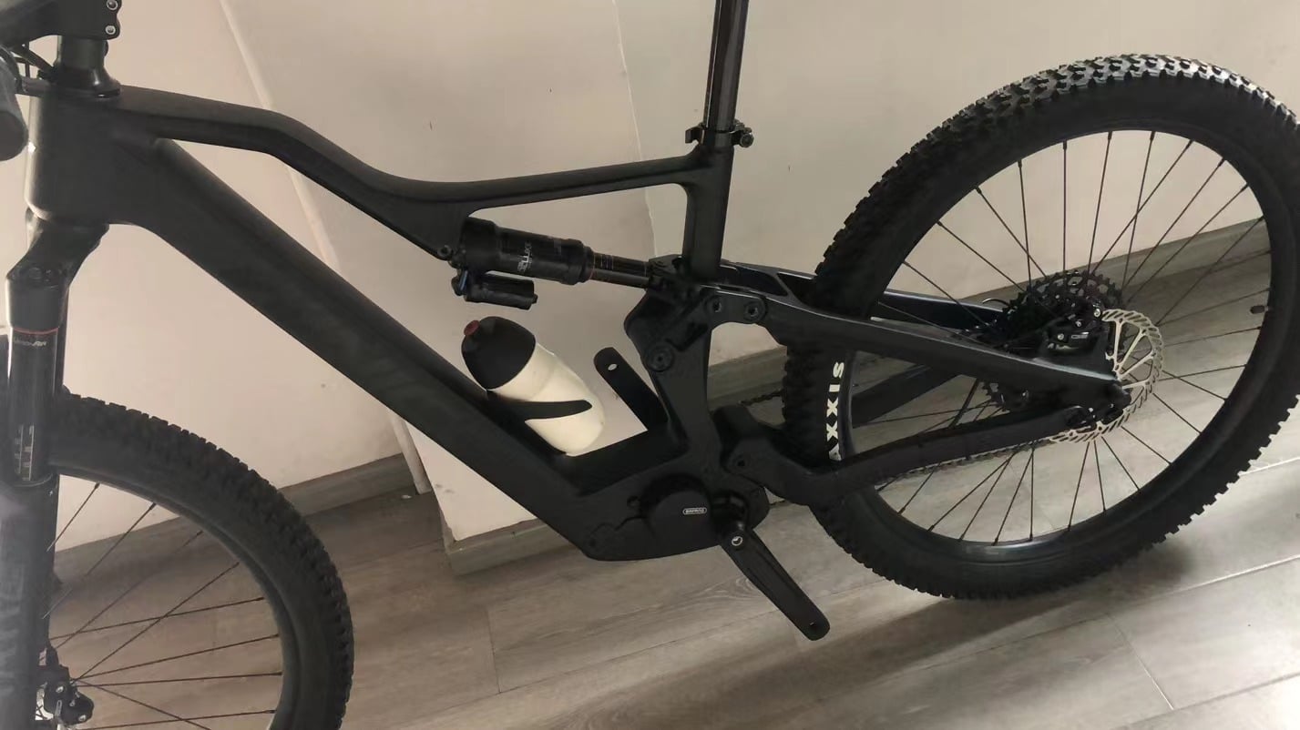

It's different....but not really my style. I like LCE930 best so far.

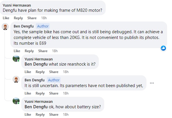

I also like the LCE930. But I want to build a lightweight bike and that's why I chose the CEF50. I think dengfu makes a removable battery. If you look carefully, there is a place at the bottom so that you can pull out the battery.
Sure that make sense. That could be an advantage, over LCE930/CEF50. But it looks like you have to take off the motor cover first or even drop the motor out...it's too hard to tell.
Maybe it's the like Trek Fuel Ex-e and need to flip bike over or put in stand to remove it which isn't bad.
The Transition Relay looks like the easiest of all the mid-powered. Just gain a little weight back into the frame and cradle. I'm surprised that the Relay isn't heavier.🤔

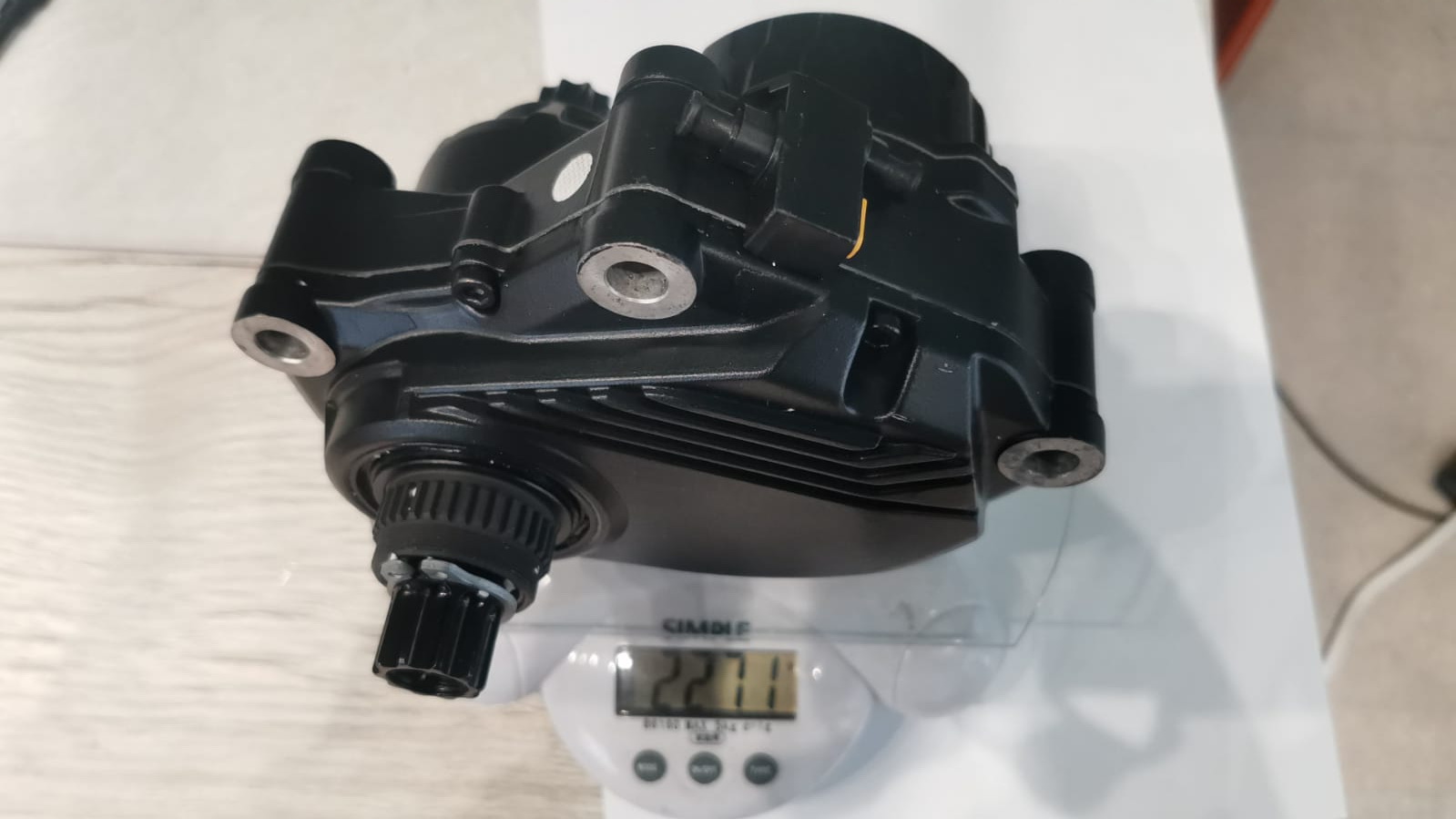

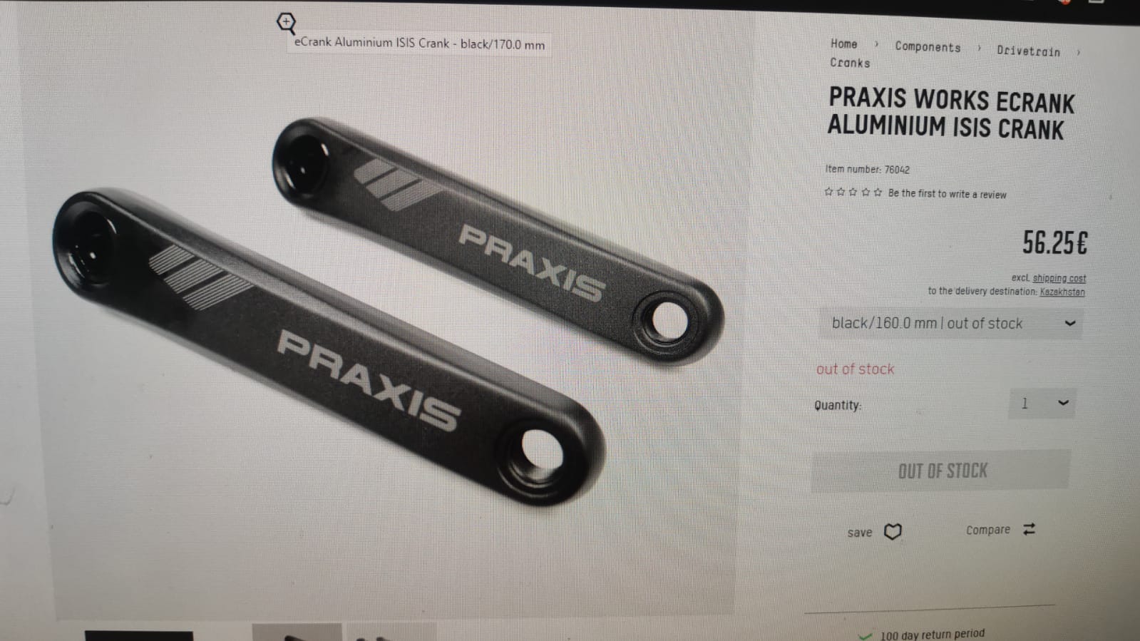

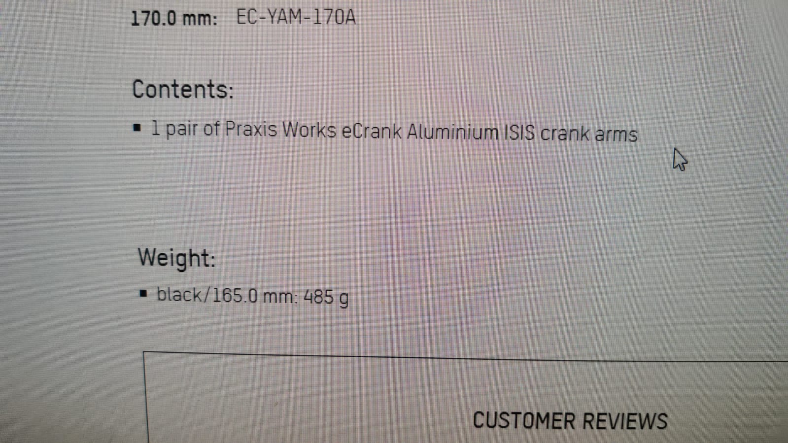

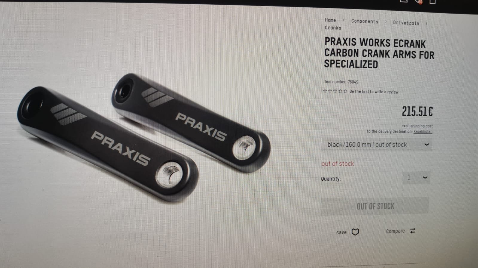

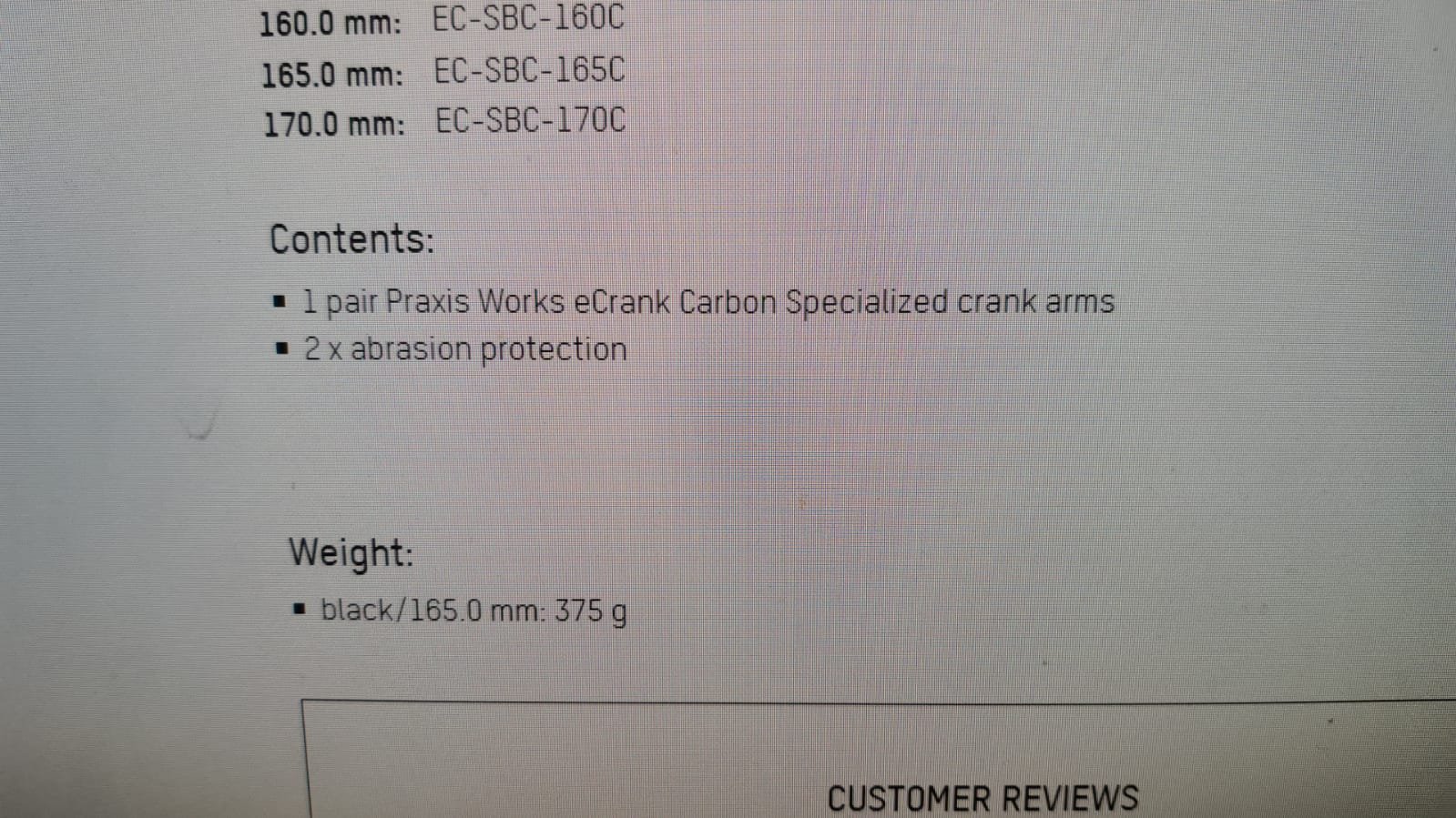

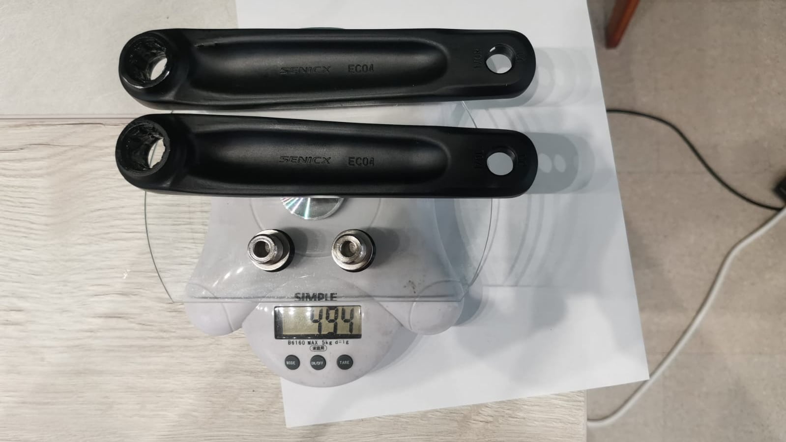

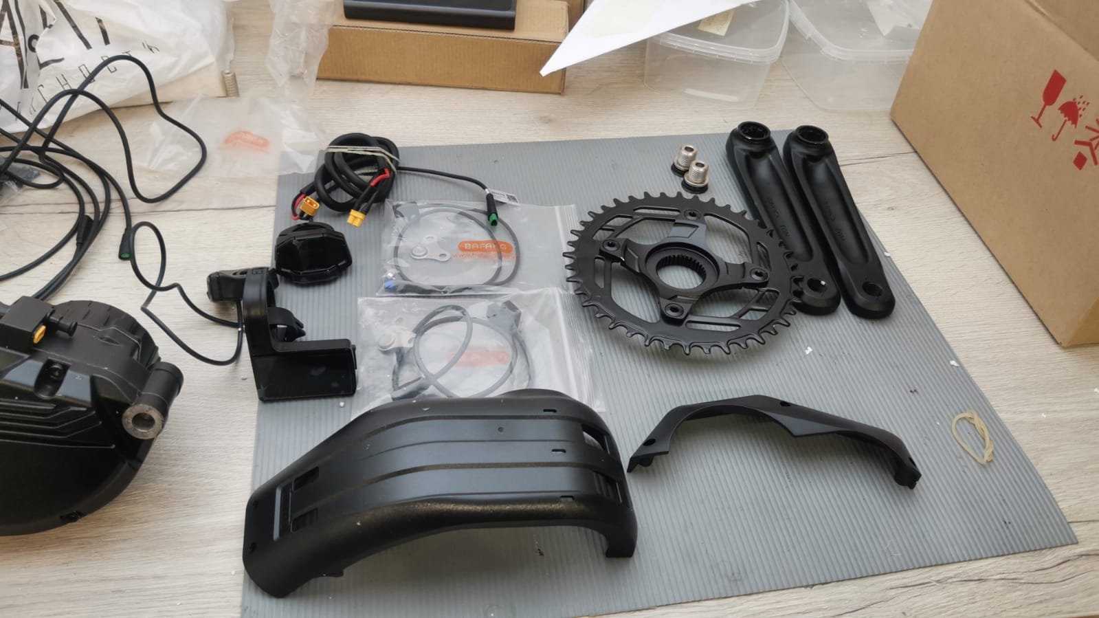

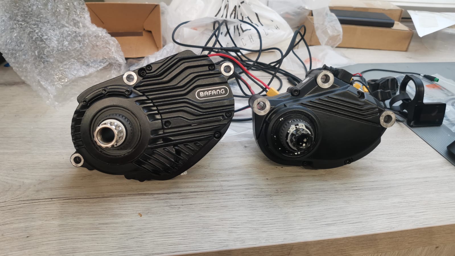

I got the first 36V motor with a 40T star. This motor is for a road bike. Although such a heavy star should be thrown away. Look at the heavy levers 170 mm 495g.

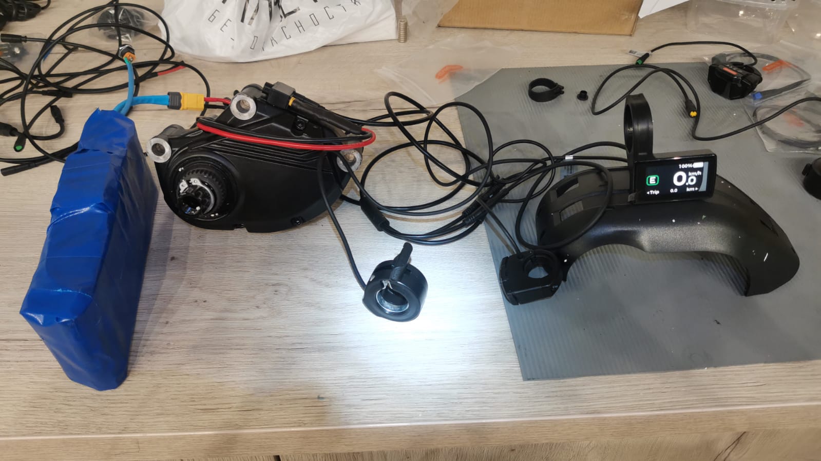

so we need to use 6 bolt rotor type for magnet mounting.
I don't think anyone would want to change the CL XTR rotor. We need to think about how to fix the magnet. On the motor connector XT-30

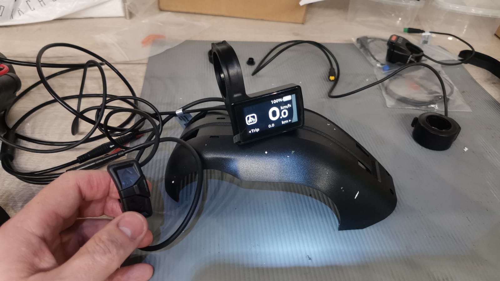

Bafang again made a pedestrian on the remote. Why can't you just hold on - and the pedestrian will start working.
