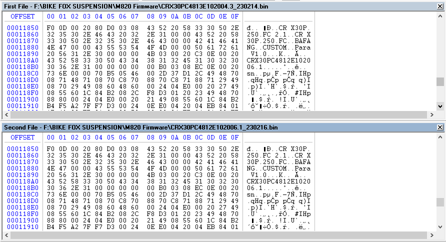

Just a small info, the 48V SW:
-CRX30PC4813E102004.3_230214
-CRX30PC4812E102006.1_230216
Are exactly the same.
Regards

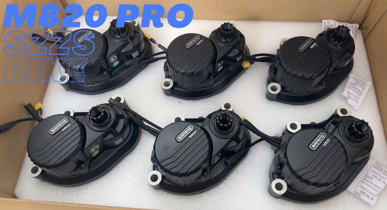

There seems to be an M820 PRO model now. Can’t find any info on it.
New response:
szzsbike
31 min
@volneicycle Bafang M820 Pro vs Original M820 Core Parameter Comparison
1. Rated Power: 250W (EU/China Standard Compliant) —— 250W (Compliant Value Unchanged)
2. Max Torque: 75-80Nm —— 85Nm (Stronger Climbing/Acceleration)
3. Peak Power: Up to 600W (Boost Mode) —— Up to 600W (Same as Original)
4. Q-Factor: 158mm —— 152mm (More Ergonomic Pedaling, Less Knee Load)
5. Waterproof Rating: IPX6 —— IPX7 (Suitable for Deep Puddles/Heavy Rain, Improved Durability)
6. Energy Conversion Efficiency: Conventional Design —— Optimized Stator & Rotor Design
7. Battery Range: Basic Level —— 10%-15% Improved
8. Heat Dissipation: Basic Magnesium Alloy Casing —— Upgraded Heat Dissipation Structure
Core Upgrade Summary
The core upgrades of M820 Pro focus on torque, pedaling ergonomics, waterproof rating and energy efficiency. The rated/peak power remains compliant with no additional power increase, only optimizing power output and user experience.

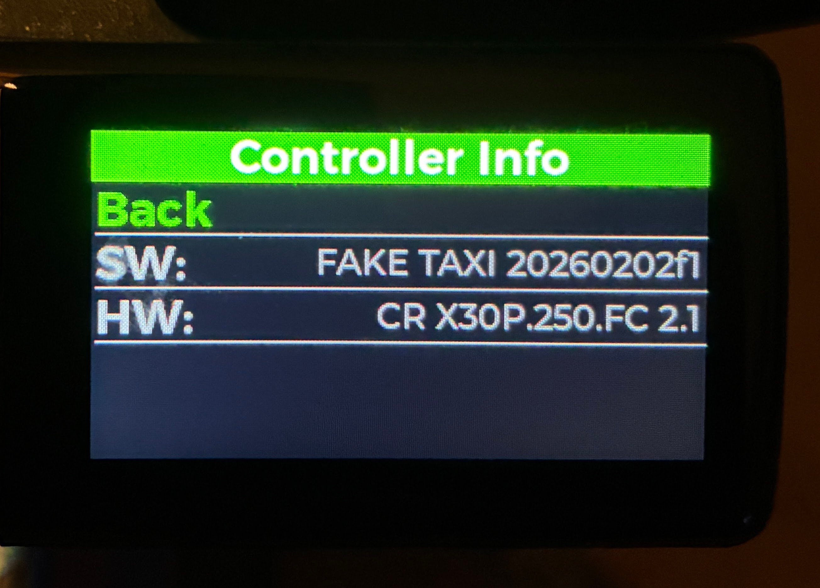

During the night, test versions of "Fake taxi" for all battery voltages from 10S to 14S appeared. Read the description and choose the right one.
Thank you for this! I tried the 13S f1 version today with a 48V battery. This was the smooth version. Indeed it is very smooth, very gentle power delivery and almost no override. I will try the other version at some point, but this is how I like it. Very natural feel, needs a lot of rider input to get all the power available. It feels very similar to the 43V version 2004.5 I have been running for a long time already. More natural, but also feels like less power.

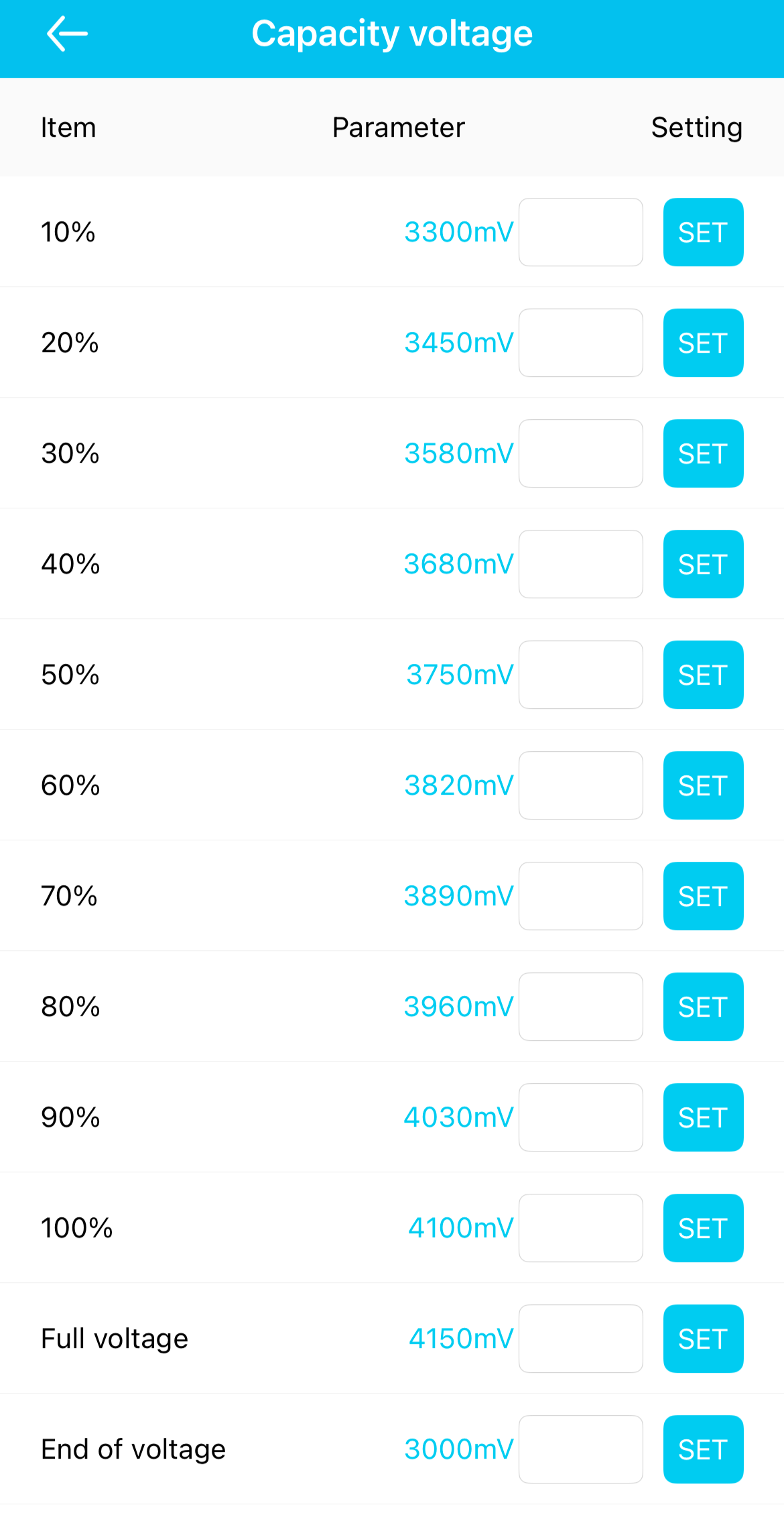

I did a 1.5h ride today going from 94% to 20% on the display. It felt like it was dropping too fast, even if I was on boost mode all the time and it was a cold ride, -15 degrees C. I took some screenshots during the ride from my JBD bms app, it was showing different figures. At the start I was at 100% going down to 41% at the end. The percentage showing on the display is not the same as in the graph in the readme file for this firmware. My JBD values are bms stock values, altough they can be configured in the app.
I did not run the battery empty so I cannot comment on performance under 20% yet. And I forgot to test the walk mode.
But all and all this seems like a very good firmware.
