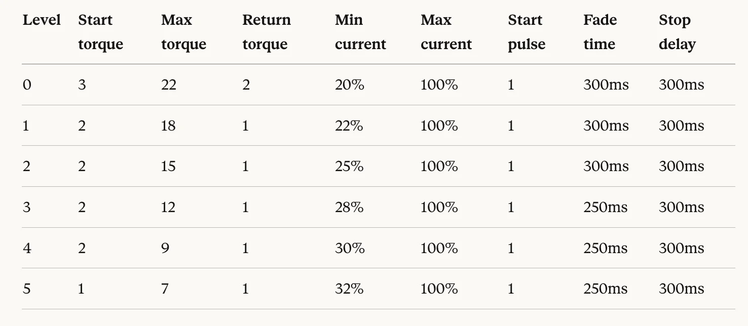

Reverse-engineering the M820 torque table – rider torque thresholds instead of motor limits
Hello,
while working with OpenBafangTool on the Bafang M820, I started looking more closely at how the torque table actually affects the behaviour of the motor.
After testing multiple configurations, I am fairly convinced that many conclusions about the motor performance are based on comparing firmware presets, not on understanding how the assist curve is really calculated.
Different default profiles are often compared, and the resulting ride feel is then interpreted as a limitation of the motor itself.
From my testing this does not seem correct.
The biggest influence comes from the torque table, not from the hardware limits.
The parameters Start torque, Max torque and Return torque behave like rider torque thresholds used by the internal assist algorithm, not like motor torque limits.
Start torque
→ rider torque where assist begins
Max torque
→ rider torque where full assist is reached
Return torque
→ rider torque where assist starts to decrease again when input drops
This can be verified easily by lowering Max torque.
The motor feels stronger and reaches full assist earlier, even though current limits and max power stay unchanged.
That would not be possible if the value defined motor output.
To get a realistic reference, I converted the torque values to actual pedal force.
With 165 mm crank length:
1 Nm at the torque sensor ≈ 0.62 kg pedal force (horizontal crank position)
This gives reasonable real-world numbers:
Max torque 20 → ~12 kg pedal force
Max torque 15 → ~9–10 kg
Max torque 12 → ~7–8 kg
These values correspond quite well to typical rider force at moderate cadence.
From this perspective many default tables seem to assume higher rider torque than what is actually applied in normal riding, especially at medium and high cadence.
As a result the motor feels less responsive, even though the hardware would allow more assist.
My riding style is mostly constant cadence around 50–80 rpm, because I shift gears and try to stay in an efficient range.
At lower cadence more force per stroke is possible, at higher cadence less force but higher speed.
So I tuned the torque thresholds depending on cadence range instead of using one fixed behaviour.
Example setup:
Level 2 (40–60 rpm)
Start torque 2
Max torque 15
Return torque 1
Level 3 (60–80 rpm)
Start torque 2
Max torque 12
Return torque 1
Level 4 (80–100 rpm)
Start torque 2
Max torque 9
Return torque 1
With this configuration full assist is reached at roughly 7–10 kg pedal force, which feels much closer to natural riding than the default settings.
Fade time also has a large influence on the perceived behaviour, so I use higher fade at low cadence for smoothness and lower fade at higher cadence for more direct response.
Start pulse = 1
Stop delay ≈ 10 ms
I also lowered the torque thresholds slightly because I am currently not at peak fitness after winter.
Increasing the values later is an easy way to increase rider effort without changing assist level.
From my point of view the M820 has significantly more usable range than what most default setups show, and tuning the torque table based on real rider torque makes a bigger difference than switching between different firmware presets.
Would be interesting to hear if others have tried to map the torque table to real pedal force instead of just copying firmware settings.

Yes, that matches what I see as well.
While testing different torque table settings I also monitored the power values on the Bafang display to make sure that the motor limits were not changing.
With my current setup, using the assist levels from the display, I get about 530 W on the second highest level (set to 90%), which is exactly in line with the manufacturer specification.
On the highest level (100%) the motor reaches around 580 W, which also fits with the expected limit for a 48 V / 12 A configuration.
I rarely use that level because I do not want to stress the motor permanently.
This behaviour seems independent from the firmware file itself.
What really matters is the battery voltage setting and the current limit.
With my 48 V battery (840 Wh) the controller does not allow more than 12 A to be written with OpenBafangTool.
That results in about 48 V × 12 A ≈ 576 W, which is exactly what I see on the display.
There were some firmware files circulating that claimed higher current (for example 13 A at 48 V), but when people compared them, they turned out to be identical to the 48 V / 12 A versions, and my measurements also never showed more than 12 A.
Because of that I am quite sure that the motor power limit is not what changes the riding feel in most cases.
What makes a big difference for me is the torque table, especially the Max torque thresholds, because they change how much rider force is needed to reach full assist, even when the maximum power stays the same.

From what I can see in OpenBafangTool, the cadence ranges are defined by the levels 0–5, which seem to represent steps of about 20 rpm up to 120 rpm. These values appear to be fixed.
Since Bafang specifies support up to around 120 rpm, it makes sense that the assist is calculated based on both rider torque and cadence.
Because of that I started looking at the torque table as a rider input threshold, not as motor output.
By measuring pedal force directly (for example with a hanging scale at the pedal) it becomes easier to estimate which torque values correspond to realistic rider effort, and then adjust the Max torque values depending on when full assist should be reached.
Start torque defines when assist begins,
Max torque defines when full assist is reached,
and with the fade / pulse / delay parameters it is possible to control how strong and how smooth the assist comes in.
This makes it possible to tune the motor either for a more natural feeling or for stronger and earlier support.
Since I live in Switzerland and ride a lot of steep climbs, I currently use a setup with earlier and more continuous assist, so the motor reaches full support at moderate pedal force instead of only at very high input.

Yes, I appreciate the feedback, it helps a lot when trying to understand how the controller really behaves.

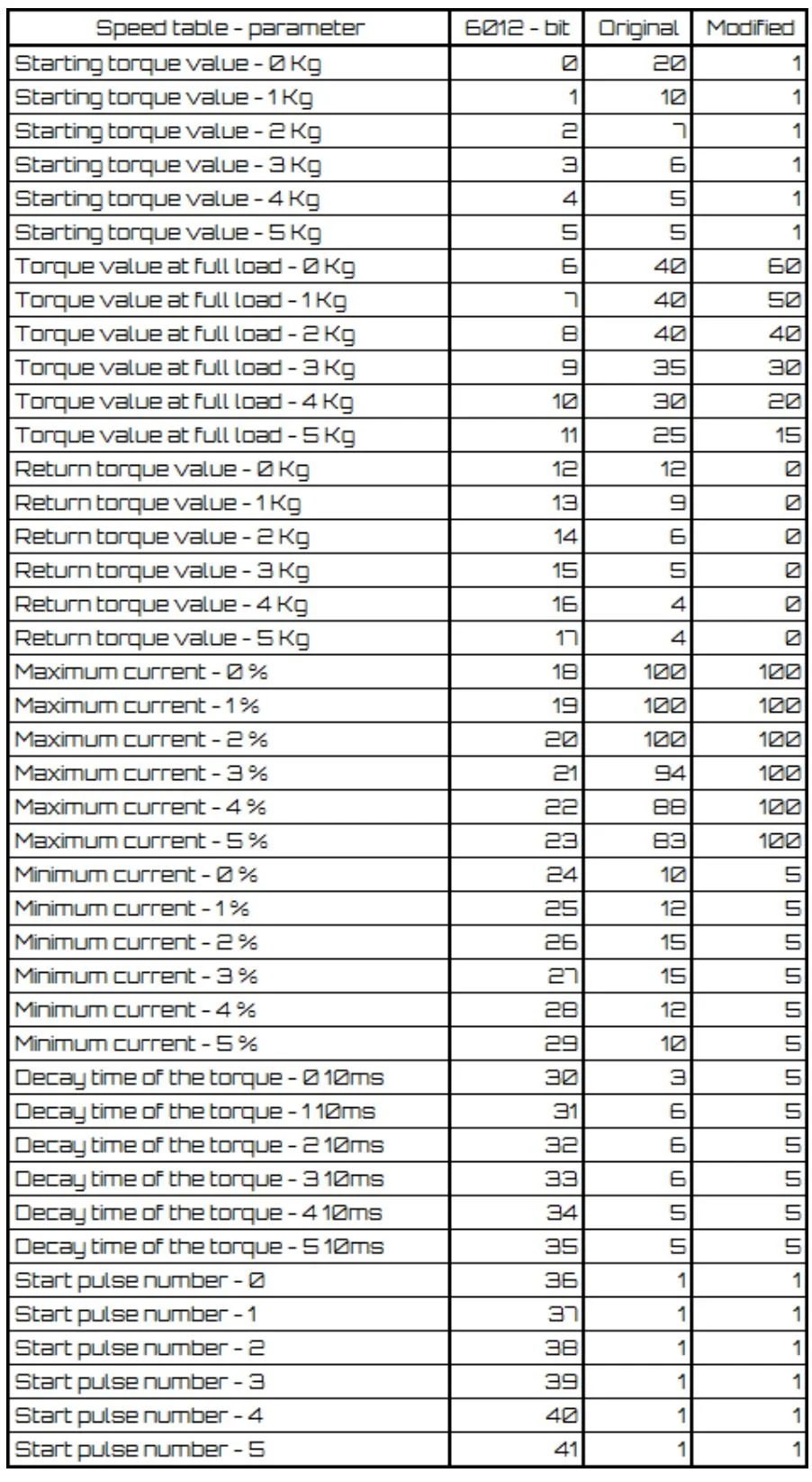

The speed table is speed-dependent, not cadence-dependent. Even if you modify the speed table, it has no effect on engine behavior, that's why the FT project was created.. Developer info
Interesting to see how far you have moved the numbers from the manufacturers. Looking foward to the 52V 14A version to try 😀
