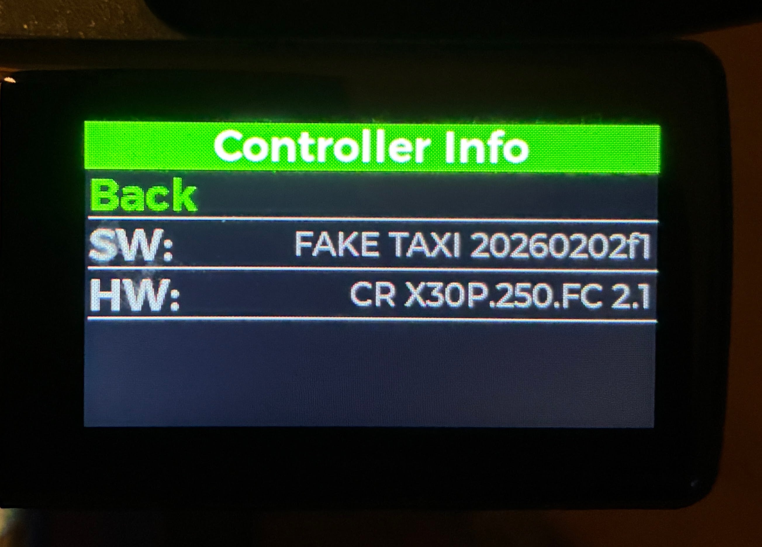

Thank you for this! I tried the 13S f1 version today with a 48V battery. This was the smooth version. Indeed it is very smooth, very gentle power delivery and almost no override. I will try the other version at some point, but this is how I like it. Very natural feel, needs a lot of rider input to get all the power available. It feels very similar to the 43V version 2004.5 I have been running for a long time already.
I did a 1.5h ride today going from 94% to 20% on the display. It felt like it was dropping too fast, even if I was on boost mode all the time and it was a cold ride, -15 degrees C. I took some screenshots during the ride from my JBD bms app, it was showing different figures. At the start I was at 100% going down to 41% at the end. The percentage showing on the display is not the same as in the graph in the readme file for this firmware. My JBD values are bms stock values, altough they can be configured in the app.
I did not run the battery empty so I cannot comment on performance under 20% yet. And I forgot to test the walk mode.
But all and all this seems like a very good firmware.

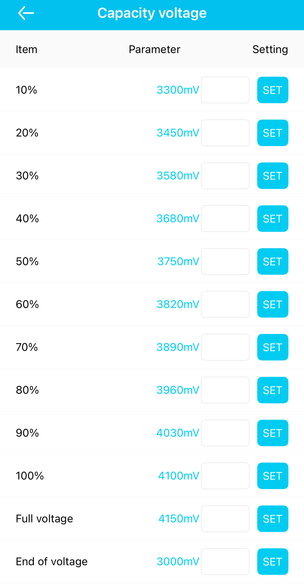

From Your measurements the voltage map seems not too look edited properly. At 20% at display and 45V it gives about 3,46V a cell, which is a lot.
From the readme.pdf for 13s battery at 20% at the display You should be getting about 42,7/13=3.28V and closer to 3.1V at 10%. I'll try to get that checked when I am back on track.

So FAKETAXI20260210f1 tried and tested. Feels good, power delivery is smooth. I don't know if I were imagining, but it felt like maybe a tiny bit more overrun than the 20260202f1. Not much in any way, but the earlier version had close to zero. This felt good, since it is predictable.
I was using 720Wh so I only got it down to 50% in 1h 45 minutes (it is flat where I ride). Still now the percentage on the display seems more or less accurate.
Walkmode is actually usable now.

I prefer to use on start : FT_2026_02_02_f1
