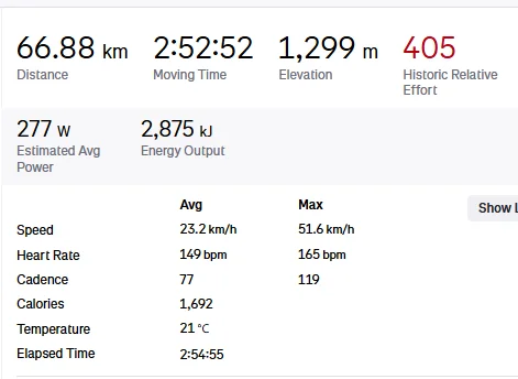

Yesterday was MTB race, 66.88 km, 2:52:52 time and 1,299 m elevation:
with fake taxi I ended up with 7% - I was switching modes - most of time in S, sometimes S+ and B, last 17 km - B mode.
here is strava link - Red Planet 2026 | Strava
I really like fake taxi FW over stock ones (y)

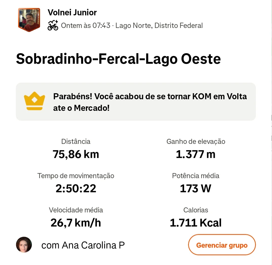

So I believe we did a similar ride in terms of distance and elevation, using the fake 48v taxi.
Me - 72kg, 720 battery, T and S modes, 38% battery remaining FakeTaxi 20260210f1 more linear
Wife - 81kg, 720+260 battery, S+ and B modes, 28% remaining FakeTaxi 20260210e1 more strong
Strava: https://strava.app.link/5EjA66WQi2b
