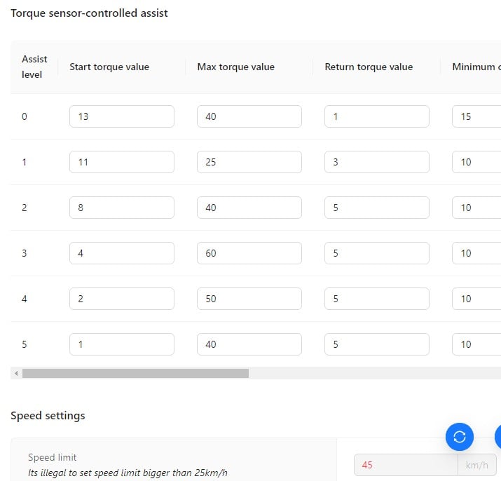

When you write to the controller, are you able to re read those values once you turn the motor off and on, as in the motor must overwrite those values from its firmware or ignore all the parameters which seems a bit strange ?
Yes values are saved and controler remember them after on/off.
Could you try these values as an experiment ? They definately gave a difference on my motor but as I'm using 48V firmware, are the 48V firmwares unlocked. The other difference is I'm using the BESST Tool with OpenBafangTool software.
Only one way of finding out I would guess and that is if you try these figures and that eliminates one factor, the software.
Yes, just tested, feel the same. It goes full power on low torque.

I also tried adjusting the motor assist parameters some time ago, and I can say with full certainty that they do not cause any noticeable changes!
All you need to do is flash different firmware versions as a test, then check the values entered in the fields like "START TORQUE VALUE", "MAX TORQUE VALUE", etc., and finally test how the motor behaves in practice — I assure you, the difference is not subtle.
I’ve tested all available firmware versions for 48V, 43V, and 36V, and honestly, even Pinocchio would feel the difference.
