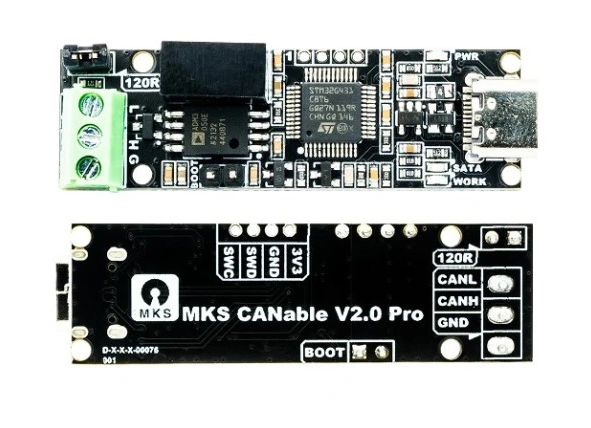

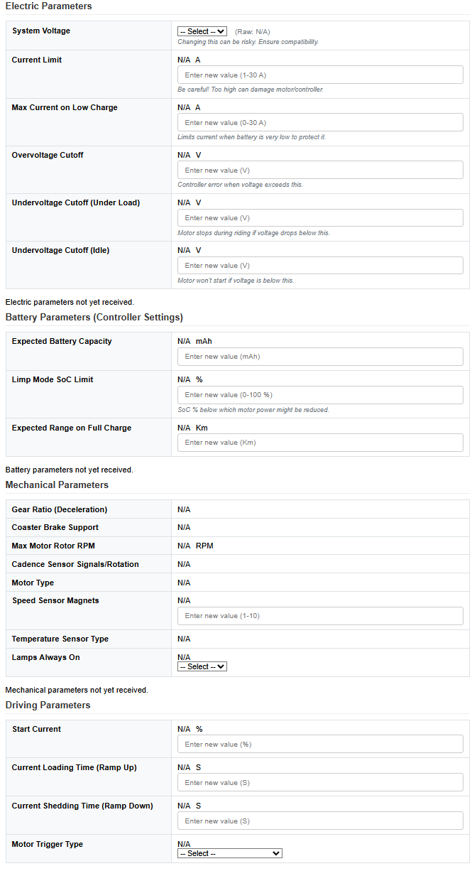

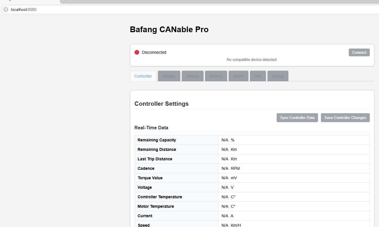

There is also Canable tool:
Someone test this with M820 ?
Best looking and probably the most comprehensive but won't work with the BESST interface, only with CAN sniffers and you need a computer degree to get it running in Windows :) . It probably will in time be OK but not just yet to those with the BESST tool.

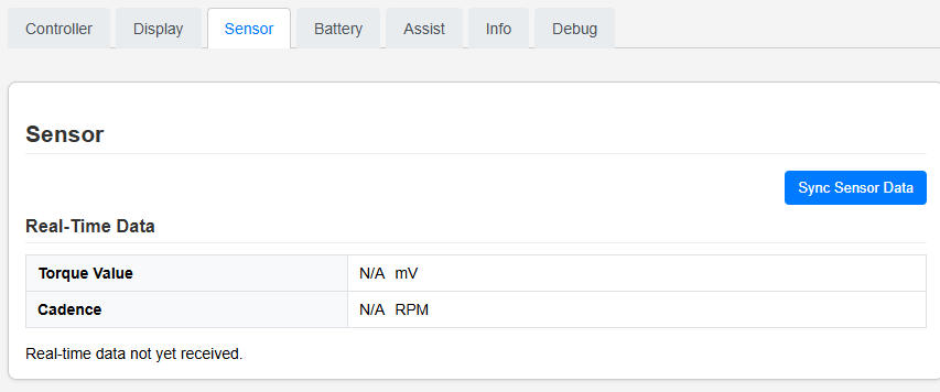

You obviously have it running, does it have anywhere to access say in the sensors tab, the full motor parameters such as speed ?
Looks good if it will show actual assist and ramp up curves. I think you can tap into the Can wires at the battery or speed sensor additionally but don’t hold me to that.

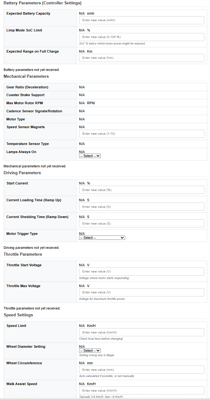

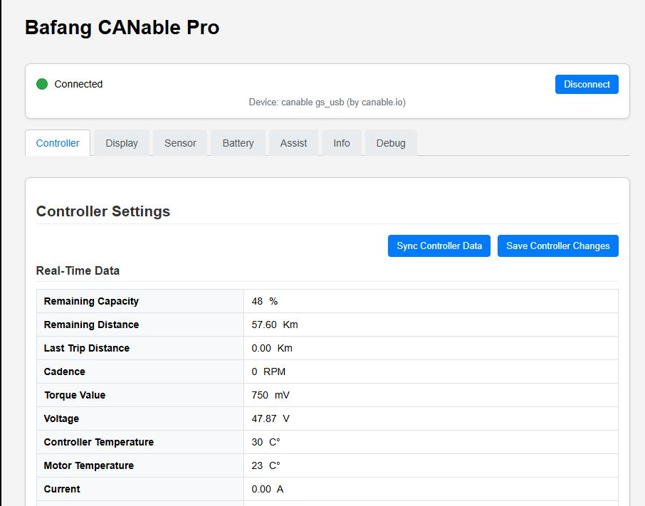

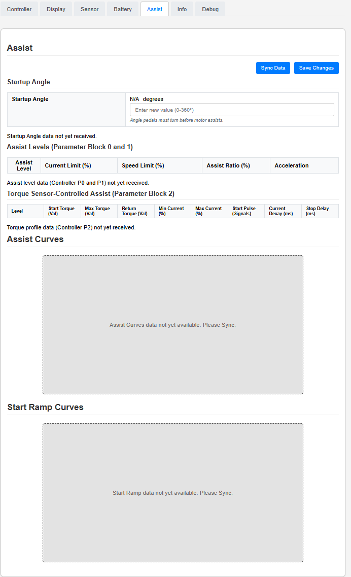

I tested bart Canable tool with m820 today and unfortunately Assit tab is not working (only Startup angle can be changed).
Also checked:
walk speed assit - no effect it's still max 2.5km/h..., initial value was 0 so it's no wonder
limp mode - set to 5%, not tested but initial value was at 25%, if i remember correctly is should be 20% so no hopes for that
Maybe i will test it with more recent firmware.
Fitted one of Dado’s devices to check on temperature, sadly the motor is not reporting correctly the temperature, not sure it’s the motor or all M820 motors.

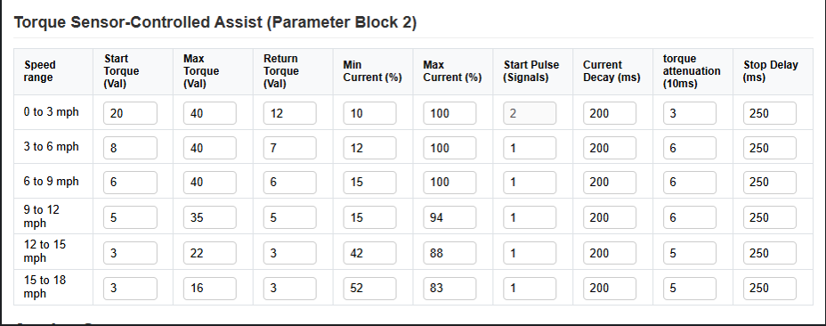

I compared spd table in two firmwares 36V2.5 and 36V3.2.
I ride both of them and know that 3.2 is more sensitive torque which spd table should show.
But spd table is the same for both:

I tested this 36V 10.1 firmware today, it's to sensitive for me, very similar to 3.3/3.2.
Whats interesting about it, that it have diffrent default spd table setup:
I'm sharing the file if someone wants to try it.
Interesting values in the min current, I can see why it is a bit feisty if my theories are correct.
Have you tried to reprogram that version of firmware ? Would be interesting to know if we can alter these values ?
Yes I tried. I do not feel any effect. Even with very stupid values like 10% max current every where. Same as other 36V firmwares.
Yes I get the same on the 48V firmwares if I reduce max currents to very low values.
I think the Assist levels set in the Assist tab seems to take priority over those sped tabs. I suspect also you are running 25kph max speeds ? If so then any changes will be condensed into very short bands of cadence levels and speed combined.
