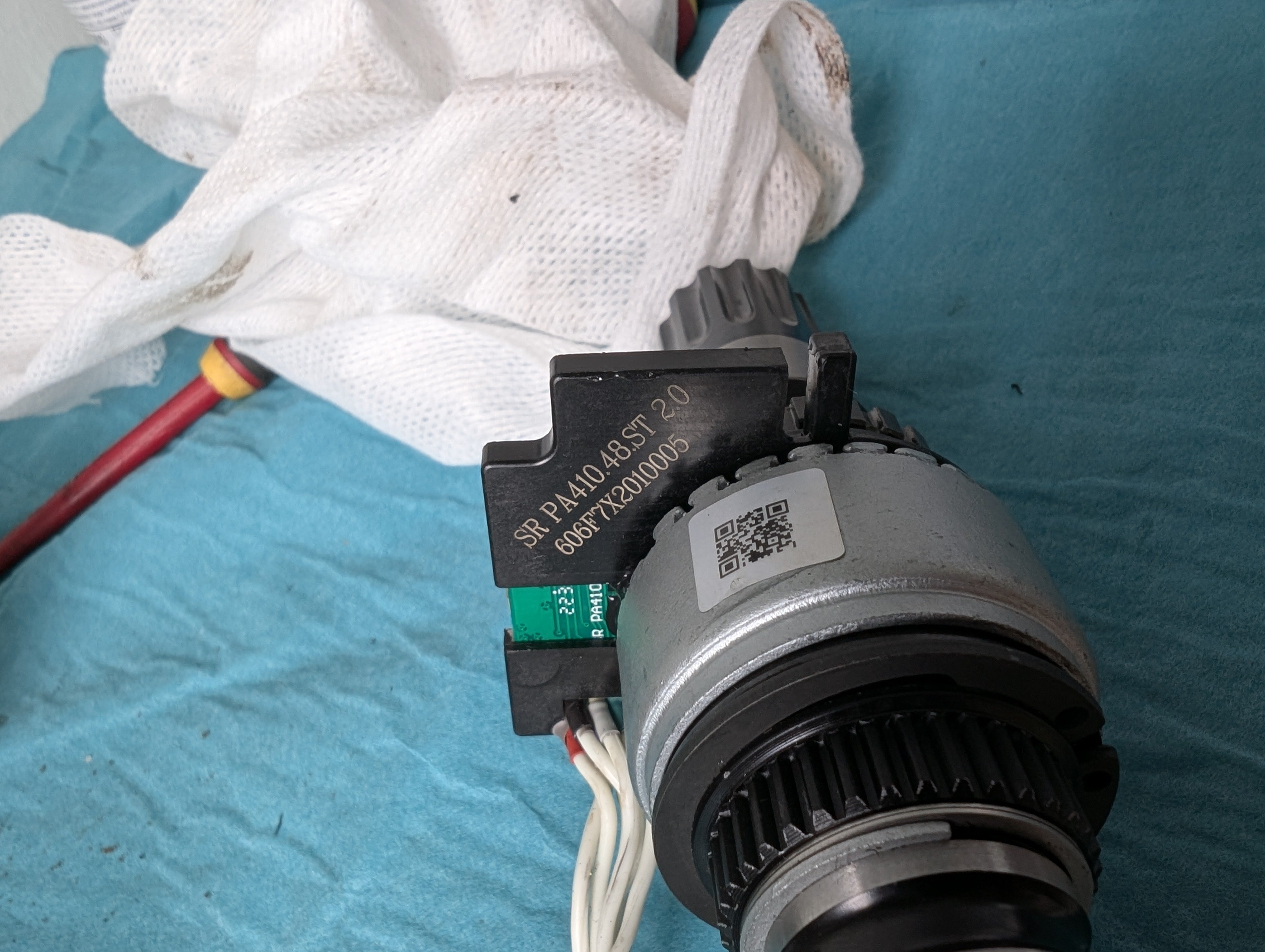

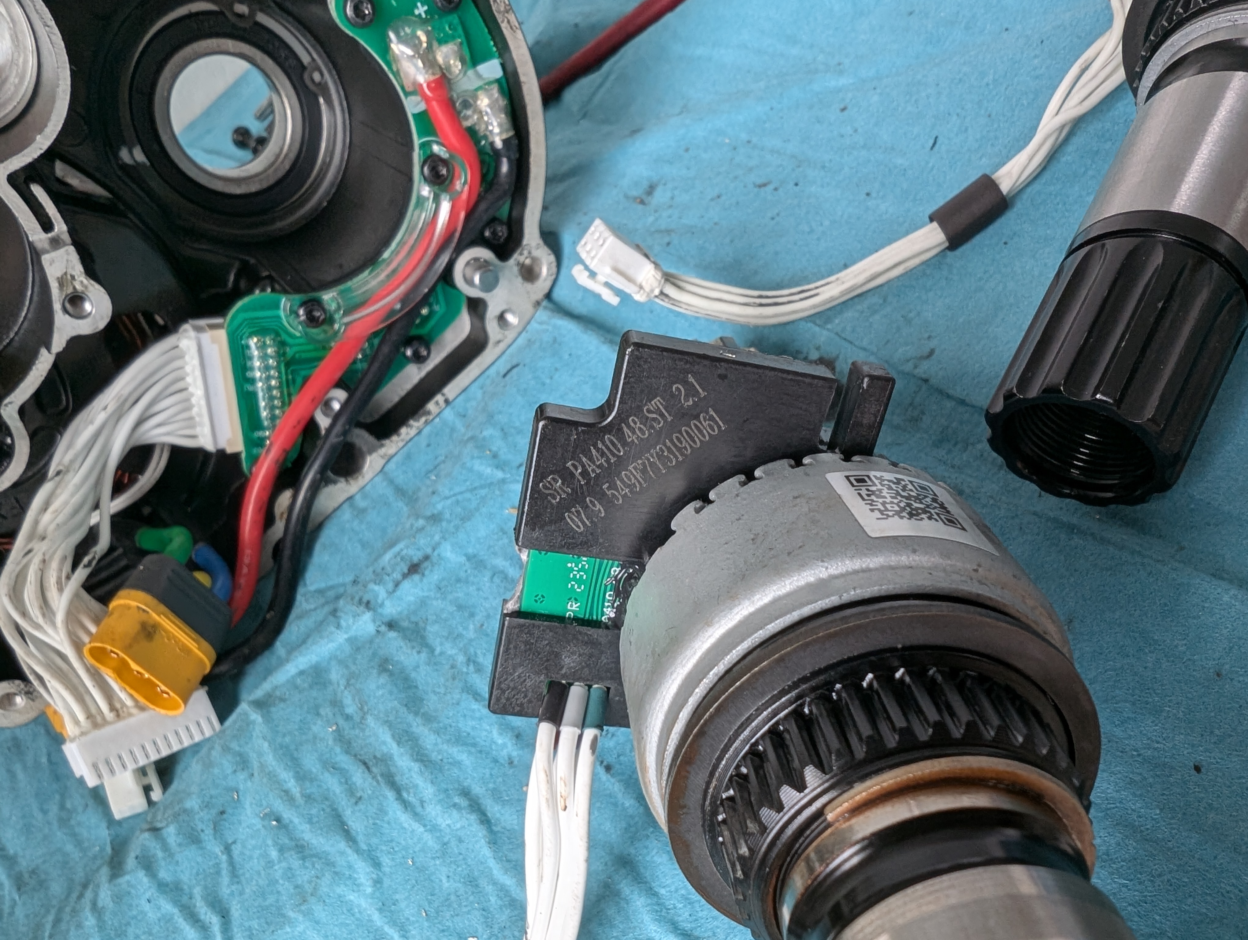

@Tomblarom I'm switching out the sensor and noticed that my old sensor is version 2.1.
But the new sensor I bought is version 2.0. I couldn't find any information about the differences. Any clue?
Was it tricky to remove the torque sensor? I suspect mine is dead too. It was behaving on and off, and now it seems to have stopped working all together. Looks like I might need to order a new one. Do I understand no calibration is needed? Please keep us posted when you'll manage to replace yours. Also I am a bit concerned as I have one of the older m510 versions and wondering if the newer ones will actually work.
No. Very easy. Only need to remove the C-clip on the torque sensor so you can remove the main gear. Open the smaller cover. After that remove the other gears and the plastic guide. After that you can just use a rubber mallet and hit the torque sensor out.
Calibration is needed. Or at least for me it is not sure if it's everytime.
M510 and m560 share the same torque sensor. Confirmed by bafang. I have not found out what the difference is between versions 2.0 and 2.1.

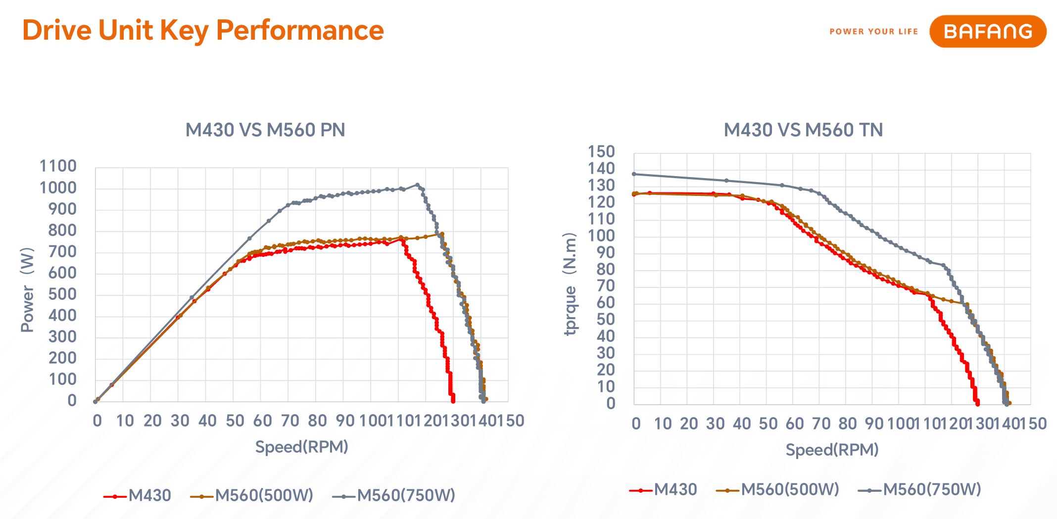

Anyone see that new bafang m560 is listed to have 150nm of torque on bafang site, any news on that?
It’s all marketing noise at this point IMO. My M560 500w had 5 power modes, I almost never used the 5th mode, it was just too much off-road. Occasionally used 4.
Similar with my Amflow. They bang on about numbers but I had to dial trail mode down to 650w /90Nm just to use it on the steepest climbs I ride.
Maybe there is some benefit on a cargo bike I have no idea of, but it sounds like the focus from China is to throw a bigger number out there to be perceived as having their nose ahead without any real context to how and when that peak power is ever used.

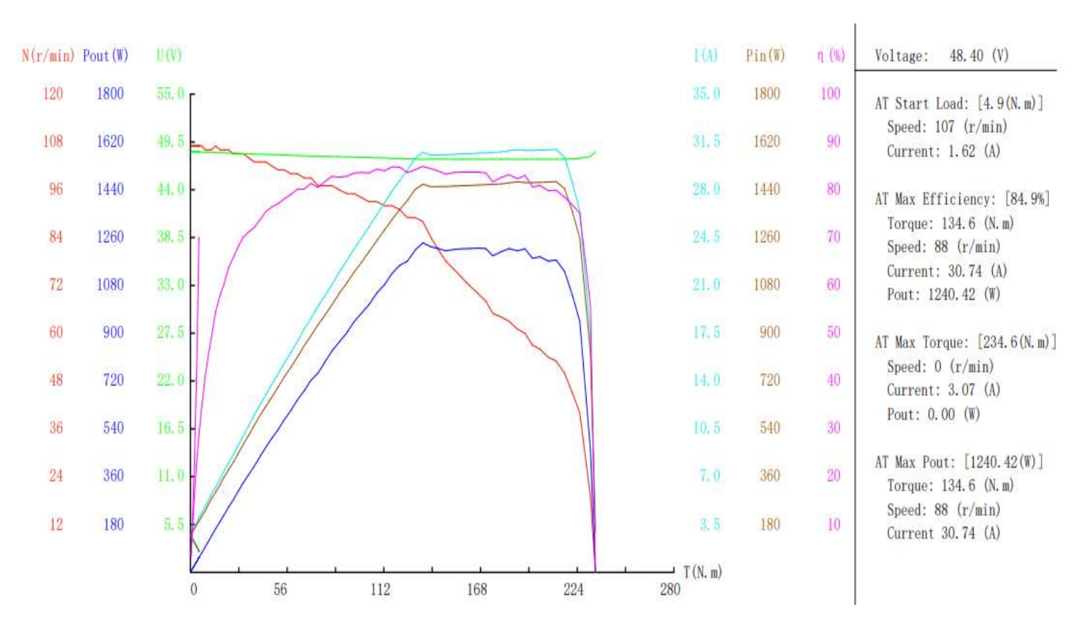

Here is M620 dyno characteristics.
Nicely seen, that input electrical power (Pin) and output power (Pout) at chainring. (chain is loosing very little up to 1 or 2%)
And also very good efficiency here in a big range (I am surprised about this, as at higher torque efficiency should go sooner down).
Here max efficiency 85% at 88 RPMS .
