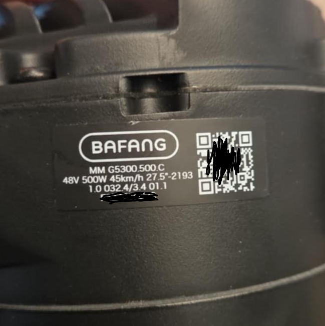

Looks like we have new torque sensor v 3.4
Also some new 500W firmware v32.4

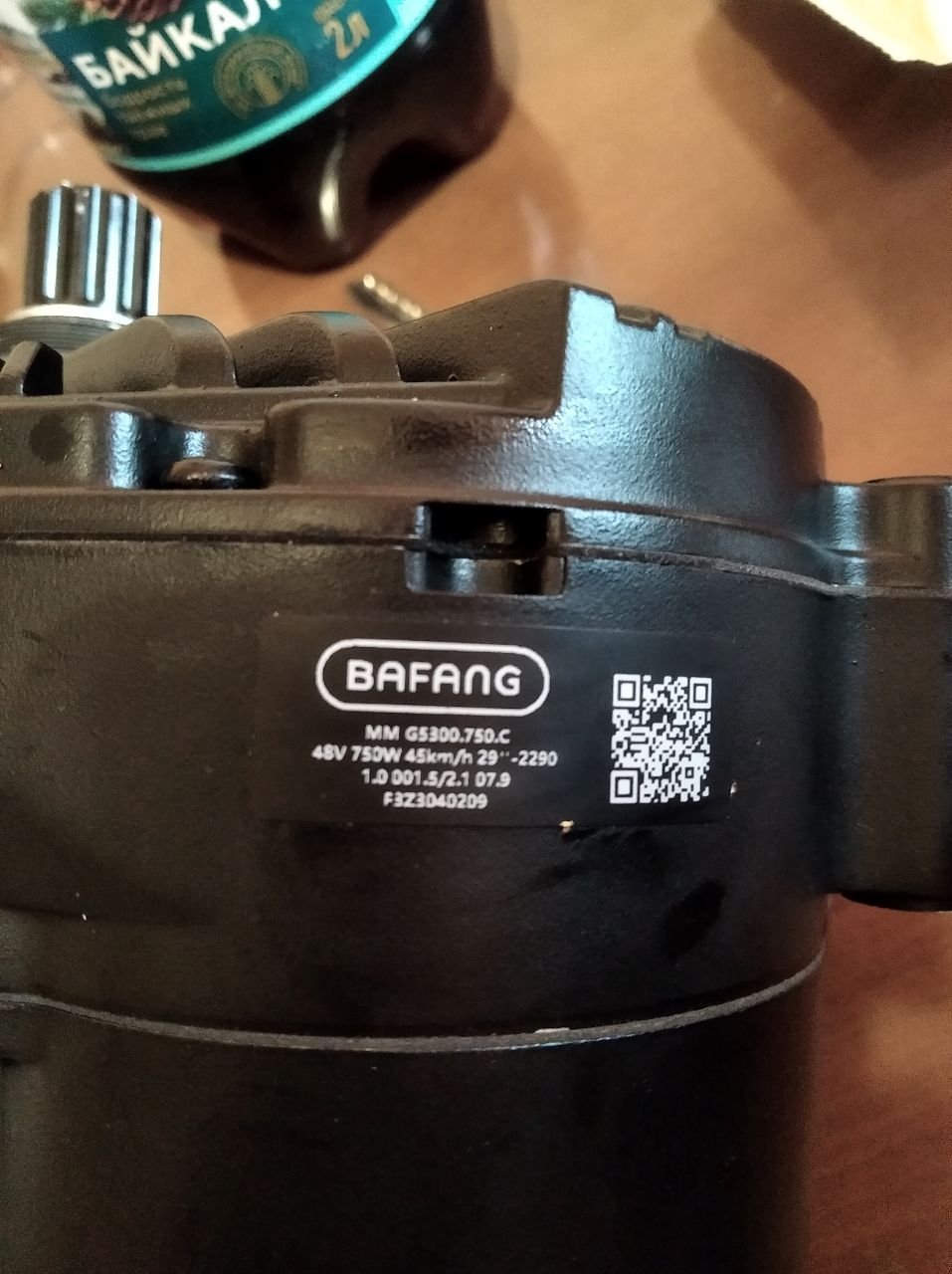

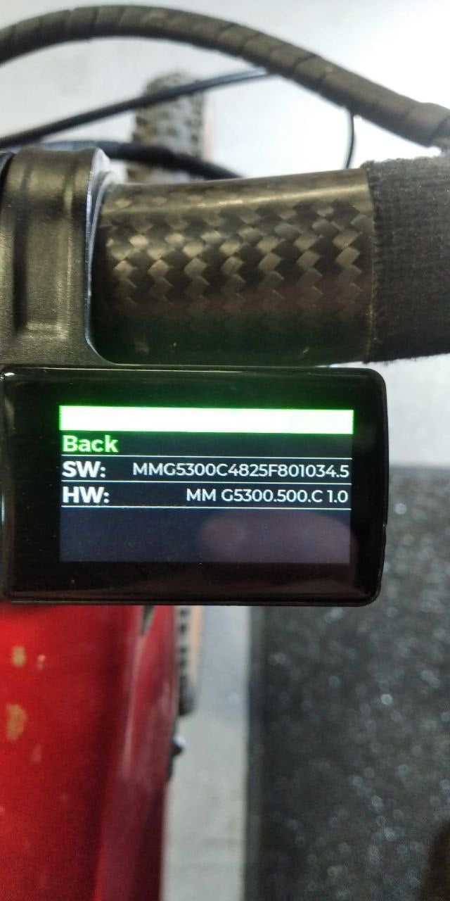

Hello. There is no topic about M560 firmware here, so I will write here. I bought myself a spare m560 750w motor, the first one was bought in the fall of 2024. The new motor is much less powerful. Judging by the firmware number, it is 25A, but according to the power readings on the display, it is 13A. Can anyone tell me if the firmware MMG5300C4825F801001.5 will work with this motor? Or which firmware is suitable?
Hello mate. Yes, you have now some custom firmware v34.5 but it is 25A. Where do you see you have only 13A?
And you right, I noticed also this recent "tuning" to lower power and acceleration (less stress on drivetrain).

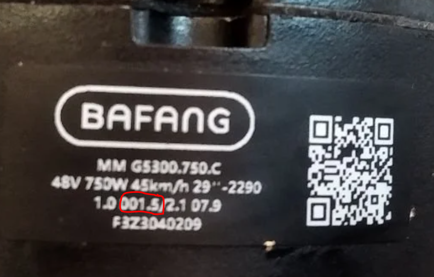

Your motor looks like second revision. I saw here somebody posted also the label of third revision with new TS.
The power readings on the display were no more than 670 W at 65% charge. On the old motor up to 1200+ W. I have not yet been able to check the mode settings because Bafang Go has updated to version 4.0.5 and reports that my DP C245 display is not supported. But I checked uphill, in boost mode and at full throttle.

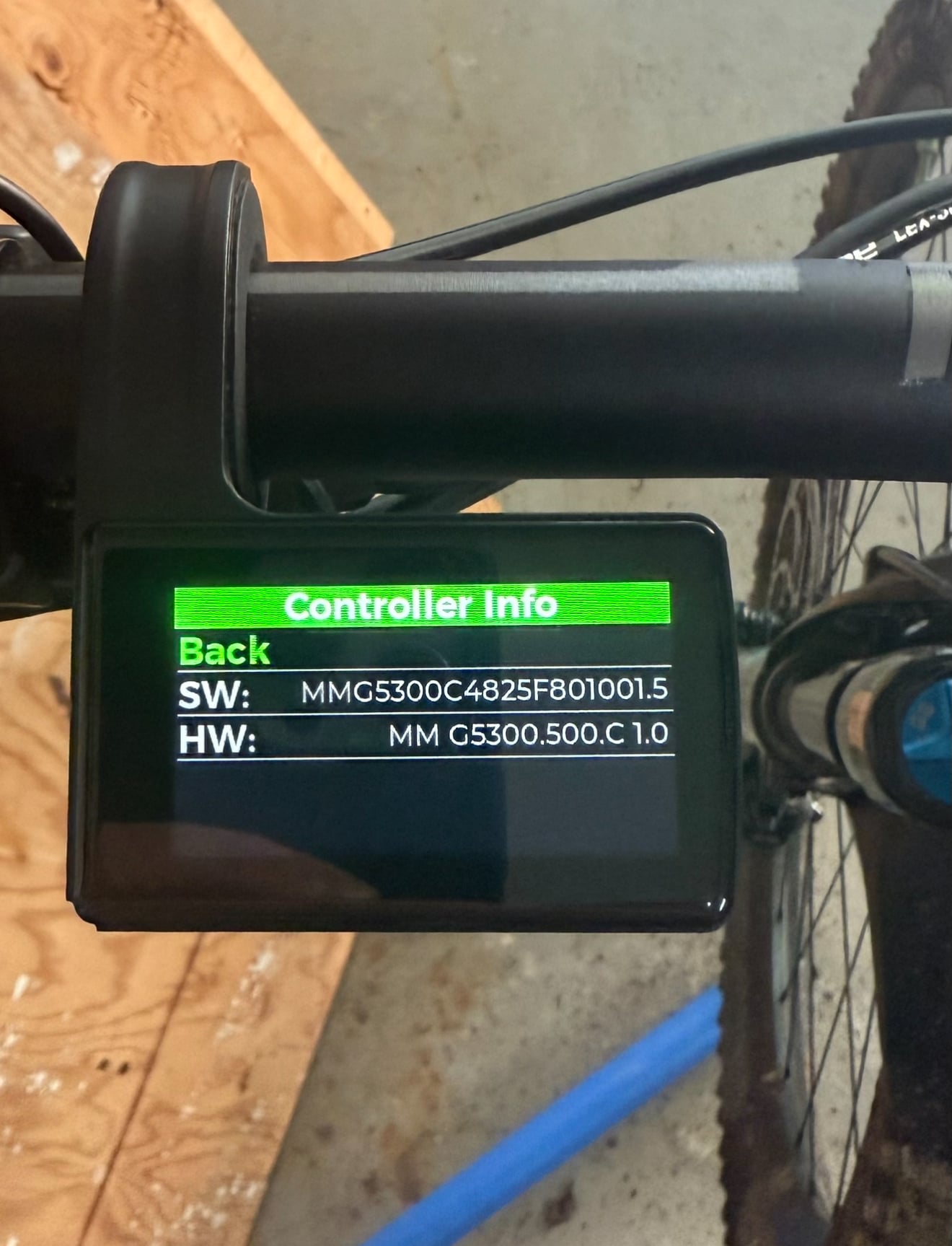

Do they all show G5300.500.C as the hardware version now? I was wondering if maybe your motor is actually flashed with the 500W firmware since that’s the only difference now between the 500 and 750W versions. I noticed your screen is showing 500 in the HW name.

Aren't the 500W and 750W motors different only in firmware? Is the hardware the same? The sticker on the motor says 750W.

Yes, they are the same other than firmware, which is why I was saying it, maybe it just has the 500W firmware loaded on it, but I’m not sure if maybe they all show that HW version regardless of the firmware.

SW version 48V 25A after "C" letter, it is 750W

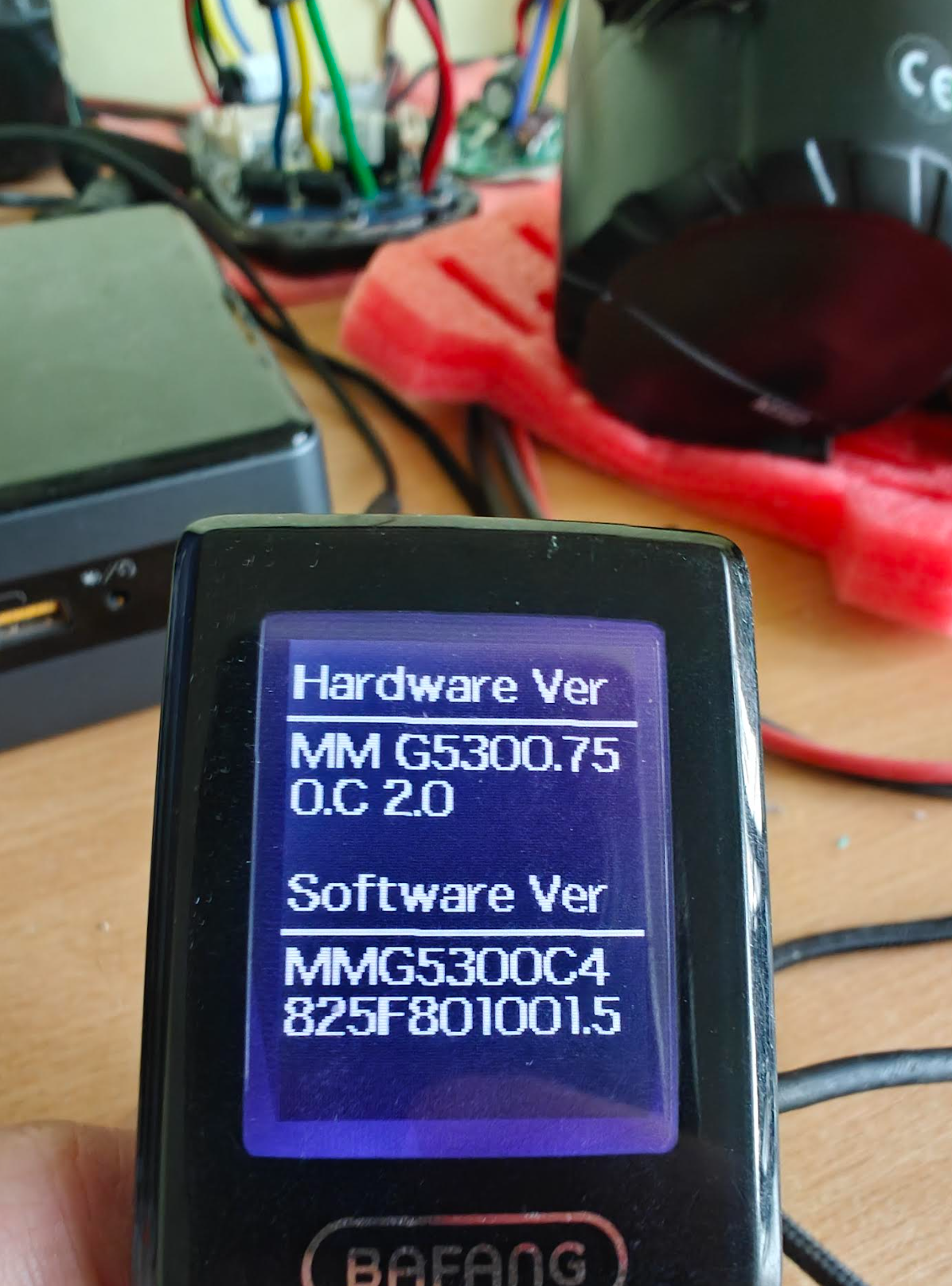

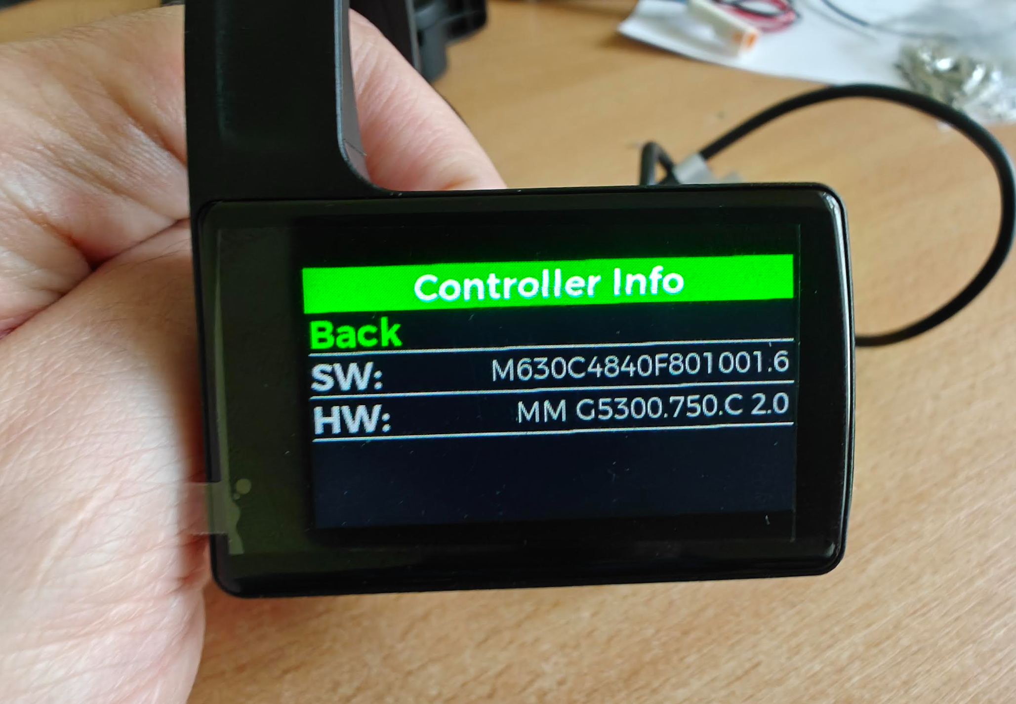

Appears they all just show 500 in the HW model, here’s what mine shows.

You are right. HW is exactly the same. And can be also marked as 750 C2.0 - it is weird this bafang labeling.

Only depends what firmware you flash. 19A is 500 W , 25A is 750W , 30A is 1000W
If you see only 670w, then you must have set less max power % or low assistance level %. (Or some strange custom firmware, which is limiting throttle power). Truth say, did not test yet such a scenario, to set at PAS 5 only 50% of power and then check if throttle is going at 50% or 100%.
Also do not rely on a stickers on the motors. For example your sticker is saying firmware version 1.5 and actually you have loaded v34.5 ;)
Do not speculate, flash there v1.5. Here even default settings are quite good and usable. What I do I putting more acceleration (I dont like lazy starts), and also finetuning assistance level % - sensitivity to pedalling (this one not possible to set over GO). Someone wants to have high assistance only when turning pedals (and then your legs going lazy, like mine ;) ) Someone wants also to push with some power into pedals to assist.

Guys, do somebody have experience with that new TS v3.4 ?
Do you feel some better behaviour? Maybe one day we will catch Bosch. ;)))
