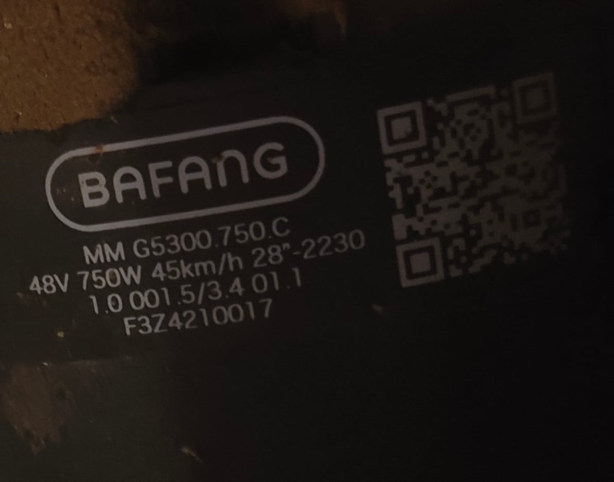

Your motor looks like second revision. I saw here somebody posted also the label of third revision with new TS.
Connected a new motor to besst. The PAS modes were standard. Flashed version 1.5, the motor ran as it should at 1200+ W. Thank you Dado for the answers.

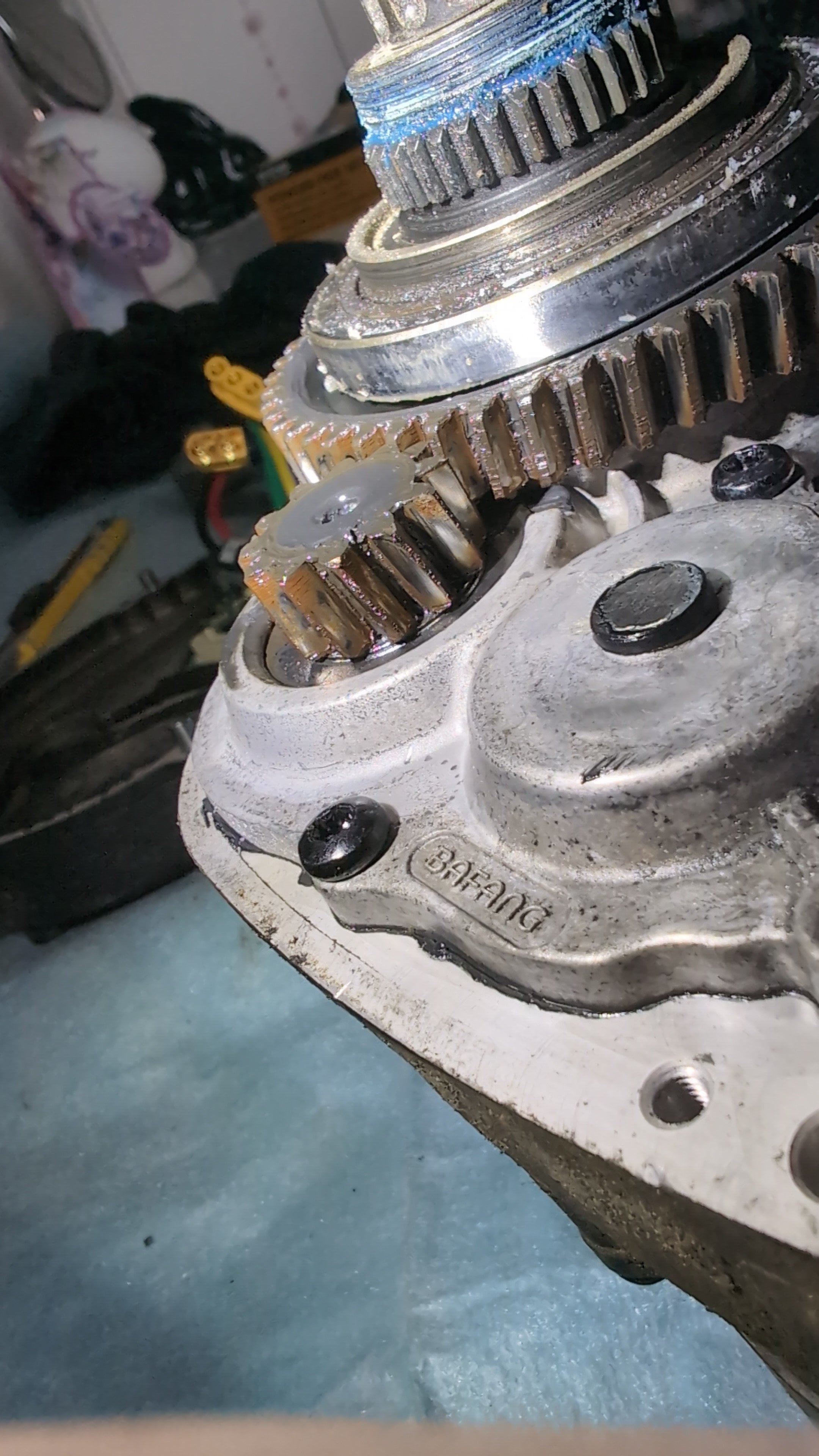

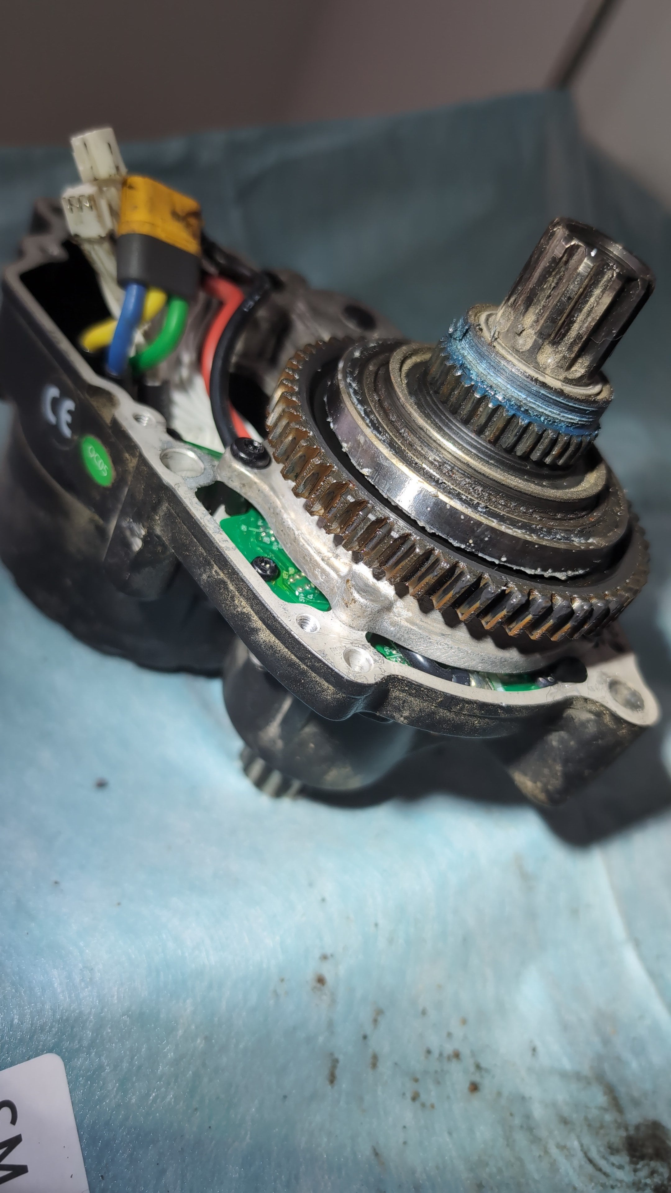

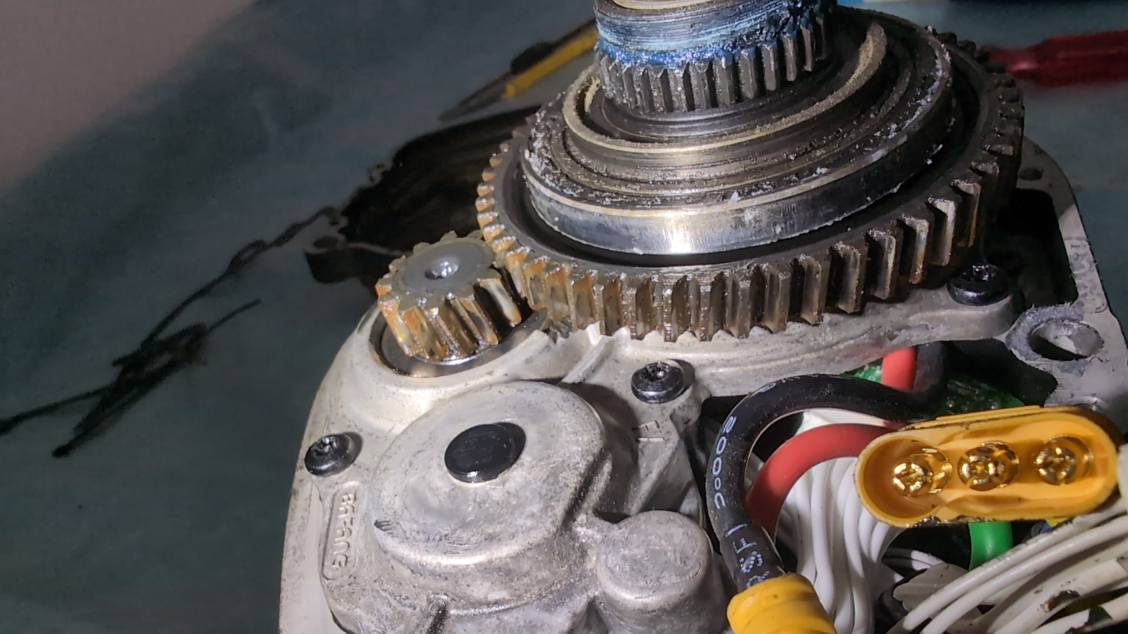

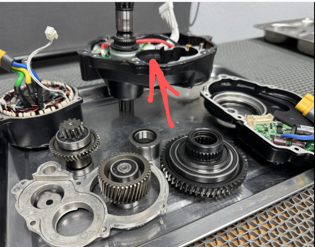

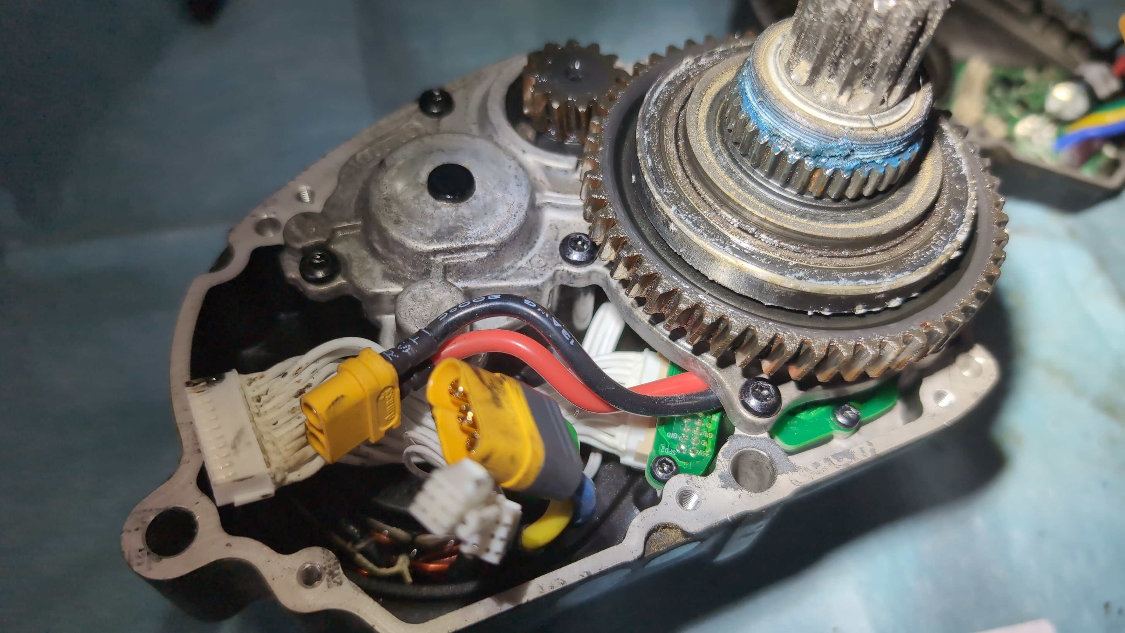

Change of plans for me.. was riding yesterday and my motor broke. I think it could be the torque sensor.
When I try to start moving there is a feeling of resistance on pedals. If I push hard it starts to spin and assist but there is a faint sound of some gears grinding. If I stop pedaling and try to start again there is resistance from the motor again. The resistance is only when I try to engage the motor after the motor stops assistance. If I try to do this a few times after start up the motor stops giving power completely and doesn't work even with a throttle. If I keep motor running the whole time it will keep working until I stop engaging the motor and try to engage again. If I turn the motor off and then on again it works again but with the resistance problem. The screen also showed me speed sensor error 27 couple of times out of the about 15 I tried to figure the problem...
Motor is slightly over a year old from date of purchase and receiving it but less than a year since I installed it.. we are talking about 30 days past warranty apparently..
Urgent help needed! 😭

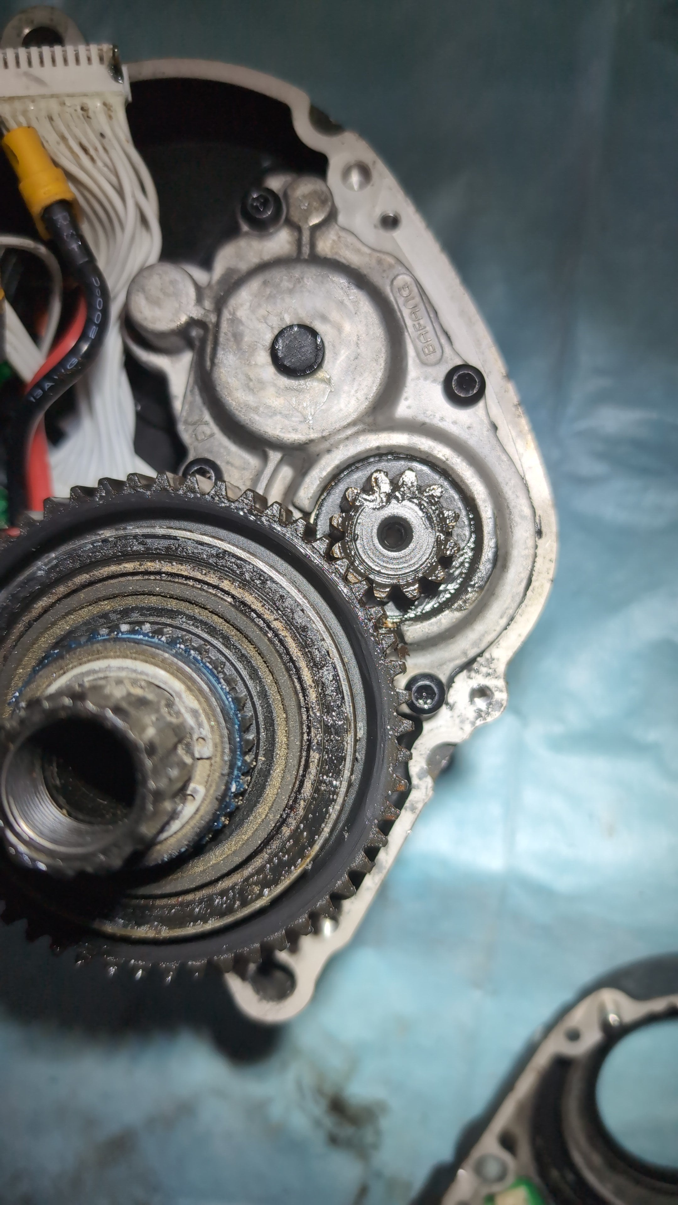

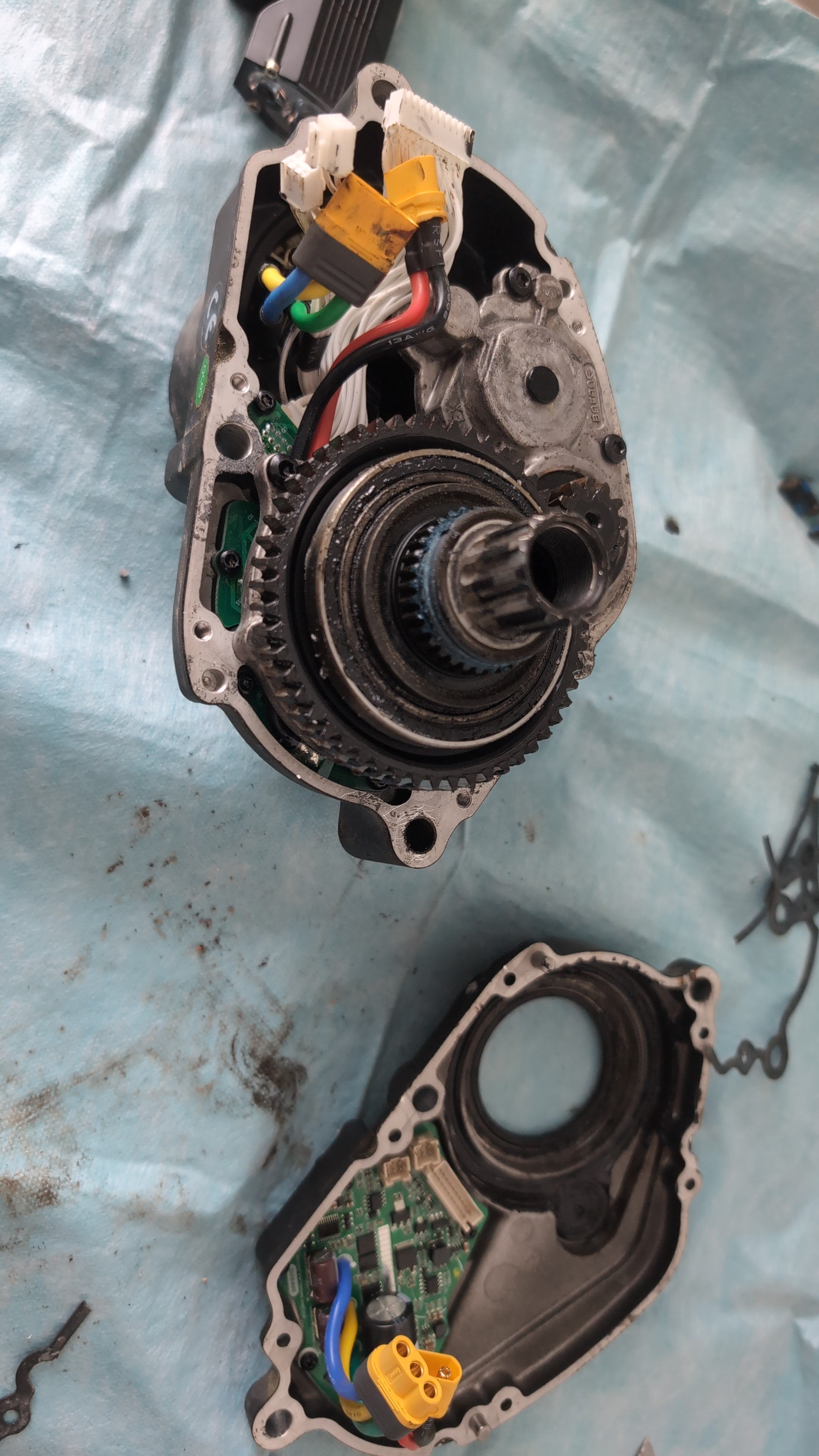

I finally had some time to open the motor. Everything seems visually okay and the big bearing in the last image spins very smoothly.
Any tips where to go from here?

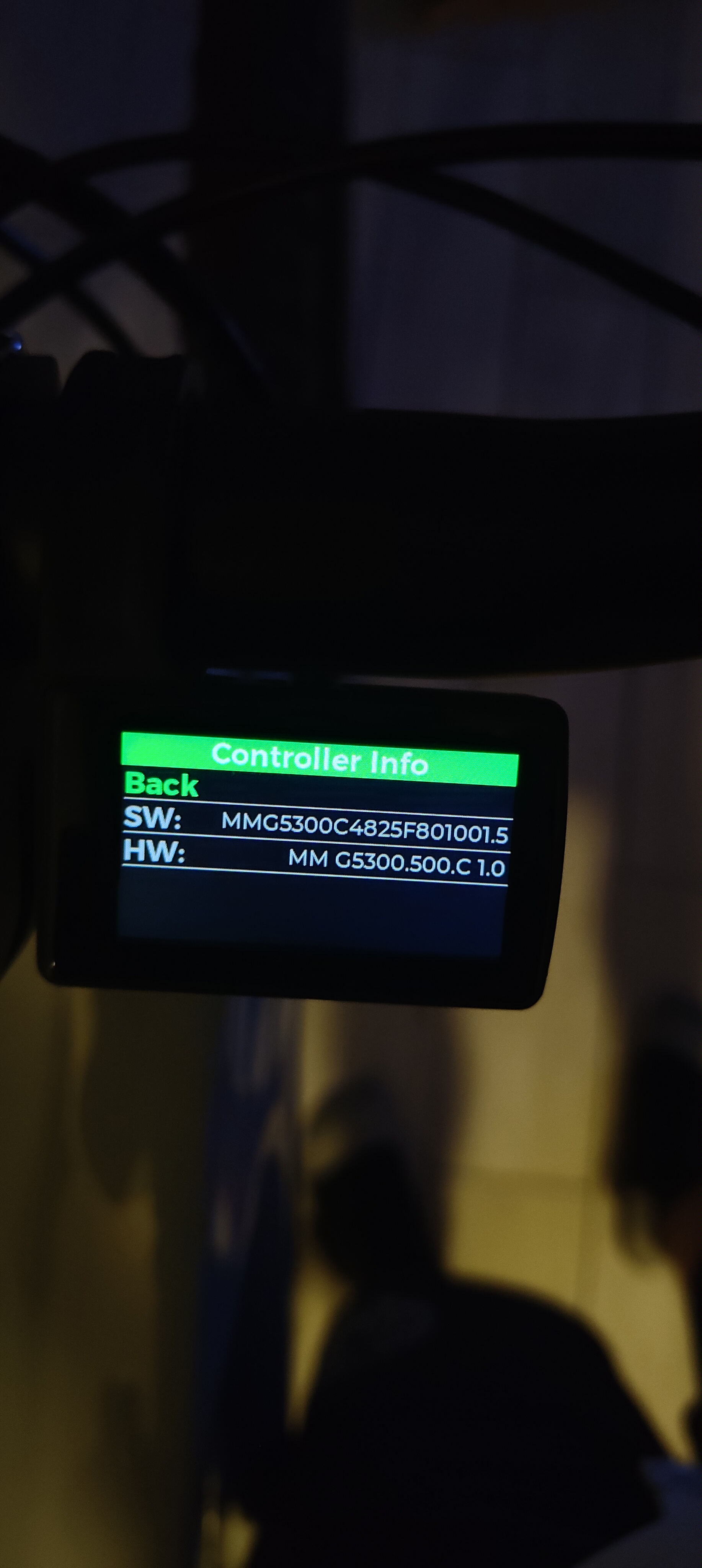

Guys, do somebody have experience with that new TS v3.4 ?
Do you feel some better behaviour? Maybe one day we will catch Bosch. ;)))
I think I have the latest version. I'll just say this - that day has come.💪
The display shows 500C... is this how it should be with a 750W engine?
Dont worry about that 500C under HW. They have mess in this. 500W and 750W HW is the same.
Thanks. I've ridden bikes with many systems from Bosch, through Yamaha, Dapu to Brose and in my opinion this new Bafang m560 is in no way inferior to the best on the market when it comes to pressure sensors in the crank. It works mega naturally and smoothly.

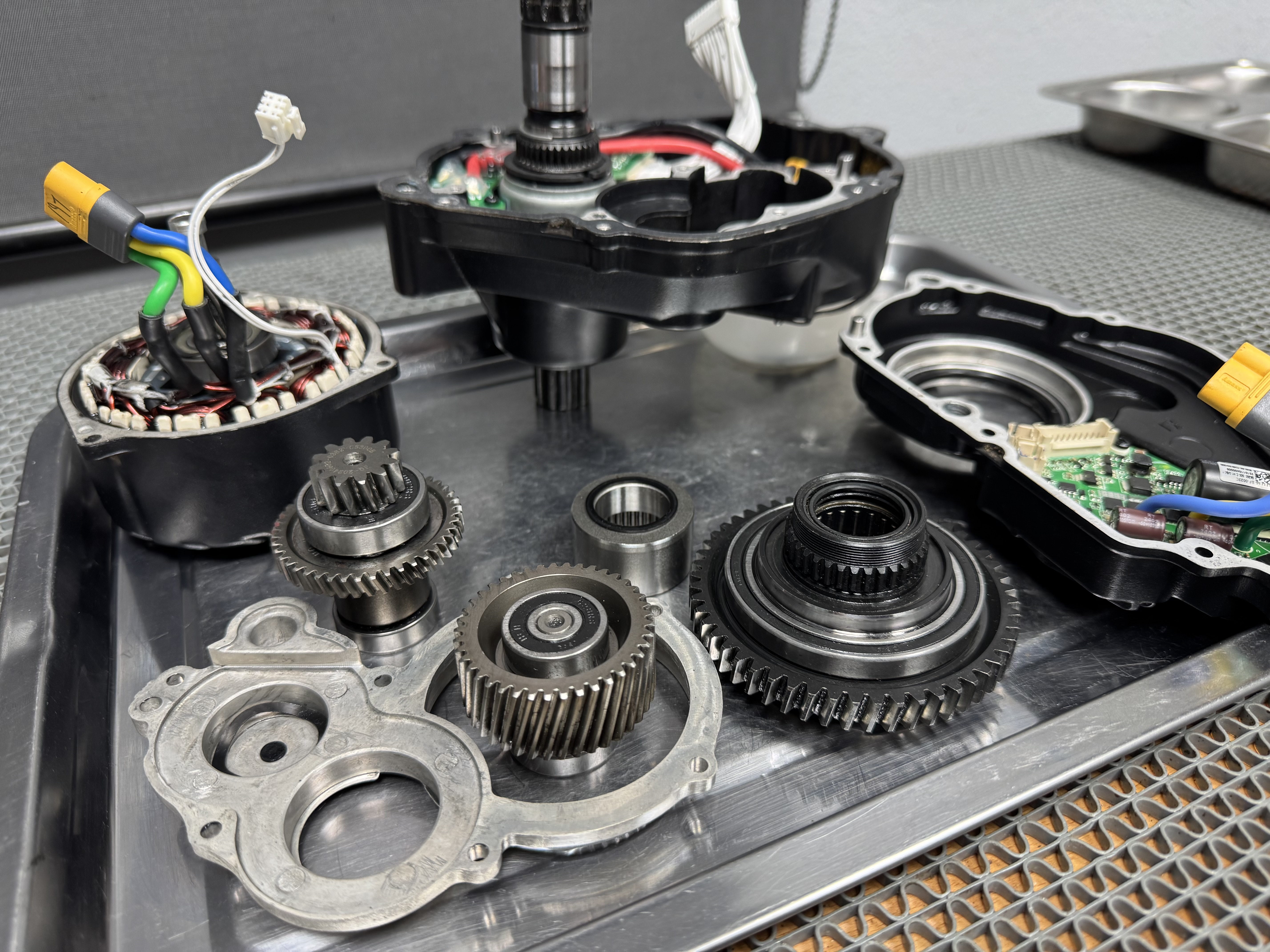

I pull mine apart every 500km, take all the cogs out, clean everything and grease all the bearings and put it together with fresh gaskets ($1 from ali).
The roller bearings under the big main cog seem to get the most wear. I use brake cleaner/wd40 to degrease them and an old tooth brush to get everything out, dry with air line and grease with SKF bearing grease.
1600km on mine now and it’s running perfectly with almost no water or dust ingress and it’s been through a whole dry season and half way through a wet season and washed and air line dried after almost every ride (or 2-3 rides in dry season)
I still have yet to ride a Bosch/Spesh/any other mainstream bike but I really am impressed by my M560 once I got it tuned right. I just wish it could have been a little quieter. The M510RS should be Bafang’s best motor yet if they actually deliver on what they promise. Perfect amount of power and the M510 was already quieter and lighter than the M560

Good to hear. Where the bearings easily removable or did you just open the cover while they were in place?

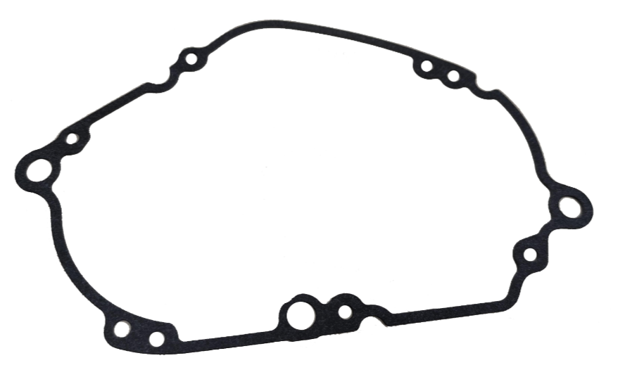

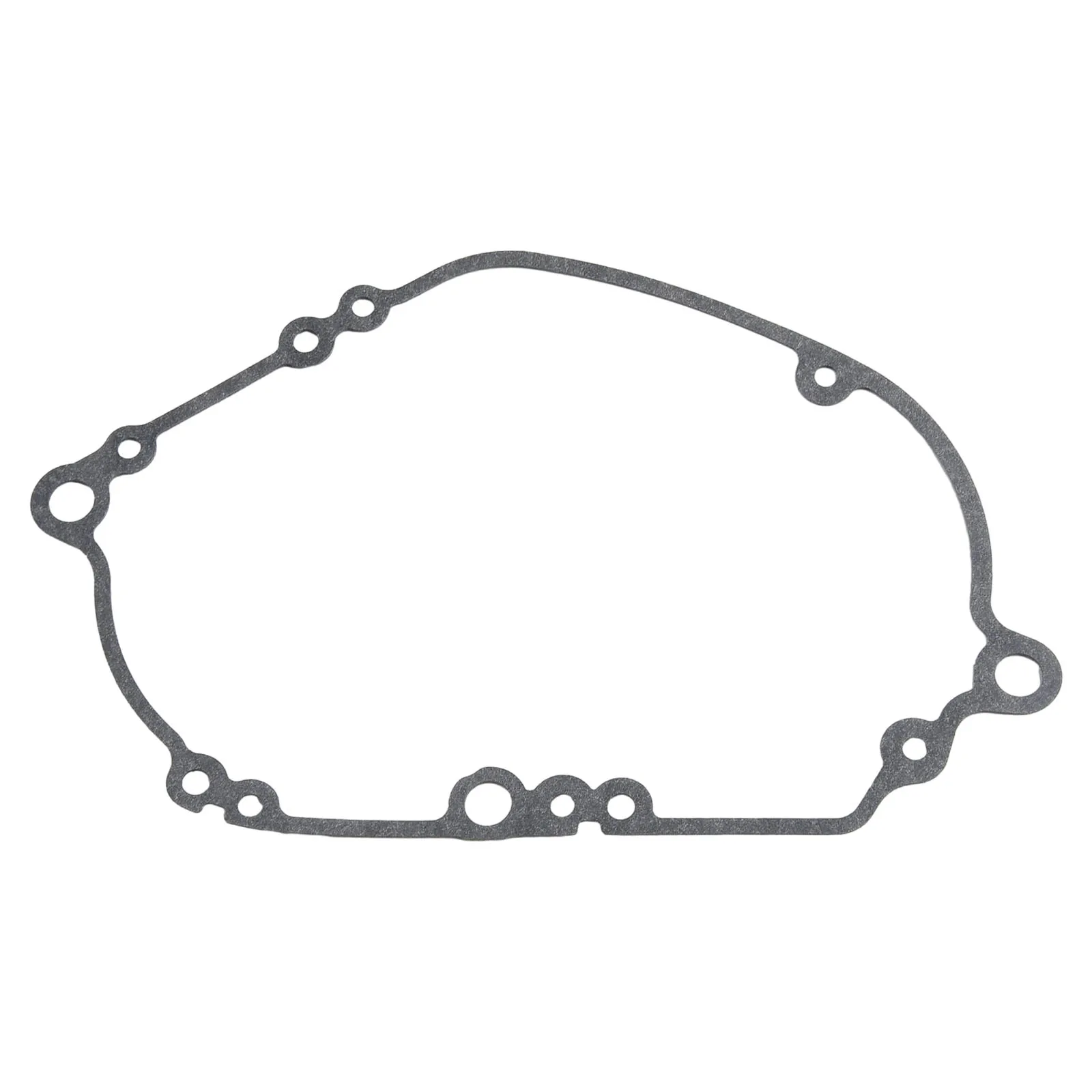

The gasket you linked seems to be different than the original m560 gasket. Does it still fit properly?
Here is a picture of the original gasket.

I haven't changed any bearings yet, they have all been in very good condition, I just popped the seals off where I could and cleaned them up while they are attached to the cogs and shafts with brake cleaner and then air-lined to dry and re-greased them all. You will need some bearing puller tools to change them but they are all quite straight forward.
All the cogs come out like the attached photo, you have to wiggle some of them a bit. I recommend taking photos of each step so you can put it all back together after. There are a few o-rings and washers so be careful to remember where they go and watch out for the ones that stick to the case with grease.
I'll check one of the actual gaskets I have here tomorrow morning. I think sometimes the images might be wrong on Ali but I haven't checked the ones from my most recent order so I hope they are right.
Yeah true. The listing does say m500 m510 and m600. That's little bit weird since m510 and m560 has the same gasket but m500 and m600 has different gasket.

I will receive my torque sensor tomorrow and will change it. I hope that is the problem with my motor and the change will fix it. I'm little bit worried that the new torque sensor needs to be calibrated but apparently in the m400 motor it didn't need calibration after the change. If it needs calibration I need to find someone or some local shop that has the besst tool for calibration since I don't have it..
I don't have time to wait for gasket to arrive from China so I will use silicone to seal the motor for now. Same as they do with car motors.
I have to remove this plastic piece before removing the torque sensor or it won't fit out.
Ok, I checked mine this morning and my aliexpress history. When I bought the first batch in October 2024 I received the correct ones. It seems my most recent order at the end of February, they are incorrect ones, glad this came up before my next service!
Looking at my order history it looks like the seller originally had the correct ones for M510/M560 and maybe replaced the stock with some wrong ones.
Greenbike and an Ali shop look to have the correct case gasket at a different shop, but not the controller gasket, so I've asked Chili Shen at Fieldebikes, she is a great resource for this stuff.
Greenbike Kit link
Aliexpress link
