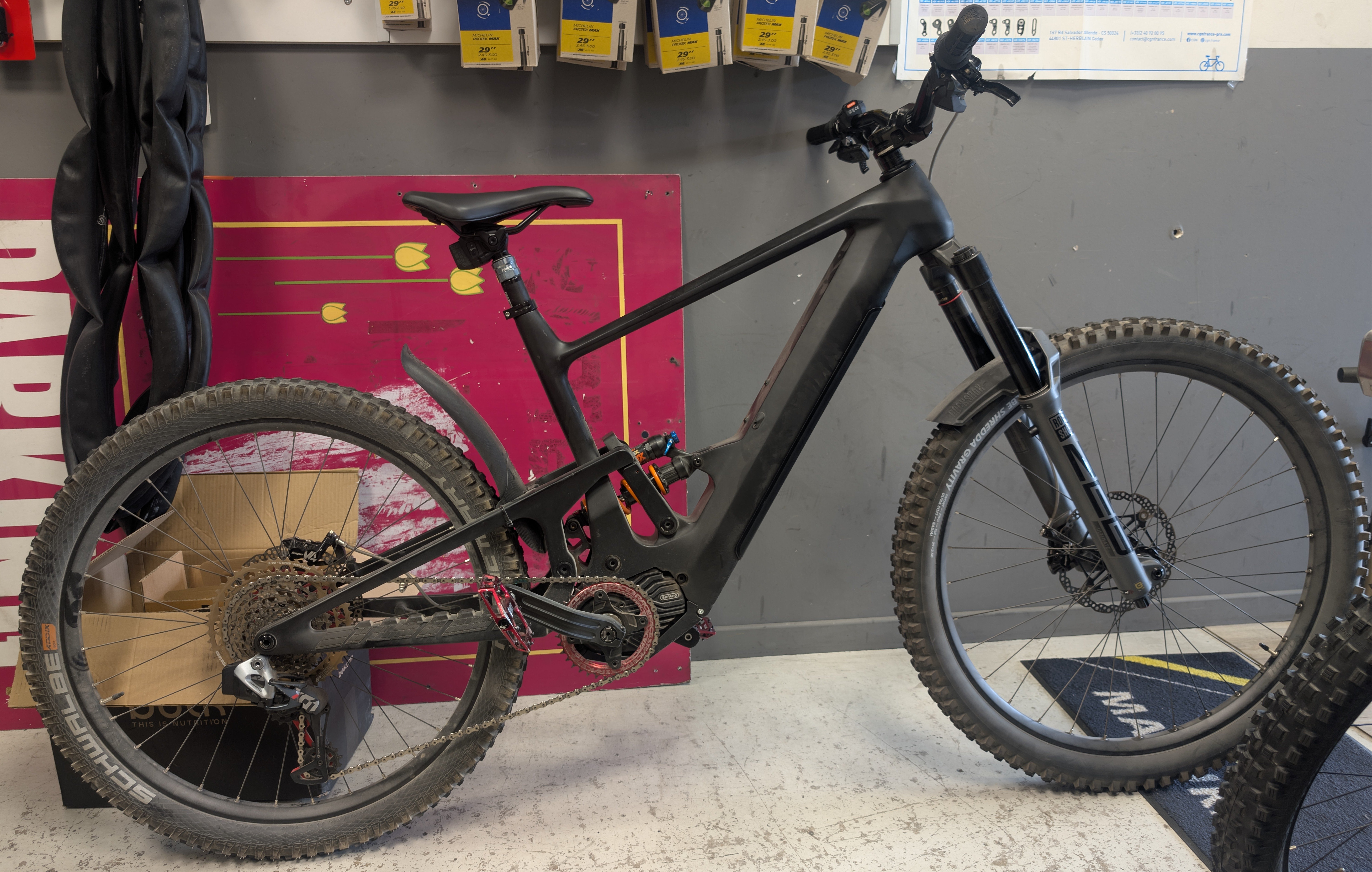

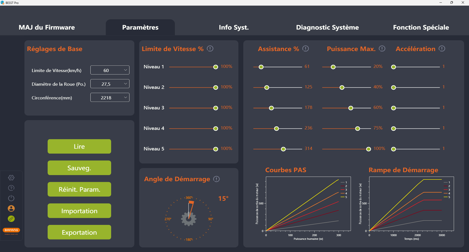

Hey guys, new member here!
I've built myself an LCE971 with M560, and am quite happy with it, except for a few minors things. Done 4800km with it, no maintenance done inside the engine, so that's good!
I've seen people complaints that their bike sometimes cutoff when being low in battery, and I had that happen to me too (sudden drop from 3 bar to 1 flashing red bar on DP E181), and I understand that it comes from the fact that the battery is a "dumb" one, providing only positive and negative with no communication, so high power + low battery = sudden cut off.
My question is, I've seen @xtraman122, in post #537, talk about using the SYR014 in a Dengfu E82, so does that mean I can use a E82 battery inside my LCE971? Because I think it's a CAN communication battery? If so, where could I buy the battery with the approriate hardware to put it inside the LCE971?
Next, I find that the M560 has way too much overrun, despite me having turned down accel to 1 on all levels of assistance. Is this something I can résolve by flashing another FW? I have access to a Besst. You'll find a screenshot of my current config for my M560, as well as a picture of the general finished bike.
Thanks for any help!
Capture d'écran 2025-08-07 131706.png PXL_20250806_144921139.RAW-01.COVER~2.jpg
Hello mate.
Acceleration does not have anything with over-run. Put it on reasonable level, with 1 it is lazy. Ramp up power to requested power takes 2.25s - you can see this from second graph. I am riding level 8.
PLease share first sreen, what firmware you have.
I am wondering, as hearing this often, M560 and overrun many times. With firmware v1.5 there is no over-run (or very small, everything under 0.4s is fine - it is not possible to make to 0s as there needs to be some timeout). Bafang is sending v. 1.5 for over a year. Just recently I saw on a label some other version (dont remmeber, but something like v32.5)
Is true, there was more versions of firmware v1.5 - which is not wise from Bafang. (how hard is to differentiate them to 1.51 1.52 and so on)
From 3 bar to flashing 1 is not ok. Could be some fault with battery or you just loosing CAN communication to display, then display is showing 0%
Assistance 61% is rather low, but as everybody likes.
With CAN battery you can get more juice from battery (depends, how was BMS set). Or you can use BBR device and go as low as 2.8V per cell.

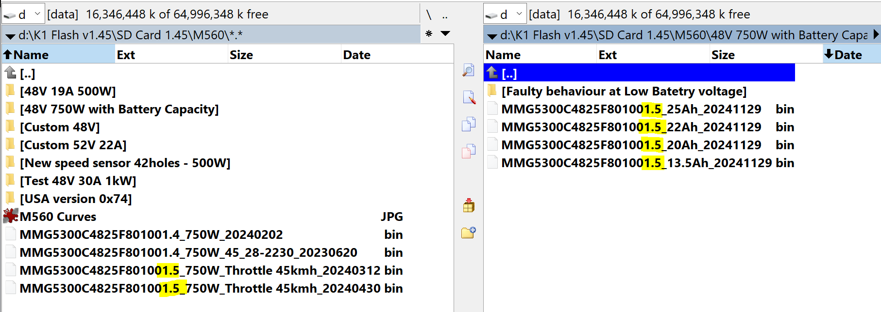

They shipping with v1.5 over a year.
As I wrote I had like 3 firmwares marked v1.5 but had different compilation date and size. So there was some updates on v1.5
But since first v1.5 I did not notice over-run. And I am sensitive to this, usually very good seen when you stopping on lights down to 0kmh and you lightly rotating pedals while braking. Then when stopped completely you feel motor is trying to push over the brakes. Also on technical trails you can feel it.

For what it's worth, below is the file Chile Shen sent me that she claimed is the current one for the 750W M560. Obviously the date in that file is pretty old, and none of us can directly interact with Bafang to find out what the actual latest is, so this is the mess we end up with.
Yes, the sellers are telling this - it is the latest. And compiling date is over 1y old.
They dont have a clue about behaviour of firmwares.
1 second you can feel a lot. I would say it is less than 0.4s

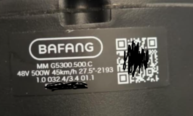

Guys, if somebody has that new version 32.4 please share. Hence only 500W version. New torque sensor here also (I guess that new one with better resolution - which would end up even in lower over run - finally Bafang did hear the complain of users)
Here that other version 1.5 from April

I put the accel to 1 in order to have a pretty linear feel (as shown in the graphs), but you say 8 would be more precise?

Do you have a 1.5 I could flash? Knowing I run a 48V15A battery, so maybe someone has the appropriate .bin for a 15A battery?
Is also in Besst Pro. And bet it does something. ;) It will store into controller registers the position of magnets to windings to have smooth starts of motor. On first sight it does nothing as your controller was calibrated from factory. But when you replace controller you must run it. Some controllers comes without calibration run, so then you getting Hall error straight.
15A battery is not good for M560 (but battery and BMS will give you more). Even 500W firmware is taking 19A.
