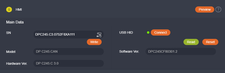

Yes using DPC245CF80301.2-DP C245.C 3.0.bin worked for me!

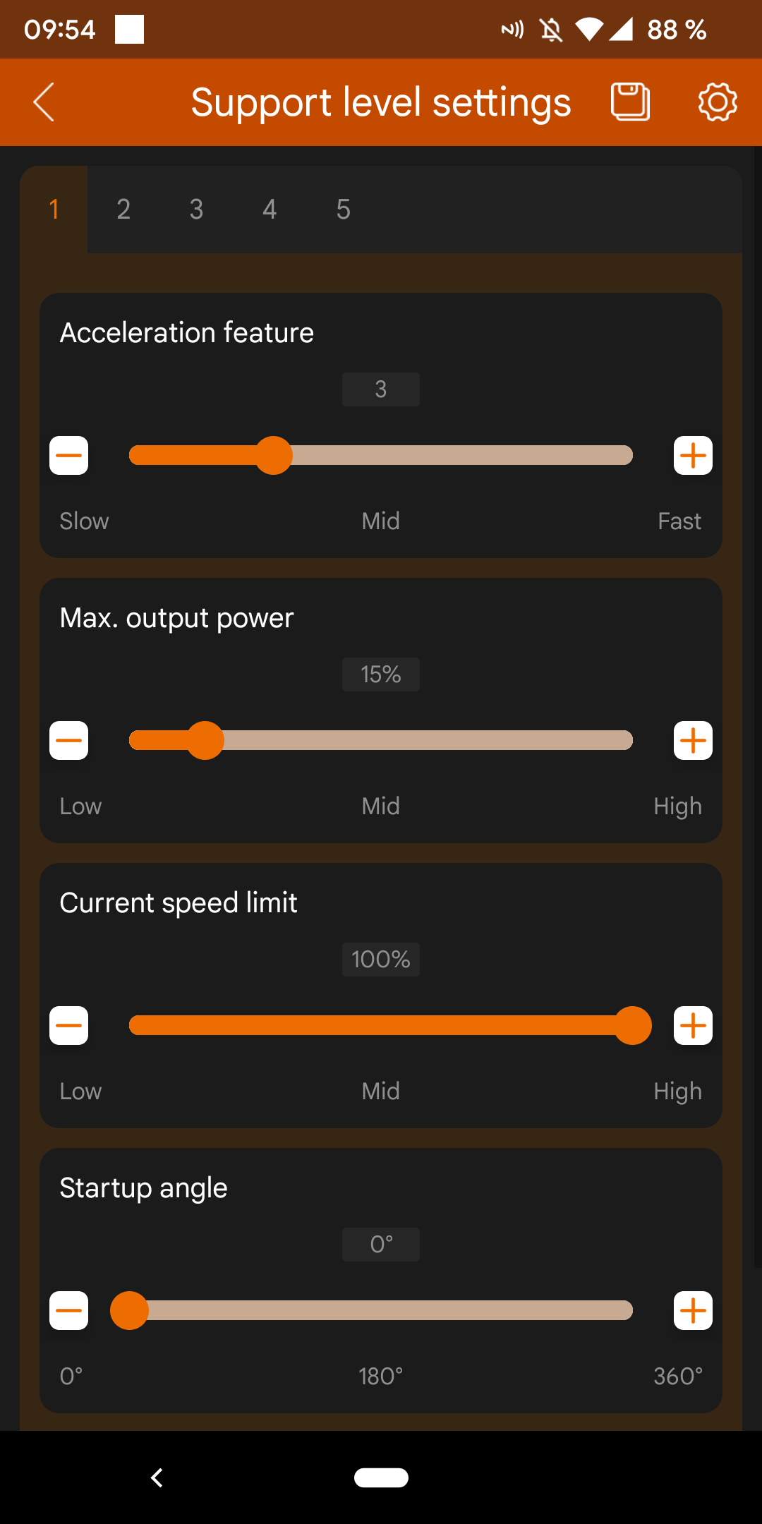

Hey, I also had this "Operation Failed" issue, but on Android 13! Bafang sent me a new firmware file for DPC245 3.0. I will test it on Friday, but maybe it helps you already. Version: DPC245CF80301.2
EDIT:
I flashed with BESST, tested on Android 13 as before and it solved my "Operation Failed"-issue, when opening "Set the personalized ride".

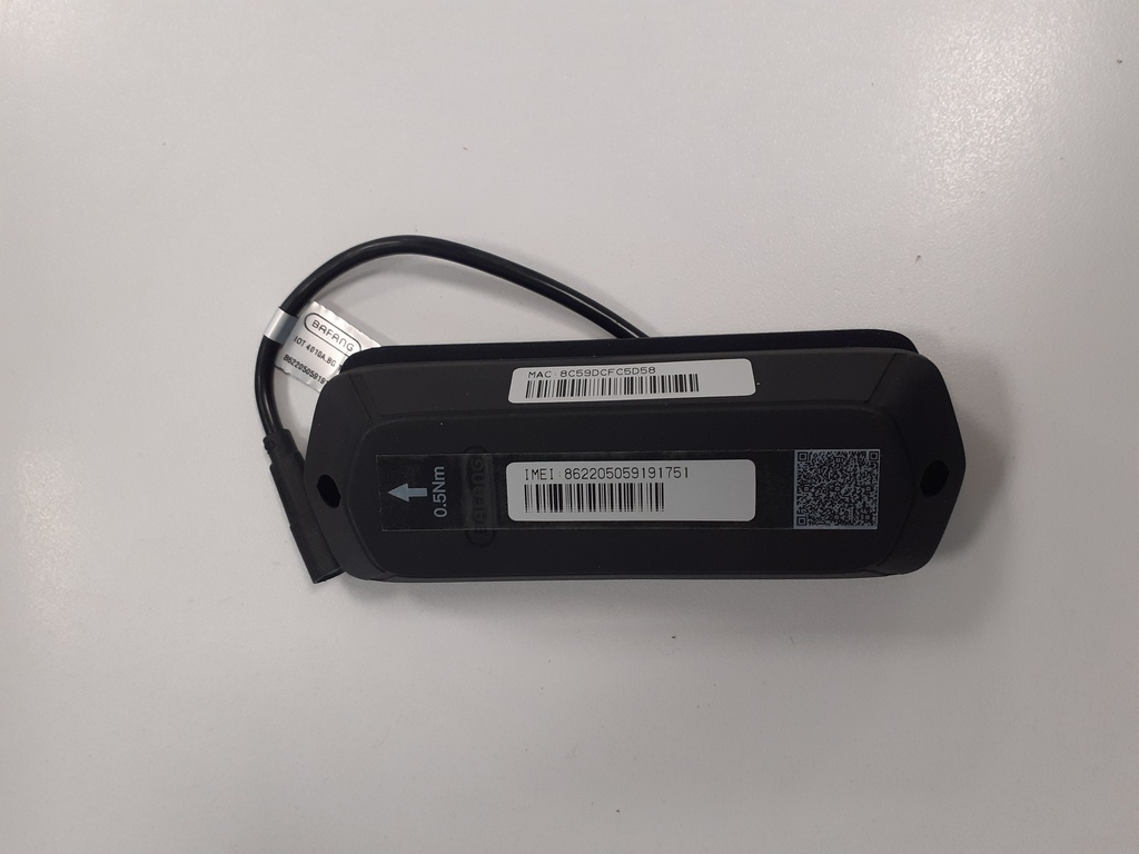

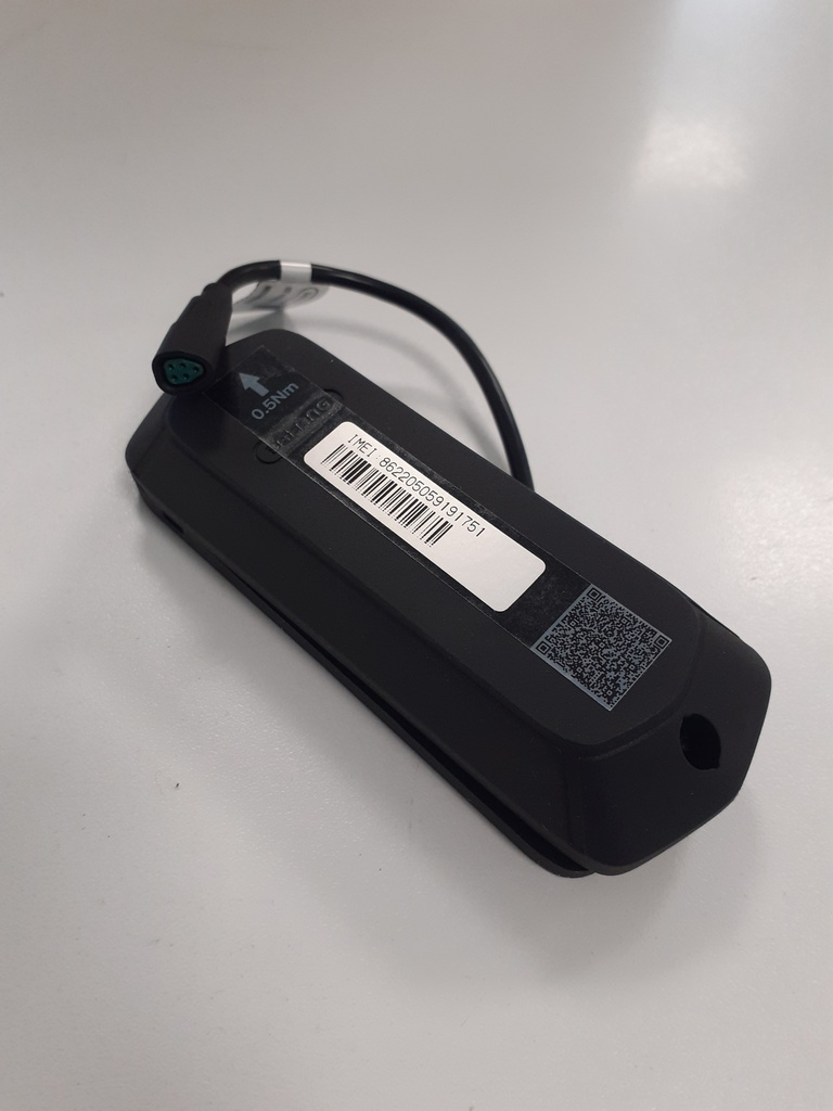

Hi, can this device replace the 245 v3 display to use GO+ and a classic 181 controller? I can't understand what else it's for... Thank you
I think the Bafang IOT device is for setups, where you want GPS, 4G-connectivity and if your display has no Bafang GO+ support. If your DPC181 is the CAN-version (triangular plug), I'm sure, it can be used with Bafang IOT. Maybe consider buying the DPC010 instead of adding IOT-device..

I was able to connect my bike, but could not manage to set some usefull things, yet...
No personalized ride, nothing...

Assistance % still missing in new Go+ :(

As I said, I can connect it to the App and can see values, unfortunately, I can't change anything. Not even the wheel-diameter.

Speed limit, Wheel size and circumference is not possible to set over Go+.
