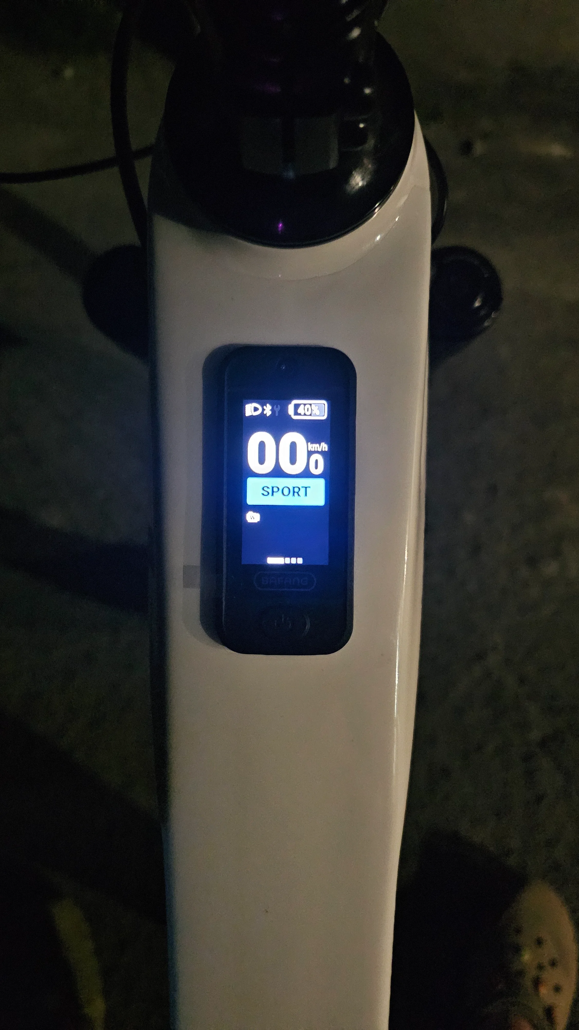

M560 and DPC030
M560 and DPC030 186244
@panicmtb - good news: you've already got the most useful rundown in your post, and since you're on the M560 with a DPC030, let me focus on exactly that combination.
M560 + Go+ app The M560 is tunable via Go+ for the things that matter day-to-day - power percentage per mode, acceleration response, assist curve shaping. Same caveat as the M510 build: speed, wheel circumference and country settings stay locked behind BESST Pro. @robk's post sums it up neatly - Go+ is the rider-facing subset of BESST, not a full replacement.
DPC030 + Go+ compatibility - honest answer This is where I have to be straight with you: I can't confirm from verified data whether the DPC030 pairs correctly with Go+. The earlier version of this summary had that as a confident tick, and the validation flags are right to pull me up on it - I don't have a source I can stand behind for that specific display.
What I'd suggest: check the Bafang Go+ app page on the Play Store / App Store - they do publish a compatible display list, and the DPC030.CAN variant is the one to look for. If your display has "CAN" in its model string, that's generally the more capable version for app connectivity. @ZetOmega's post on the E82 M560 build might have relevant first-hand detail on what display came with their Fieldbikes kit too - worth a read.
If you can tell me what's printed on the back of the display unit, I can dig further.
