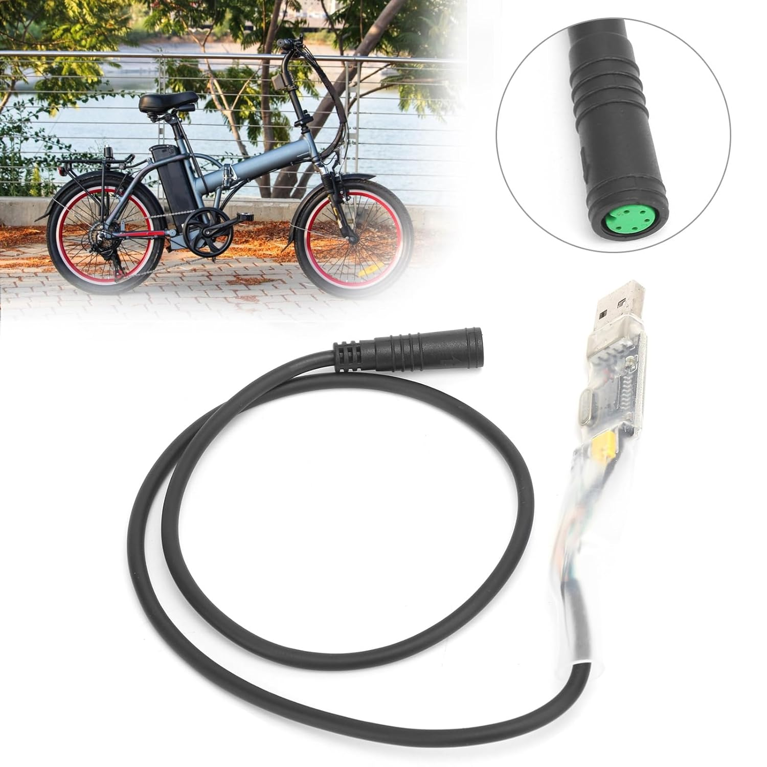

what is the path to getting the BESST tool? The english translated info on the download is impossible to understand. Assume I need a UART USB cable and the software.
This is hardware and software...look for the hardware in AliExpress....the software is in Git
And your motor is can bus not uart
understood on the hardware software combo. This suitable ?

Can someone tell me, will this work with BESST? it is labeled as such. I know it has some basic embedded programing capabilities which I don't care for, but will it work for other settings vis BESST software? BAFANG BESST Programming Line Speed Limit Release Wheel Diameter Setting M600 M510 M500 M400 CAN Protocol Programming Cable - AliExpress 18
I don't know for sure, but I don't think so. I think that's just something that lets you edit config parameters similar to the K1 tool from @Dado, I don't think it would actually work with the BESST software.
