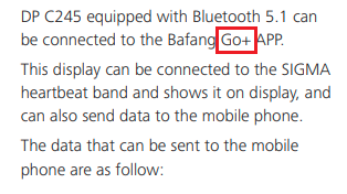

I was just checking the manual of DP C245.CAN and found this:
there are DP C244.CAN and DP C245.CAN. 245 has bluetooth and 244 doesn't. Nothing new.
But when you try to open the manual, there are two options:
One is BLE5.0 and another is BLE5.1.
In one it is writen:
and in the other:
So it looks like there are two versions of C245. One with BLE5.0 ant one with BLE 5.1. It looks like if you have 5.0 you can't connect to Go+ app. And it looks like thay have identical part numbers, so when you order one as a customer/dealer, you don't know which one you will receive..
I then checked the other displays and this is the only one, where there are different manuals for BLE5.0 and BLE 5.1.

Same here. Was described above in this tread. There are 2 Versions of 245, only the version with BT 5.1 can connect to GO+ app
and in the other:

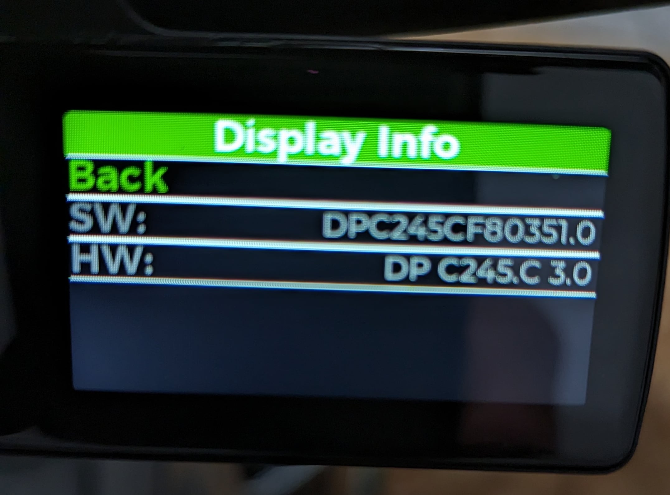

Bluetooth connection works great on my setup. Very happy with it so far.
Bafang M510 FC 2.0 with DP C245 Display. I am able to access the Options:
Set the personalized ride MENU
Support Level Settings MENU
Able to change Level Settings for ECO, TRAIL, SPORT, SPORT+, BOOST
Level Settings available:
Acceleration Feature
Max. Output Power
Current Speed Limit
Startup Angle *What does this mean?
Looks very similar to Besst Tool Settings except there is no Support Relation Setting on the Go+ App.
Can someone please explain what "Support Relation Setting" is on Besst Tool?

Just test on my M820 with DP C245 not working. Can U show us your DP C245 version? and what smartphone U use?
