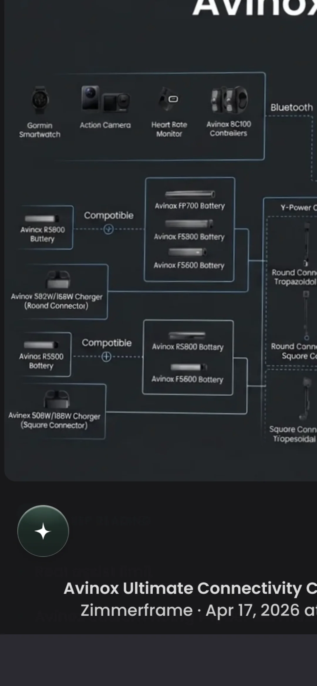

It would be good to see the original chart as some of the pixels are a bit blurry and it may be better in the original !?
Strange to find the chargers are shown as being different in more ways than just the plug-connector
Avinov 582W/I68W Charger (Round Connector)
Avinex 508W/188W Chorger (Square Connector)
Accessories Page (Amflow) both are 508W/168W
New Battery Shown - RS500---RS800/FS600?
(Must be RS600---RS800/RS600)
Above - Same image labeled RS800---FP700/FS800/FS600
(Must be RS600---FP700/FS800/FS600)
Some pixels may have gone astray !?
Hence my wish for the original
Cheers All
Yup, it's far from perfect !! I think the RS500 is the RS600 with pixel blur !! I'll clean it all up later when I enter my next phase of boredom.
And yes, it's interesting the fixed and removable batteries have different chargers - but we saw the different ports on release day :

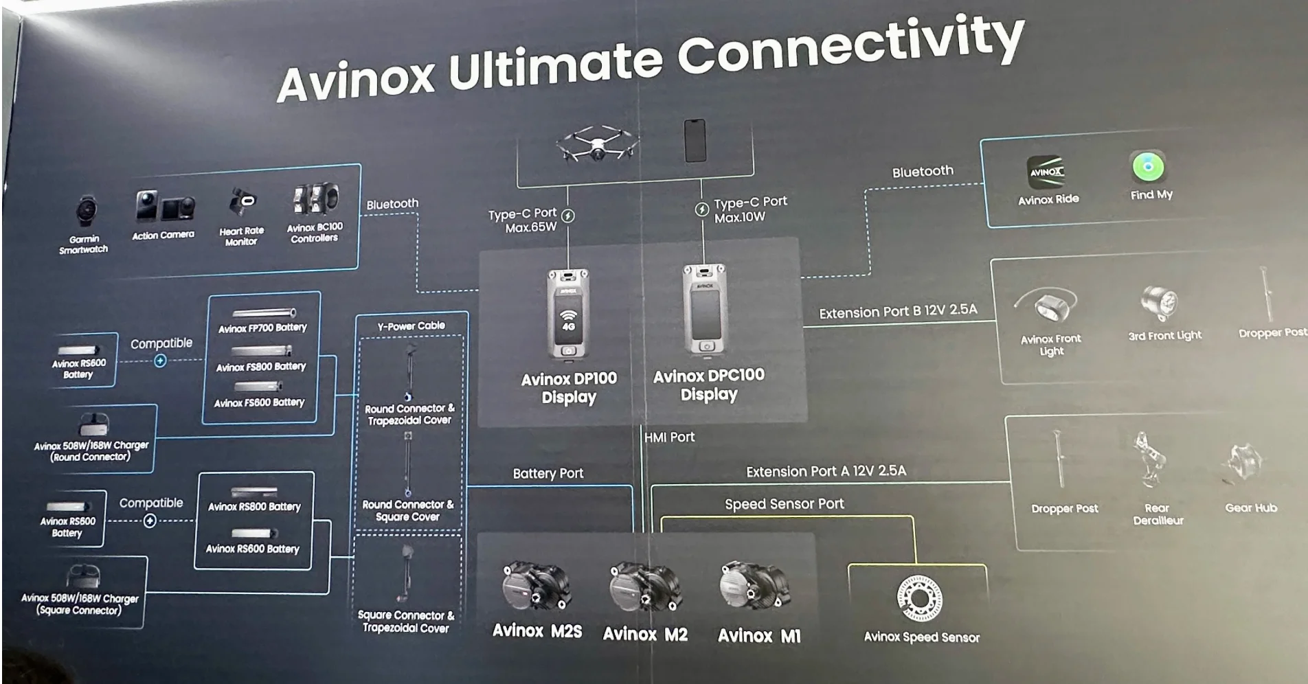

Now in your White version (Before Upgrades)
We have Buffery, Buttery, Bottery and Roand !
Maybe more - Definitely some pixel spreading/AI stuff going on !?!
Like your upgrades too
Makes more sense RS600
Pixel Drift !
Great diagram - Wish they would let it into the wild !
Cheers
🍿 While I wait for your next boredom inspired creation ...

Oops thanks. Yes, was lazy and used AI which normally does some weird things. Have edited it manually now so it's a bit clearer !
👍 @Zimmerframe
To be fair the AI did a pretty good job of squaring it up and getting the lighting better.
Plus like your future upgrades chart 🙂

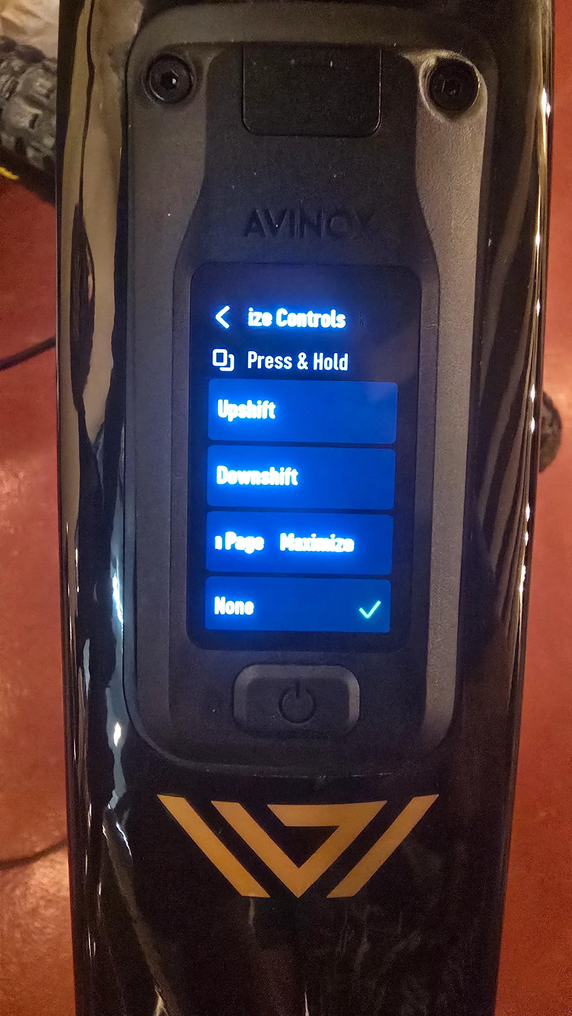

Has anyone noticed that the Avinox remote control customisation options for the right hand buttons now includes "upshift" and "downshift", alongside all the other stuff like screen changes and HRM control.
Perhaps the cable change is somehow linked to being able to control AXS derailleurs from the Avinox buttons? Perhaps two wires are for comms to tell the derailleur to change?
Id be happy either way, control avinox modes with AXS pods, or control AXS derailleur with avinox remote.

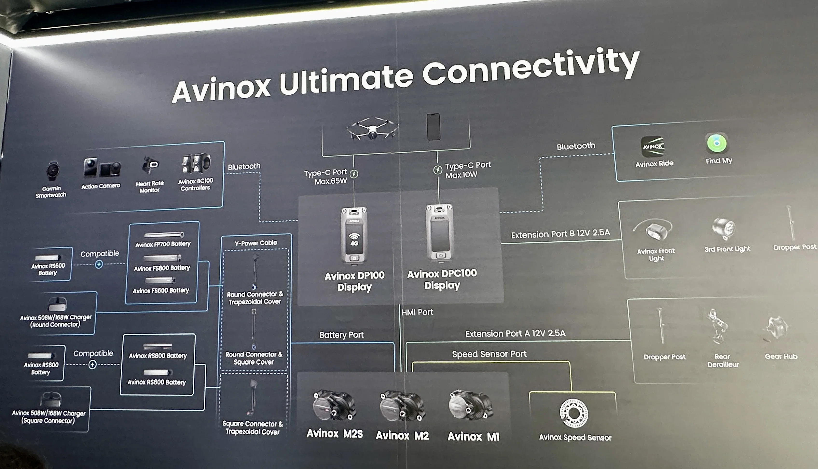

Ok. More information direct from Avinox. The new cable port on the motor, (Extension Port A) is now a CANbus port. On the M1 motor. It was only a 12V power supply.
The SMAM AXS derailleurs do not use the CANbus data cables. It only uses the 12V power supply. But if you plug a dropper in, it can use the CANbus and not trigger the Smoothshift.
You can also buy Y connectors so you can daisy chain multiple devices off the same Extension Port.
So yes. I'll just need to join the Red and Black wires on the Z405 light plug, and the SRAX AXS power cable. I will put a voltmeter on the red and black wires to confirm this.
What is interesting. Is that if you connect a transmission system that is CANbus compatible. You will be able to use the Avinox remotes to change gears. Hence why there is now that option on the M2S motor, but not on the M1 motor, as the M1 doesn't have the CANbus port coming out of the motor.
