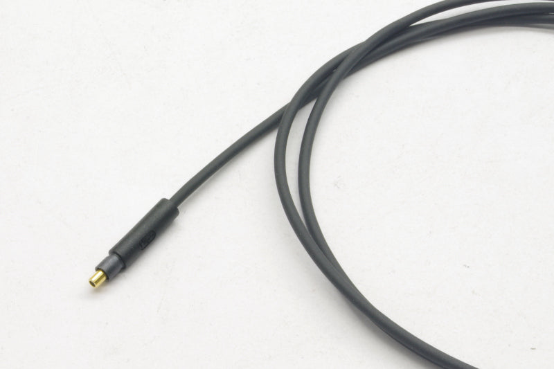

AXS Cable built and installed, and new S1000 derailleur fitted. I have tested everything including Smoothshift. Everything works perfectly. It was as I previously posted.
SRAM AXS Power Cables.
Black is the Positive +
Blue is the Negative -
https://www.theoddspoke.com.au/sram...jLIn6P7ms6rmj9dbV8hWcao7vfBe_dNHgsy5Pk6DaIDJN
I have the Ebike24 cable.
Red is the Positive +
Black is the Negative -
DJI Avinox Light Cable 500 mm | eBike24.
With my two cables the correct wiring is. AXS Cable Black with Light Cable Red. AXS Cable Blue with Light cable Black.

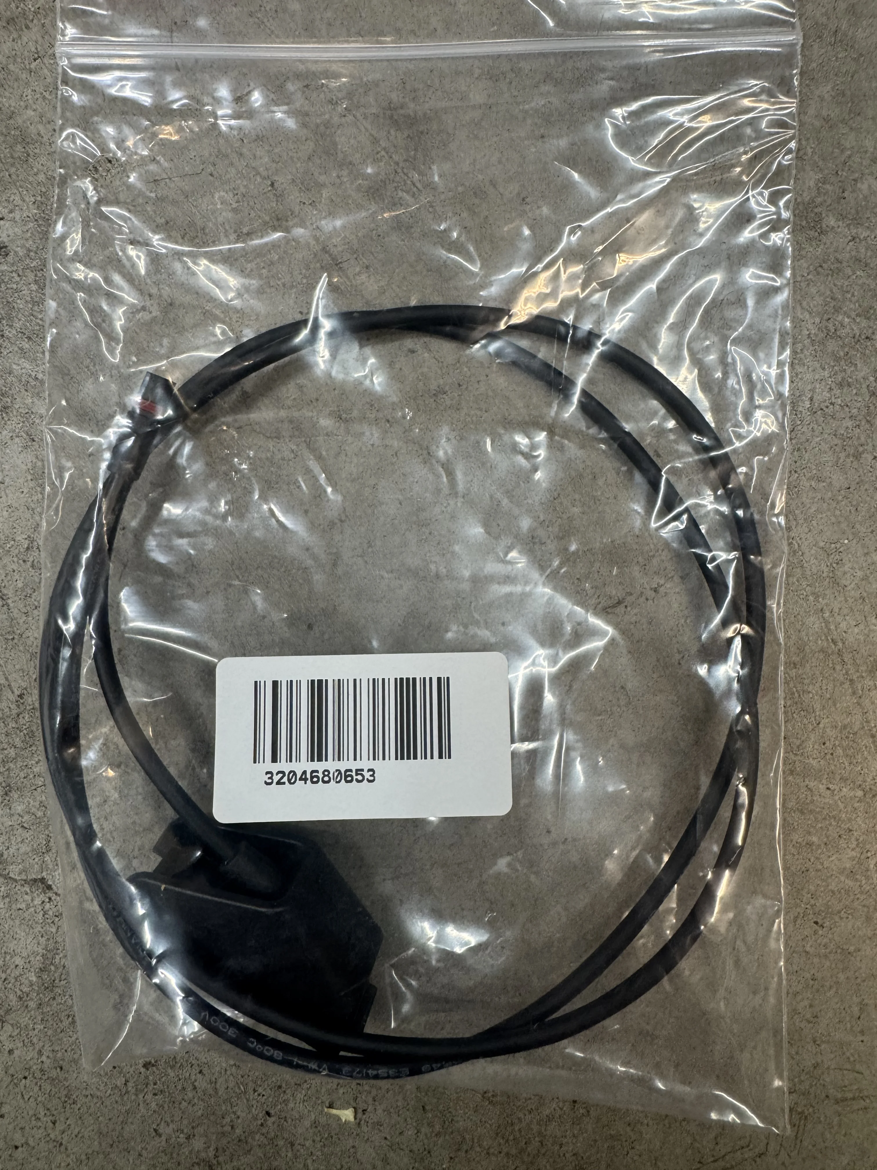

I have a Bosch cable (with the Bosch end cut off), and M1 Higo, and an M2(S) Higo going spare of anyone in the UK is after one. Bought while waiting on my Druid before I knew about the change, and the M2(S) after I knew but before I got my frame (didn't know which tier I'd be getting).
I'll get pics up tonight

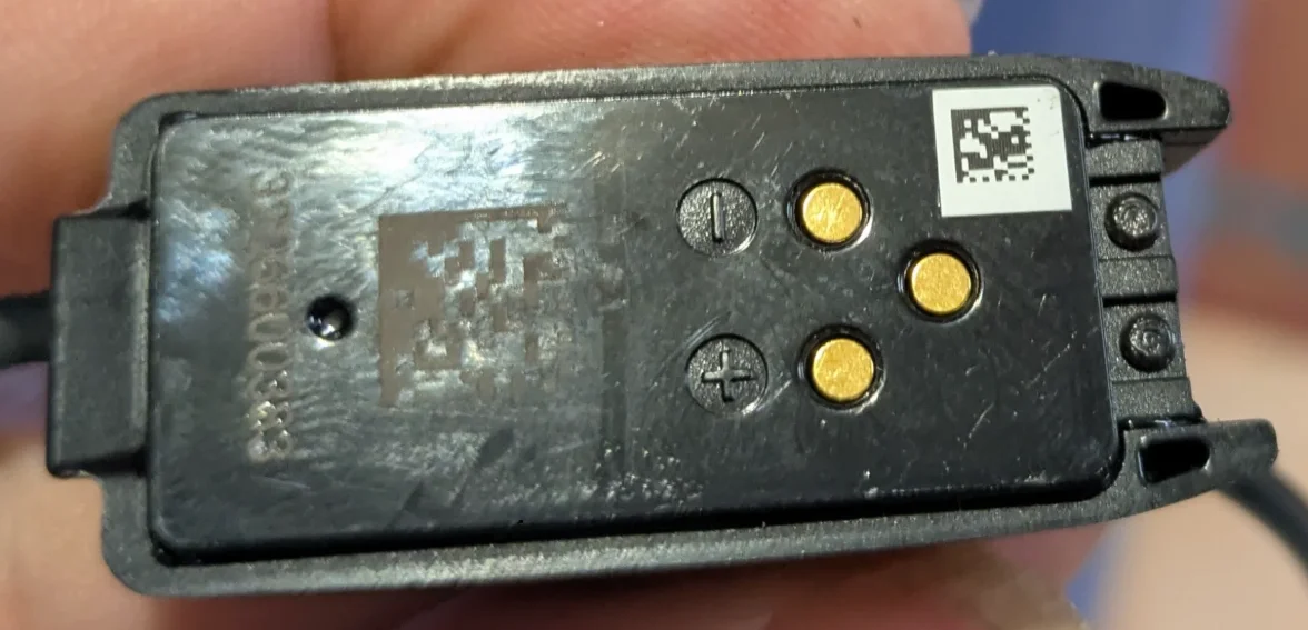

Anyone having any issues with these? I’m not getting any power to my derailleur. 2 day old dreadnaught E
Anyone having any issues with these? I’m I’m
nope factory , just stopped working
Quick check. See if the adapter is seated properly into the derailleur. Maybe a bit of water dispersant and contact cleaner will help.
If not. You'll need a multimeter to find it. You need to check if you are getting 7.4Volts at the pins that clip onto the derailleur, to determine if it's derailleur or cable.
Then if it's the cable. Check if it has 12Volts where it plugs into the motor.
If derailleur. Then you'll need to take it back.
