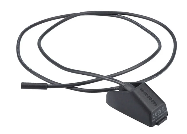

Finally I could measure the M2s motor.
I have this: https://www.velofactory.ch/SRAM-Cable-Extension-Cord-780mm-Higo-Micro-A
It has two cables Black and Blue. As @Astro66 has posted, and I did measure it too, it looks like this:
Black is the Positive +
Blue is the Negative -
And this: Buy Supernova Connection Cable - Avinox / DJI New online
It has two cable Black and Blue, I did connect to the M2s and measure it and here is the polarity:
Blue is Positive +
Black is Negative -
With this two cables the correct wiring is Black with Blue and Blue with Black.
For safety I would recommend that you do your own check in case that cables are different.
Looking at the supernova light cable plug this is how the polarities are:
I have now built the cable next week I will test it.
Forgot to give you an update, cable works perfectly did already 3 days of riding with it.
AXS Cable built and installed, and new S1000 derailleur fitted. I have tested everything including Smoothshift. Everything works perfectly. It was as I previously posted.

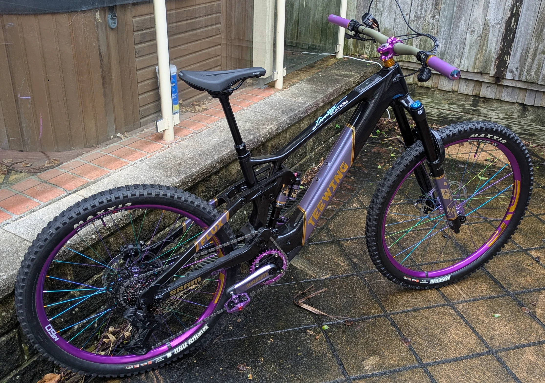

how’s the bike?
how’s the bike?
Only ridden it around my local urban training trails. I'm waiting for the Ride Wrap to turn up. Supposed to be early June. I just can't risk damaging the graphics. The man hours in the purple vinyl wrap was exhausting.
But I've ridden it up and down some local stairs, and off a few hucks to flat, and it's so much smoother than than the Amflow. But I can definitely climb better on the Amflow. You feel the extra 2kgs and longer geometry, in the Flux. So it doesn't feel as nimble. But that's not what it's designed for, nor what I got it for. It's designed to flatten the bumps when descending, and that it does well, whilst still being a very capable climber, due to the M2S.

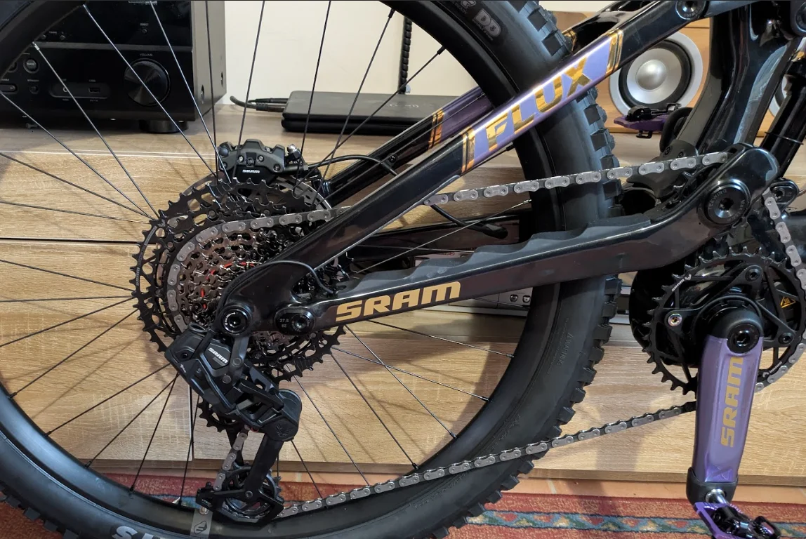

What makes it 2kg heavier? Can’t be the frame alone?
Stronger Frame,
Bigger and stronger Pivot Linkage,
Bigger Shock,
Fox 38 Fork Vs Fox 36,
S1000 derailleur Vs X0
XS-1270 Cassette Vs XS-1295
GX Chain Vs X0 Chain
Additional structure for the high pivot.
M2S motor Vs M1 motor
Alloy wheels Vs Carbon.
Couple of 100 grams here and there adds up.
I could spend $4-5K on the bike and get the weight into the 22kg range. But it' my downhill EMTB, where weight isn't my endgame. Unlike the Amflow, which is my Adventure Trail and Climbing Bike.
I was looking at the Flux but I don’t want another 52 pound bike. Sorry going off topic.
Flux One Pro is about 50 pound. But you won't get any 180/180 Enduro, with proper tyres, under 50 pound. They are designed for big impacts. This requires well built, larger components. My Amflow PL Carbon Pro is a Trail bike, thus can use much lighter components. But is less capable in technical downhill. So you'll need to go slower, and you cannot jump off as big drops.
