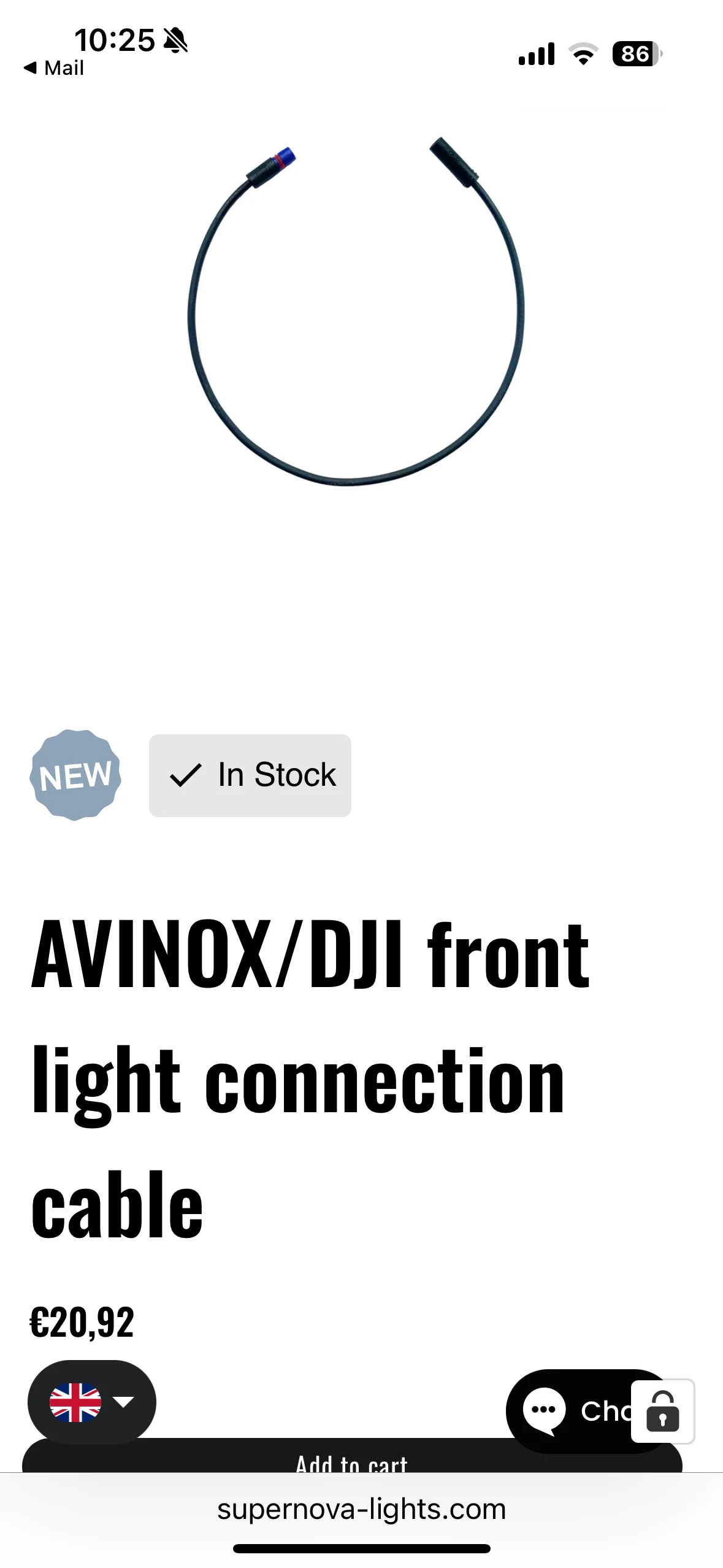

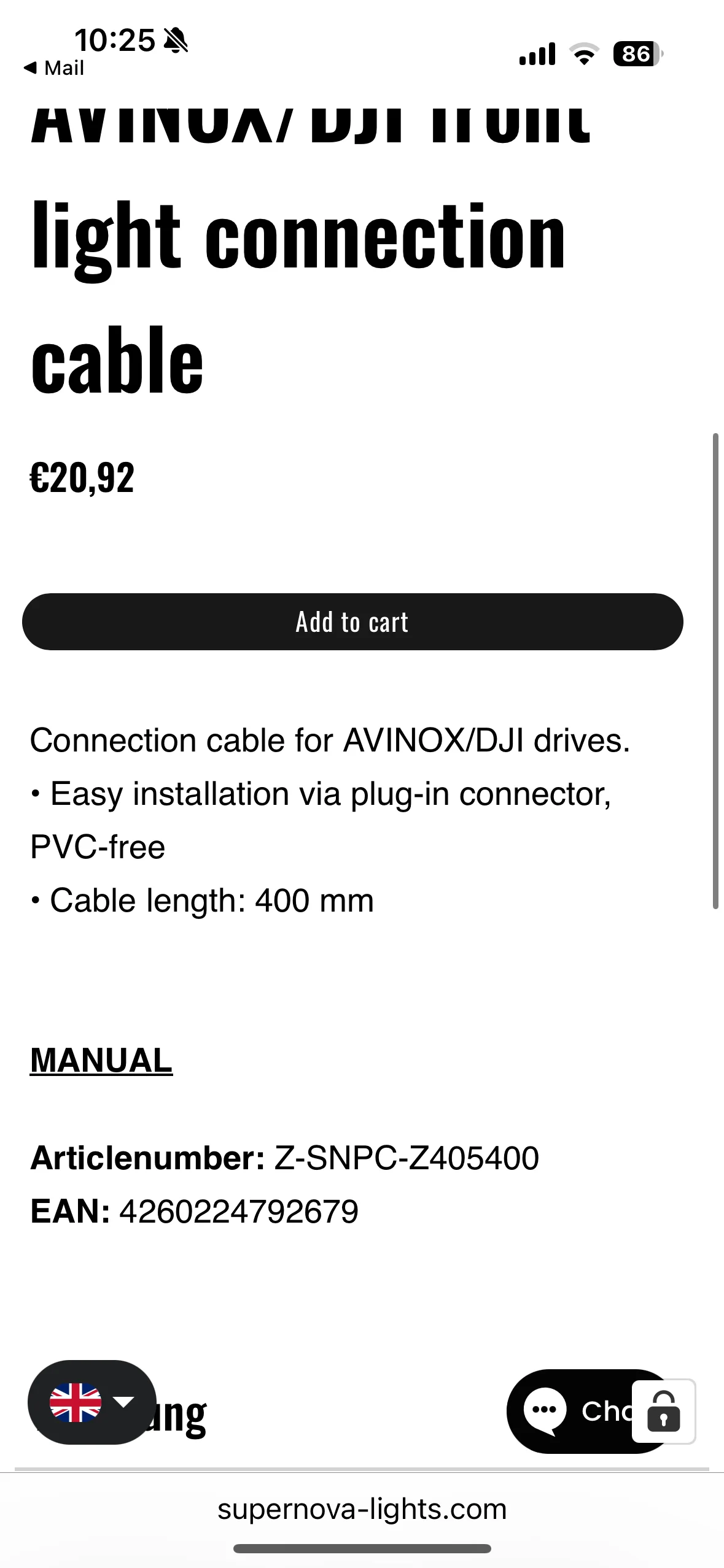

Don't think Supernova ship to UK 🫤
eBike24 €200 minimum
Nanobike don't ship outside EU
Contact about UK shipping !?

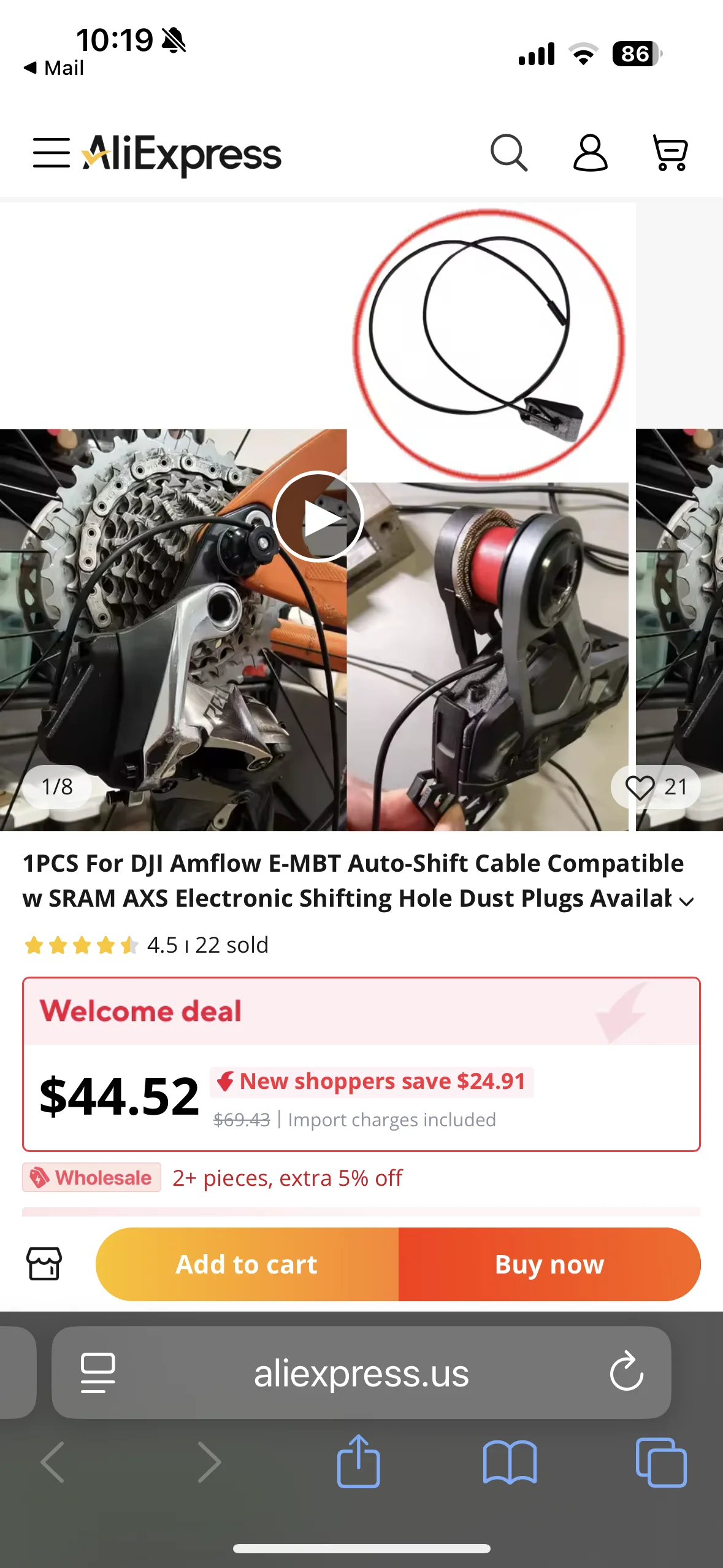

DJI is currently custom making these AXS extension cables and has essentially taken over production for Sram. I should have 30 of these soon. Hopefully they will arrive in time for our first batch of Teewing frames.

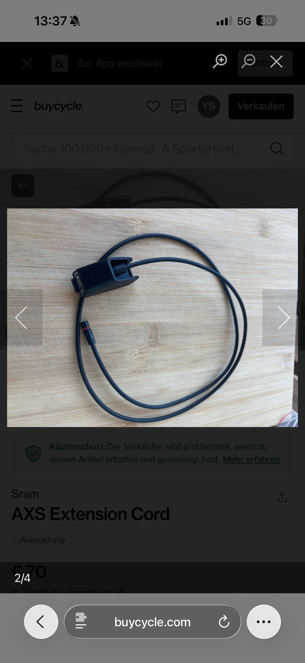

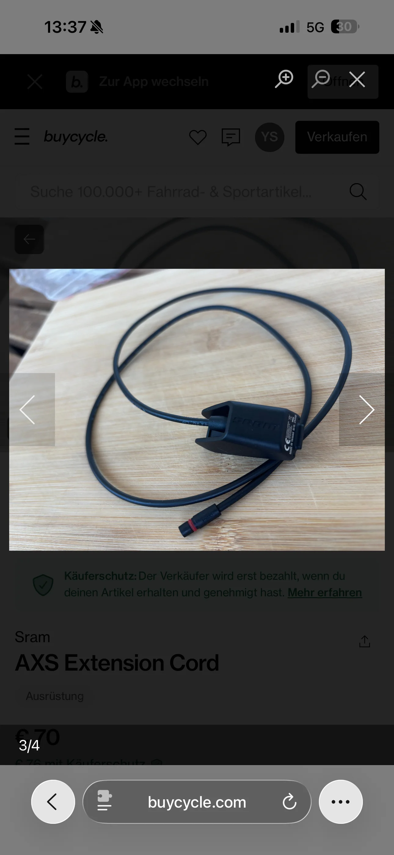

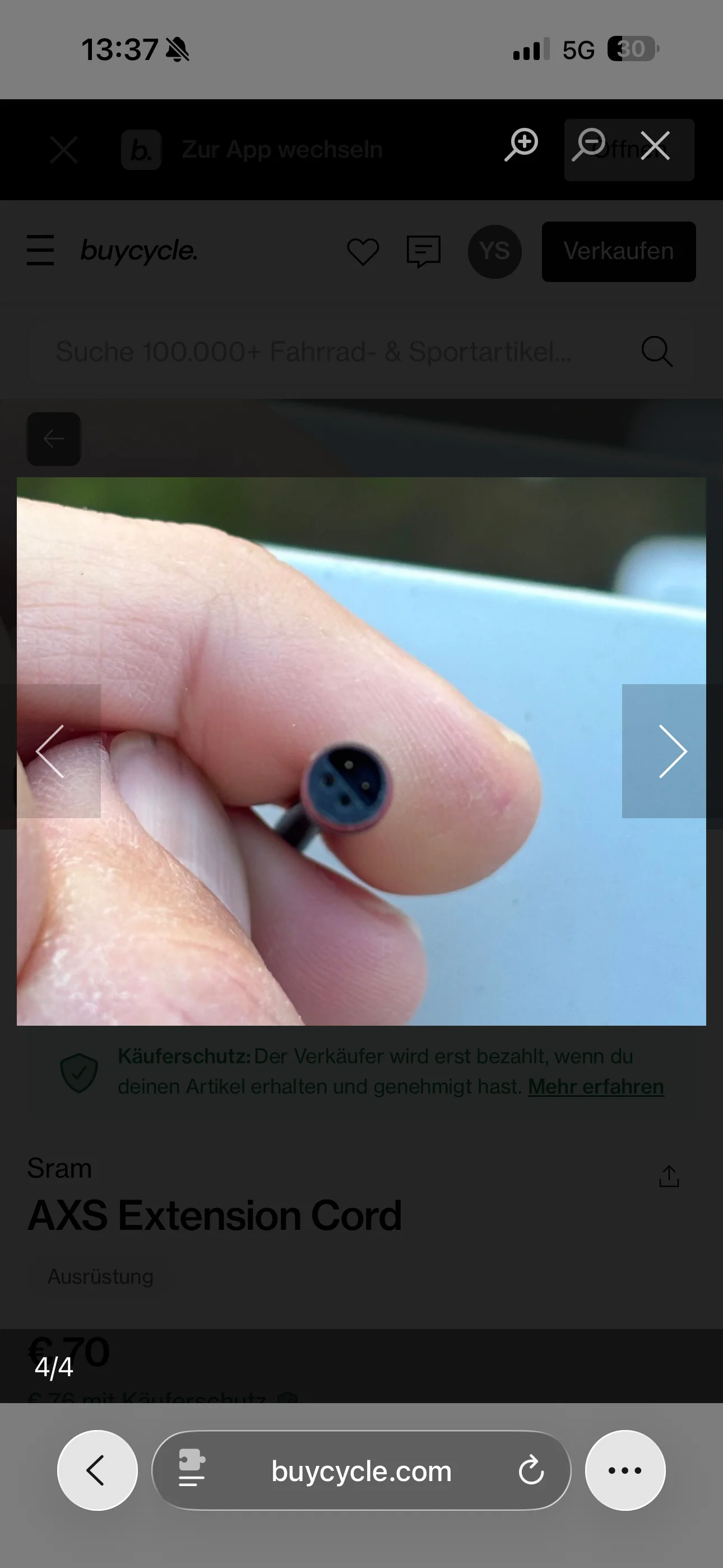

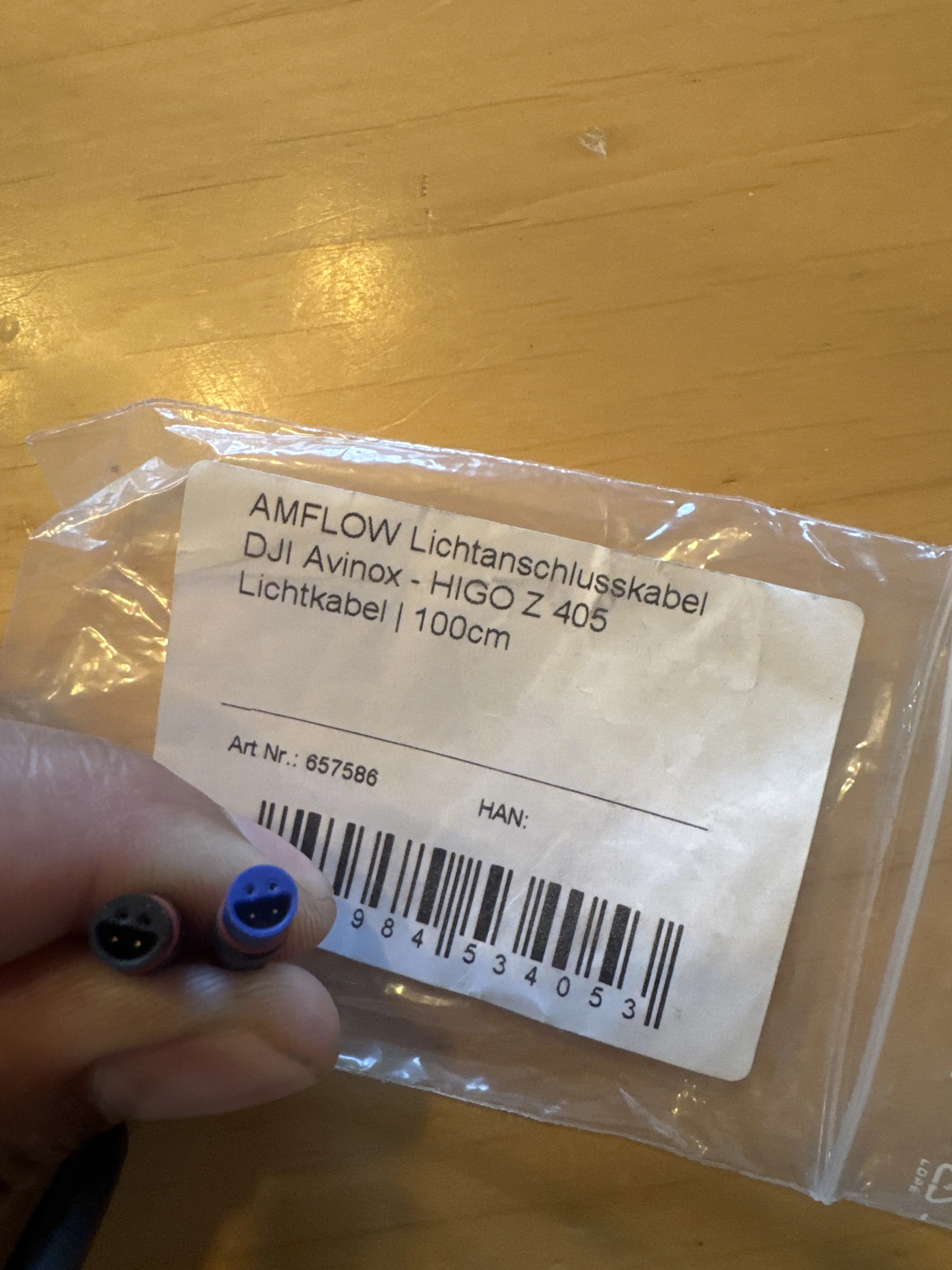

I just randomly purchased a cable to convert it to the z 405. Just realized after cutting, that it was already the right connector. Also the wiring seems correct. So they’re already out there.
So you randomly managed to get the mythical correct Amflow-SRAM cable ?
Where did it come from ?
Just have to join it back together again ...
More pictures 🖼️ please.

We need the photo of the cable bag that the AXS Power cable with Z405 connector, came in, not the light cable. And where you got it.
Also, I'm assuming one of those cables you are holding, has a battery clip on the other end ?
The blue one is the light cable - I have the same one from nanobike.de

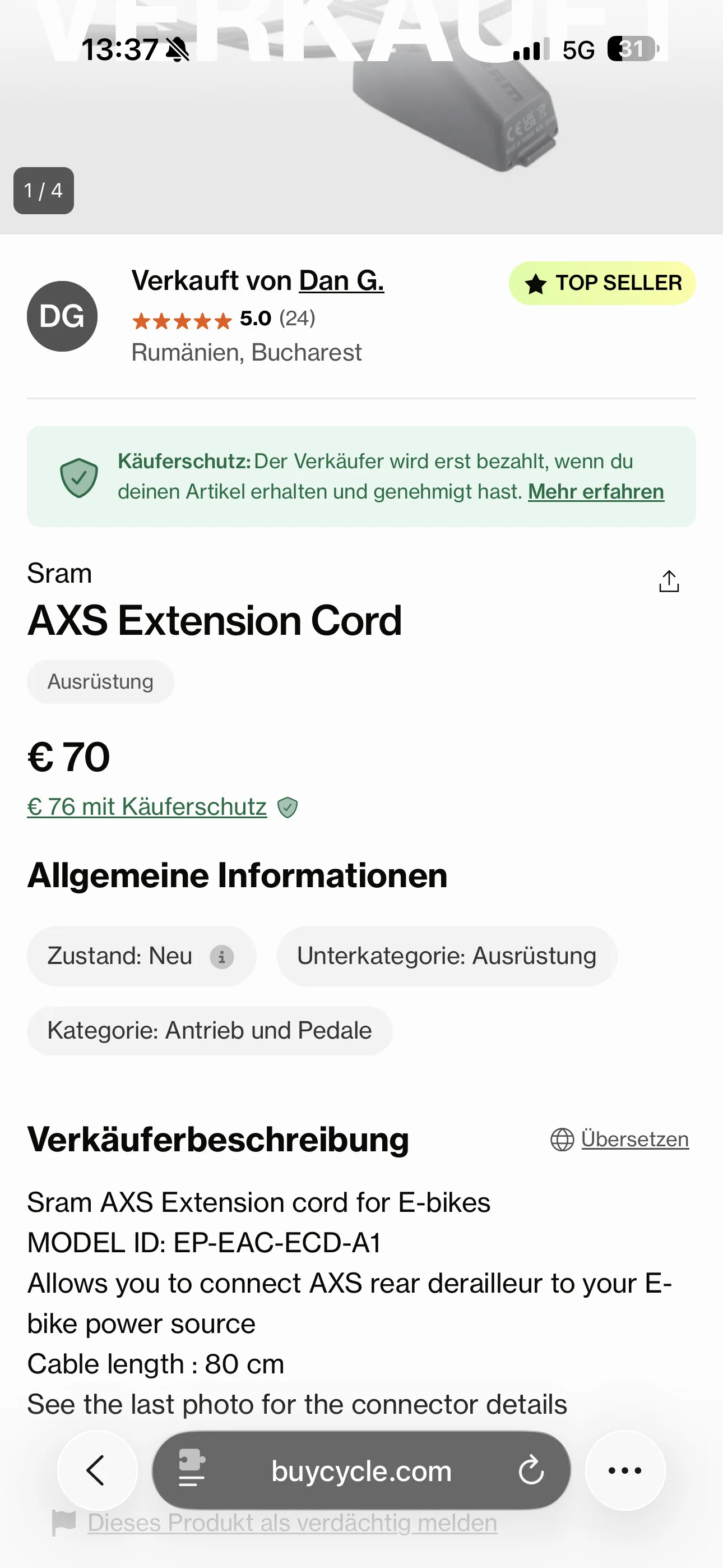

I bought it on Buycycle.com from a private seller for 70€. Just ordered a second one. The blue one I got is the lightcable from nanobike. The black one on the left is the one from buycycle with the SRAM adapter attached.
EDIT: Got confused about the whole talk with the z 405 light cable. Just looked at the color black and figured it must be the wrong connector.
EDIT2: @Astro66 It came without a bag so I got no serial for it sorry
