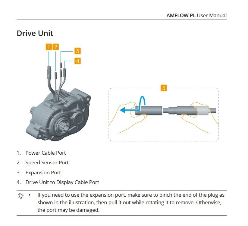

Does anybody have an installation video or fotos on how to connect the cable to the battery. I have an Avinox motor on a Megamo Reason. Thanks

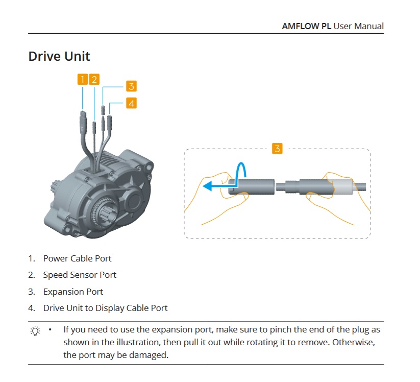

It connects to the motor using the "Expansion Port"
Motor needs to drop (not remove) for access, held by just two long bolts, no need to remove pedals or cranks.

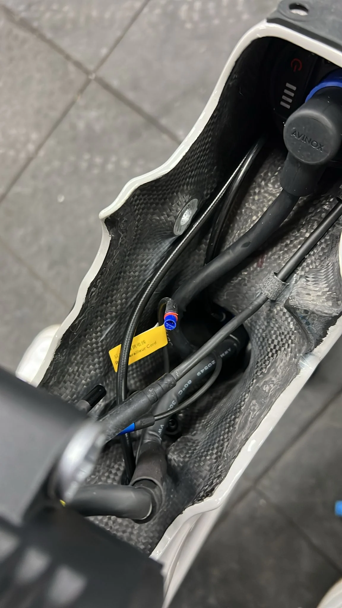

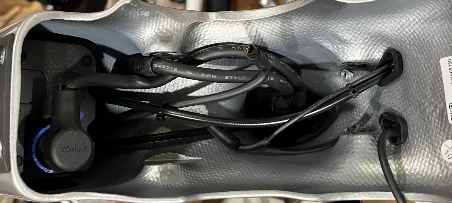

I installed in 15minutes the axs cable (POWERTRAIN 780mm) between my avinox motor (bike: megamo reason) and my GX T TYPE AXS...
So easy, the cable go through the carbone base without any issue, the motor can be remove easely too (i just remove the chain ring because the big bolt which is behing it : my hexa key is too big to go thought the chainring)
I don't understand why some sellers propose the micro A Higo cable for the avinox motor when the Powertrains cable is OK.
There is plenty of space in the vertical tube to insert all the cables.

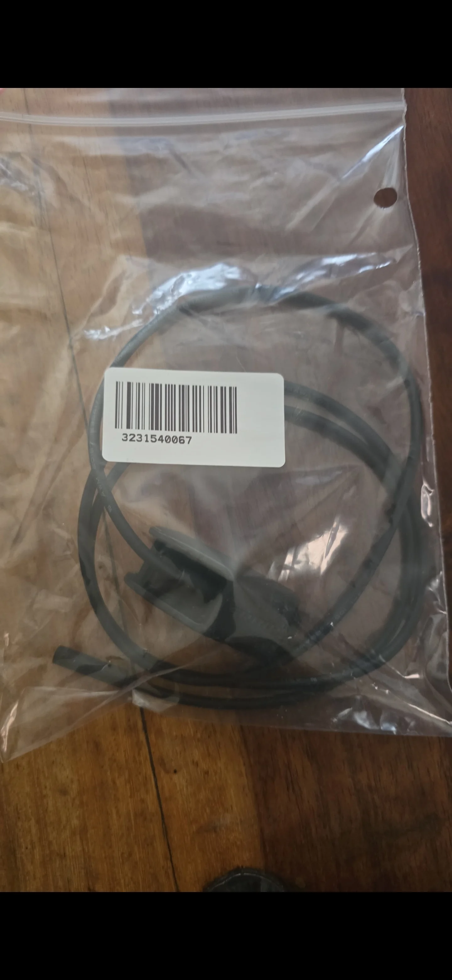

So I have the cable in the op (the connector is 1 single pin)

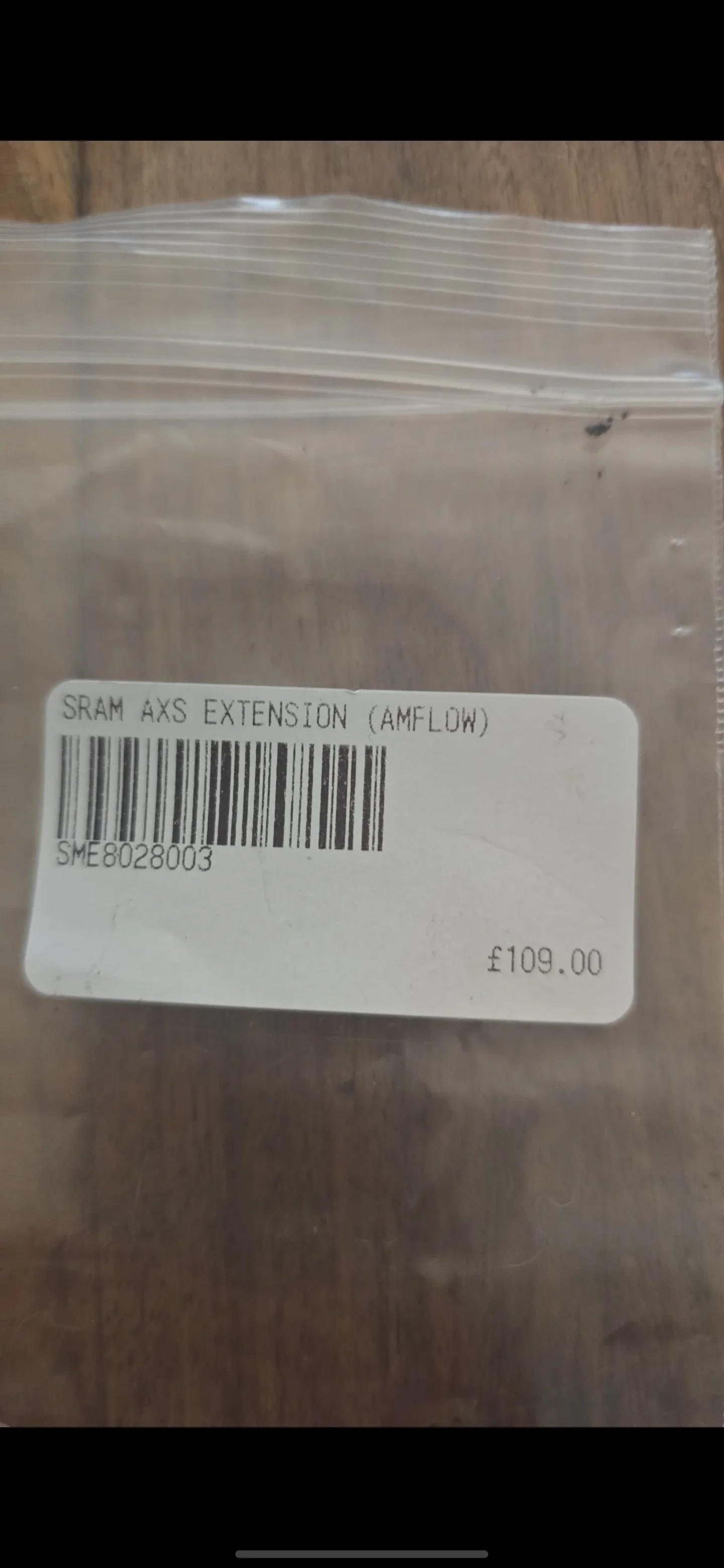

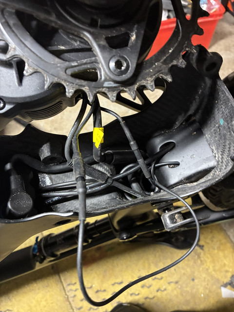

I've got the m2s motor and had it out of the bike this morning to check and see if I could connect the axs cable. It does not fit. £109 wasted :(

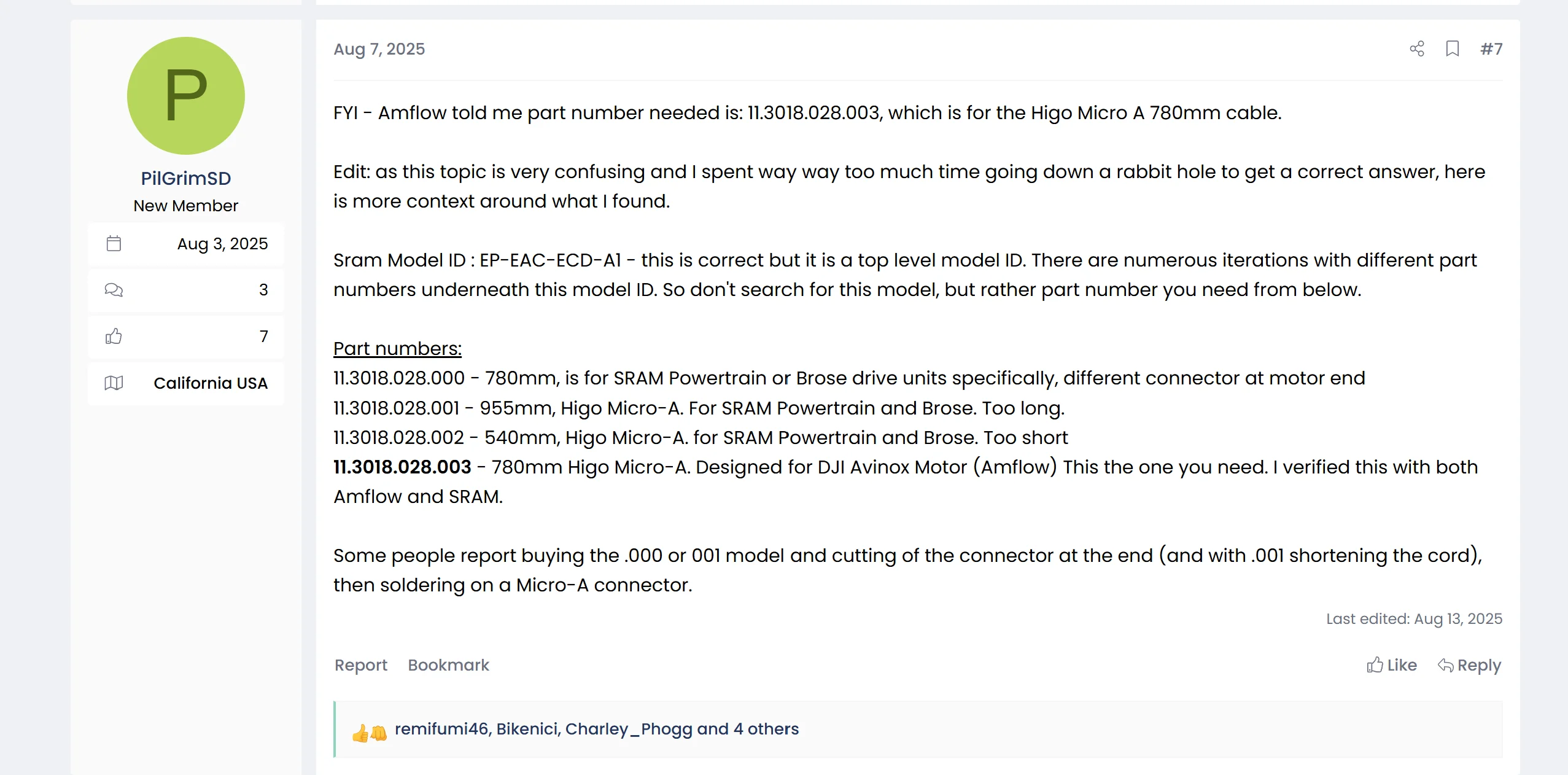

you bought the 11.3018.028.001?

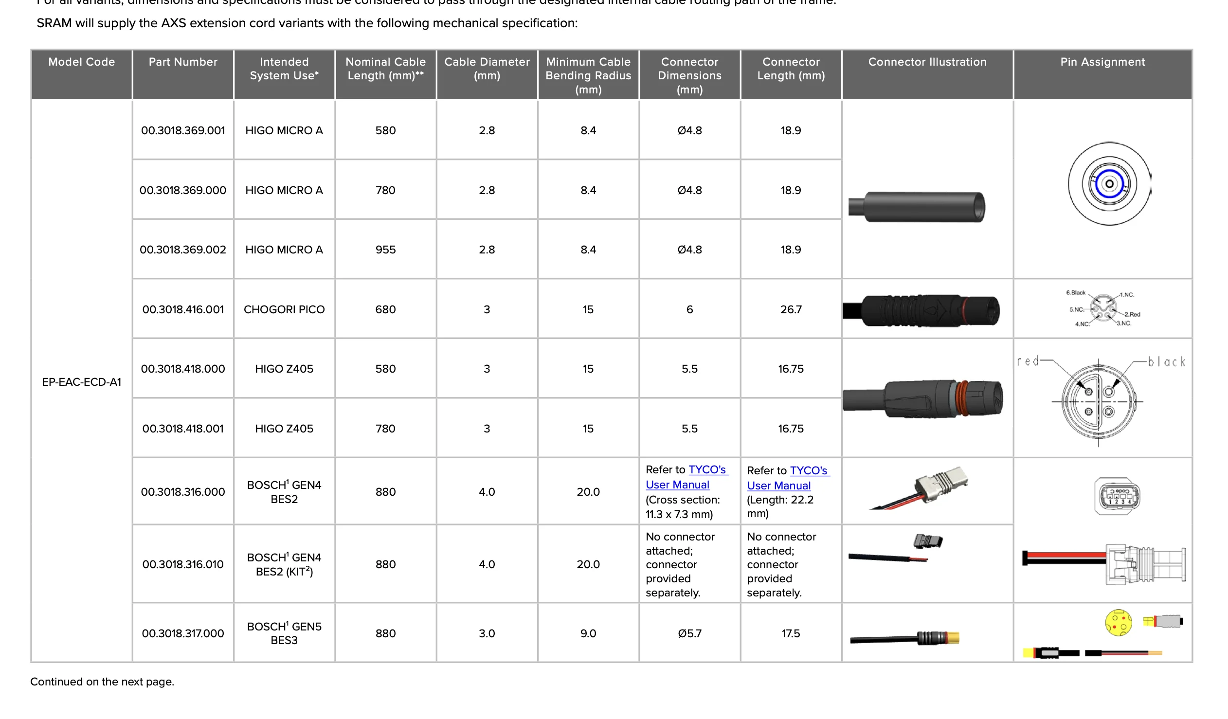

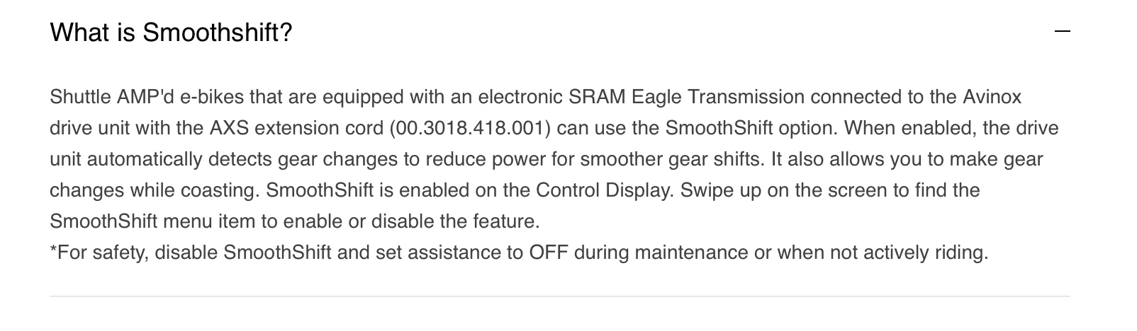

00.3018.418.001 780mm Cable (Higo Z405 connector) is better if your bike comes after April.

Can you post a photo of the end of the derailleur power cable coming out of the M2S ? If it looks like this. Then it's different to the old motor.
If it looks like this. It's the same as the old motor.
