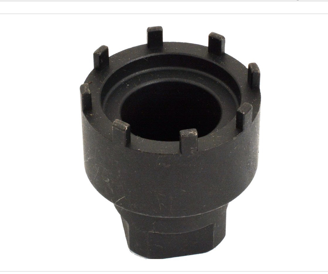

It seems your chainring got loose.
Take off the crank (allen key) and thight the sproket lockring with special tool:

No, the lockring keeps the chainring tight only. No other function.
