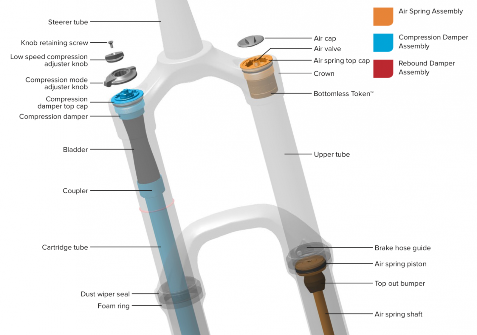

thanks for your reply....... Um... What are tokens??
G-Bru
Jan 8, 2019
96
70
United Kingdom
Ok now I understand that is an awesome diagram so that token could be loose and I can fix that myself can I?
Yes, my Lyrik had 2 installed from factory and 1 of them came loose and was rattling round on top of the airspring. They simply thread together. Not saying this is your problem, but easy enough to check. Make sure you release all air from the fork before removing the top cap!!!!!
