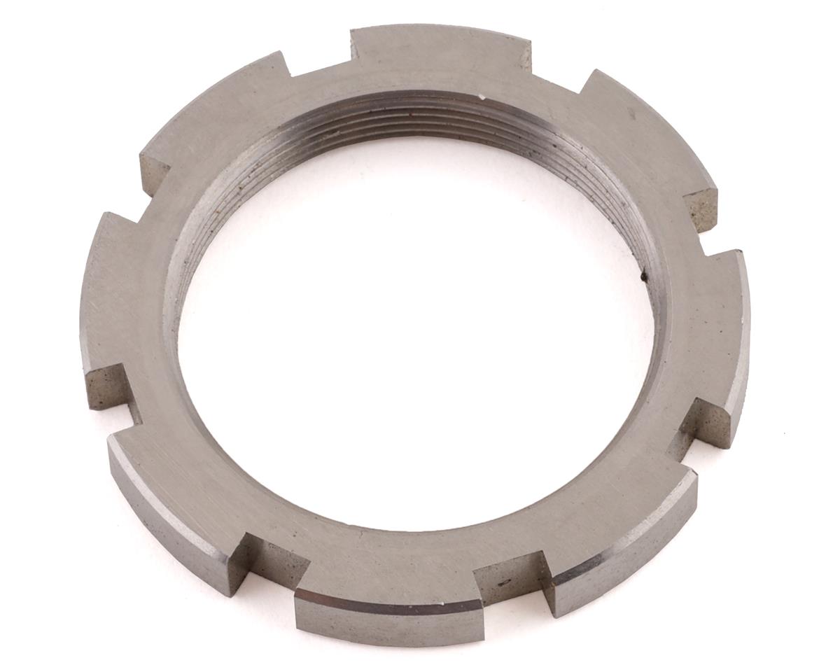

check the groove nut on the chainring side of your crank arm

Rattling? I appreciate the reply, but that thing is so machined to fit those threads and is on there so snug (I've pulled it off and put it on at least three or four times for various reasons), there is absolutely no way it could be rattling unless it's completely off and I would see it. Any other ideas?

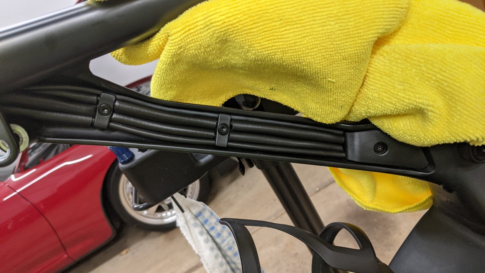

Mine is also rattling. I think its the cables that enter under the side arm into the top top and along to the TCU.
When I get a chance I will take the shock out and stuff some bubblewrap inside the tubing to see if that helps. They really should add some kind of packing foam / damping material into there upon assembly I think.

the cables do rattle in the top tube! usually right underneath the TCU. i would remove the TCU and pull out the extra length of cable floating around under there...add a couple extra zip ties to the cables and re-install. this is very common source of a rattle in these bikes.

Did the wrapping and padding under the tcu. didn't solve it. going to try the area near the shock going up toward the tcu next. thanks for the suggestions guys.
