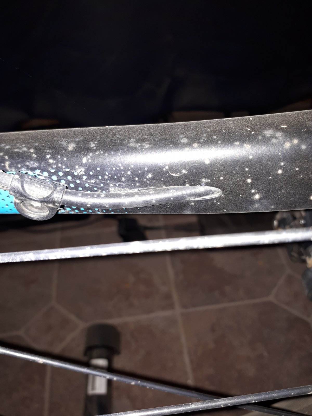

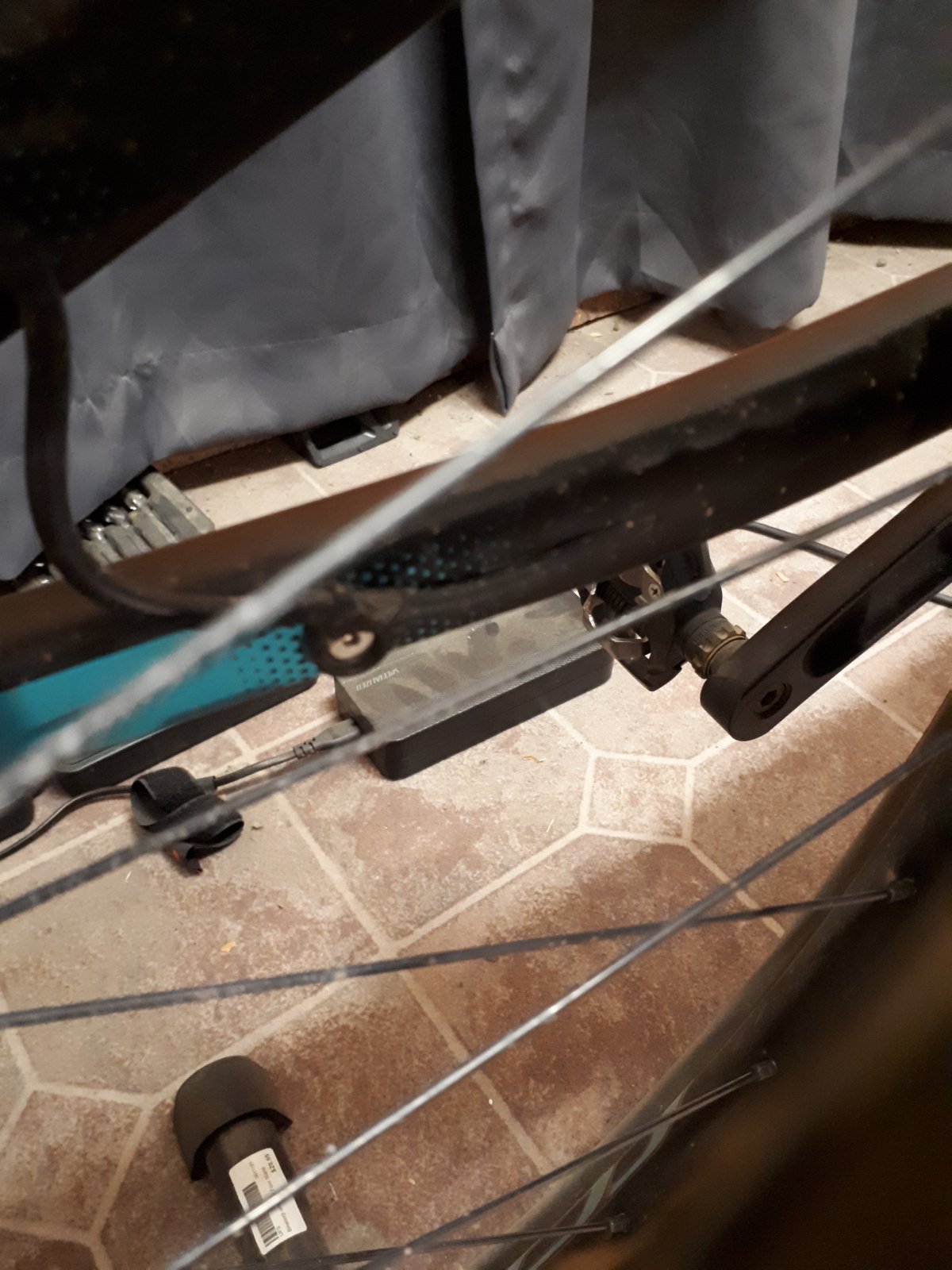

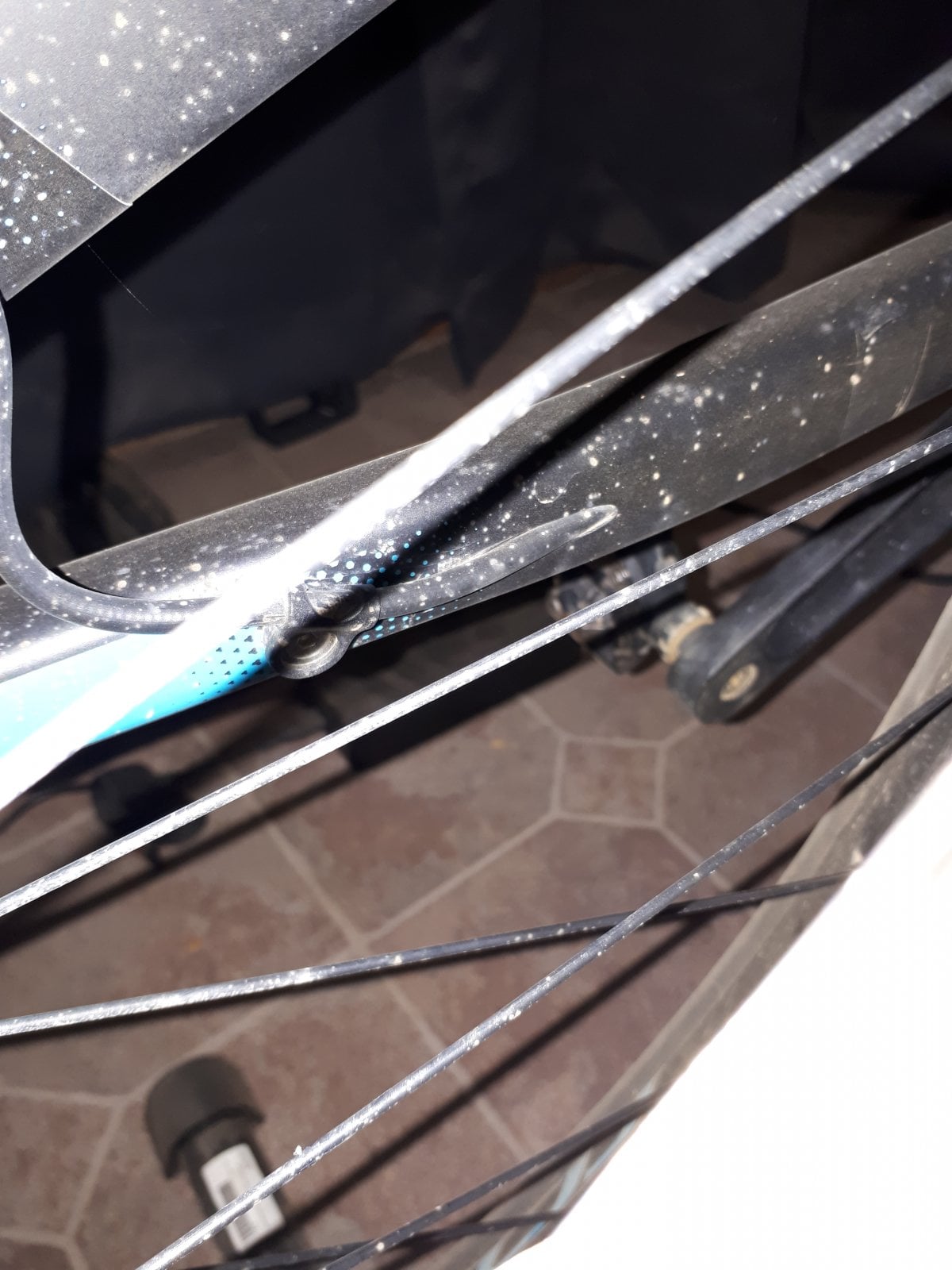

Just pulled the right cable out a little bit put some tape around the cable to make it thicker. Pushed it back in again with the tape. It dosen´t rattle anymore anyway...The big issue for me is that the brake cable is wearing out only after 4 rides where it goes in to the backswing, you can now see metal on the cable.../: It´s a very sharp edge where it goes in to the swing arm. Am I missing some rubber piece here or are your bikes the same??

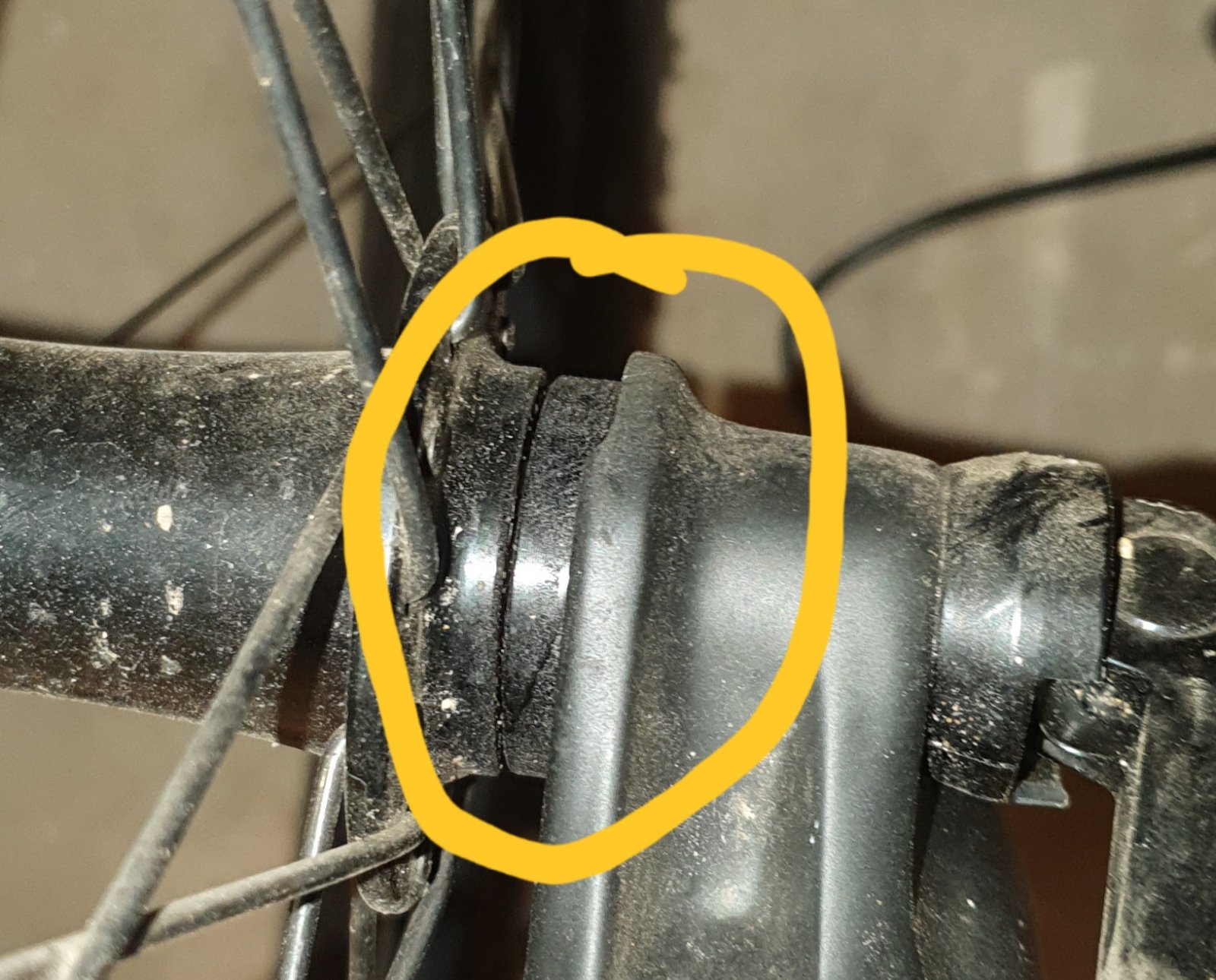

If you've ever removed your front wheel, check if the spacer that makes it extra snug is still there. (It lies loose on the hub, accorind to the LBS it gets lost sometimes.)
I have the same issue and I am convinced it comes from the front hub, the end caps of the hub feel very loose when the through axle is on. What spacer are you referring to? I don't think mine came with one, but it feels like one should be there to keep the end caps snug. Do you have any pics or even better link to the part?
That explains a lot! Mine is loose even when the axle is on. I did ask my LBS about it and they told me it is normal but I think it is time for another visit.
Mine is loose too. Had been asking myself already why this would be designed in this way. However as the axle is fixed and I don’t have any issues I didn’t pay any attention too it.
I sent an email to Specialized rider care this morning and they were very quick to respond with the following, back to the LBS this weekend I guess!
Thanks for reaching out. No, I wouldn't say that is normal. The rings are there to take advantage of the larger clamping surface on the Rock Shocks fork and they should be snug. The best thing to do is to visit your local Specialized retailer to further evaluate that. They can contact their service rep if they need additional assistance in finding a solution.
Maybe to clarify what Maastricht's and my LBS said:
Yes, it is loose on the wheel, it can rotate, it comes easily off, but when the axle is on and tightened it is snug and has no room to rattle or whatever. It clamps into place. Basically it fits perfectly.

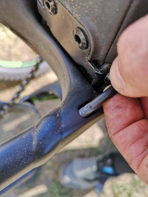

Check the headset is correctly tightened. Mine loosened off after a few rides. If you have a Swat tool the allen is at the bottom of the headtube.
Piling in on top of what Scoobaru wrote. Great advice! I tightened my headset and voila the noise is gone! This was the final step in my 2020 Turbo Levo Expert noise abatement plan :) Earlier I had a bunch of electrical cables rattling around in the top tube. I unscrewed the TCU display, unplugged the cables and threaded on some pieces of old road bike inner tube onto the wires to stop them bouncing around against the carbon. Now my bike is as quiet as a church mouse!

After seeing this thread, I watched a YouTube on tightening modern headset: must loosen 2 handlebar stem screws, then tighten Allen at top of headset & check bearing tightness. Retighten stem.

Some of my cables move freely, and the sound really sounded like it could be the electrical connectors in the top tube under the TCU, so I removed TCU and rode with it dangling beside the bike, connectors outside the top tube, and got same tapping sound. Mine was totally fixed with head tube tightening (3 bolt process).
