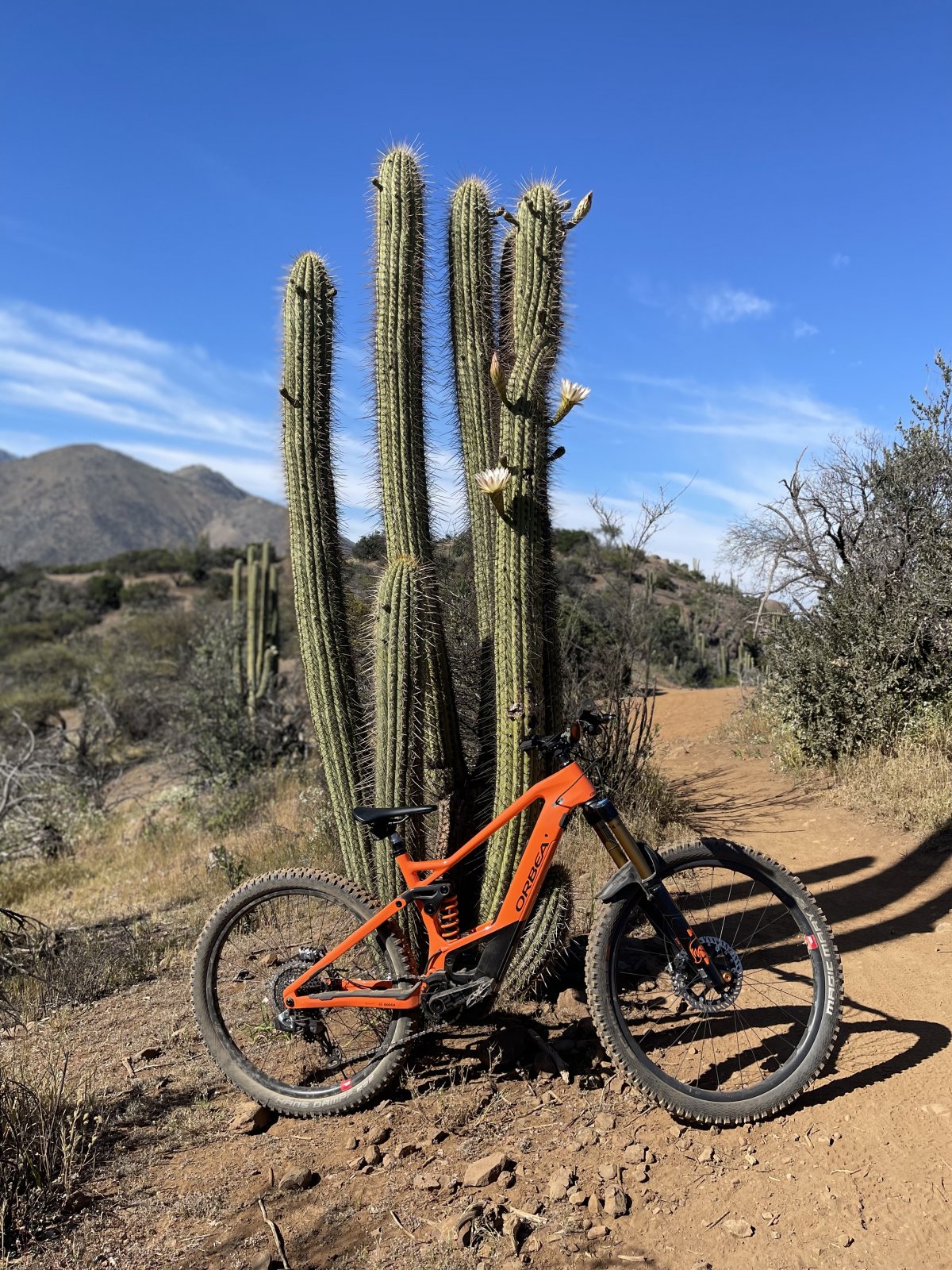

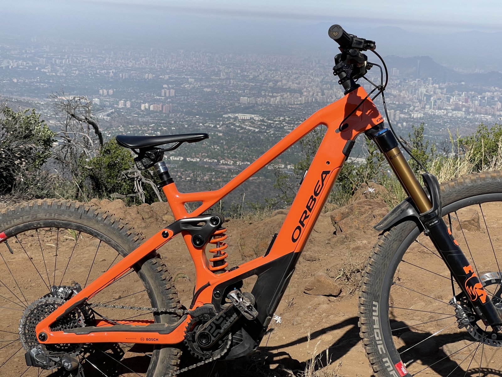

Hi, I went with the fox 38 180 mm. Perfect choice. Couldn’t be happier

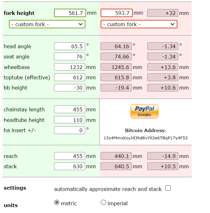

That must make the reach ,which is really quite short as standard, even shorter. Does it take about 10mm off the reach?
edit : I plugged the numbers into a geo calculator, results below. Green is the standard bike with a 36 160mm fork, red is with a 180mm fox 38. Both sets of numbers assume a size large frame. reach shrinks by 15mm, head angle ~64deg, seat angle~74.5deg.
yes, but I went for the L size (been a medium with 174 cm), 50 mm stem to compensate, handlebar a bit forward. The bike is super stable, no complains there. The fact that de bb drop is massive on this bike let me pull the trigger on the 180. Super happy with the choice.
The axle to crown length of the 38 160 mm is 573.7 mm. Could you please give me the name of that site/app? Looks interesting
I was comparing it to my 2020 wild fs which has the fox 36 fork, so compared to the now standard fox 38 160mm I guess your reach will have reduced by ~10mm
heres the website - I use it all the time for working out what would happen if I changed X on my bike.
geometryCalc (muha.cc)
