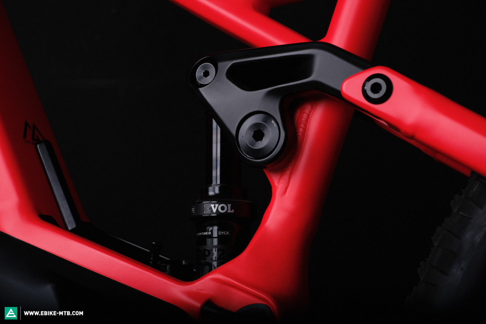

Heres an image of that area of an aluminium model that I found on the web, They've smoothed off that weld pretty well, looks like they might take too much material off/or not have enough weld in that spot in the first place.
Mikerb
May 16, 2019
6,140
4,672
Weymouth
form over function. The fillet weld above that area is a proper weld.....but not wide enough!

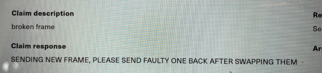

Good news They are sending a new frame.
Now all I need to figure out is should I but an Orbea Rise m 20 at 25% discountand sell the wild FS when the frame is swapped or just keep it.
I am really on the fence after trying my mates rise :)

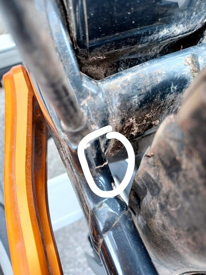

I had the same issue, but I stopped riding my bike as soon as I saw the crack in the frame at that same spot. Orbea let me upgrade my alloy frame to a full carbon for a very reasonable fee. That's what I would recommend you do, I have the Wild and my buddy has the Rise. I would still personally get the Wild. The carbon frame is also 3lbs lighter than the alloy frame and you can see where it's built stronger with more material on the carbon frame verse the alloy frame in the areas that that alloy frames have been failing.
Mar 10, 2022
74
39
United Kingdom
Will get my bike dealer to ask them, I didn't notice any crack until... POP

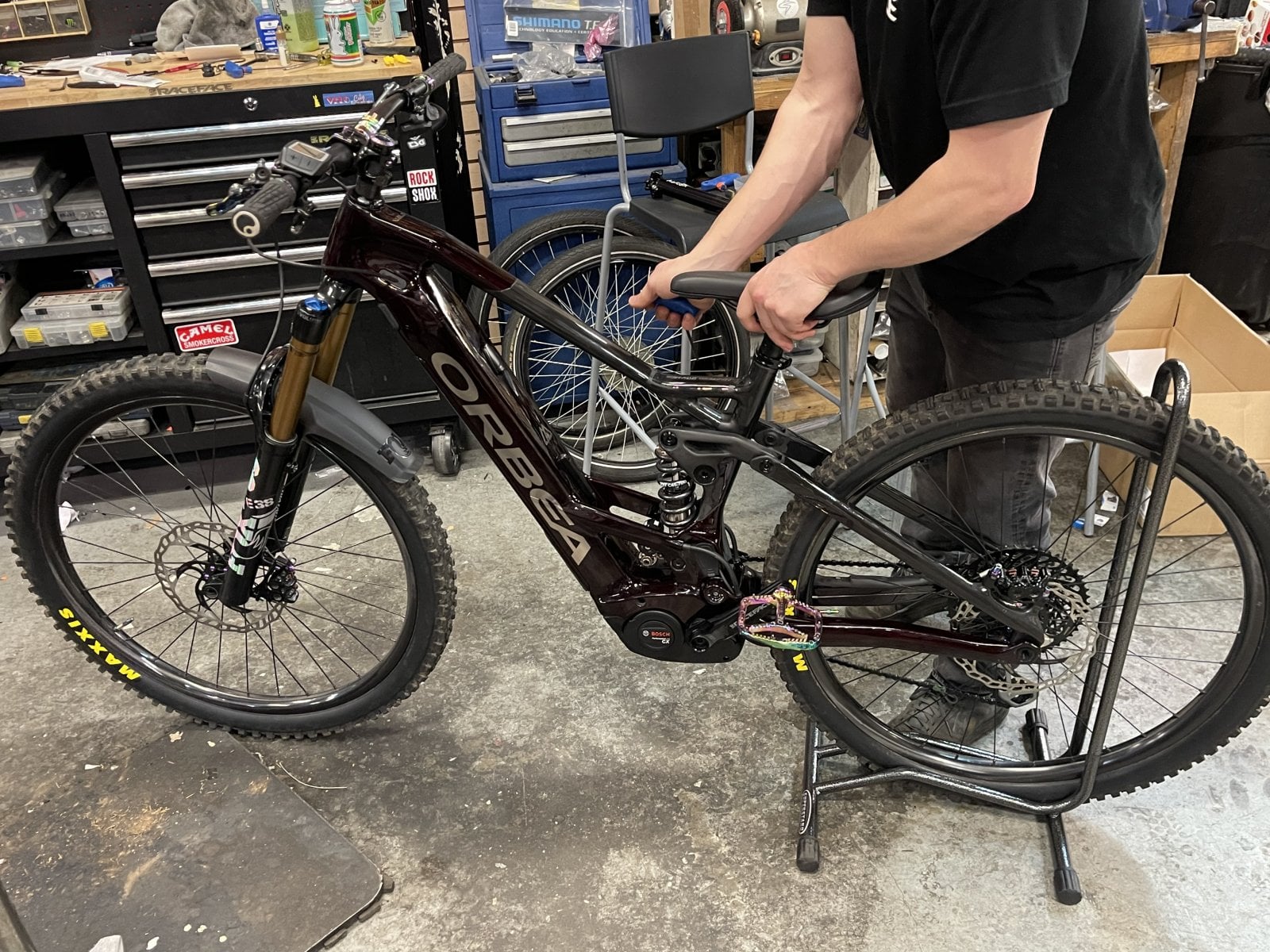

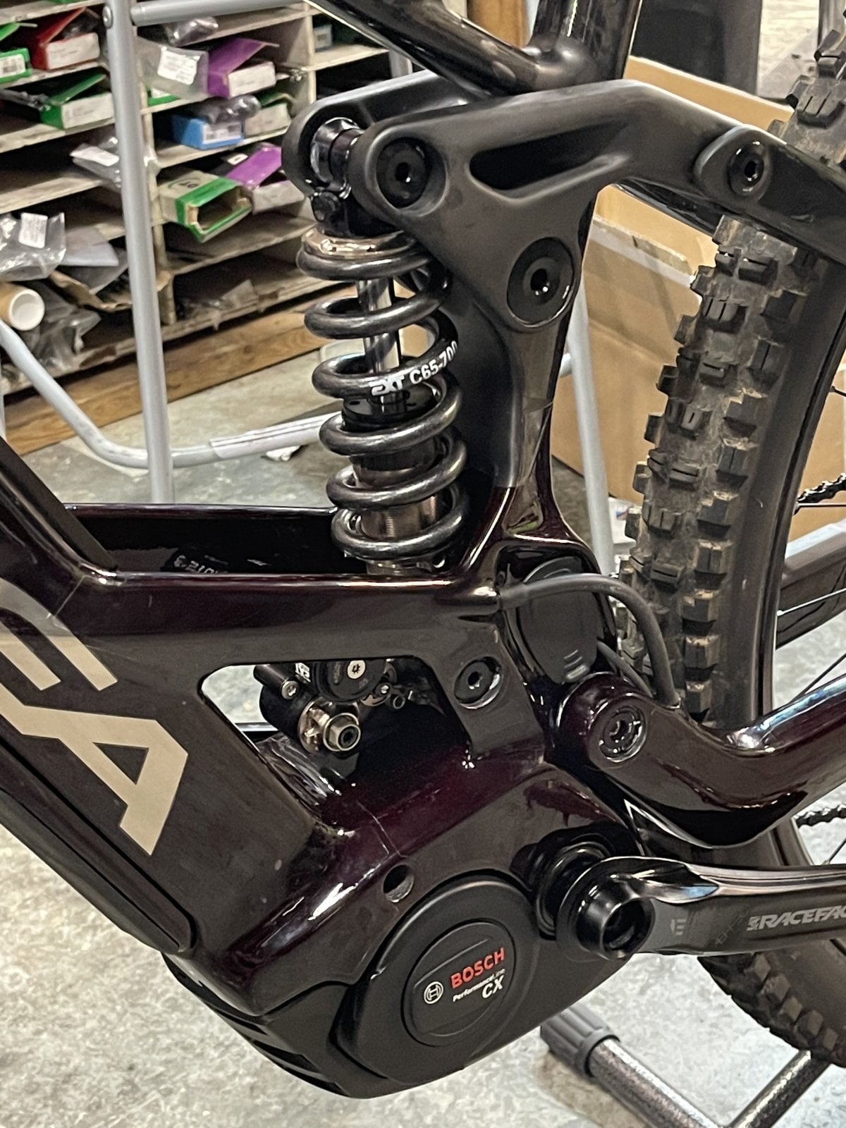

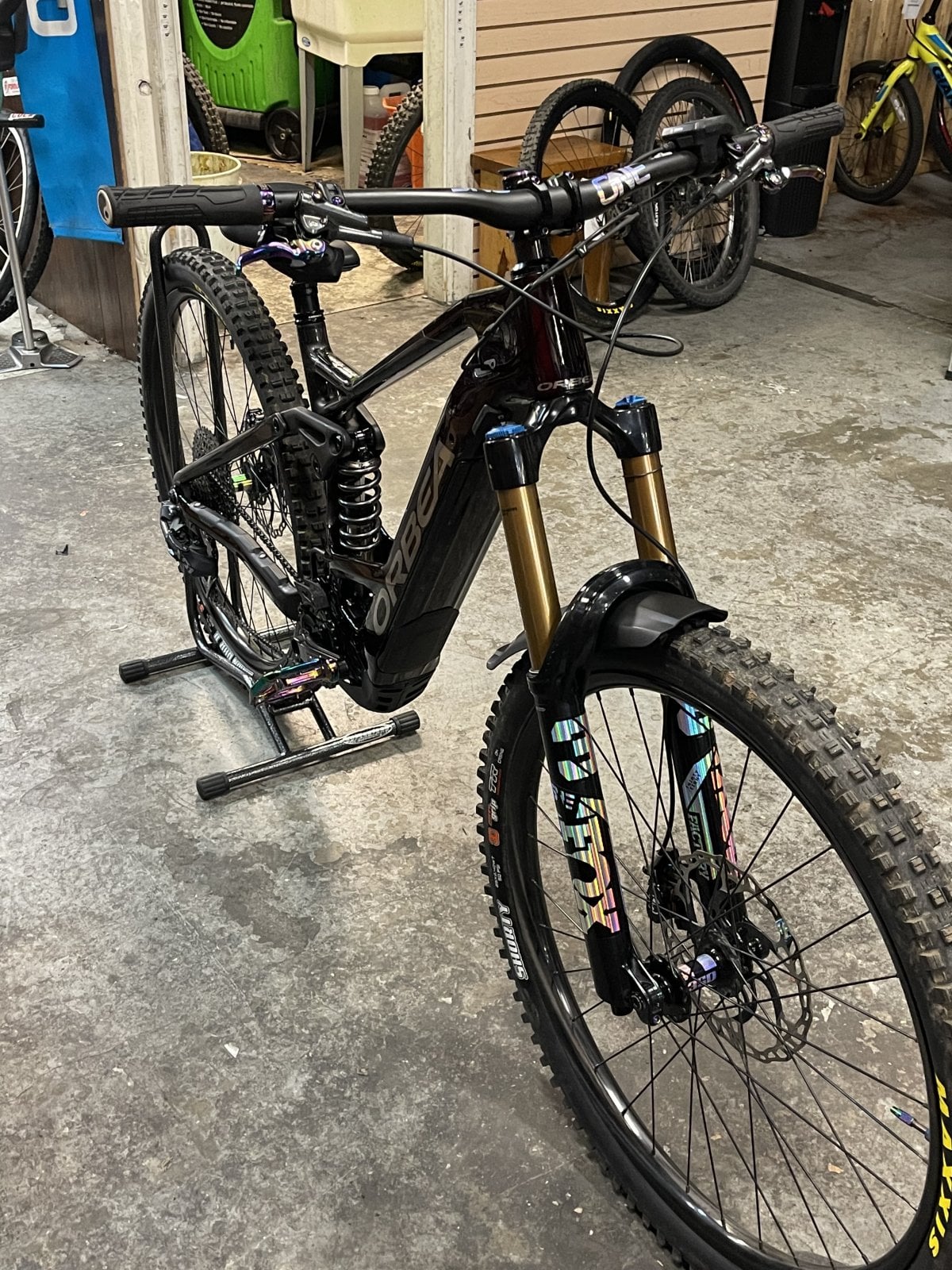

here’s my upgraded replacement frame all built up.
Mar 10, 2022
74
39
United Kingdom
word to the wise, I had another member upgrade his frame too and his dealer tried to make a profit off of the replacement frame to him.
For some reason some dealers feel the need to try to make money on the replacement upgrade from Orbea. You will have to pay labour to swap the frame as warranty doesn’t cover labour, but it’s still worth the upgrade in my honest opinion.
View attachment 84994 View attachment 84995 View attachment 84996
What an absolute sled that is! love it!
Yeah the dealer is a friend of mine so doubt he will try and do one over on me :)

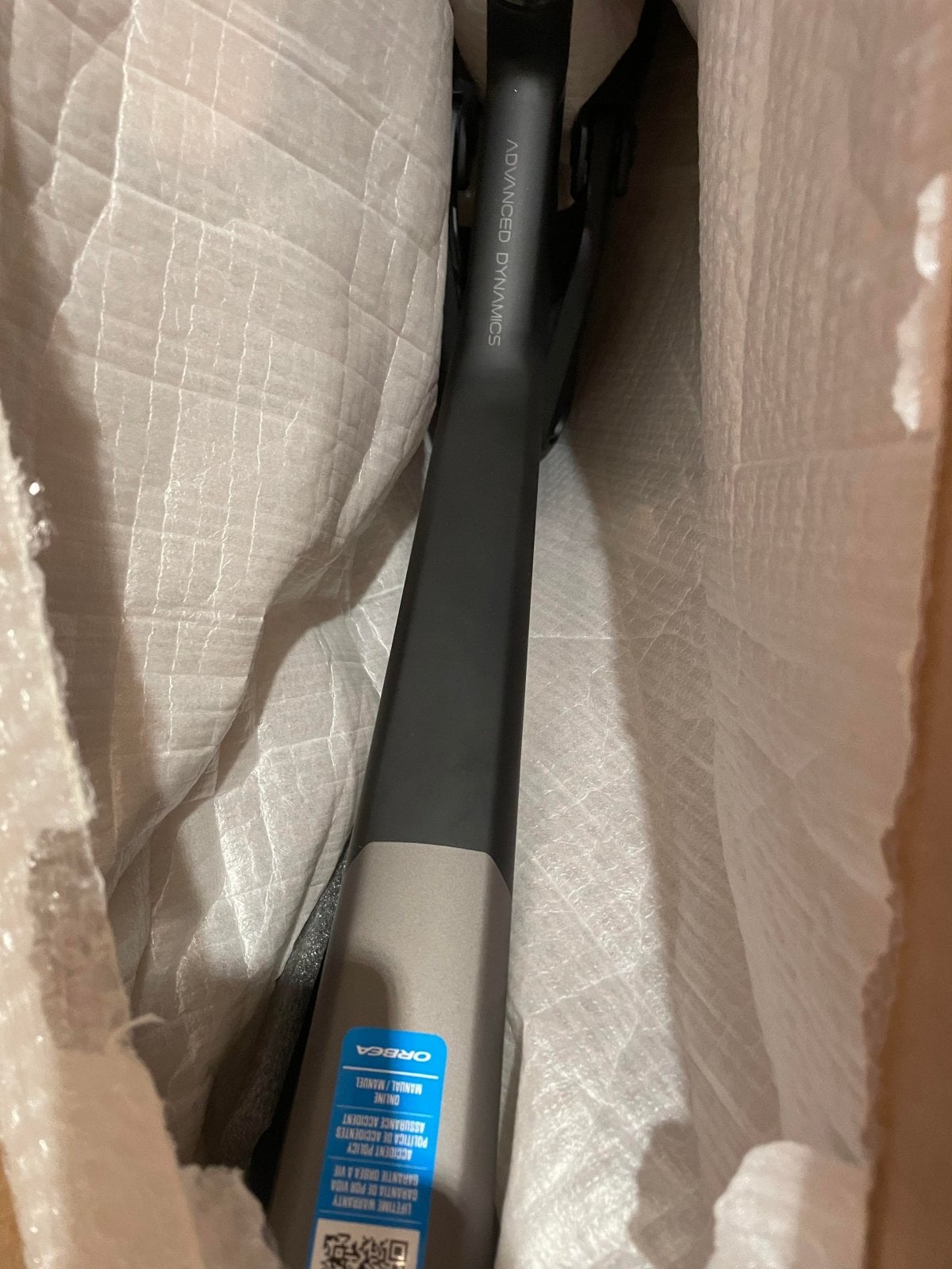

Just an update direct from orbea
Thank you for contacting Orbea, Paul!
Regarding to your concern about a possible frameset breakage in your Orbea Wild FS, I can see that you have a 2021 model.
Over the years, we have strengthened the frameset in order to avoid these breakages, and warranty claims statistics shows is working correctly. This is why we would recommend you to do not be worried about a possible breakage.
For the moment, our Wild FS carbon frameset is not for sale separately.
Best regards,

Keep in mind that the pictures shown with the frames completely cracked don't happen overnight. If you inspect the frame after cleaning which is something that I recommend everyone one does, you could catch it before it cracked like some of the pictures posted.
If the frame is damaged you'll see a crack in the paint. It's not going to just snap during a ride out of no where. And now you know exactly where to inspect the frame.
