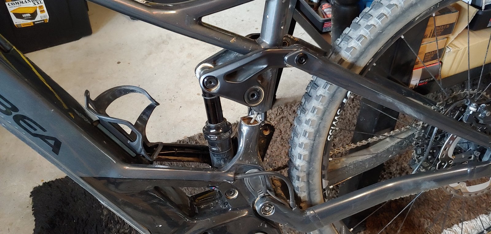

The alloy chainstays commonly crack on the Orbea Wild frames, so much so that Orbea sends you a free carbon upgrade if it does.
And when you compare the alloy version to the carbon version it's easy to see why.
The carbon chainstay is so much beefier and stronger looking in the exact spot the alloy ones crack. Almost makes me wonder why Orbea continues to use the alloy ones without a redesign.
But with that said Orbea seems to be warranting all of them so they are standing behind the product.

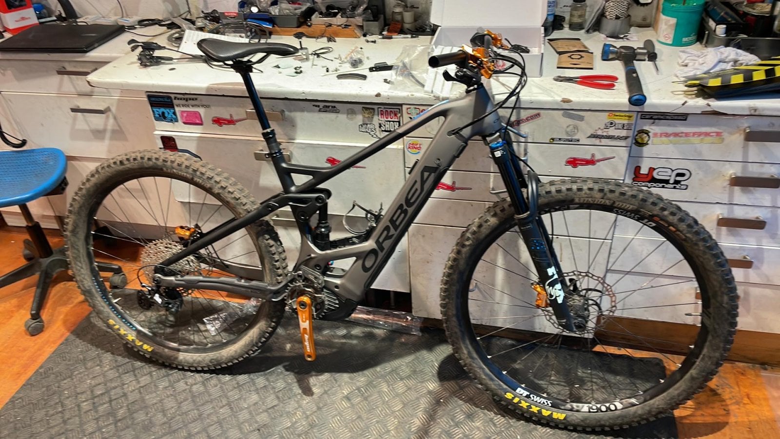

Mar 10, 2022
74
39
United Kingdom
Mine should be ready for the weekend, my mate added hope brakes to match the cranks and carbon wheels are going to be fitted.
The fox 34 will be swapped back for the orig 38 but I might actually put a red lyrik on there in stead I am not a huge fan of the FOX 38 (for sale now). New super deluxe rear shock to come and some narrower tires, the bike feels clumsy with 2.6's to me.
