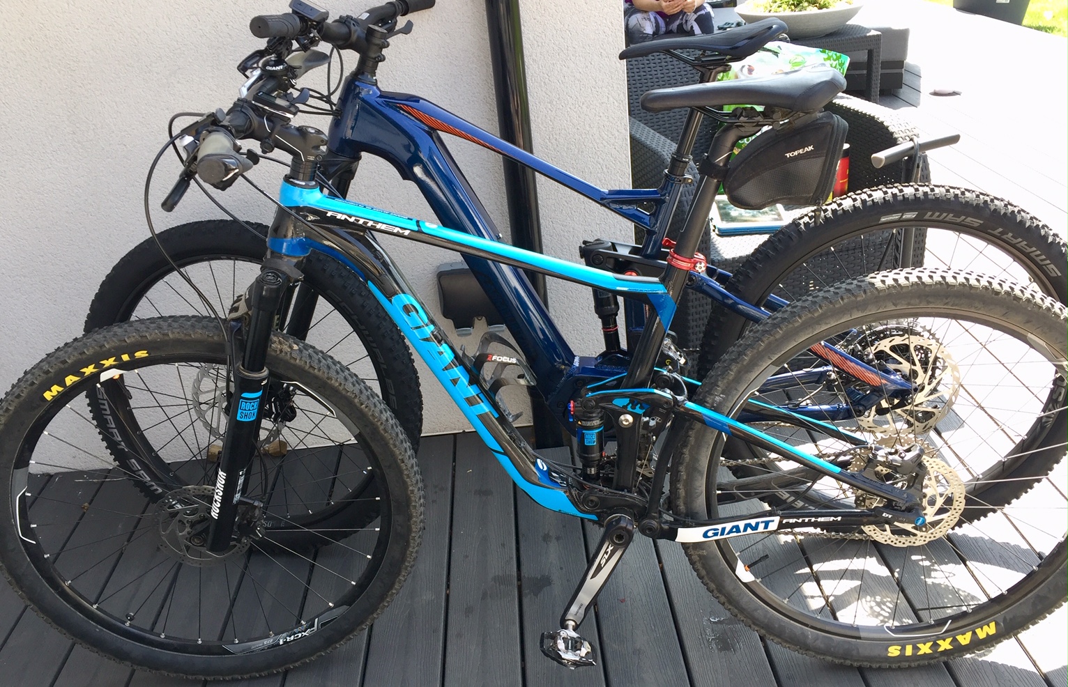

Just as a point of comparison, I have been riding relatively lightweight XC Full Sus bikes for the last 15 years, currently a 13kg Giant Anthem with carbon bars and lightweight wheel set.
Given it's my first EMTB so hard to score the bike out of 10 vs other bikes, but given the sheer value for money and fun you get riding it, it has to be a solid 8.

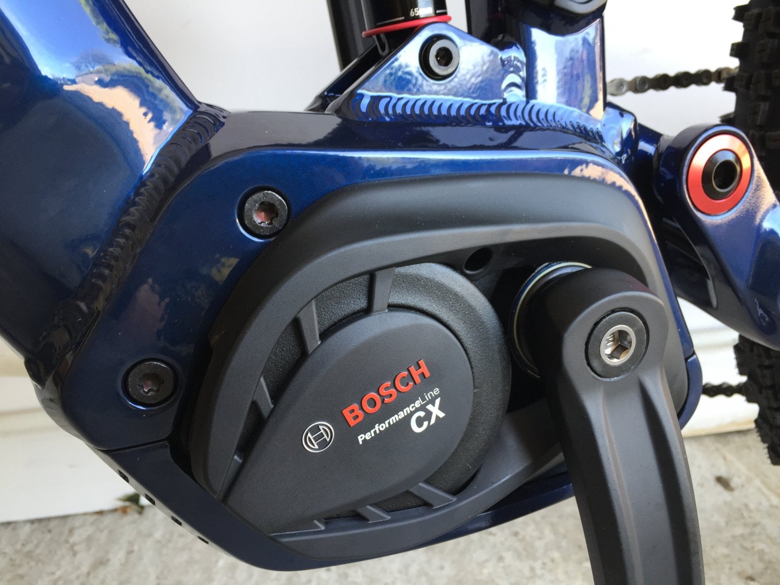

The Bosch gen 4 performance CX motor is great as everyone suggests, the power is there with 4 engine modes to choose from and I found it relatively quiet (again no real comparison vs other emtb's). You can really feel how much it assist you based on how hard you pedal.

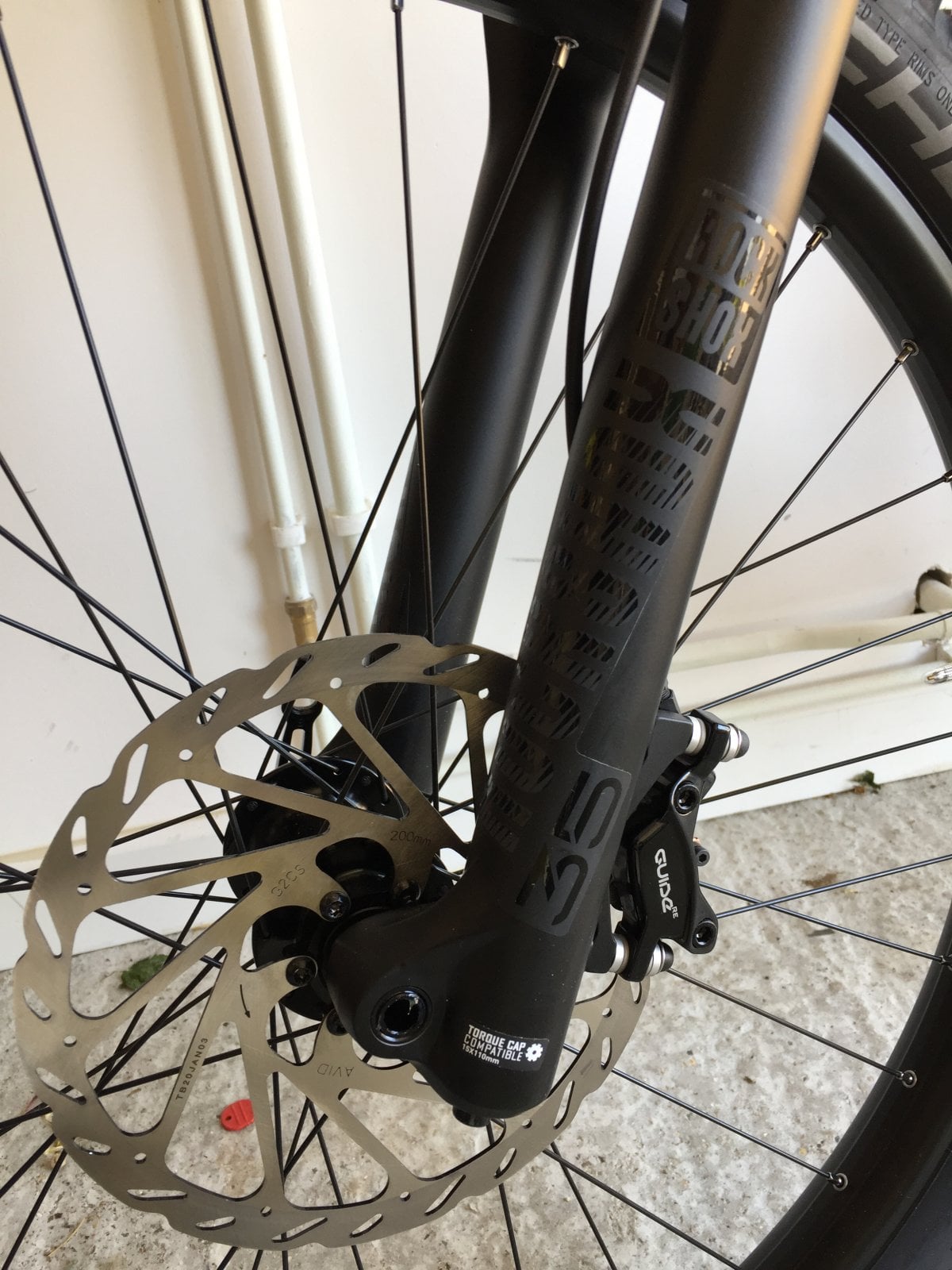

I found the breaks pretty poor to be fair but maybe it just the fact that this bike is twice the weight of my acoustic bike, they work for sure, but are not as sharp as I'm used to.

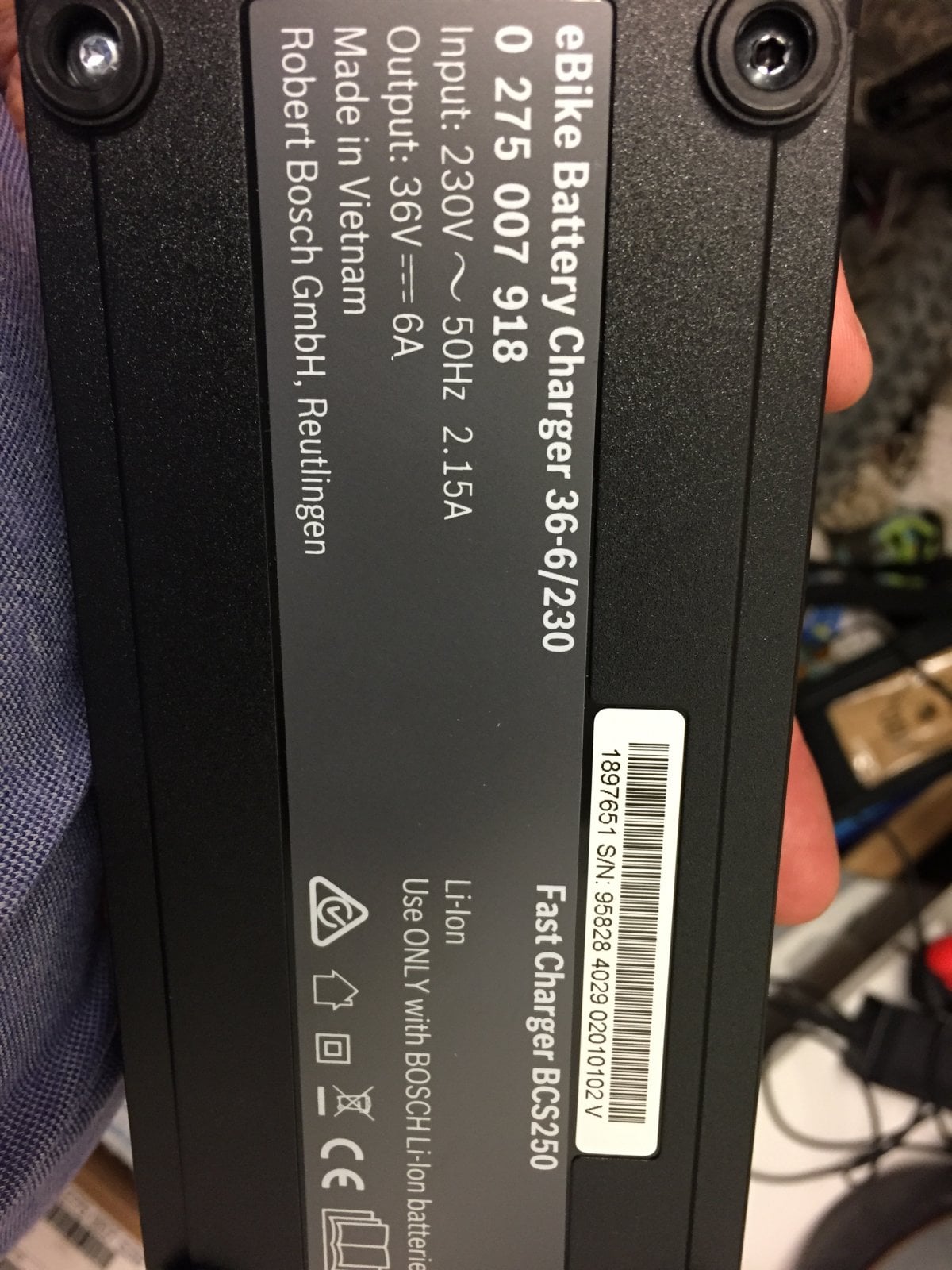

It came with a Bosch 6amp Fast charger worth £150, although it would have been nice to have had a slow charger as well.

Thanks - good tis ee there is a bash guard under the motor, wasn't sure if there was one or not.

Yes, happy with the Italian styling ;-) Decent solid plastic bash guard, all colour coded of course. Will see how it lasts. The battery cover also may help with stone chips and rocks being flung up from the front wheel. There is litterally only a few inches of Frame between the battery guard and the engine bash guard for rocks to hit.
