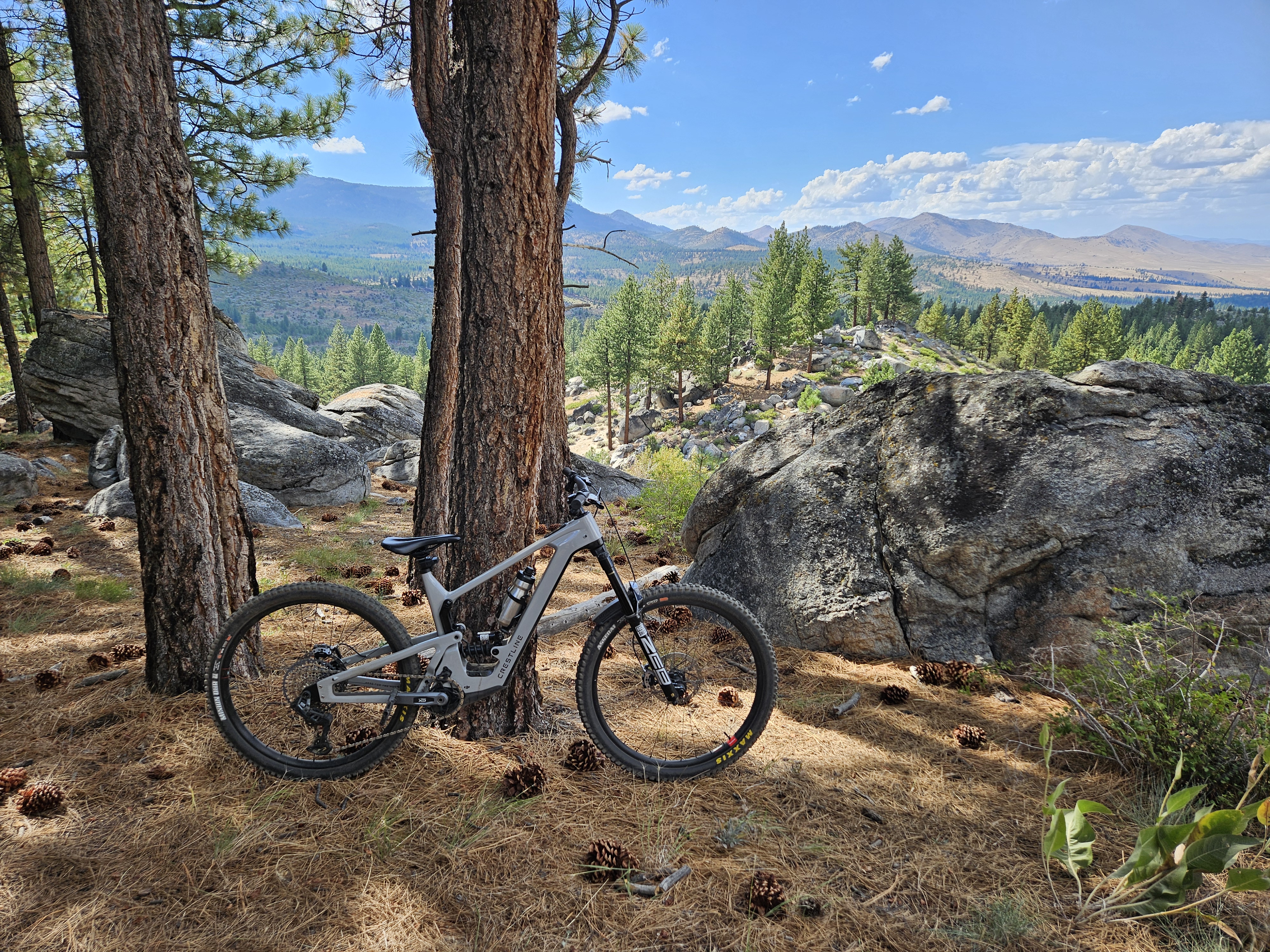

Here is a quick update after 499 miles.
* Avinox display screen did not fit tightly into the frame. If you tap on the bottom of the screen it will make a knocking sound. I put a couple layers of electrical tape inside the frame so the screen fits tightly now and doesn't knock.
* The Avinox speed sensor cable was making noise inside the frame (rear triangle). I had it attached to the brake line which caused it to bind up. I now have the brake line and speed sensor independent and no more noise.
* I started to hear additional knocking from the motor. Found that the motor bolts (both) have come loose. Torqued the bolts and all good now. The suspension pivot bolts also had to be torqued back down.
* My Maxxis DHR2 DD Maxx Grip is completely done after 450 miles. Just switched to the Schwalbe Magic Mary Gravity Ultra Soft Radial/Albert Gravity Ultra Soft Radial and loving the combo so far! Actually surprised how nice these tires ride.
* My SRAM Maven organic pads are also done at 499 miles.
* The new Rockshox AXS dropper post is stupid. When not fully down or extended it knocks really bad. Had the older version AXS dropper laying around and swapped for that.
* Can ride 30 miles/5,000ft in Trail and 25 miles/4,000ft in Turbo. Range is good. Also done these rides on 95 degree days without any overheating issues.

Helpful update, I always gotta remember to recheck pivot bolts after a few rides!

No issues with my new AXS Dropper, makes zero noises or knocks and it's a long boi 250mm
Mon issues with my new AXS Dropper, makes zero noises or knocks and it's a long boi 250mm
Hmm, I might send it in for warranty.
If you raise the post 1/2 way and press on the seat does the seat squish a little? Mine does squish but makes a top out sound hitting the bottom and top of the stroke.

My EP801 and Bosch Gen 4 Race motors all rattle a bunch. My Avinox motor rattles about 1/2 as loud as those. My brake pads rattle louder than the motor.

I’m sitting at 2,000 miles on my Crestline Avinox, and honestly, this thing still rips. Best bike I’ve ever thrown a leg over. The motor rattle hasn’t gotten worse with mileage — at this point I barely notice it. Zero issues with the motor or frame.
SRAM GX Transmission
No reason whatsoever to jump to XO or XX on an e-bike. I’m 2,000 miles in on the original chain, cassette, and chainring.
SRAM Maven Ultimate Brakes
Never again. Three different shops have bled them. They feel amazing for a week, then the pistons start sticking and the bite point wanders like a drunk dog. Great for the first few rides after a bleed… and then nope.
Reserve Alloy Wheels (DT350 hubs)
Shockingly good wheels for $700. Still true, spokes still tight. Zero complaints.
RockShox ZEB Ultimate
Mine knocked and creaked from day one. Got a new CSU and a fresh service — rides fine now.
RockShox Vivid Coil
Set it and forget it. Fantastic shock.
SRAM AXS Dropper V2
Knocked straight out of the box. SRAM finally warrantied it last week. Haven’t bothered installing it — I’ll toss it on the next bike.
OneUp 50mm Bars
Huge fan. Way more comfortable.
OneUp Composite Pedals
These things rule. After years on the alloy version, I’m way happier with composite. They stay looking clean and glide over rocks better. Price is right, too.
I’m pumped to see what Avinox drops for 2026. Really hoping Forbidden rolls out the E-Dreadnought. I’m holding off until Sea Otter before choosing my 2026 rig.
