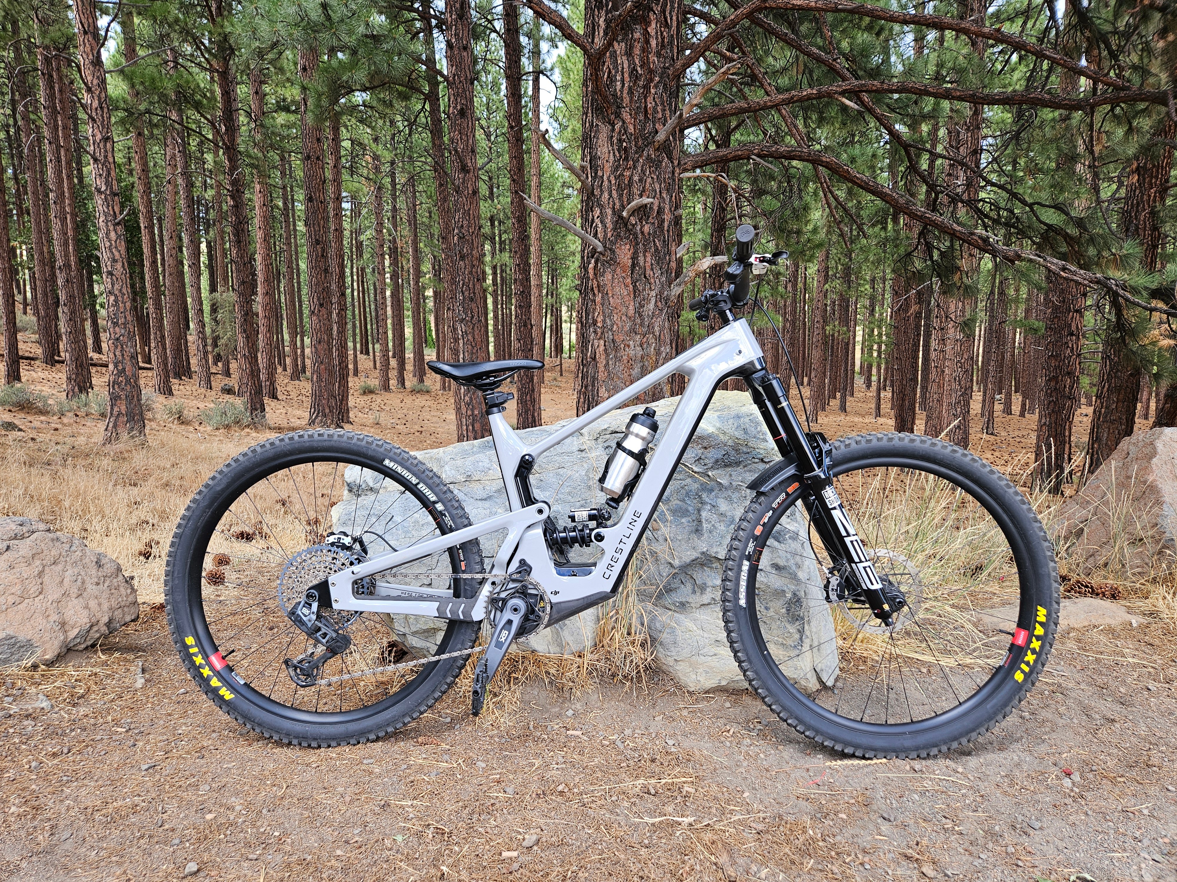

1st ride on my Crestline RS 181.1 DJI

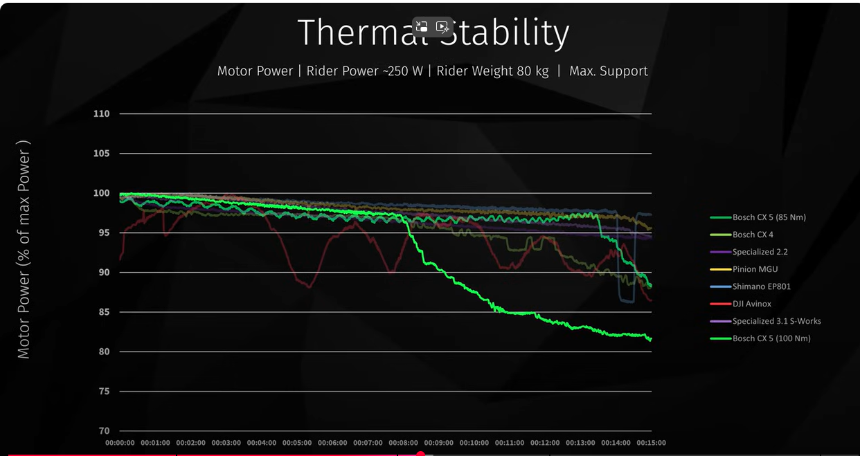

The DJI motor (red graph) does a lot of weird things as it heats up as seen from the Velomotion test results. The Bosch (green graph), typical German engineering, remains very steady and that has a very even fall off that might even be hard to detect. This is with the 100NM upgrade btw. You can also see that the 85NM version of the Bosch has the same pattern, it just takes longer to get derate as it's making less power.
The reason the Bosch Gen 5 85 NM did better in the long (20 mins I think) climb than the DJI might just be because the Bosch has higher average power over a 15 min test on a hot day.

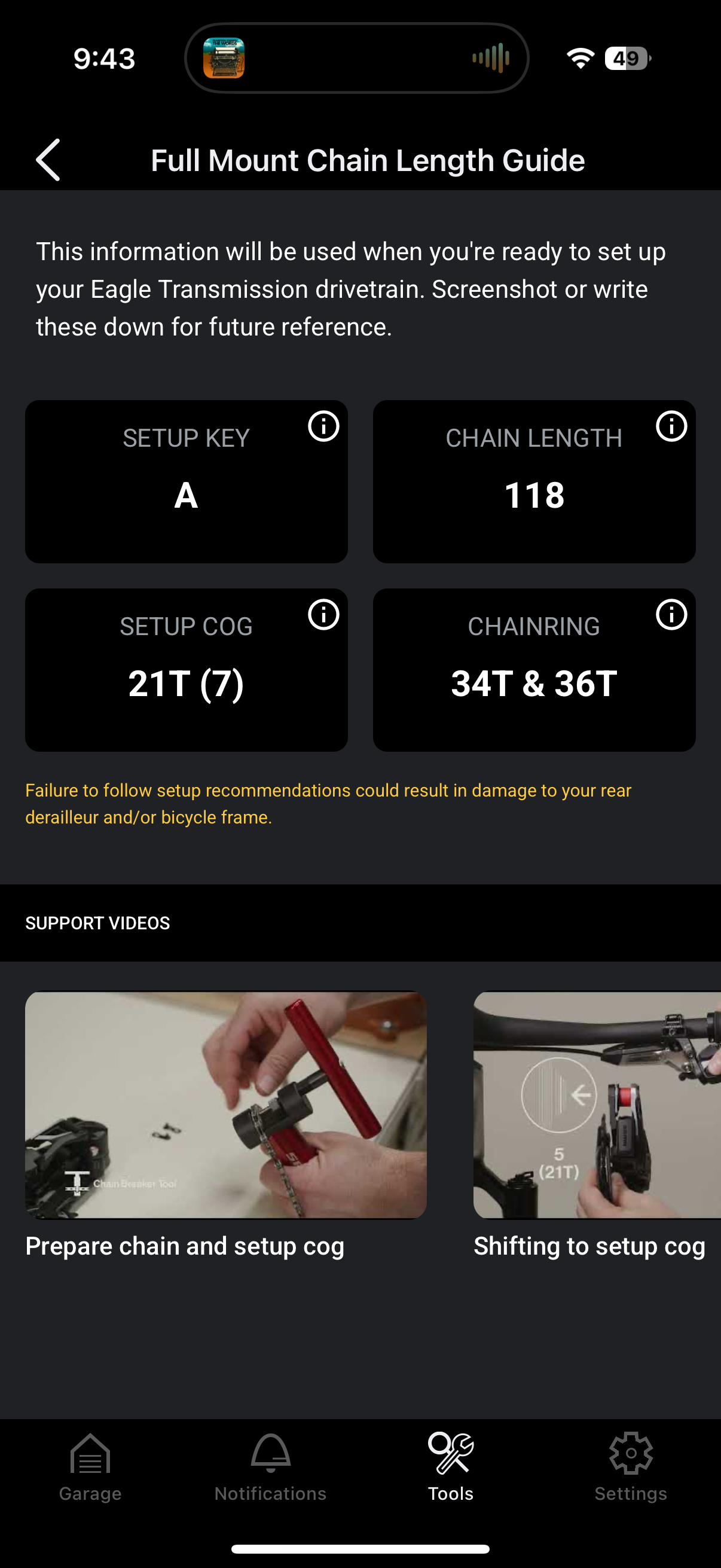

Thanks! One more question, what is your chain length? Did you use SRAM chain length recommendation? I understand they just recently added RS181 to their list but I’ve heard it’s inaccurate.
RH2 w XO transmission w 34T chainring and my chain length is 118 links just as indicated in the SRAM set up guide for the RS 181 Spectre. Works perfect!!
What about rear tire and drop out length? Wouldn’t that change the required chain length?
I’m wondering what the required T-type chain length is for my RH-4 MX(27.5) 440mm drop outs and 36T chain ring?
Yes, different dop out/CS lengths and chain ring teeth will change chain length. All of those variables can be selected here:

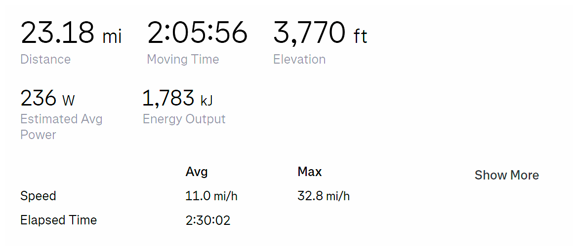

Really digging the range I'm getting. This ride was using 100% Turbo Mode (105nm/800watts) (assist + overrrun maxed out) and ended up with 25% battery left at the end of the ride. Doing the same ride with my Bosch Gen 4 Race Motor running 100% Race Mode I end up with 33% battery left.
Good data point.
The Gen4 750W battery used .44w/ meter whereas the DJI used .52W/ meter (18% worse efficiency) but maybe was climbing faster. Do you have your average speed on the Gen4? Extraordinarily close to what e-mtb got for their efficiency numbers too when they compared the Gen5 vs. the Avinox. Like so close!
It's a solid comparison, same rider, terrain, model bike, probably tires, etc. Only catch, the older motor for the Bosch.
Either way, this checks out with what I consistently see, the Avinox being about 20% less efficient than the Bosch. If true, that has a 600 watt watt Bosch being equivalent to a 720W Avinox battery. Or an 800w Bosch being equivalent to a 960w Avinox battery.
