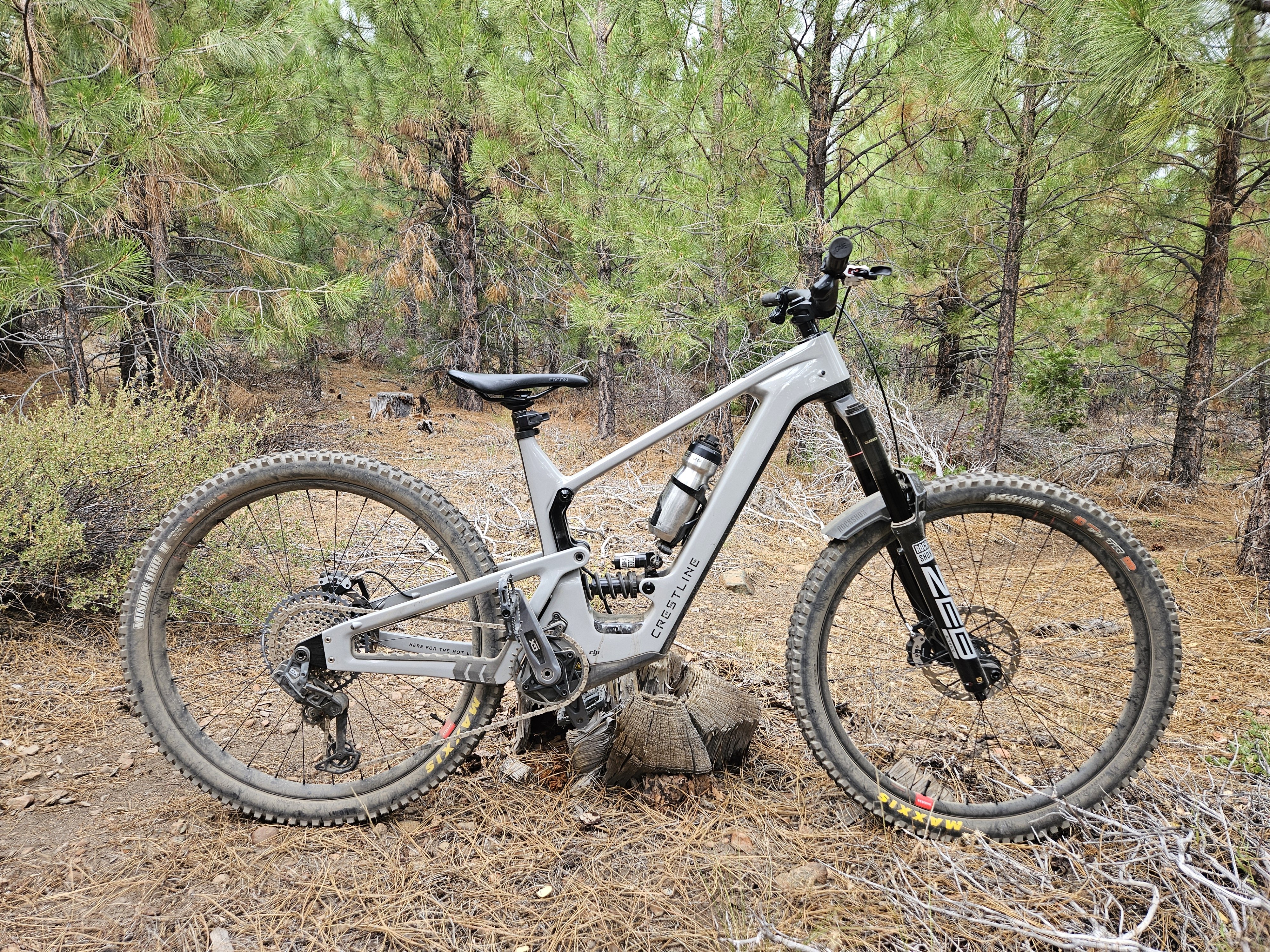

1st ride on my Crestline RS 181.1 DJI
Let's assume the Bosch Crestline offered the adjustable CS length.
Would you still choose the DJI version for the power/ integration/ looks/ etc?
Or instead the CX-R for the low noise, high efficiency, etc?

I’m super bummed to hear about the downhill rattle! One of the reasons I pulled the trigger on the RS181 and sold my Crestline Bosch Gen4 was to reduced the downhill rattle. I’m glad I’ve never ridden a silent Bosch Gen5….. sounds like I’d be even more bummed with the DJI.
The SideKick hubs that were on my previous Crestline are going on my RS181 regardless.
Just finished fully Ride Wrapping my RS181 frame, including some custom cut pieces for places Ride Wrap doesn’t cover. She’s well protected.
depends on the generation of cx4 you had. the first ones where loud as hell compared to the latest versions. Definately louder than the DJI. hopefully DJI will change some internals in the future to get the noise down.
I've done over 2000 miles on my DJI/Amflow and can honestly say I've never heard or noticed a rattle.
How bizarre!
Indeed :) I am on the 2nd Motor. Both rattle. First one maybe did rattle a little more, but the Axle had a lot of side to side play...so they replaced it.

I guess you will be happier with the new motor, but you will notice some rattle. there are so many other good things coming with the DJI system. You will have a alot of fun. great bike too!
Hopefully DJI keeps the same mounting and motor size when they release the quiet Gen2 motor, that way us with the Gen1 can swap it out.
That's a pretty big bummer honestly. Thanks for the clarification though. I'm actually not that sensitive to bike noise, not sure if it's even a factor for me.
Bosch Gen 5 CXR Pros: considerably more efficient, included bash guard coverage, no rattle noise
DJI Pros: better integration especially with the 800w battery, even more power, can derestrict to 28 mph, technically 1# lighter but in light of the less efficiency, it's maybe not really.

The bike came out to 53.11 lbs with the following build.
Crestline RS 181 Spectre DJI Frameset RH-3 29er 800wh 450mm CS
RockShox ZEB Ultimate Charger 3.1 RC2 Suspension Fork - 29", 180 mm, 15 x 110 mm, 44 mm Offset, Black, A3
RockShox Vivid Ultimate 205 x 65 Coil Shock
RockShox Metric Coil Spring - Length 151mm, Travel 57.5-65mm, 350 lbs, Black
RockShox Reverb AXS Dropper Seatpost - 31.6mm, 175mm, Black, B1
SRAM AXS POD Electronic Controller - Left or Right Mount, Discrete Clamp, 2-Button, Black, D1 (Dropper Post)
SRAM GX Eagle T-Type Ebike AXS Groupset - 160mm ISIS Crank Arms
SRAM Eagle T-Type Chainring - 36t, 12-Speed, 104 BCD, Steel, Black
SRAM Maven Ultimate Stealth Disc Brake and Lever - 4-Piston, Titanium Hardware, A1 - Front
SRAM Maven Ultimate Stealth Disc Brake and Lever - 4-Piston, Titanium Hardware, A1 - Rear
SRAM HS2 Disc Brake Rotor - 200mm, 6-Bolt, Rounded, Silver/Black (2ea)
SRAM EP Cable Extension Cord Eagle Transmission Powertrain 955MM
OneUp Components Regular Grips, Black
OneUp Components Stem 35mm clamp 42mm length +/- 0 Degree
OneUp Components V2 Carbon Handlebar 35 x 800mm, Black - 35
OneUp Components Composite Pedals (Black)
Reserve Wheels Reserve 30 HD AL Wheelset - 29", 15 x 110/12 x 148, 6-Bolt, XD, Aluminum, DT 350
Maxxis Assegai Tire, 29'' x 2.50, Folding, Tubeless Ready, 3C Maxx Grip, Double Down, Wide Trail, 120TPI, Black
Maxxis Minion DHR II Tire - 29 x 2.4, Tubeless, Folding, Black, 3C MaxxGrip, DD, Wide Trail
Trail One Components Top Cap & Spacer Kit - Black
Cane Creek 40-Series Steel 52/40 1.5" Crown Race
Ergon Men's SMC Saddle, Black, S/M
Specialized Zee Cage II + Tool
