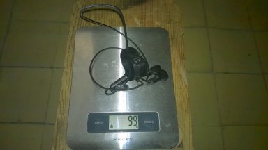

    shift control Shimano Deore XT DI2 SW-M8050-L Switch left

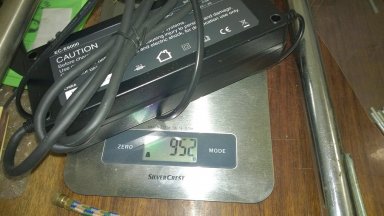

    Battery charger

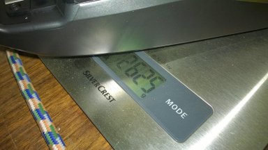

    batery

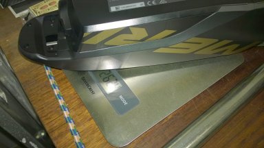

    batery
